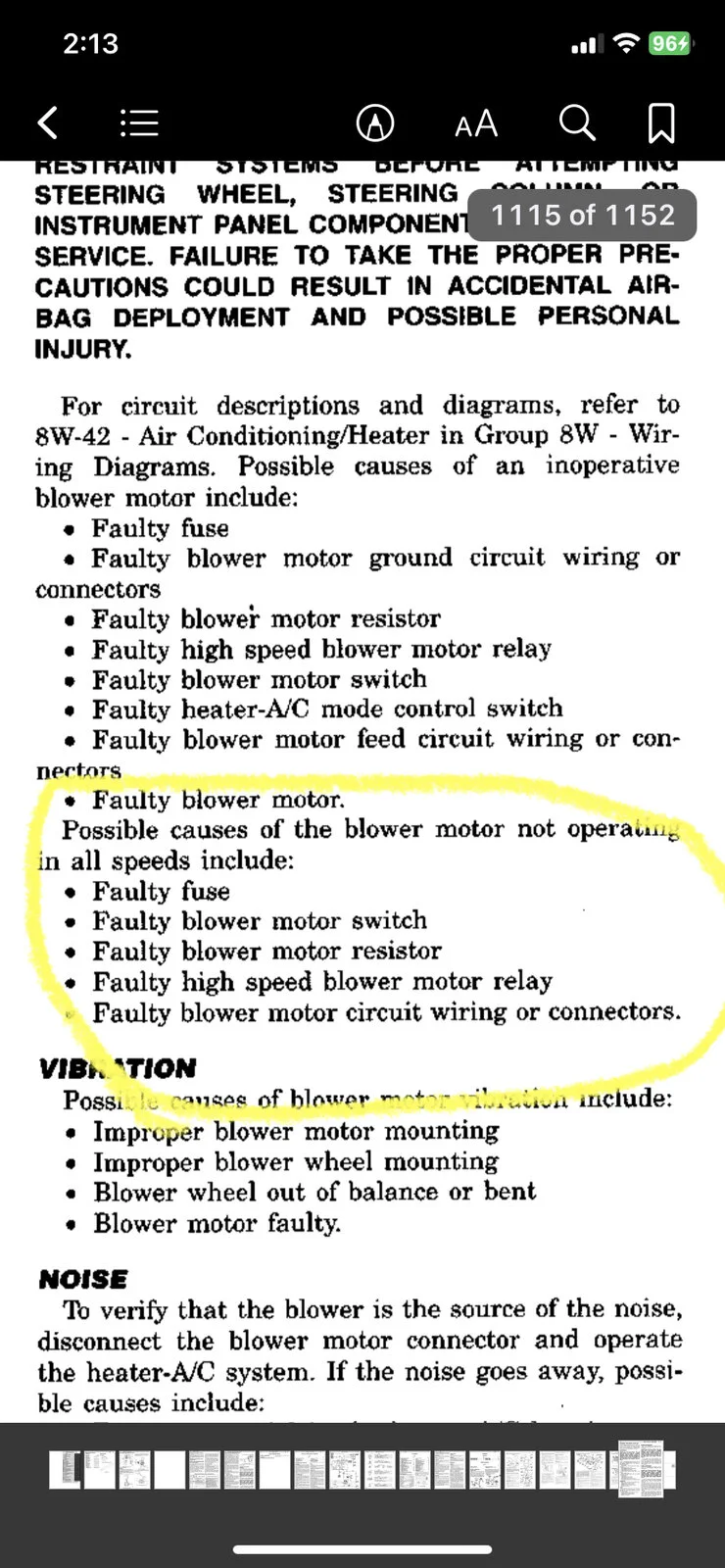

I’ll just have to break out the meter while I’m waiting in the parking lot for my daughter to get out of school lol FSM says these things could be responsible for fan only working on one speed. When I changed the switch originally it would only work on speed 3 but still only one speed so I swapped it back to the original switch since it fit without modifying the metal bracket on the back of the switch. The resistor still looks new and shiny as I could see it when I replaced the fan. I had tested the ohms on it before but will have to check it all out and try the other switch again now that the fan is replaced. Maybe it’s a burnt wire, that’s kind of my suspicion because the pigtail I replaced when I changed the resistor and relay was a little crisp
