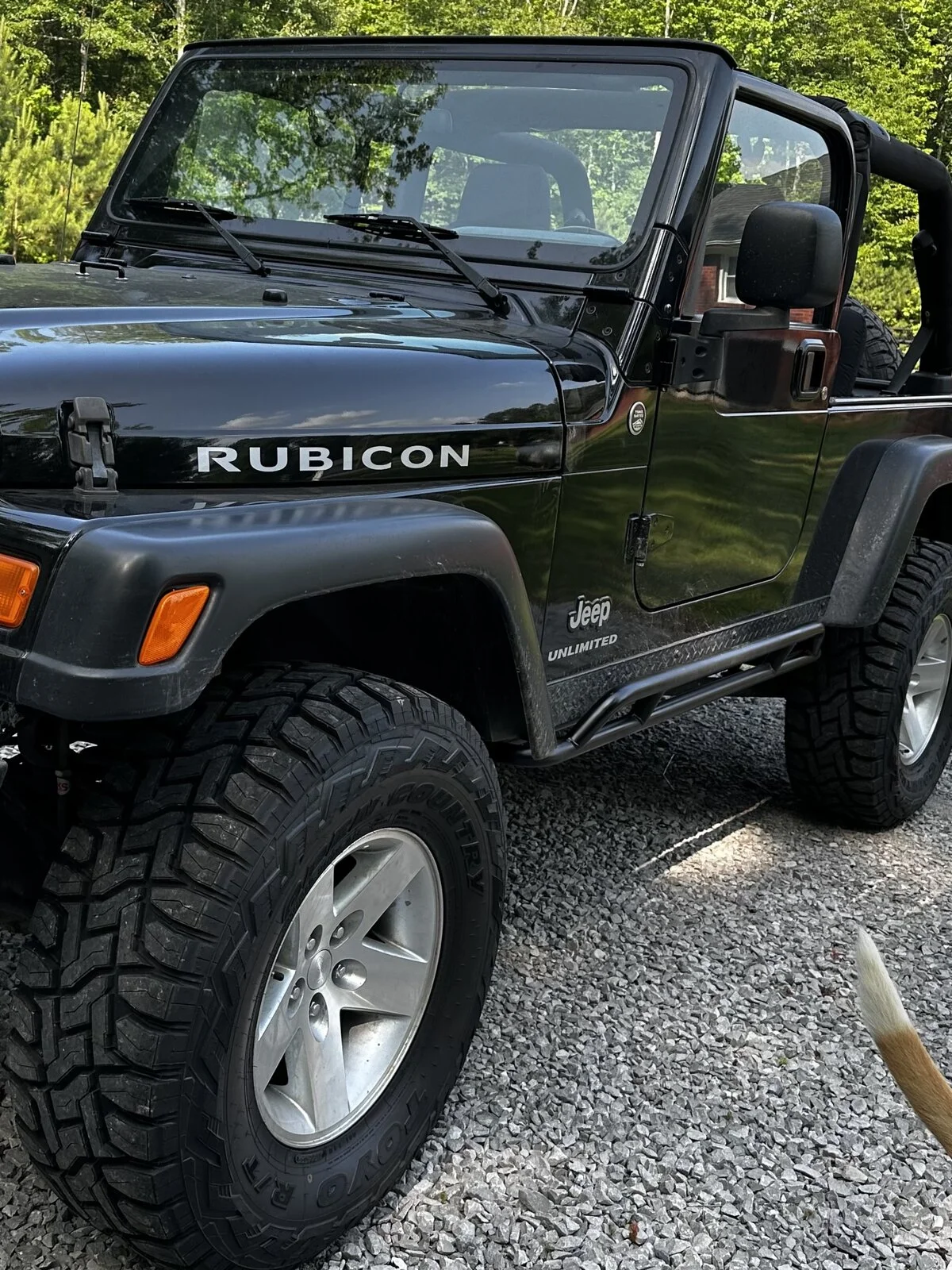

Here is the finale of the flipping of the rock rails.. they were on the other sides.. with the bars downward..
I have some of those if anyone wants to come by and pick them up. Rubi sliders also.

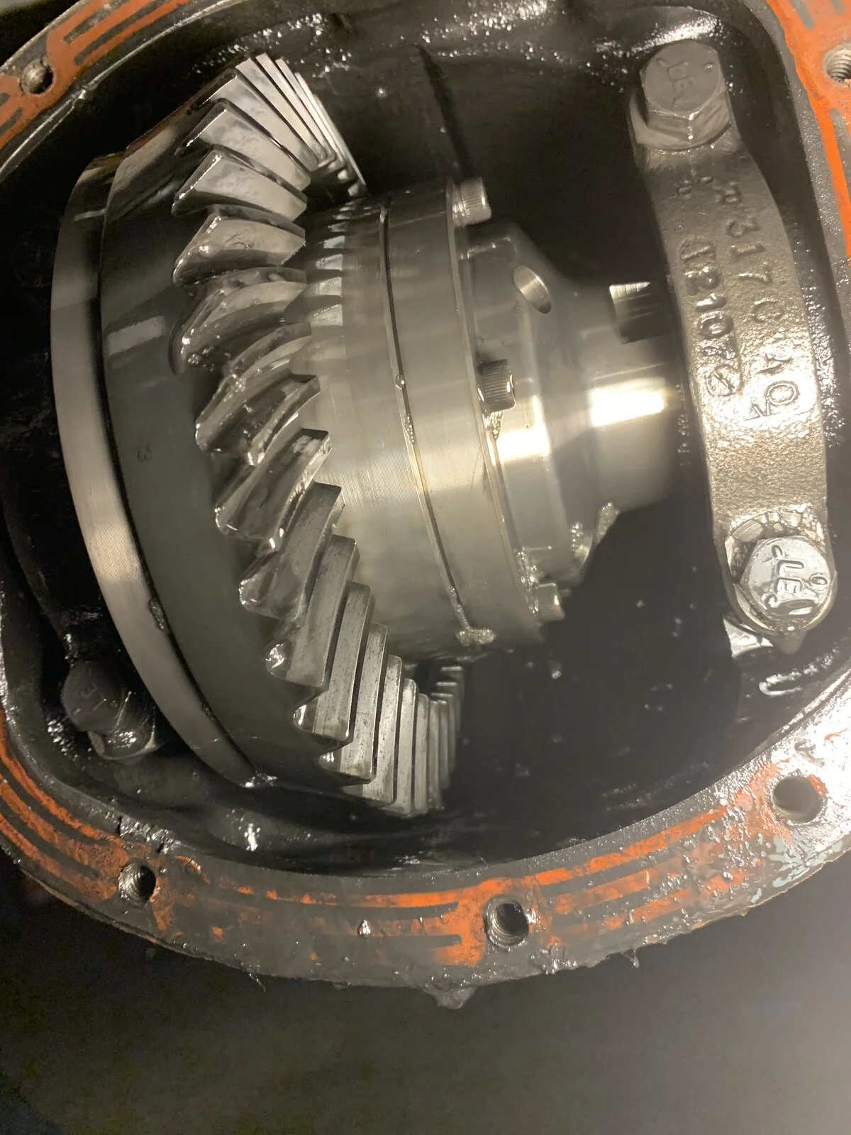

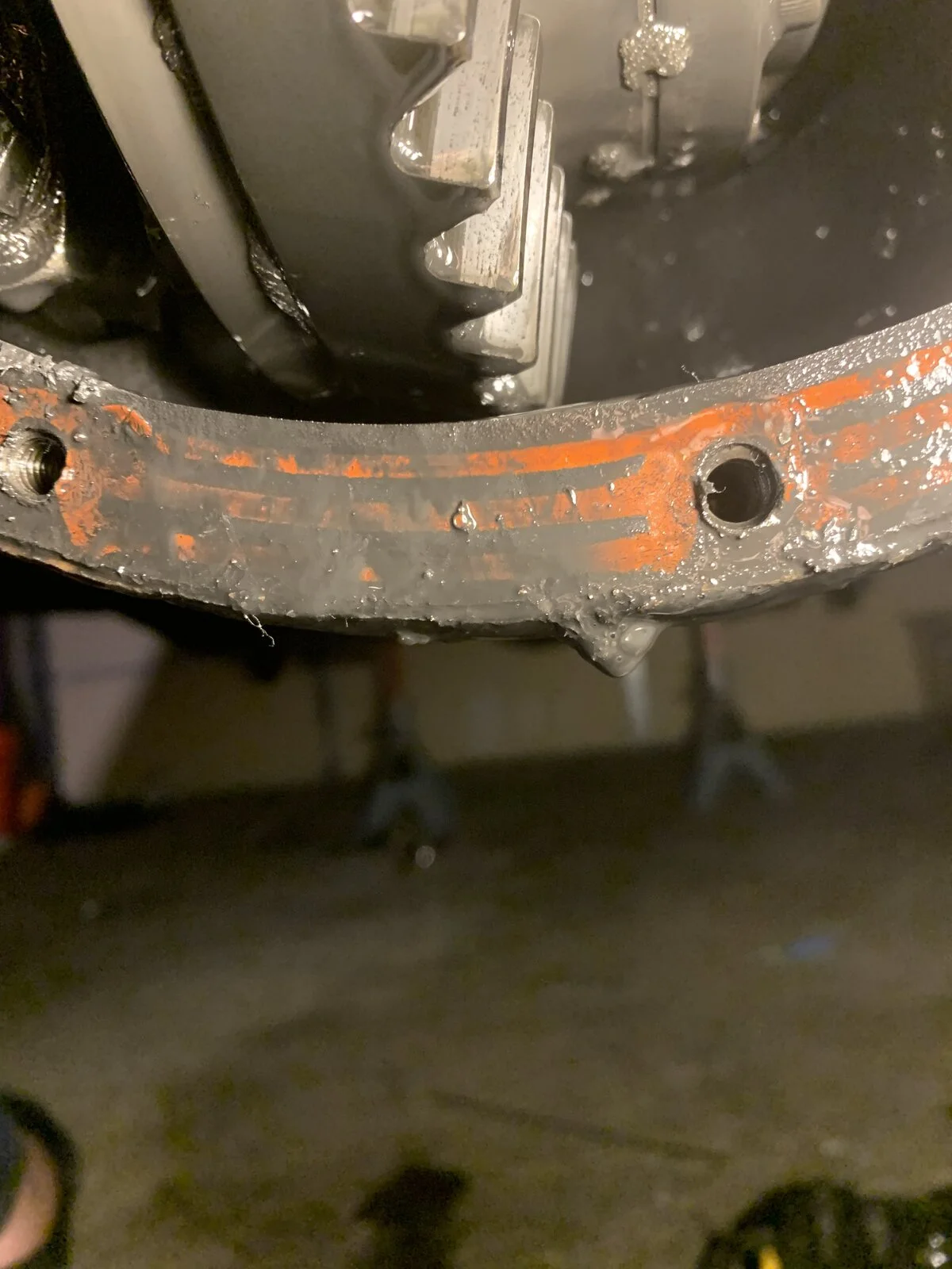

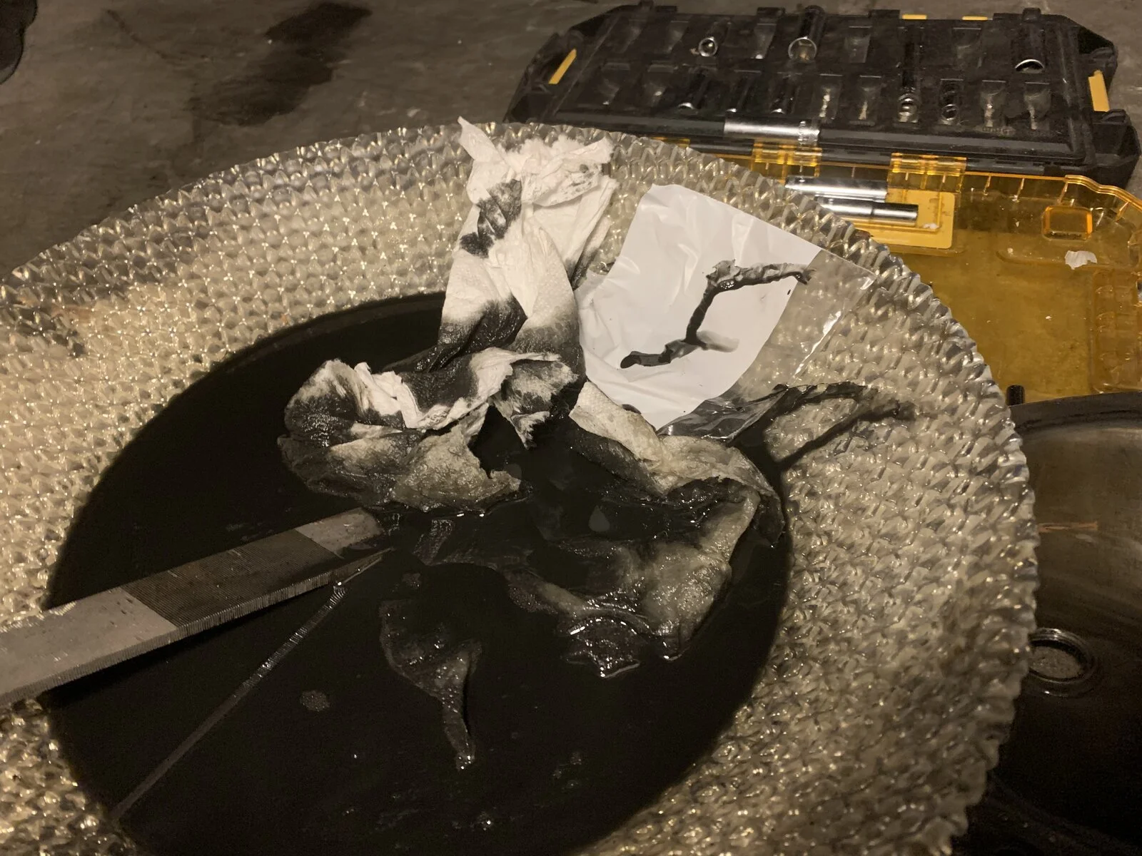

I did find find that the breather tube on on front diff was not attached to diff, so water and dirt could get into it through the top, as the there was simply a hole.
Also my pinion seal is leaking, water could get through it as well, although much less likely.

Do you spend much time in axle deep water much?
