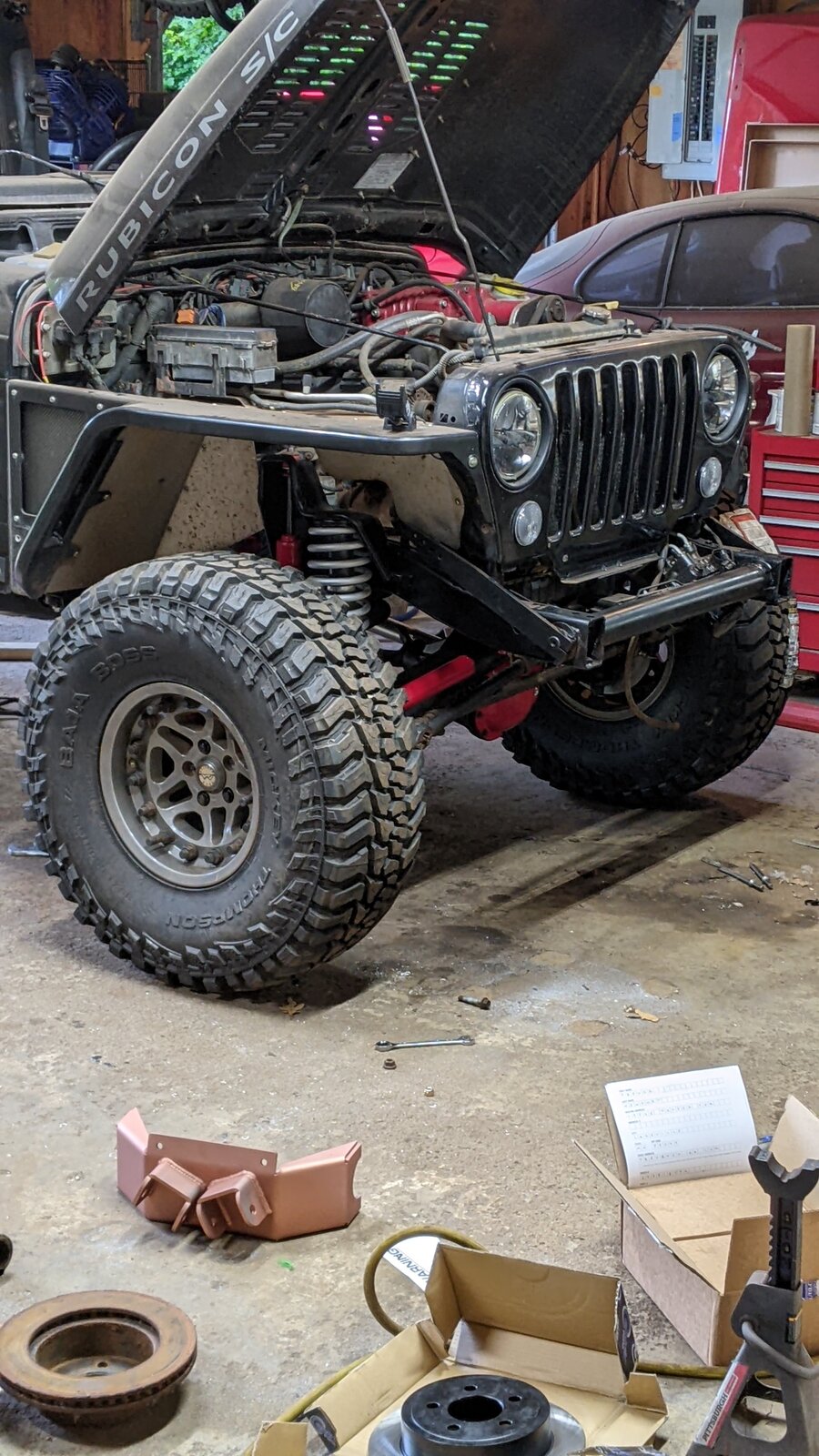

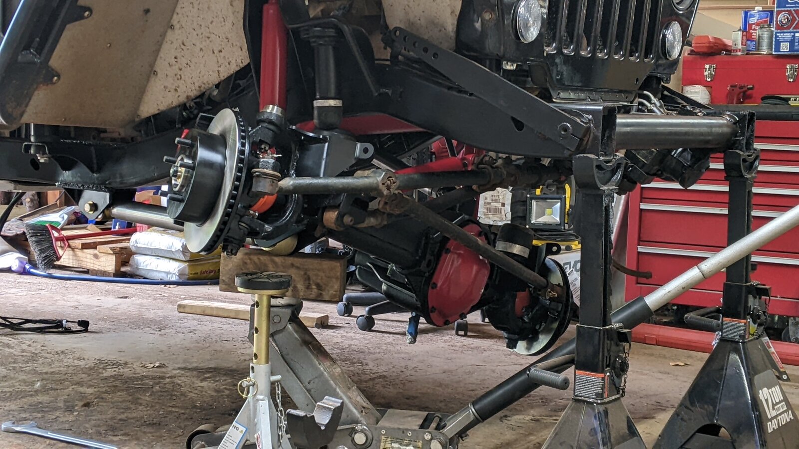

Made some changes to the suspension seat base. It needed to move rearward but that left over half the base cantilevered and unsupported, so I chopped a couple pieces of 2.5" square tube to support the overhanging part. The pieces are cut at an angle so I can get a wrench in there for the floor bolts.

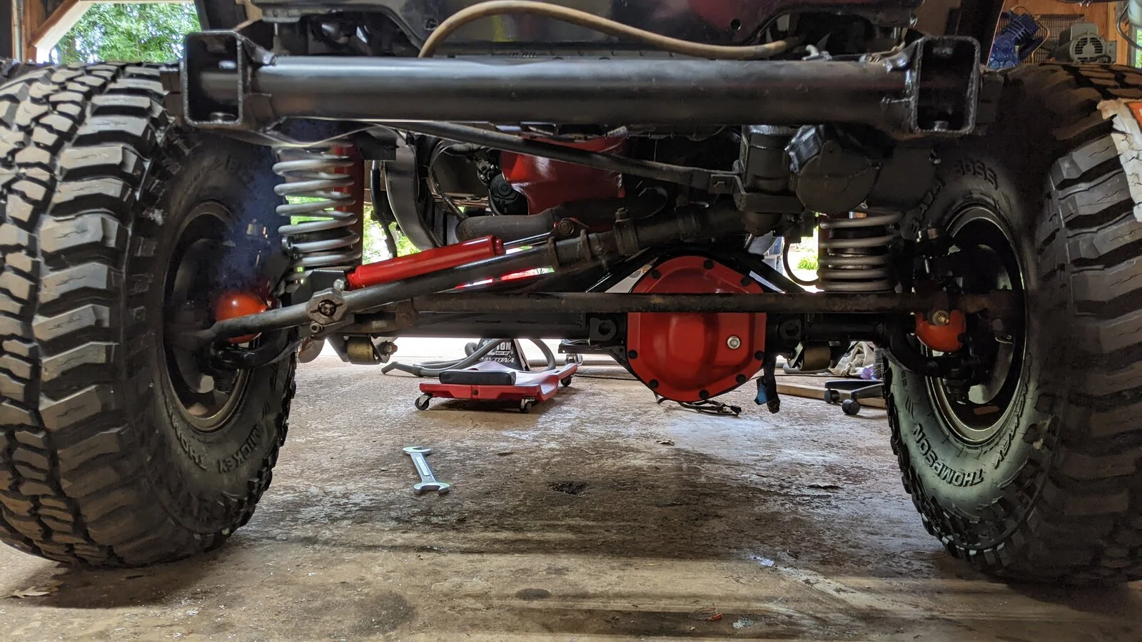

Finished painting the frame, got it back down on all the new body mounts and savvy BL and torqued.

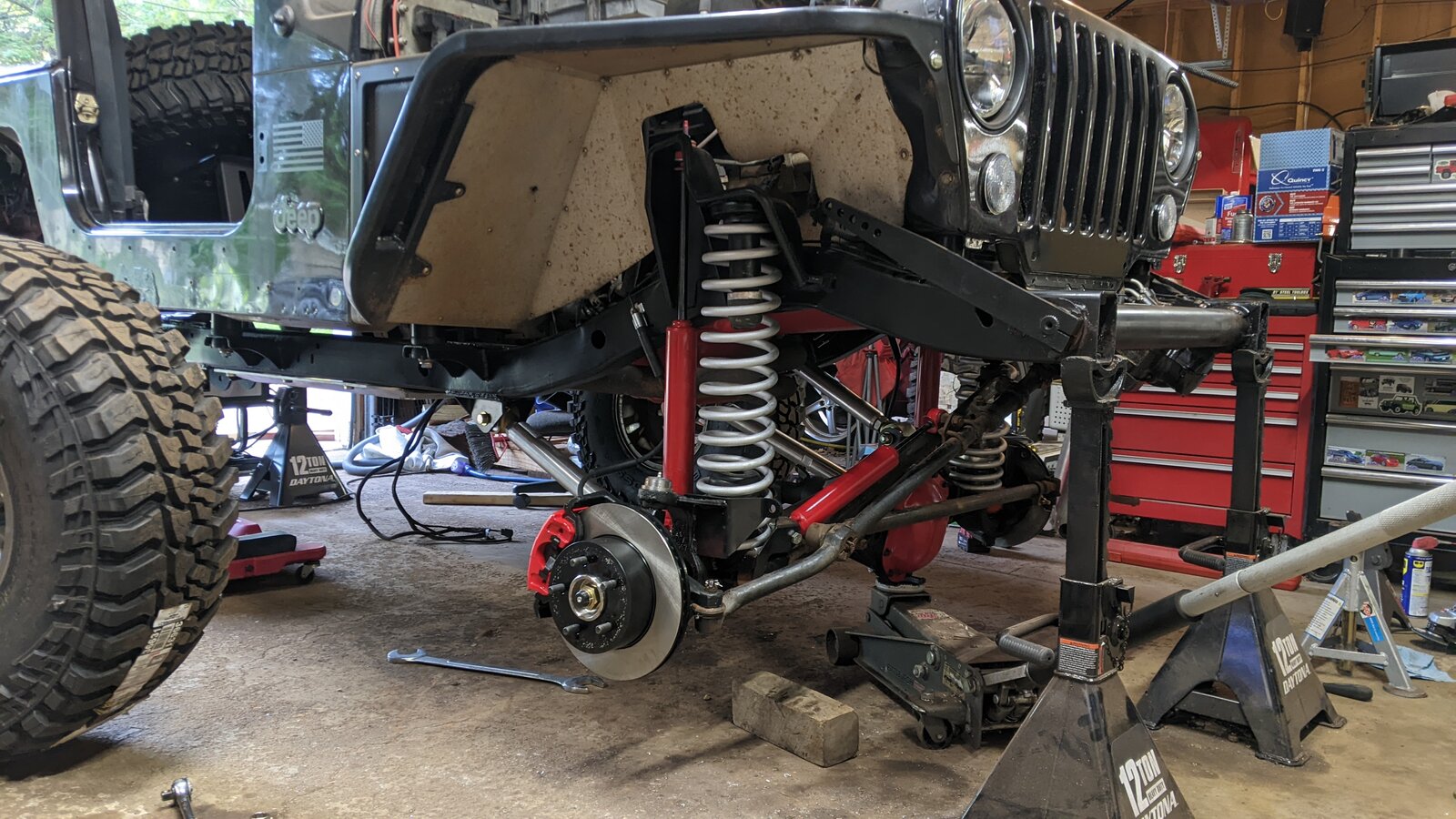

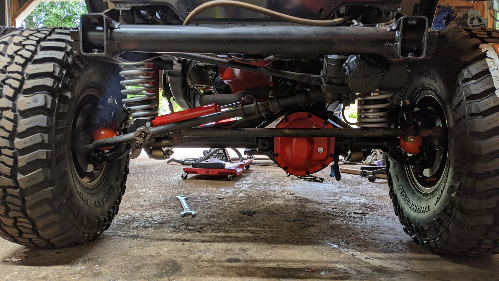

Finished assembling the front axle. Checked clearances. Had a lot of interference between steering stab and tie rod. Some different bolts and positioning of the axle took care of that. Front end finally back on its tires.

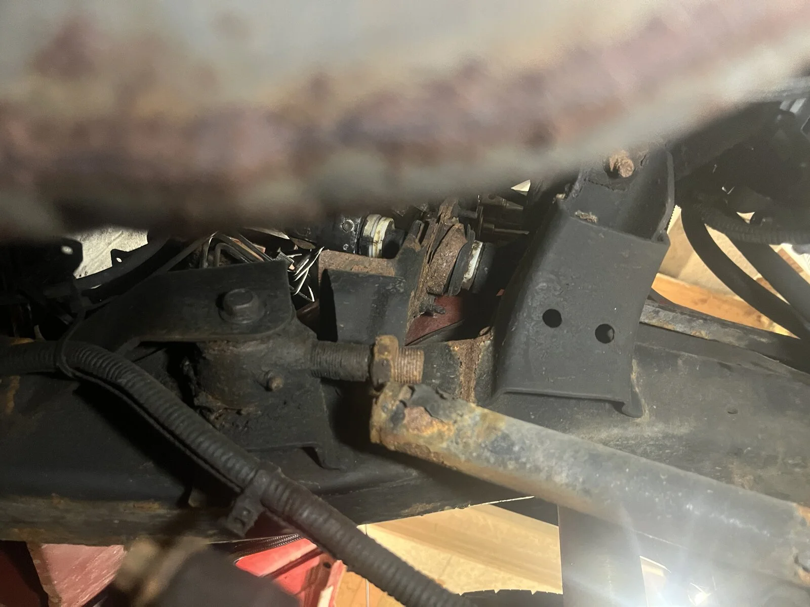

Was changing my starter today when I looked up saw this. No idea how long it’s been like that. Anybody know if it’s fixable or do I need a new upper control arm?
Take it off and clean it up, I might be fixable. You need to inspect the threads inside the tube and also see if the johnny (heim) joint sheared off inside the tube.
The upper joint should be fixed at the axle. I dont understand how the tube could have rotated to unthread itself unless those are turnbuckle style threads on both ends.
