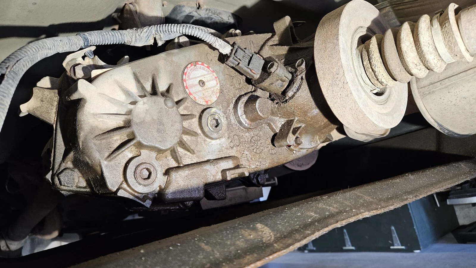

Noticed ATF leaking from the pinion gear adapter on my NP 231 transfer case the other day, so I removed the adapter clamp and found that the adapter was just rattling around in the housing. Likely an bad o-ring, ordered a new Mopar part (603709) off Amazon. It showed up this morning so I pulled the adapter and replaced the o-ring before I left for work. Easy fix. Looks good so far, no new leaks on the way to work, but I'll drive it around for a few days before I declare victory.
