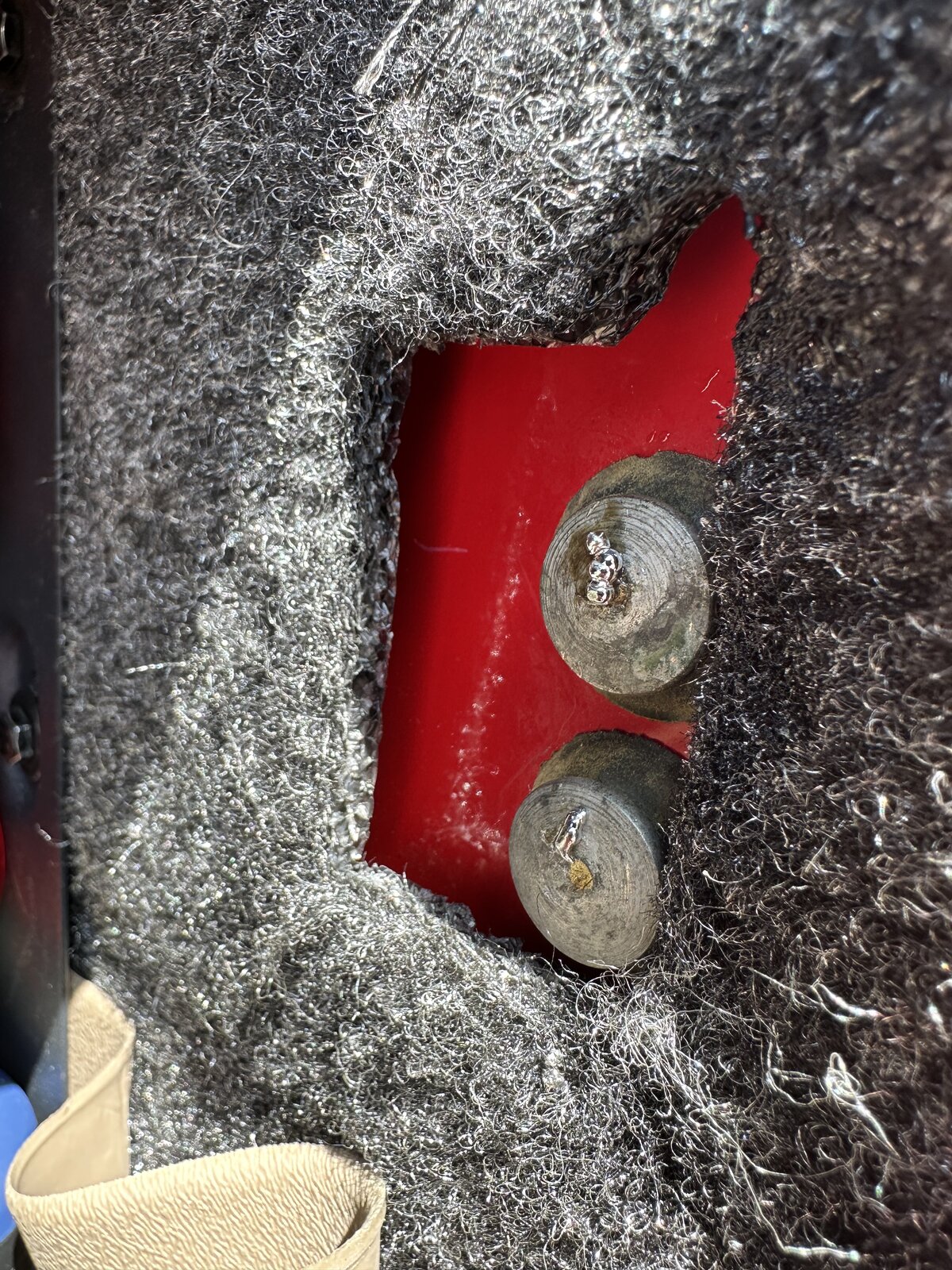

After an hour of trying to get my third brake light pins realigned after installing the Moryde hinges I said F’it and added two blobs of solder, works just fine now.
Since you brought it up, I have not had my 3rd brake light since installing my morryde thingy.

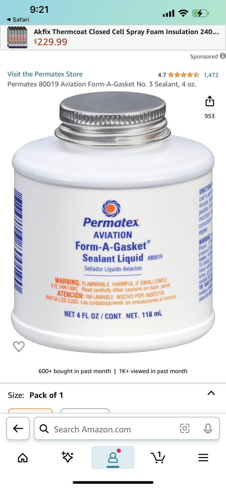

No leaks on the TC cover, after a few long drives and heat cycles!! And I cheated by only loosening the oil pan to fit the timing chain cover. I attribute it all to permatex #3 aviation form a gasket. Laid on a thin coat between TC cover gasket, bottom of the front of the pan lifting the felpro gasket up, and bottom of the TC cover. Waited 24 hours for it to cure and so far so good. Hope this can help others.
Since we all like pics, NFA and I don’t own stock in permatex 😂
