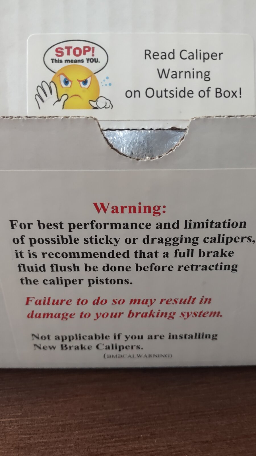

Did you read the instructions or just choose to ignore them?
I suspect ol' Boog's reacting to the part of your post that I highlighted with red bold text below:
I did the Day 1 break in period yesterday (2 cycles of 5-7 stops) and literally just got back from the Day 2 break in (1 cycle of 5-7 stops). With both days, I definitely heated up the brakes up enough because I was smelling the brakes, and saw a bit of dust/smoke coming from them as well (I did these cycles at 4am so the street lights were great for showing any kind of dust).
I actually need to flush out the entire brake system. I may end up doing that today after it has been sitting for 8 hours or so.
Mr. Blaine has stated many times over the years that there is something in the design of the TJ brake system that causes debris to be released when you push caliper pistons back beyond their normal operating range in order to re-install after putting new, full-thickness pads on. That's the warning Boog posted in his reply, and also the top warning in red on the pdf you posted above. If you're talking about the flush being the next thing to do, one would assume that you weren't aware of the need to flush before you push the pistons back...

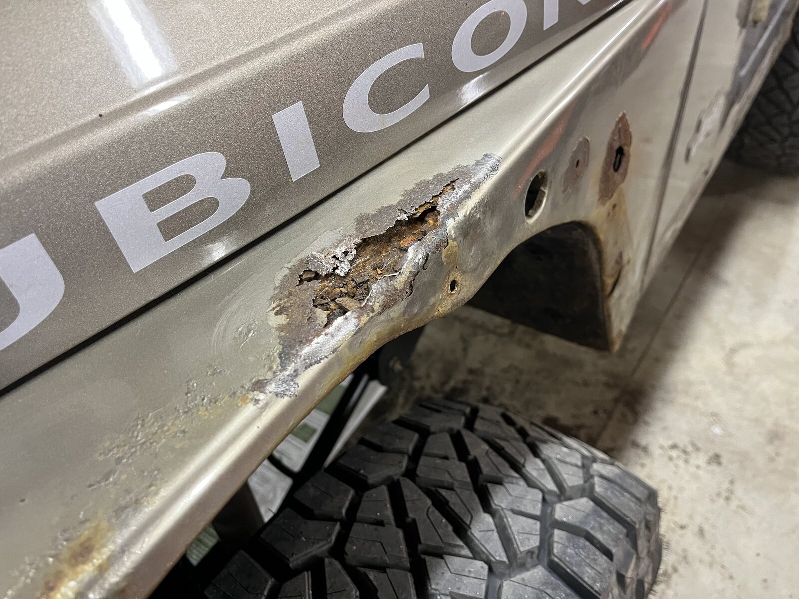

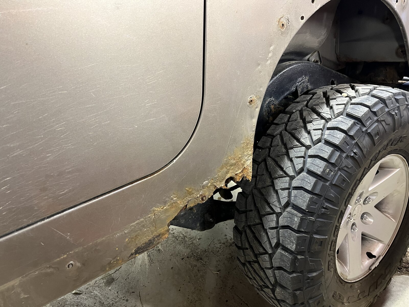

I took my TJ for its longest drive in a while - to the inspection station! It’s been off the road since early spring for a fender rust repair project and suspension upgrade. I was hoping to get it legal to drive for a couple months before winter.
No such luck! The guy pretty much laughed me out of there (nicely). He said I’d need the fender extensions mounted and to cover up the sharp metal edges (from grinding/cutting out rust spots) to pass. He said the suspension is looking good though! 😂
Then on the way home something smelled hot and I think the front passenger brake caliper is seized. So the list just got longer 😞.
Oh well - it was good to drive it for a little. Back in the barn until spring!
Here's one of Mr. Blaine's previous posts on the subject:
https://wranglertjforum.com/threads/doing-a-brake-job-must-read.2247/
I put on new calipers along with the new BMB pads and rotors. The warning on the box says that a brake system flush isn't needed with new calipers.
I am choosing to do a brake flush because the current brake fluid is old anyways.
