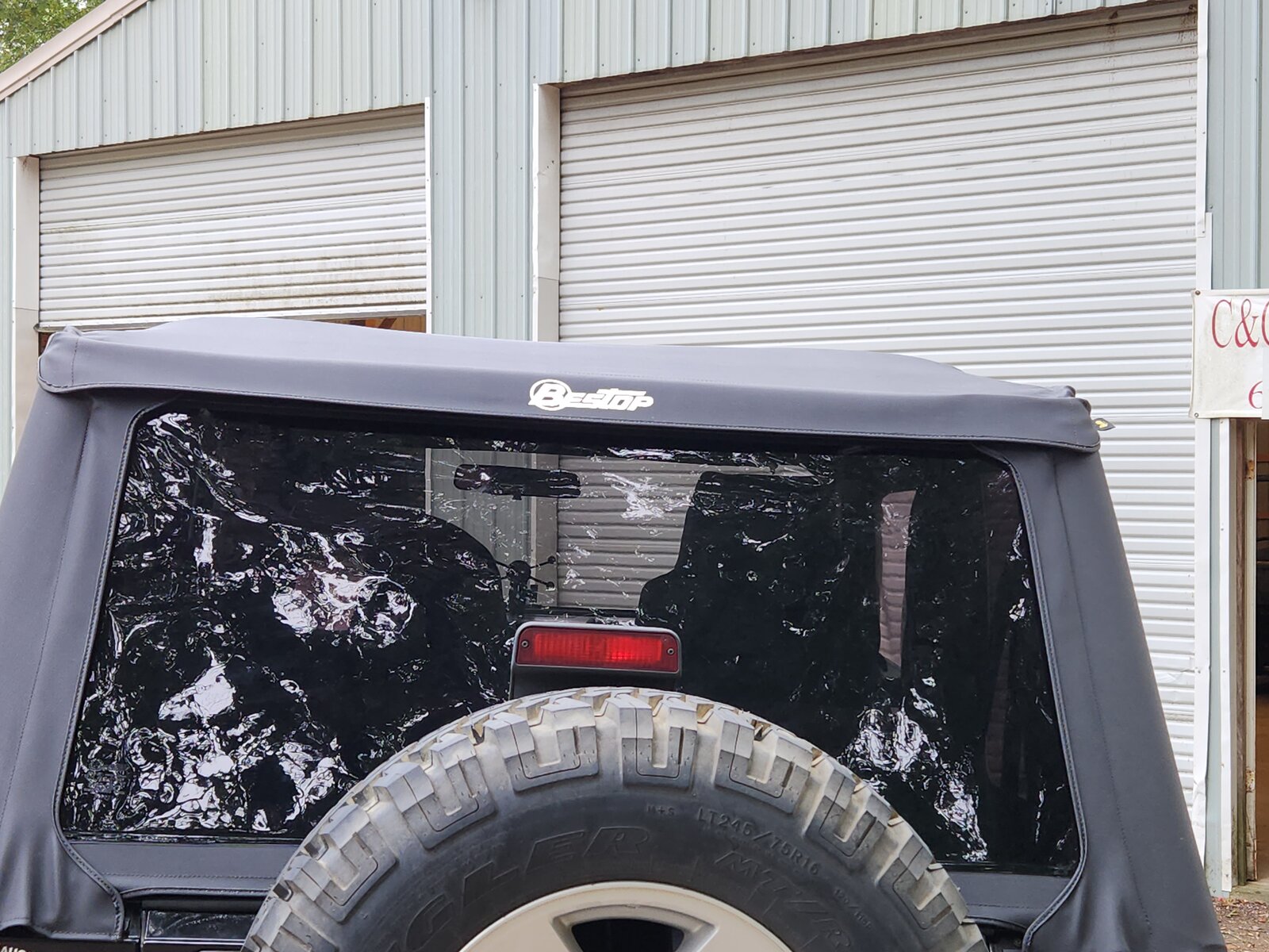

Got the Trektop NX put on. Yes I got the Trampstamp, but it's all good. Better than getting a duck!!!!

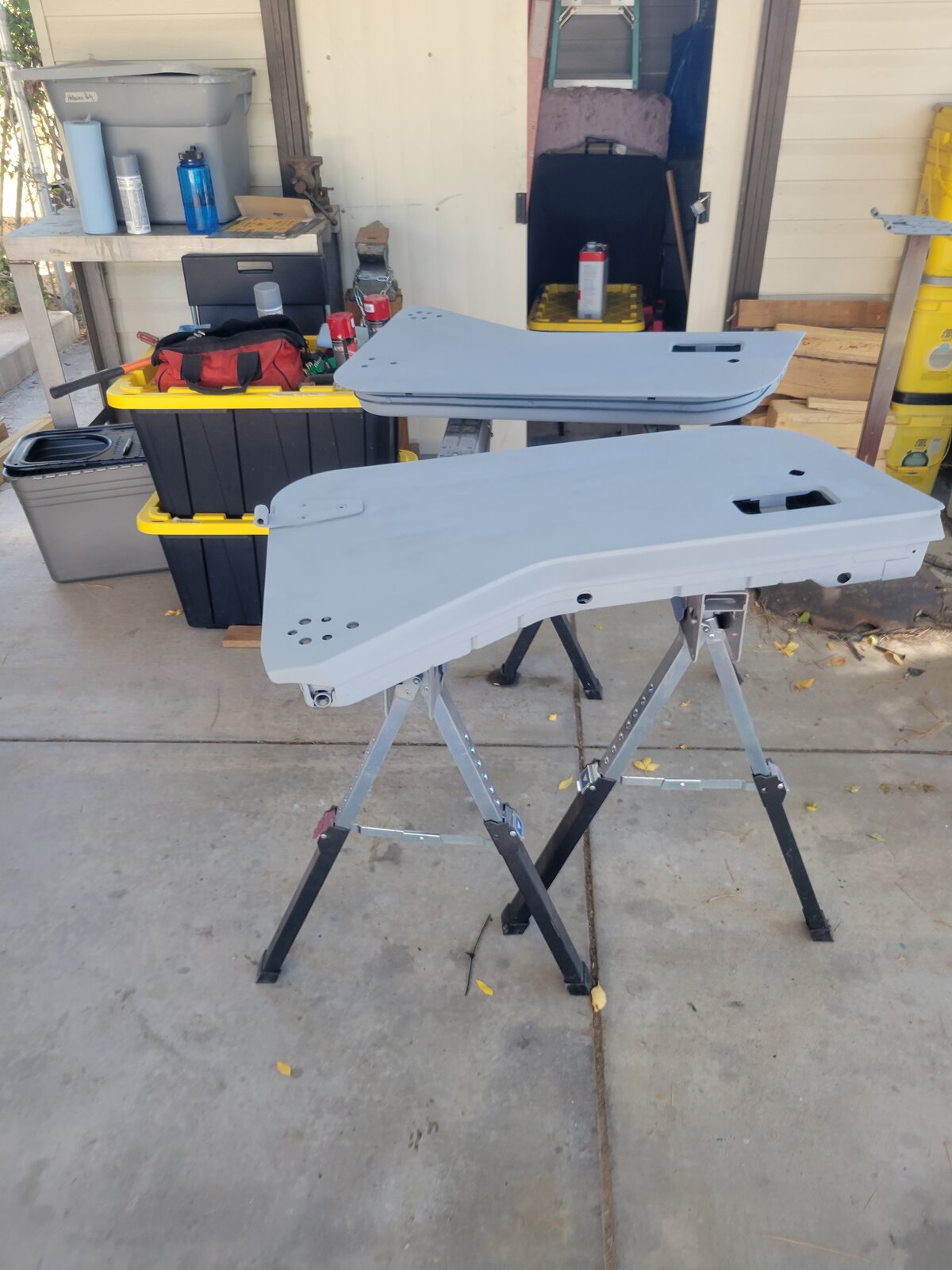

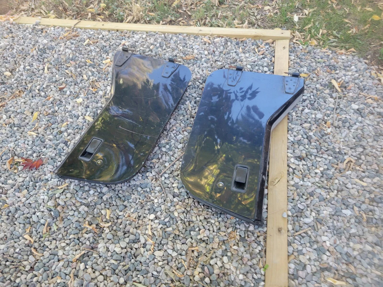

I looked it over, and bought a stock air box to replace the cold air intake that was on my Jeep when I bought it. I also bought a set of half doors that need some love, but the interior panels are in good shape and match my mist grey interior.

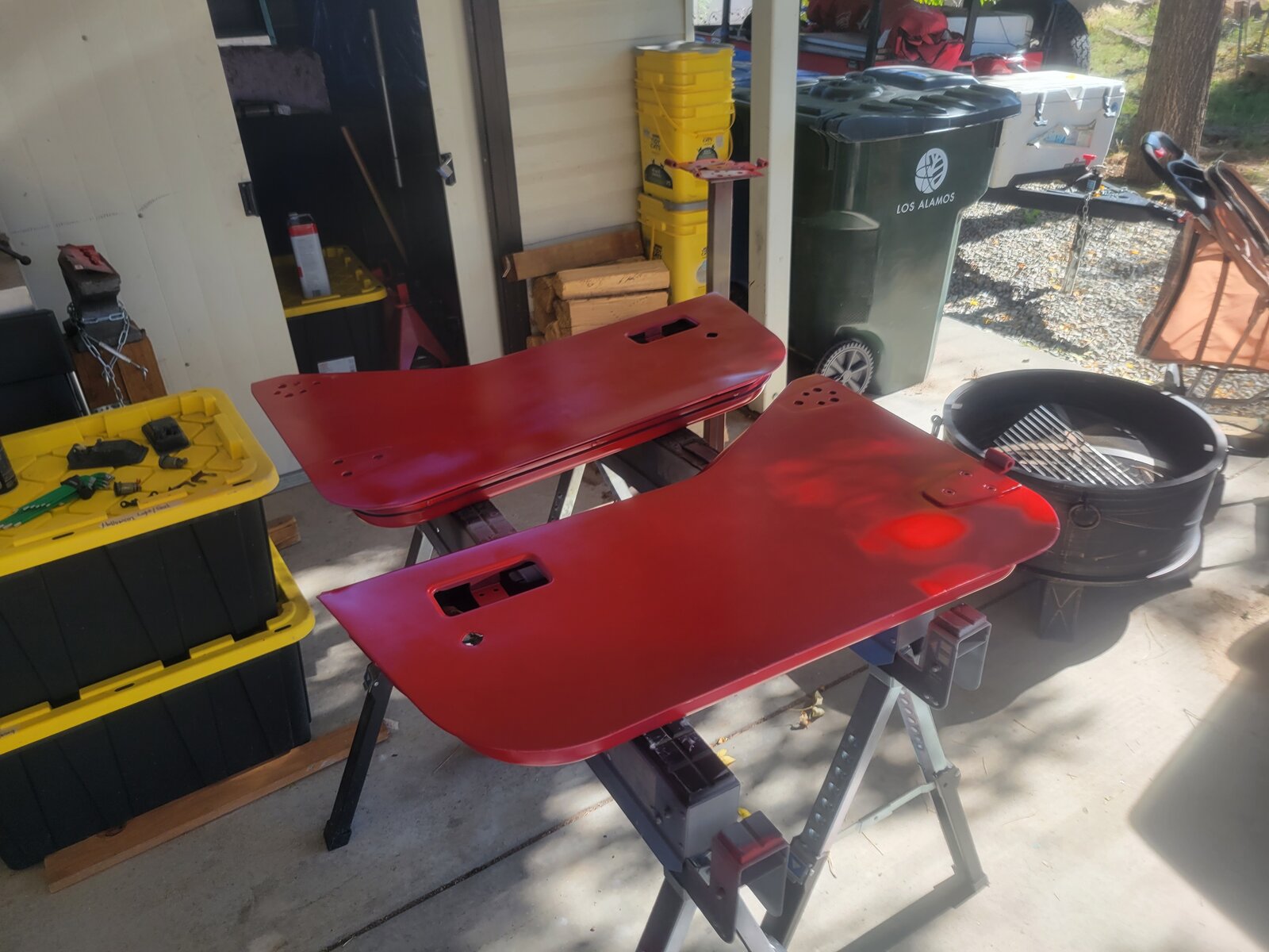

I gave the kid $400 for the doors and the intake, and we both walked away happy. I'm going to clean the doors up, shoot a coat of paint on em, and use them for trail doors. The air box? Already on the Jeep!😆

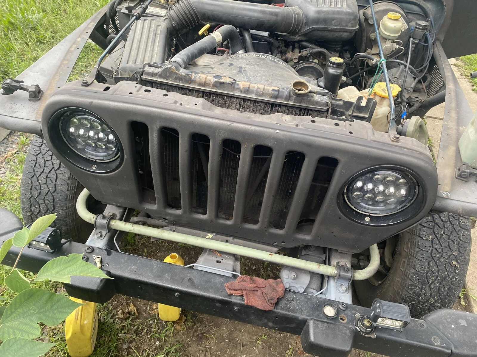

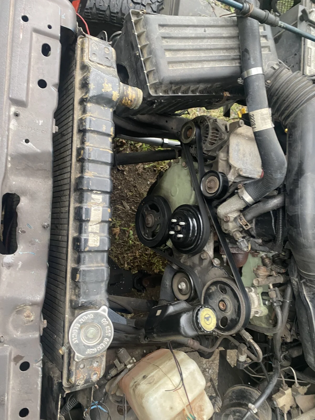

Radiator swap before I had to go to work tonight. The YJ radiator was almost identical besides two noticeable differences. The barb for the overflow reservoir hose was pointed 45* towards the grill as opposed to being parallel to the radiator like my original one and there were actual nuts welded onto the frame instead of just holes with U nuts. Thankfully I had some M8 x 1.25 bolts lying around and I just rigged the coolant reservoir hose up until Amazon delivers the hose I ordered to replace the now too short piece due to the different angles. Ran it up to operating temperature and everything is good. I hate to toss out a nice old brass radiator so I might look around and see if anyone local repairs them since they are hard to find anymore.
Might not be the case anymore, but recoring and repairing radiators used to be a thing. Though thinking about it some, I can't recall the last time I saw a sign for a radiator shop....:unsure:
