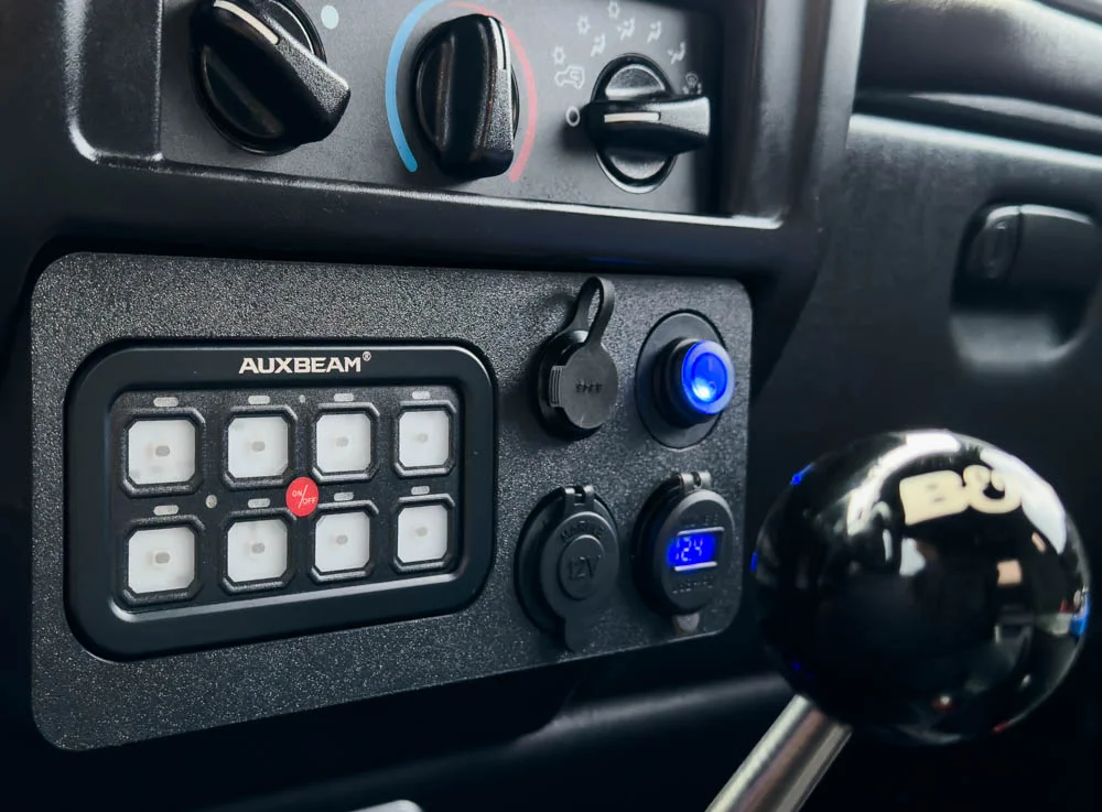

I've been working on the center stack. Moved the Auxbeam switch panel up from on the center console to a custom insert that has a new auto dimming switch panel, an RJ45 for the Midland GMRS, a standard cig lighter port, a dual USB A & USB C charging port with voltage display and an on/off switch for all the above.

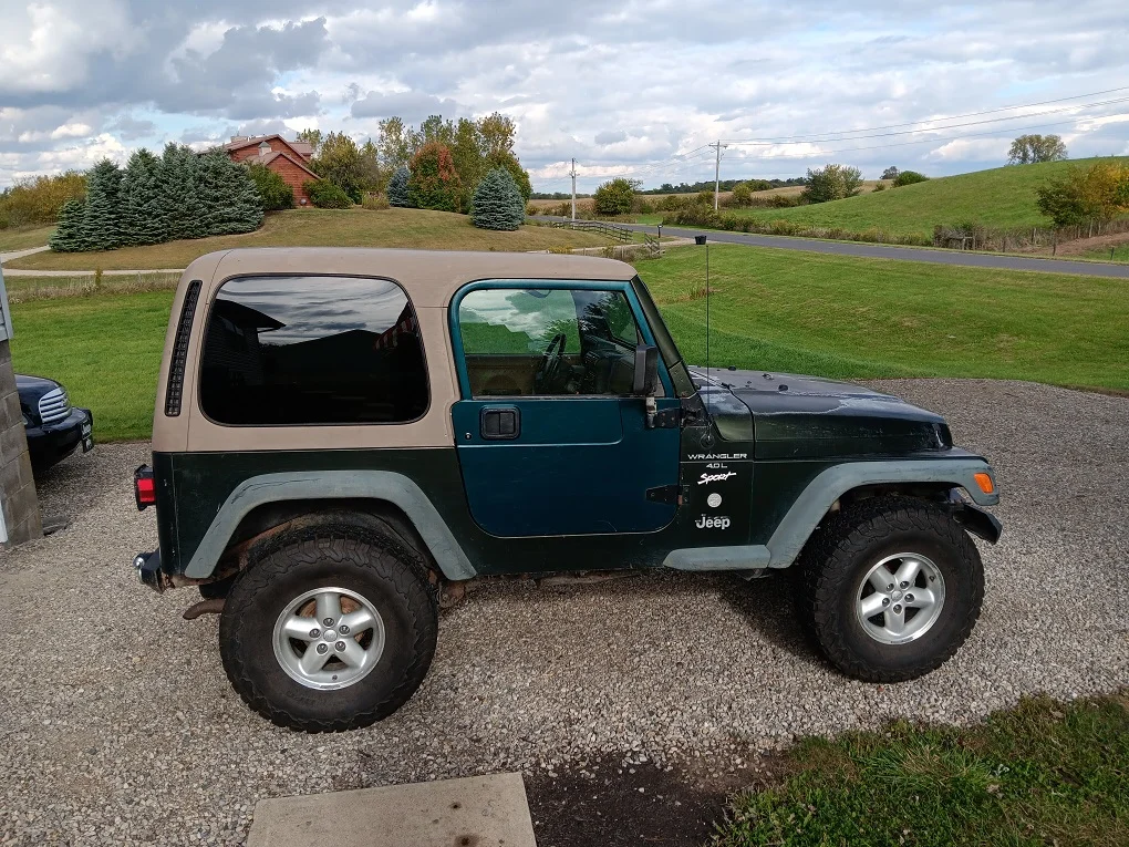

Should probably wash it so the rest of the Jeep matches the doors in cleanliness. Or Not....
Well, yesterday I drove to my sister's house and went thru the car wash in her neighborhood. it all matches now in cleanliness, Now I need some rain to make some mud so I can be comfortable driving it....

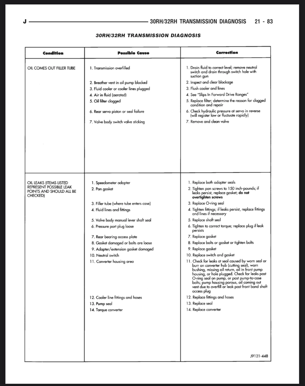

Yep, the transmission is definitely still leaking.
Any tips on how to track down a transmission leak on a 32RH transmission?
Complete shot in the dark here, but I had a leak on my F150 years ago. After days of aggravation, I finally discovered that the dip stick tube seal was missing and the tube wasn't fully seated. Replaced the seal and reseated the tube, and no more problems.
Mine was only a very small leak, which made it much harder to track down.
Reactions: Kiwi TJ
If it’s all dirty, clean it up, put down a piece of relatively clean cardboard or something. Check it frequently and look for signs of leaks. Should be easier to spot if everything is somewhat clean. If it’s leaking fast enough that you don’t see it when it in the beginning stages of leaking, the cardboard will catch it and give you an idea of the area you need to look in.
Obviously the cardboard is optional. The garage floor will tell you the same, but it may help keep your floor cleaner.
If it’s all dirty, clean it up, put down a piece of relatively clean cardboard or something. Check it frequently and look for signs of leaks. Should be easier to spot if everything is somewhat clean. If it’s leaking fast enough that you don’t see it when it in the beginning stages of leaking, the cardboard will catch t and give you an idea of the area you need to look in.
I’m going to drive it a few more days while it is warm. Once it gets cold, I’ll take the skid plate off, let it sit for a week, and see where it is dripping from. The skit plate is redirecting the fluid so I can’t get a good idea of where the leak is coming from.
chased a leak for ages. finally put it on the lift with someone in it. had them shift through the gears finally got it figured out to the shift shaft seal but the way it leaked it made it look like the pan. crappy seal to replace in frame but is doable.
Good idea.
Remember, the skid plate is the crossmember for the transmission mount. Don’t just remove the skid and let the trans hang there. Put a jack stand under it to support it.
Good idea.
I’ve done this enough times now that I can get the trans supported and skid plate off in about 10 minutes now.
the skid plate threw me off on where it was leaking. per the drops i kept looking on passenger side thinking it was the dipstick or corner of the trans pan
