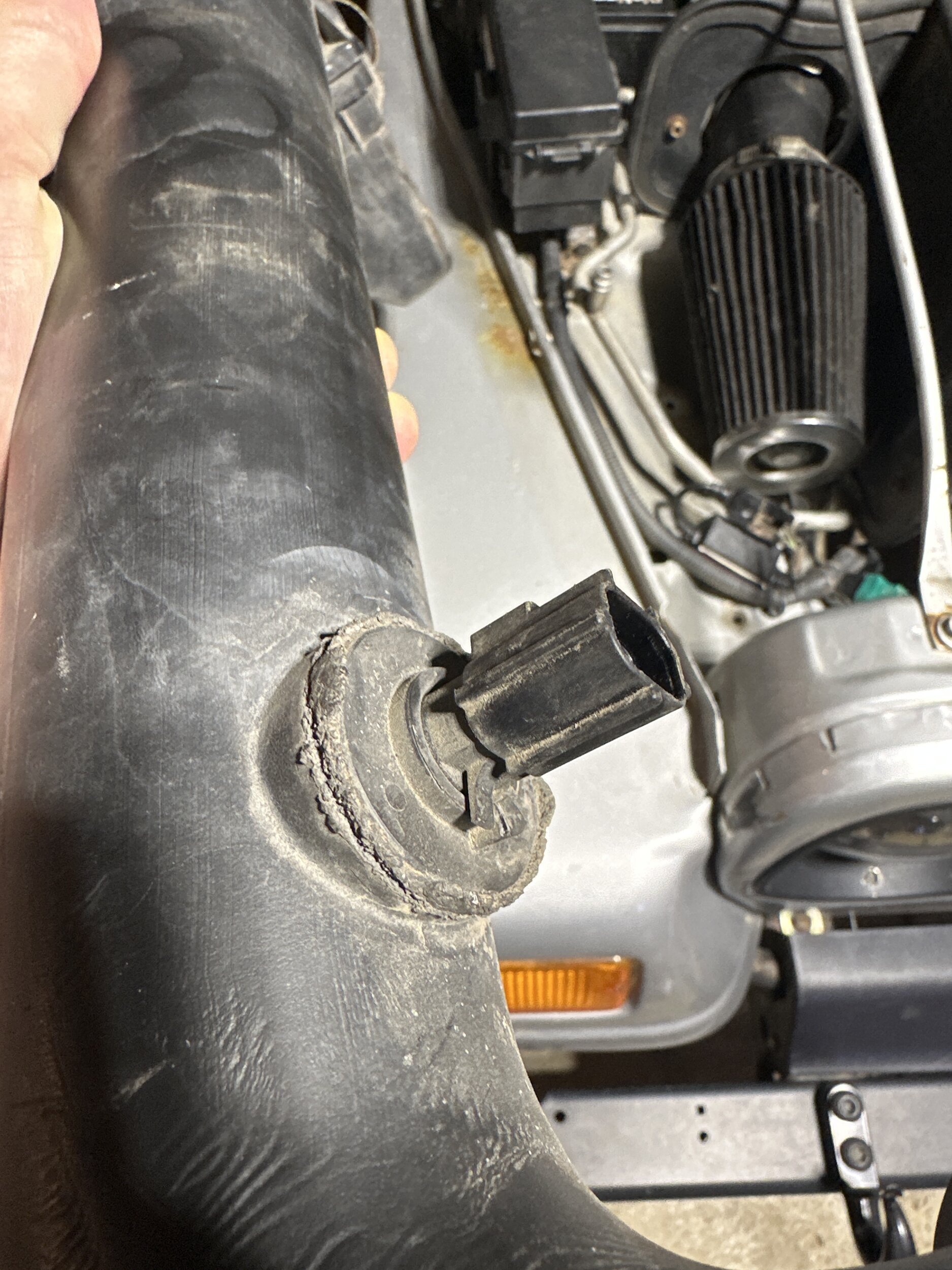

Snagged the K and N intake off our parts 99. Any idea how I can add in the IAT sensor? I was thinking drilling a hole and using a grommet.

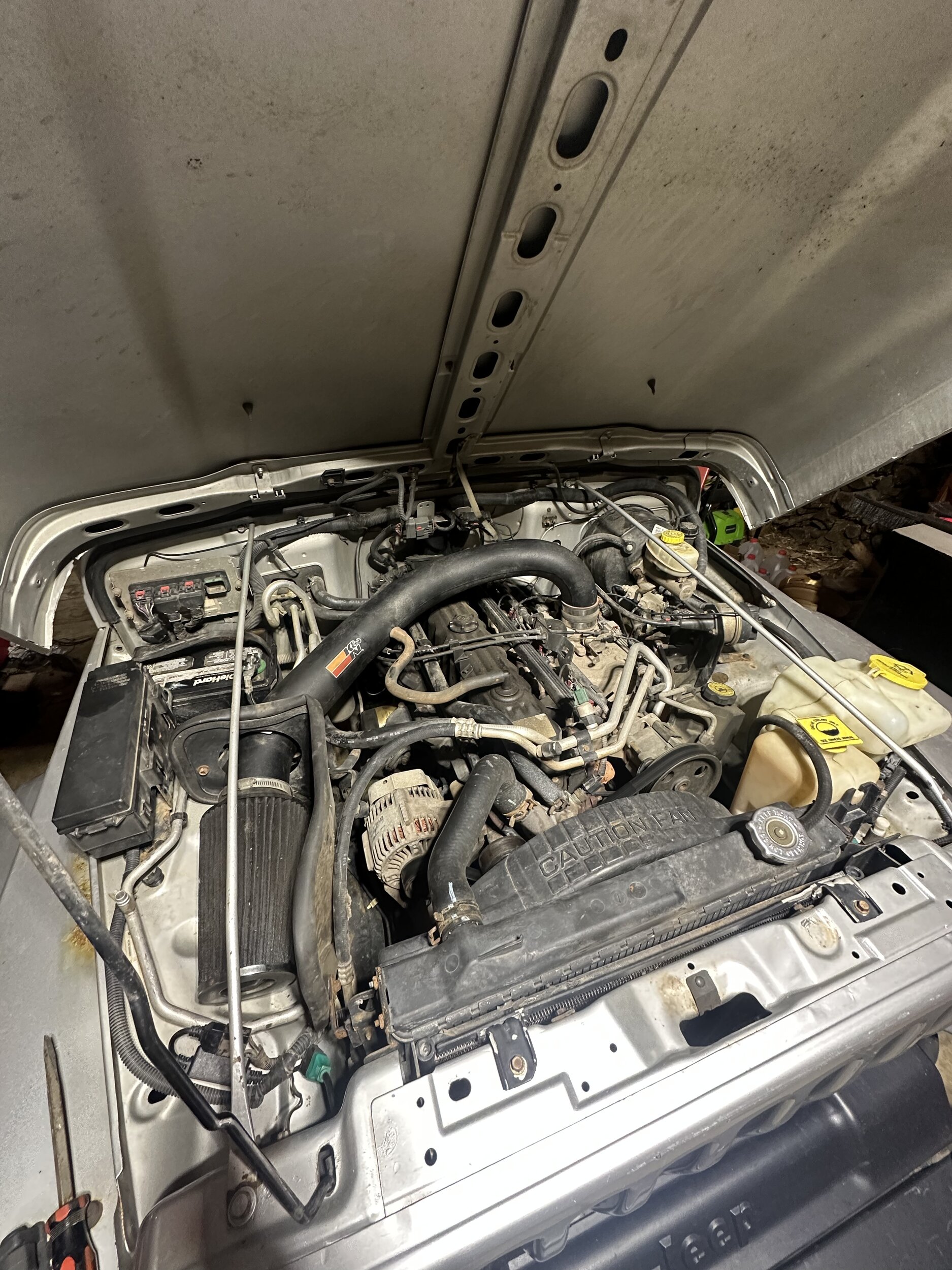

Drill a hole, move rubber grommet from the original tube to the new tube, mind the wire length to determine where to drill the hole if that makes sense.
edit: adding a picture when I was working on my set-up. yu Can zoom in and see with a stepper bit it is quick work.

Would you try to cut the plastic support as well and JB weld it on the other? Or purely just a hole and grommet?

see The photo I added to previous text. I did away with the locking ring altogether. I ordered A Amazon air tube and it came with the grommet- just need to run to a parts store for a pvc valve grommet that fits the OD of the air sensor- drill an appropriate sized hole to accommodate that grommet.
