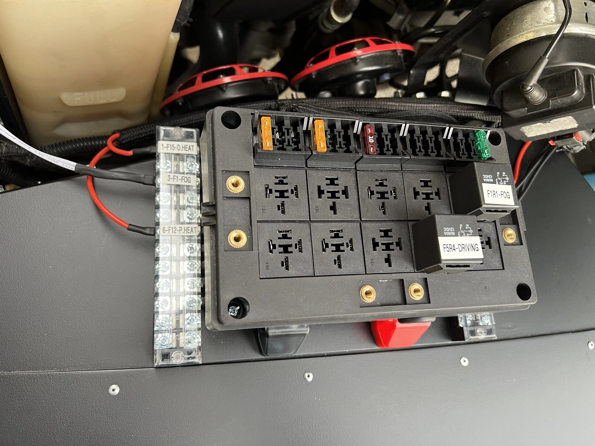

Installed the Baja Designs S1 wide cornering LEDs on some cheap Amazon clamps and positioned them on the tire carrier. Wiring them in was super simple since I spent so much time organizing the aux power box.

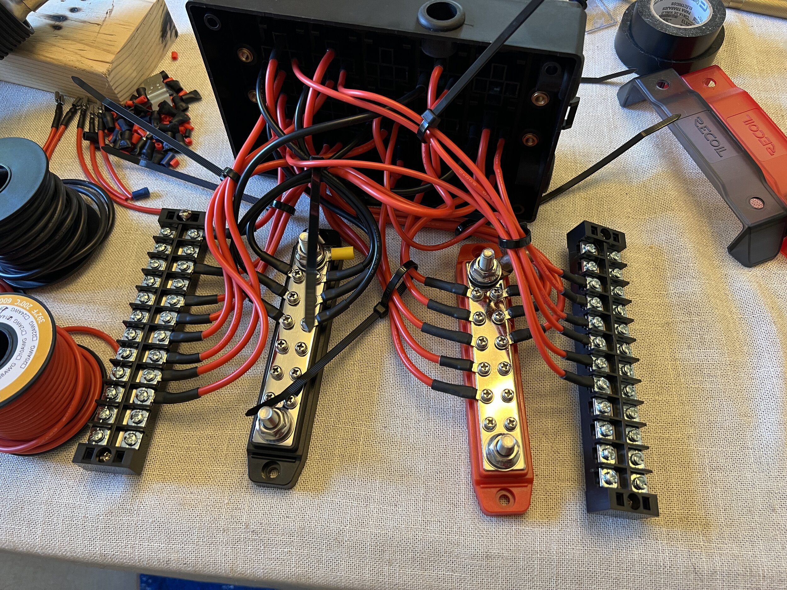

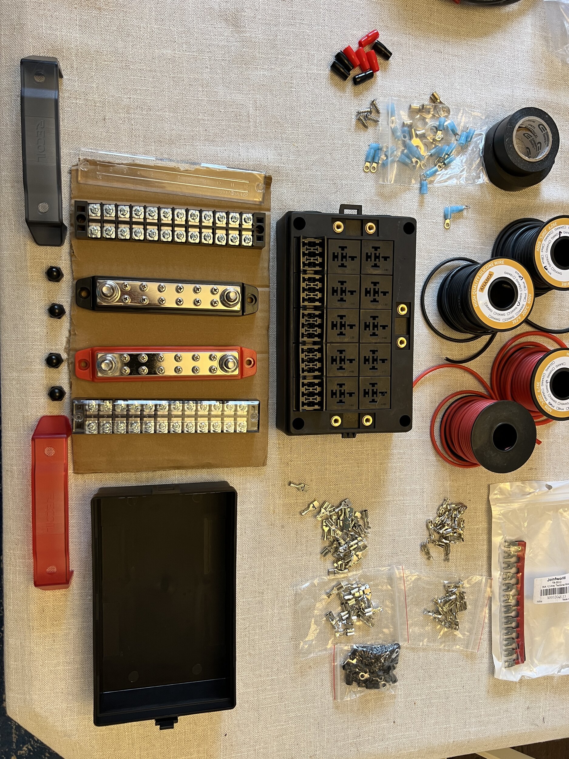

What relay setup is that?
I pieced it together from this Amazon relay/fuse box: https://www.amazon.com/dp/B0BYWVNJX5?tag=wranglerorg-20
I really like how it came out:
img_7018-jpeg.498940

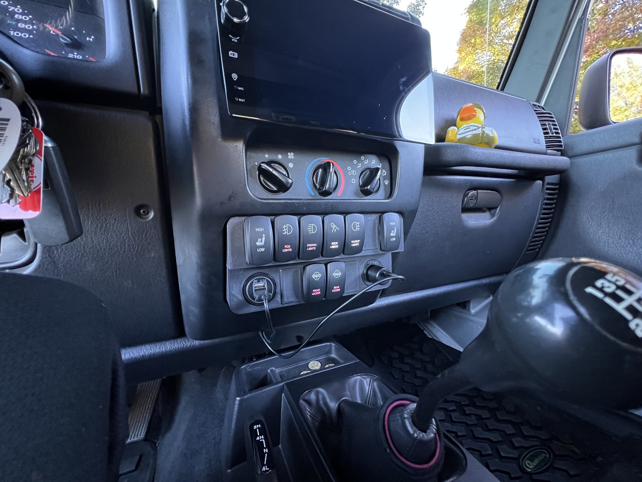

I teamed it up with a Custom3DFab switch panel. It came out rock solid and way cheaper than an sPod or the like, all with reliable Carling switches and 14/12 awg wiring throughout. Took a while to plan, assemble, and install but very worth it.
