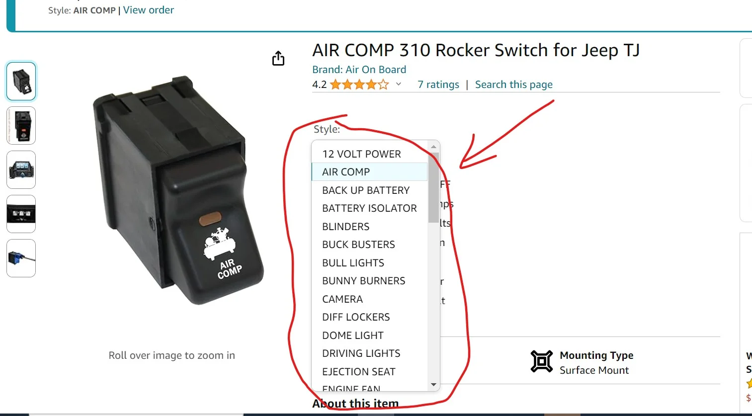

Where do you order your toggles from?
Amazon, you can choose different applications

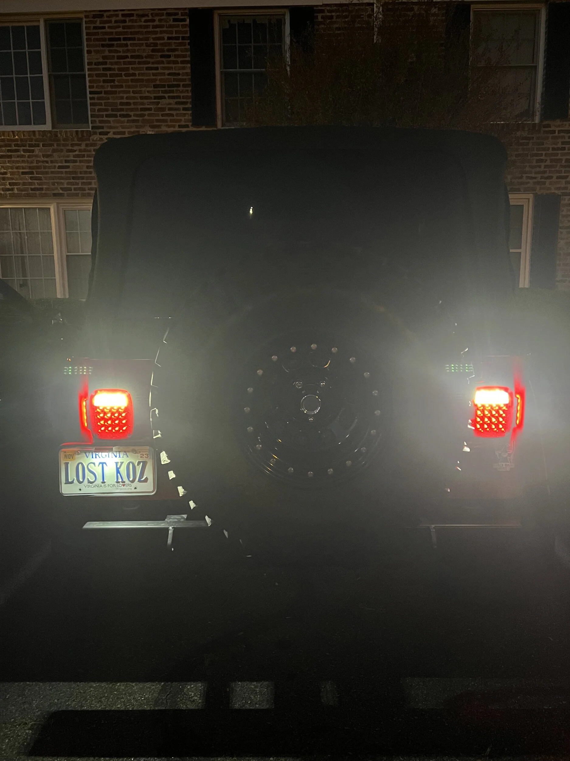

While I have 33s on the Jeep, the spare tire is still stock size. I know it is worthless essentially. I am going to get new tires this year and I will put on a full size spare. In order to get ready for the full size spare, what should I do? I've heard good things about MORryde tailgate reinforcement kit JP54-022. Is there anything else I should know about for reinforcing the tailgate and getting everything set up for a full size 33" spare tire?
I’m sure others will chime in on do you need to with 33s @TheBoogieman will post his weld on bumper bracket. But if you do….

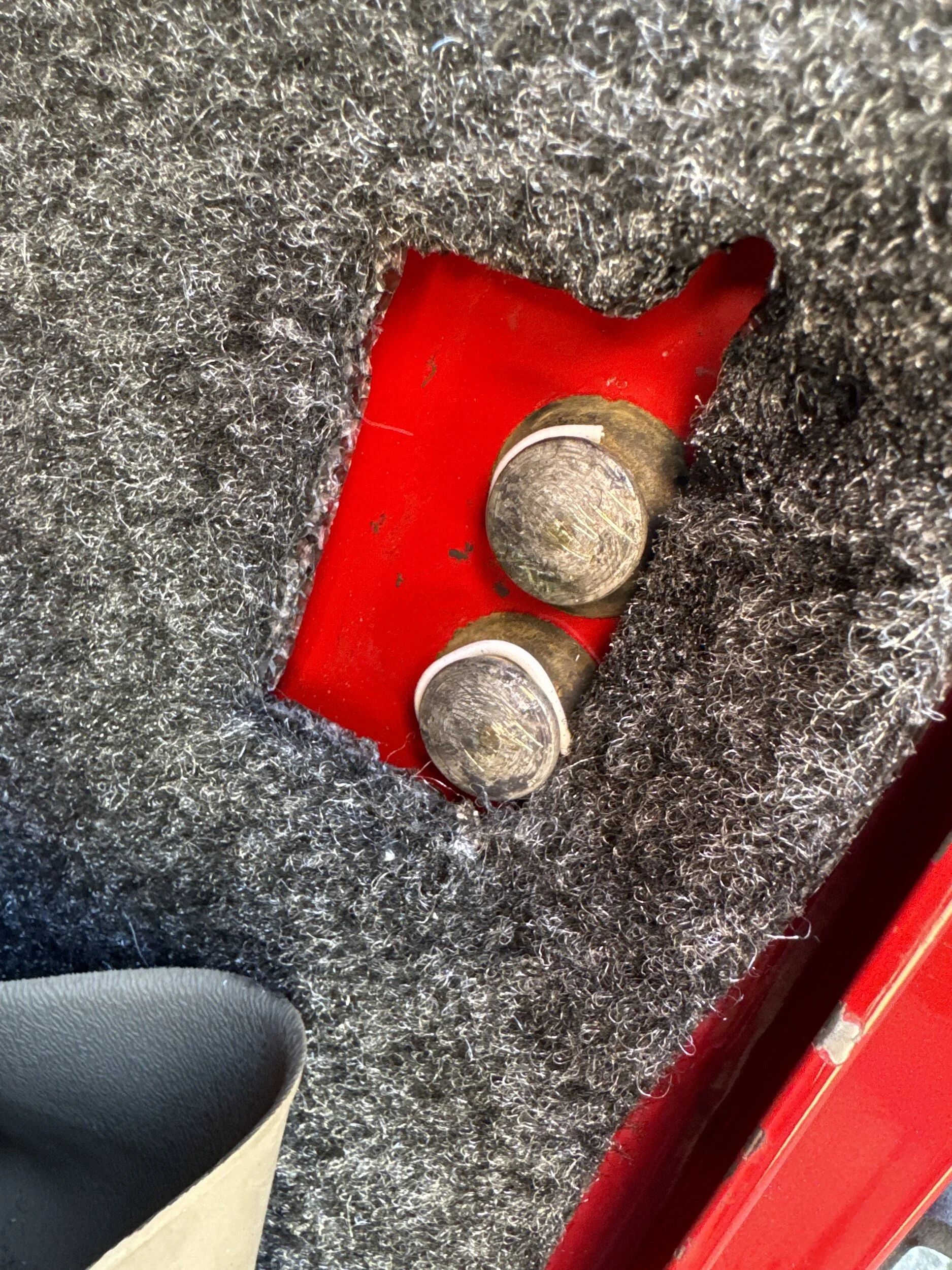

1) if you go MorRyde route, start soaking the hinge bolts now. Even with my rust free jeep, I needed a chisel to get two of them out
2) do one hinge at a time, otherwise realignment is a major PITA
3) rear brake contact sensor will get out of alignment since the new hinges change the angle. My stupid simple solution after way too much time wasted was to do a wrap of wire around the tub side pins to pop them out more.
4) extend the snubbers (lots of threads)
5) raise the 3rd brake light, lots of DIY options but I was lazy and got this for $25
