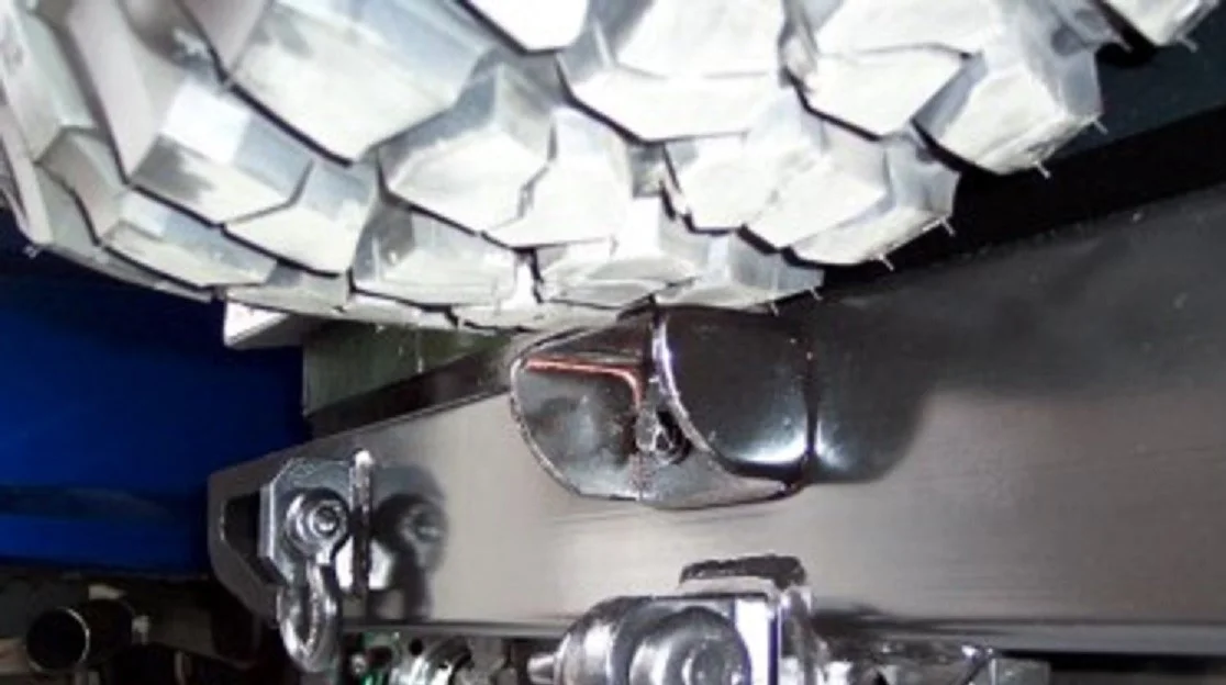

Weight has little to no bearing on the durability of the stock tire carrier and tail gate. A stock size tire will destroy both of them in short order if you remove the rubber bumpers and allow the tire to bounce around. I put a 35" tire on Kat's 01 in 01 and the carrier and tailgate worked exactly as new when I removed the carrier and replaced it with the Exogate a couple of years ago. I replaced it because I could, not because I had to.
The key is two fold. First as Jerry showed, the edge of the tire should just slightly jump up on the top of the bumper when you slam the gate and the rubber bumpers need to be slightly compressed into the sidewall when you tighten down the lug nuts when you bolt the tire to the carrier.
To further that, a friend brought me his Exogate to repair because he failed to space the bumpers out correctly and the mount flanges were broken and about to fail and it only took a few hundred miles of driving to do it. The tire simply can NOT bounce around back there so one must do whatever it takes to prevent that.
