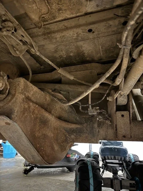

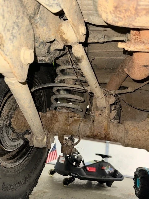

Ok, I know this question is going to make me sound like an idiot but that's never stopped me from asking before. Mainly just want to see if I'm missing the obvious.
Does my jeep not have a rear sway bar?

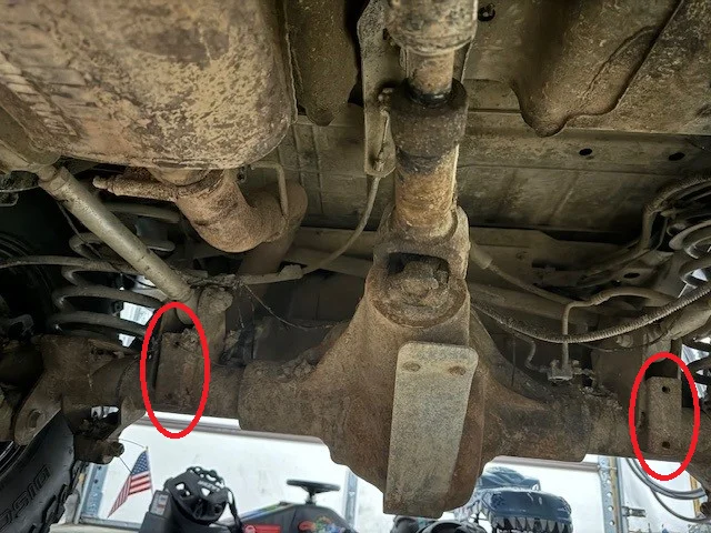

I'm away from my Jeep now, so I can't go look, but from what I remember, these are the stock mounting holes for the sway bar bushings in the rear, so you definitely don't have a sway bar that uses the stock mounting points (I don't see any other evidence of a sway bar in the other pics, either):
Correct, this is a Currie 60 that appears to have built in compatibility with the factory sway bar. My guess is the previous owner chose to not use one.

If you had a stock swaybar it would have to be flipped over and run under the dif, so no you don't have one. You'd see if you had an anti-rock, which I don't see tabs for.
