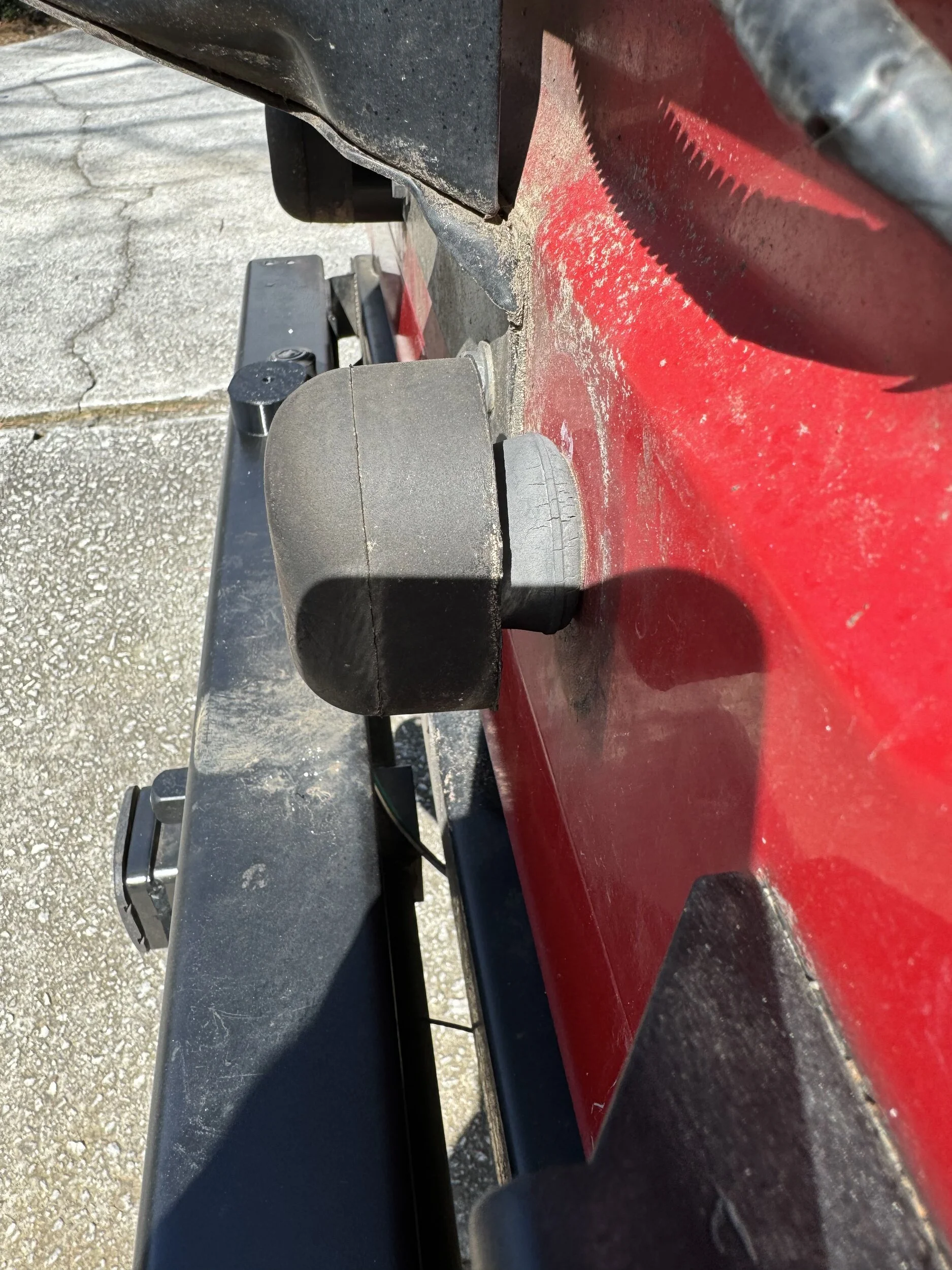

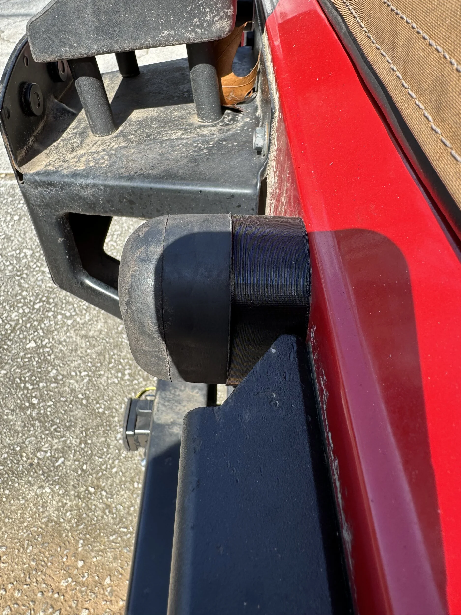

Thanks to @gbirk for the file and @SSTJ for maintaining the list. I got my new 3d printed snubbers installed. Looks much better than my DIY PVC and cane feet setup.
