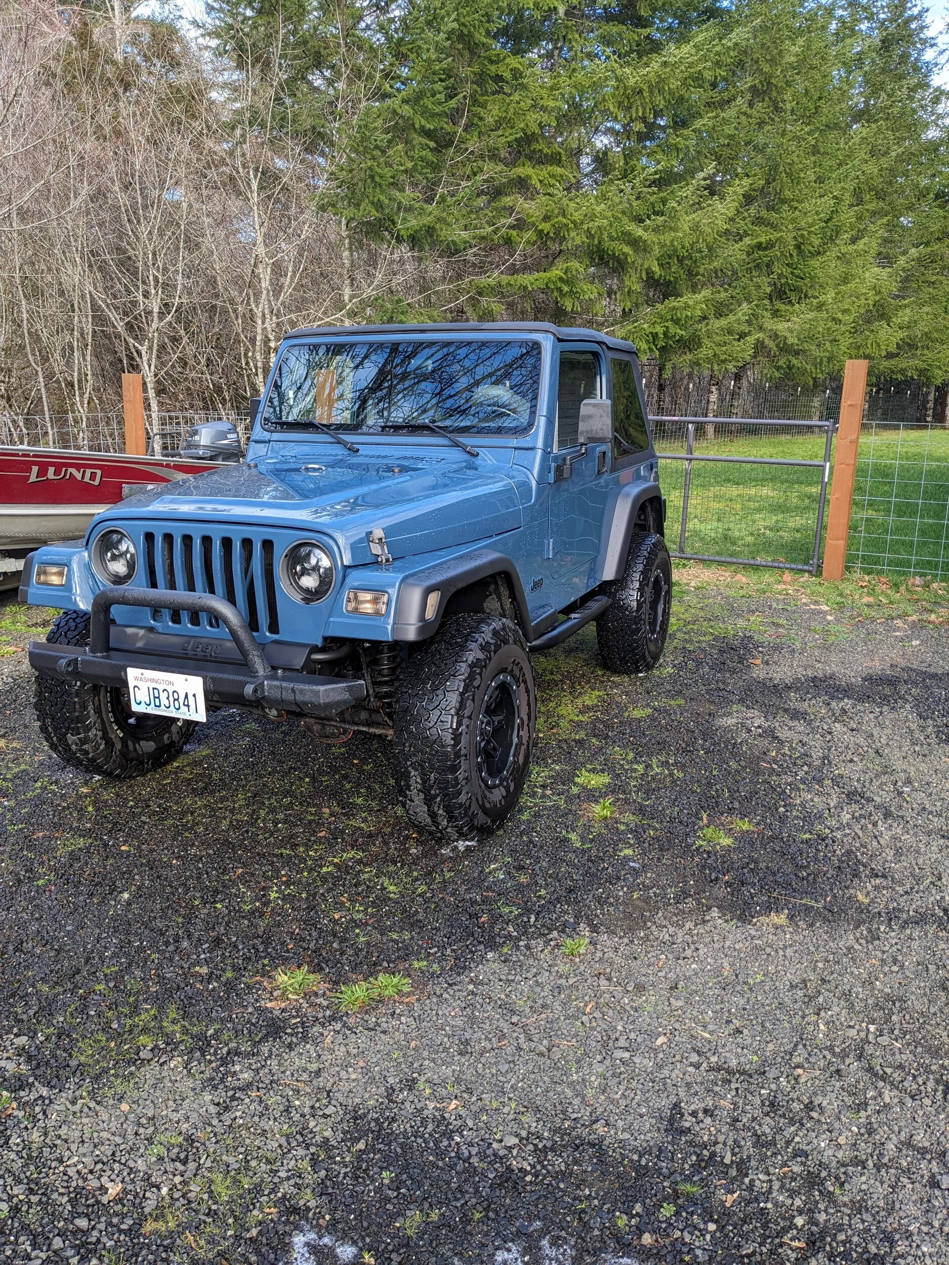

Cleaned it after the muddy trails earlier.

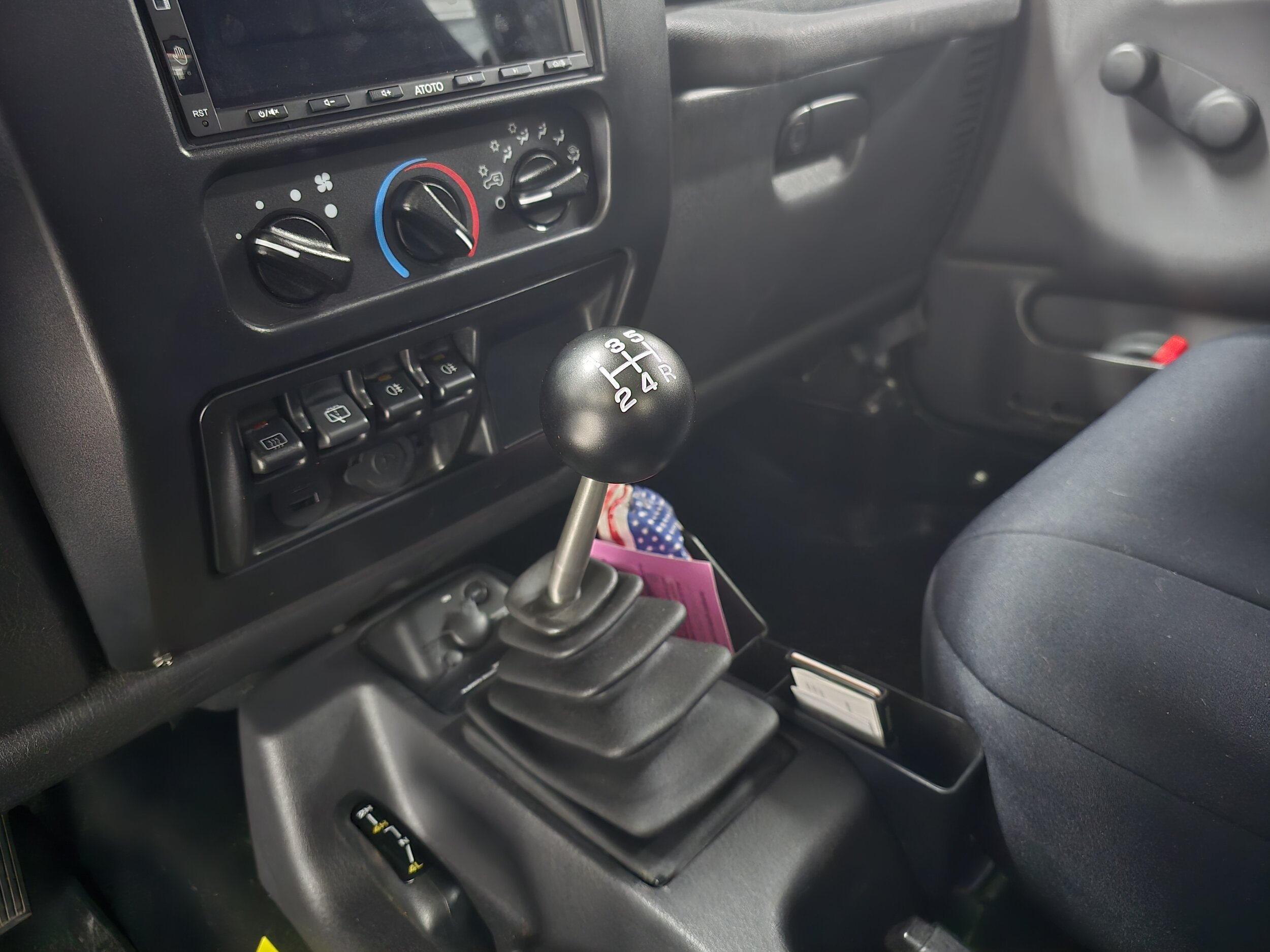

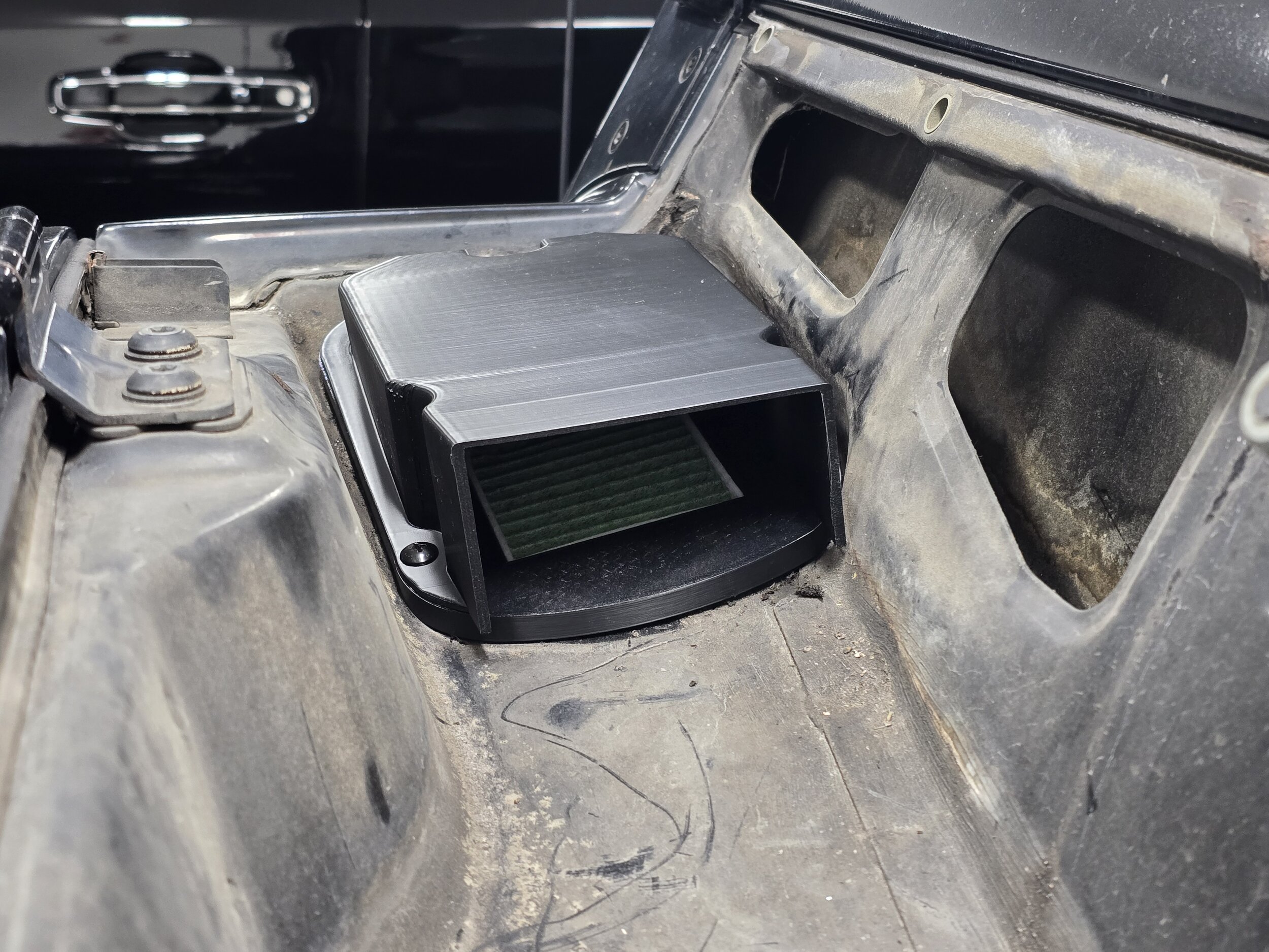

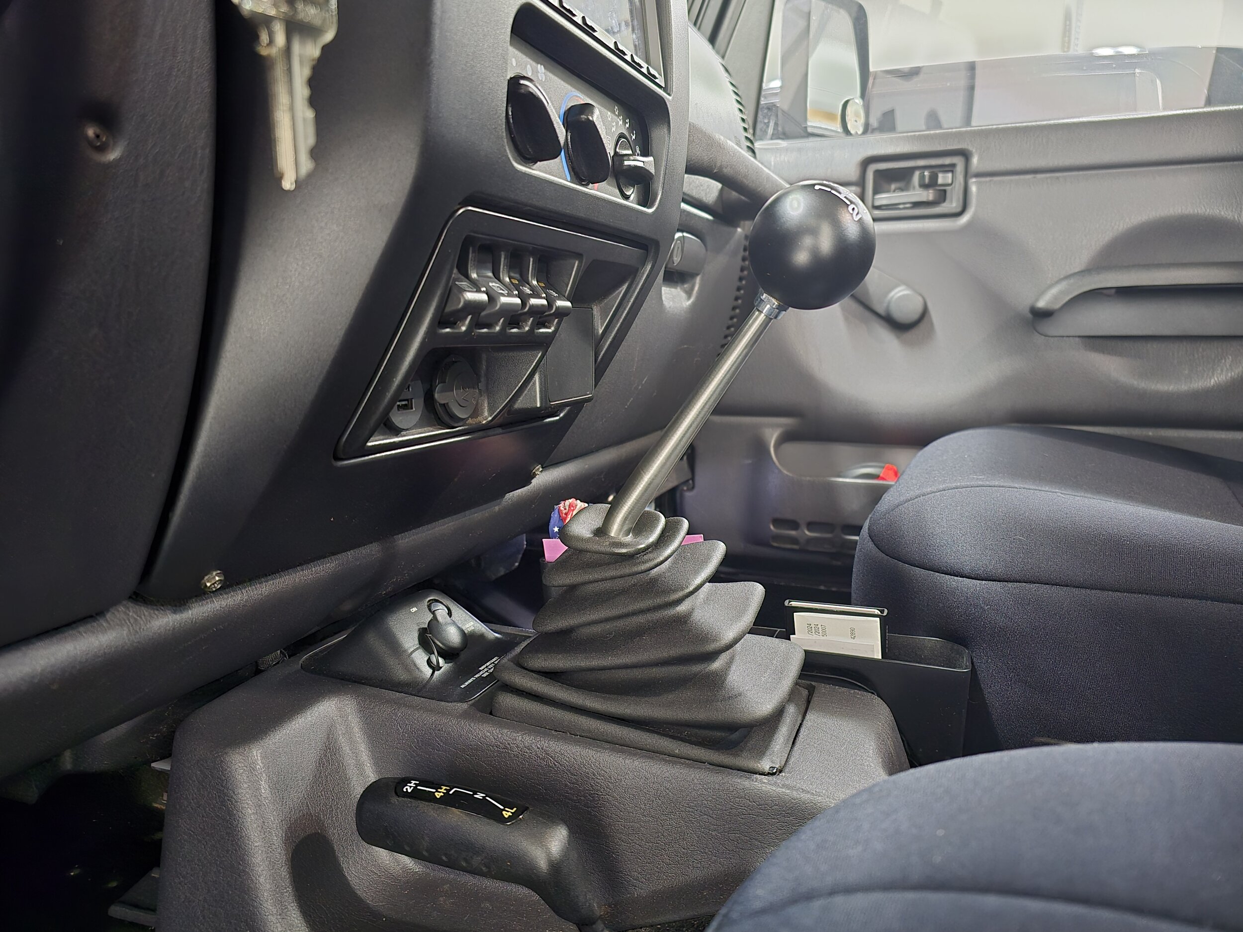

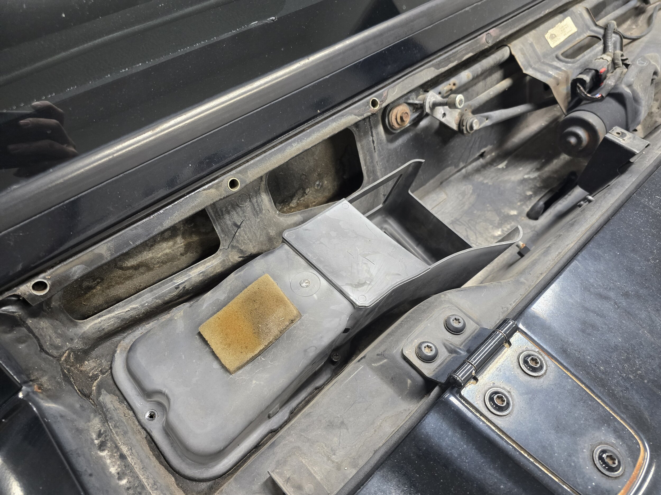

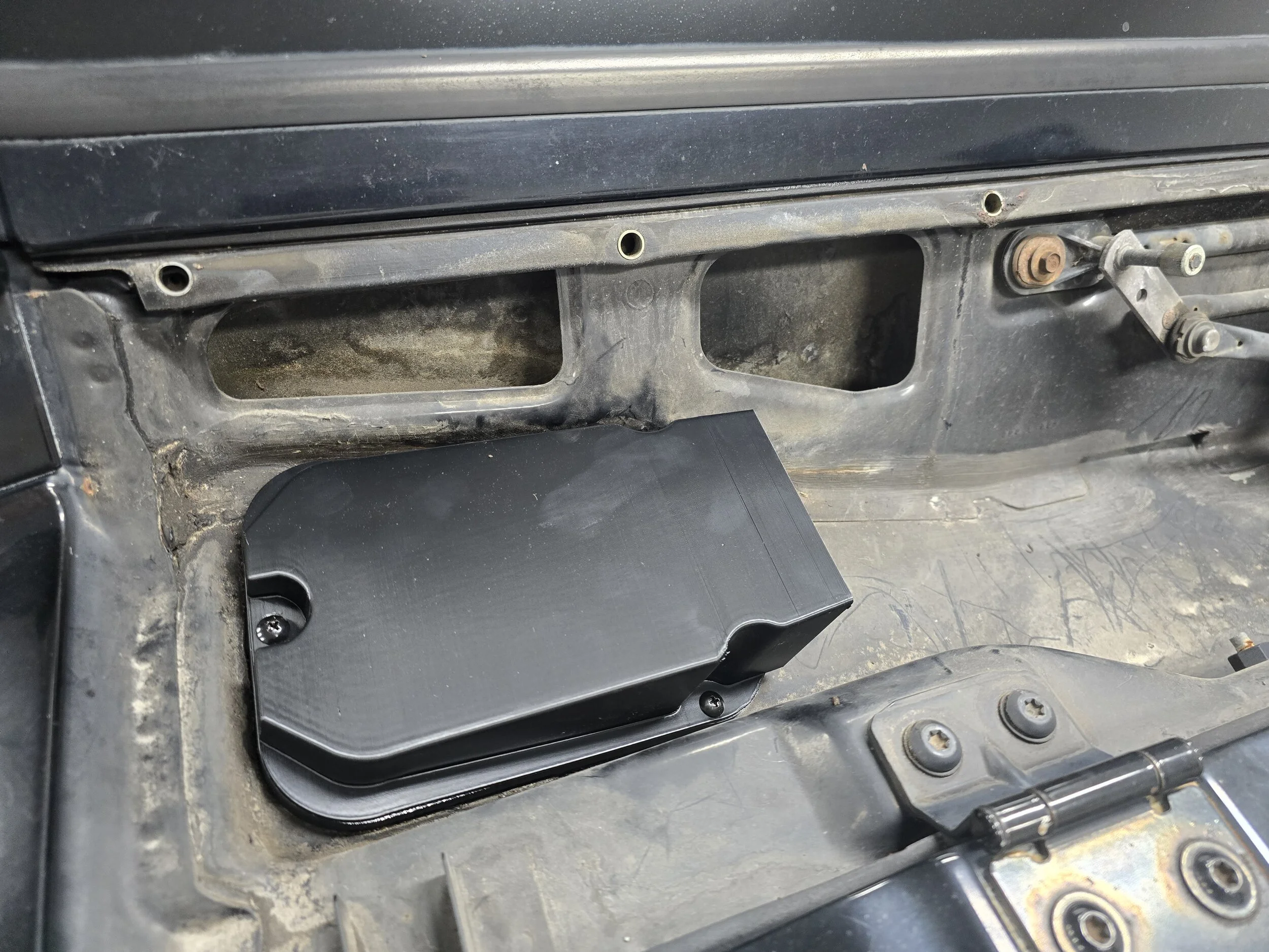

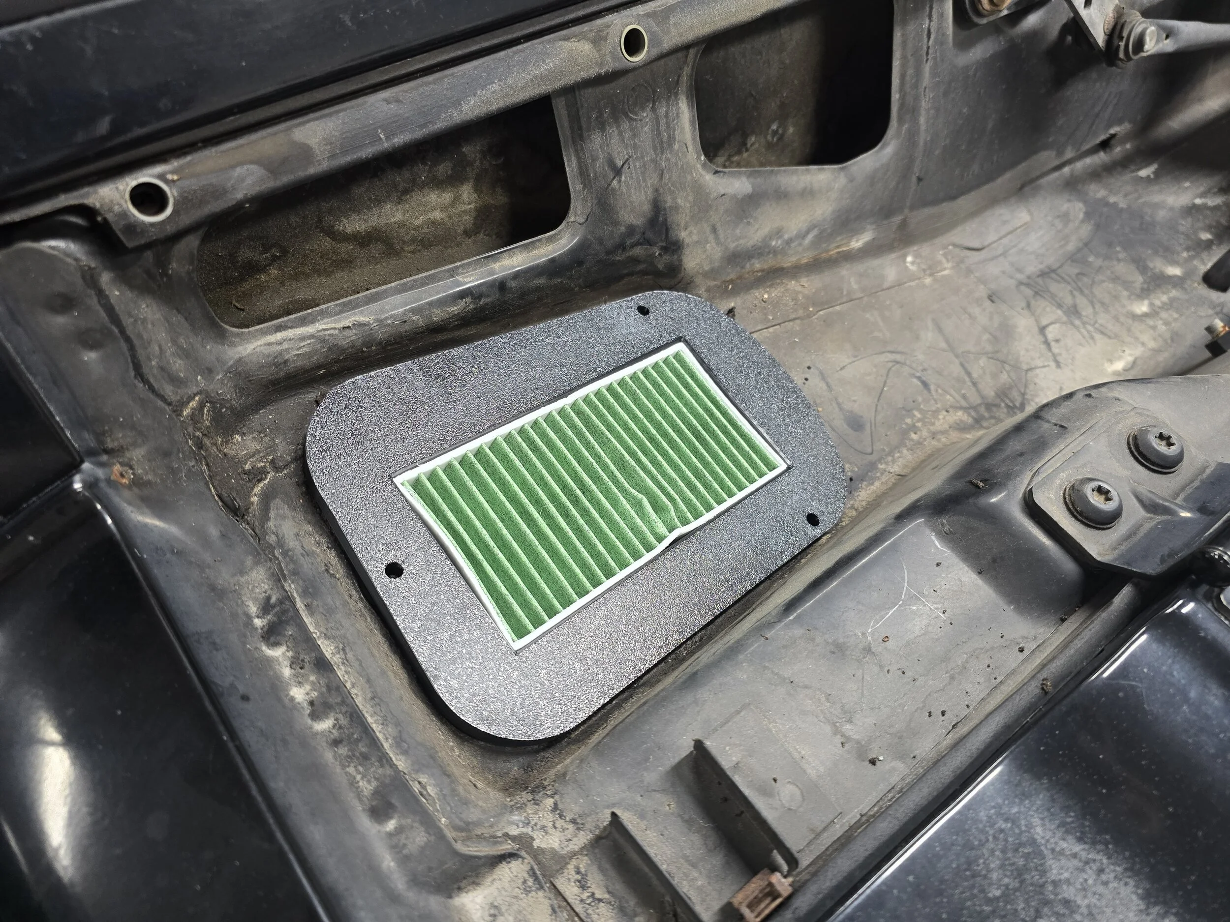

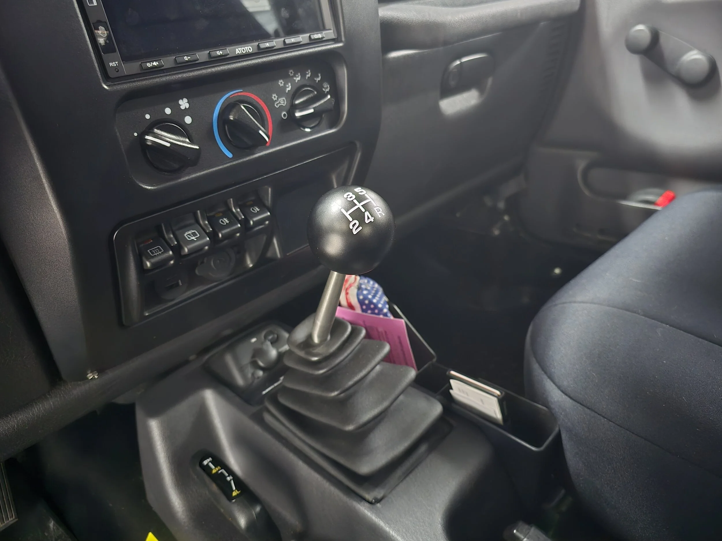

I installed the B&M short throw shifter and a cabin air filter housing. I am interested to see how different the shifts are in the morning after the RTV dries. The cabin filter is 3D printed and the filter is from the JK's.

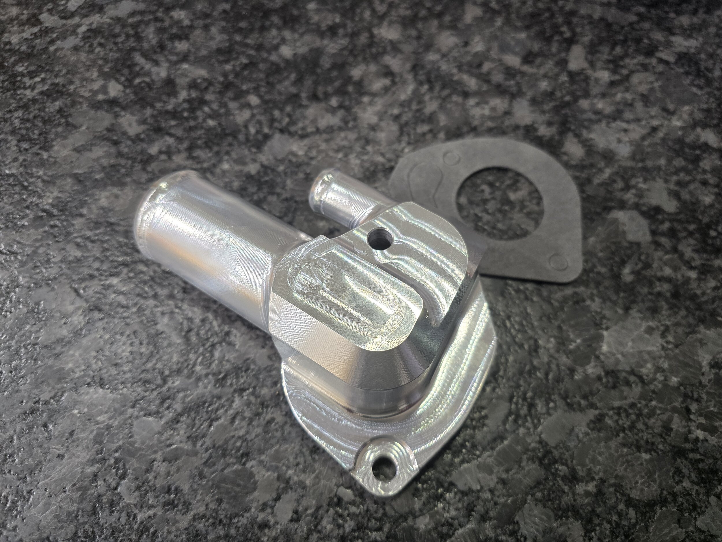

I also have this billet aluminum thermostat housing to go in tomorrow evening. Hopefully this one will seal better an will not be prone to cracking like the cheap aluminum factory ones are.

I love my B&M shifter.

Who made the thermostat housing?

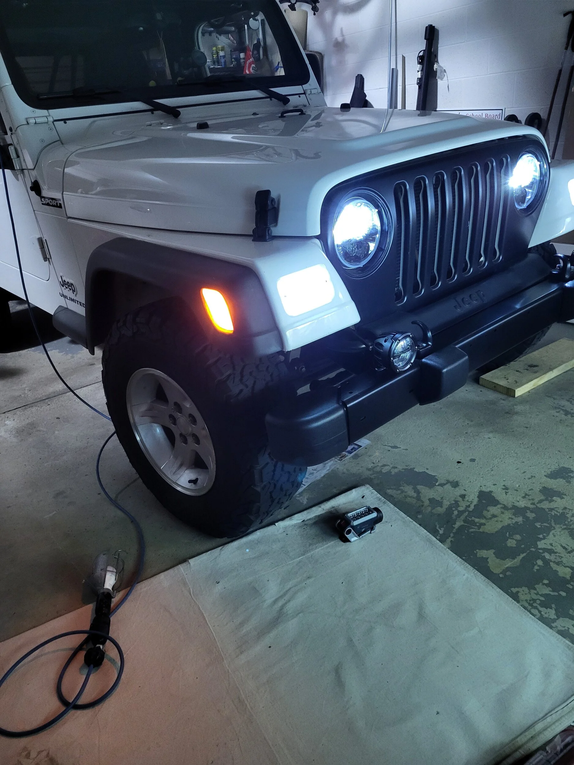

Re-wired my Side Marker lights so they aren't turn signals. Now the switchback modules in the front switch from White Park lights to Amber Turn Signals and the Side Marker lights just stay on Amber.
I didn't have any trouble with the LED's flashing correctly, I just wanted it to be like today's cars.

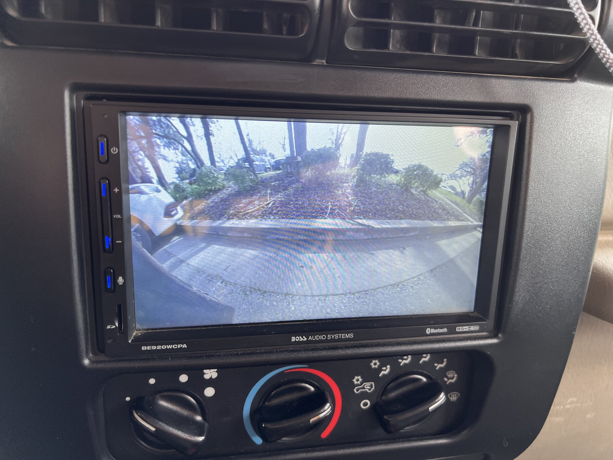

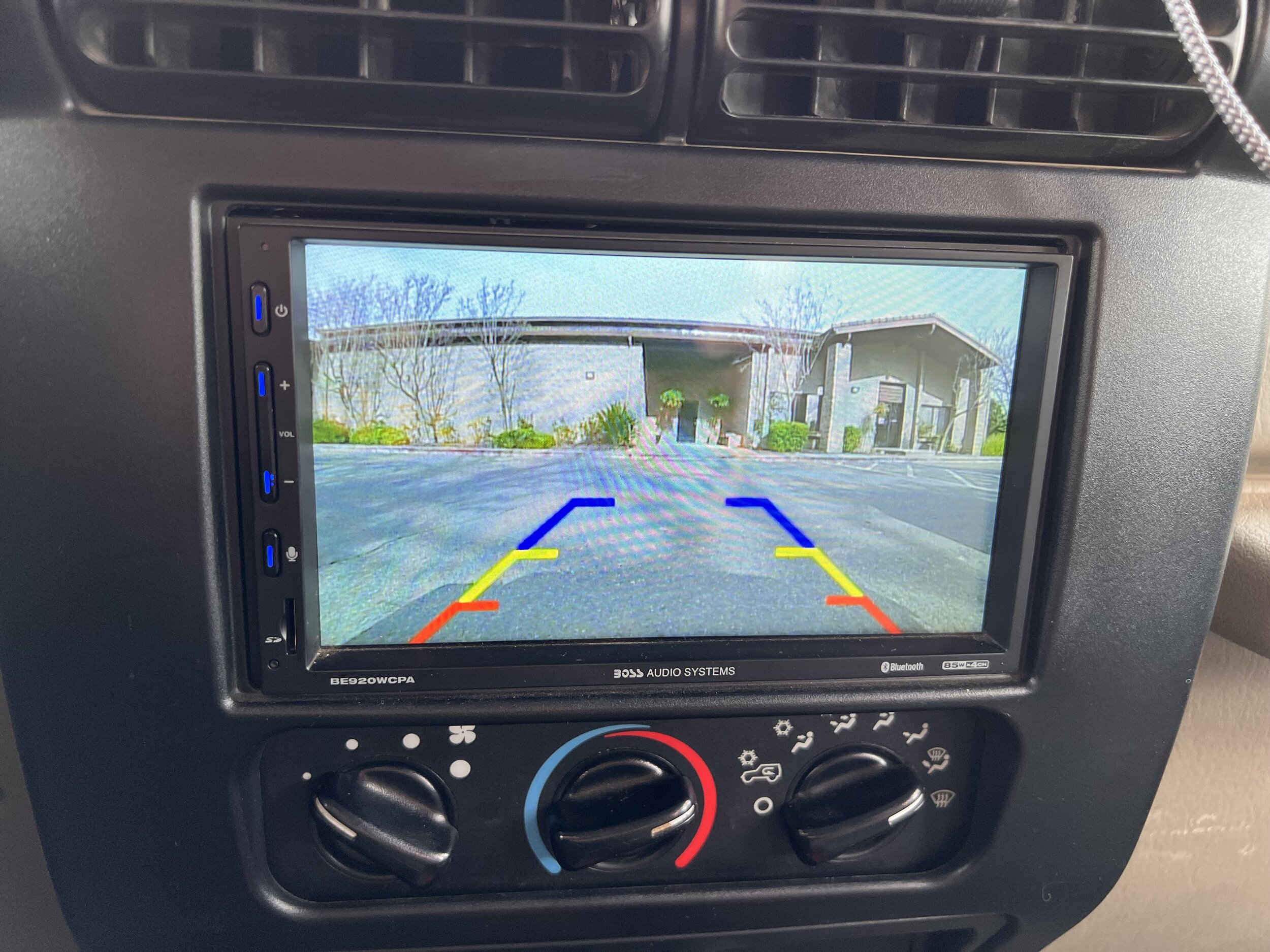

Actually yesterday, got the front and rear camera’s wired up. I’ll probably cut the wire to eliminate the parking assist guidelines on the front camera.
Job looks good -
If you’ll take some washers and bring your climate control out about an eighth of an inch it will stay cleaner in there and fit the bezel tighter

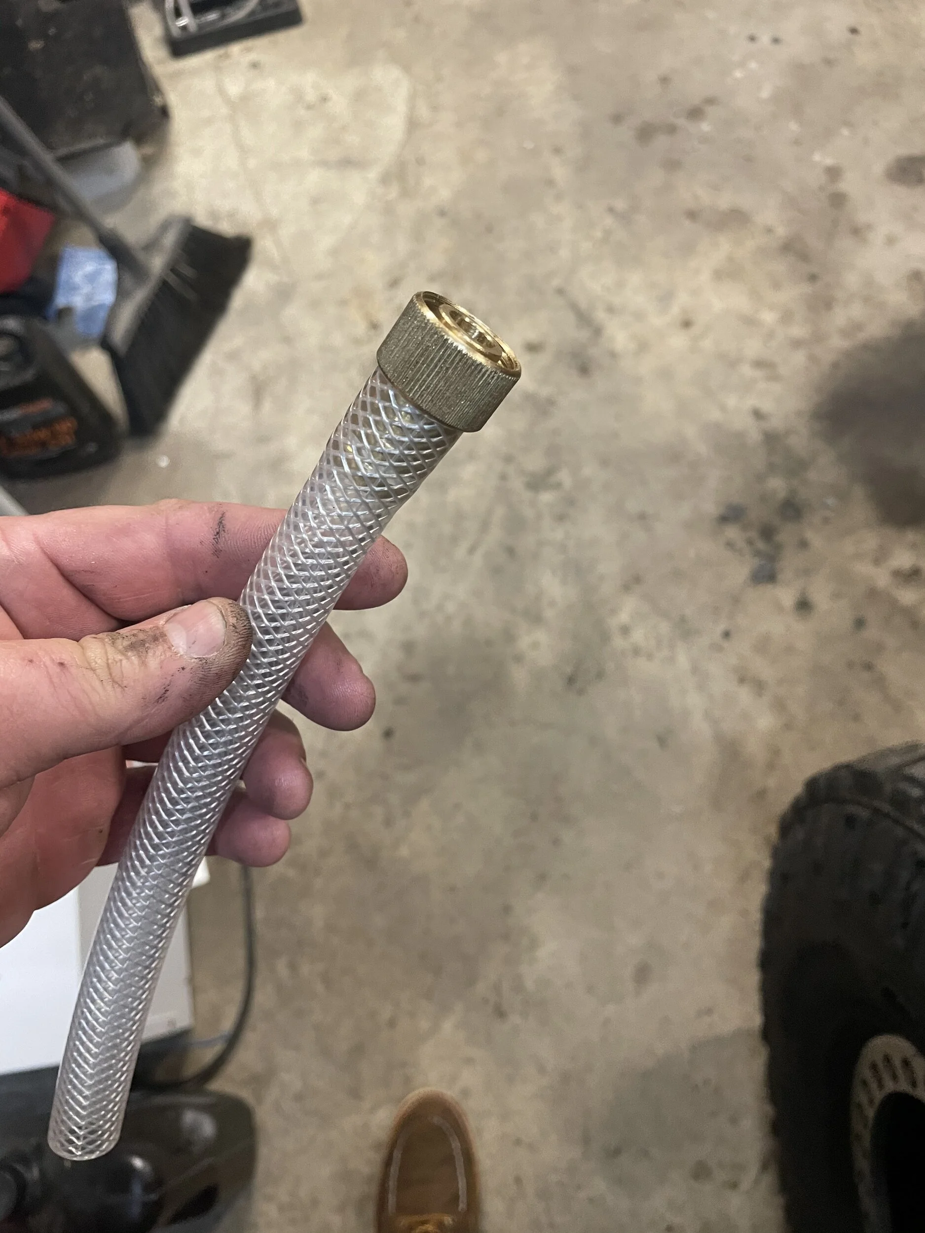

Added a quick oil change adapter due to the skid- I hope these don’t affect the oil from draining contaminants much- seem restrictive but maybe I’m over thinking it.

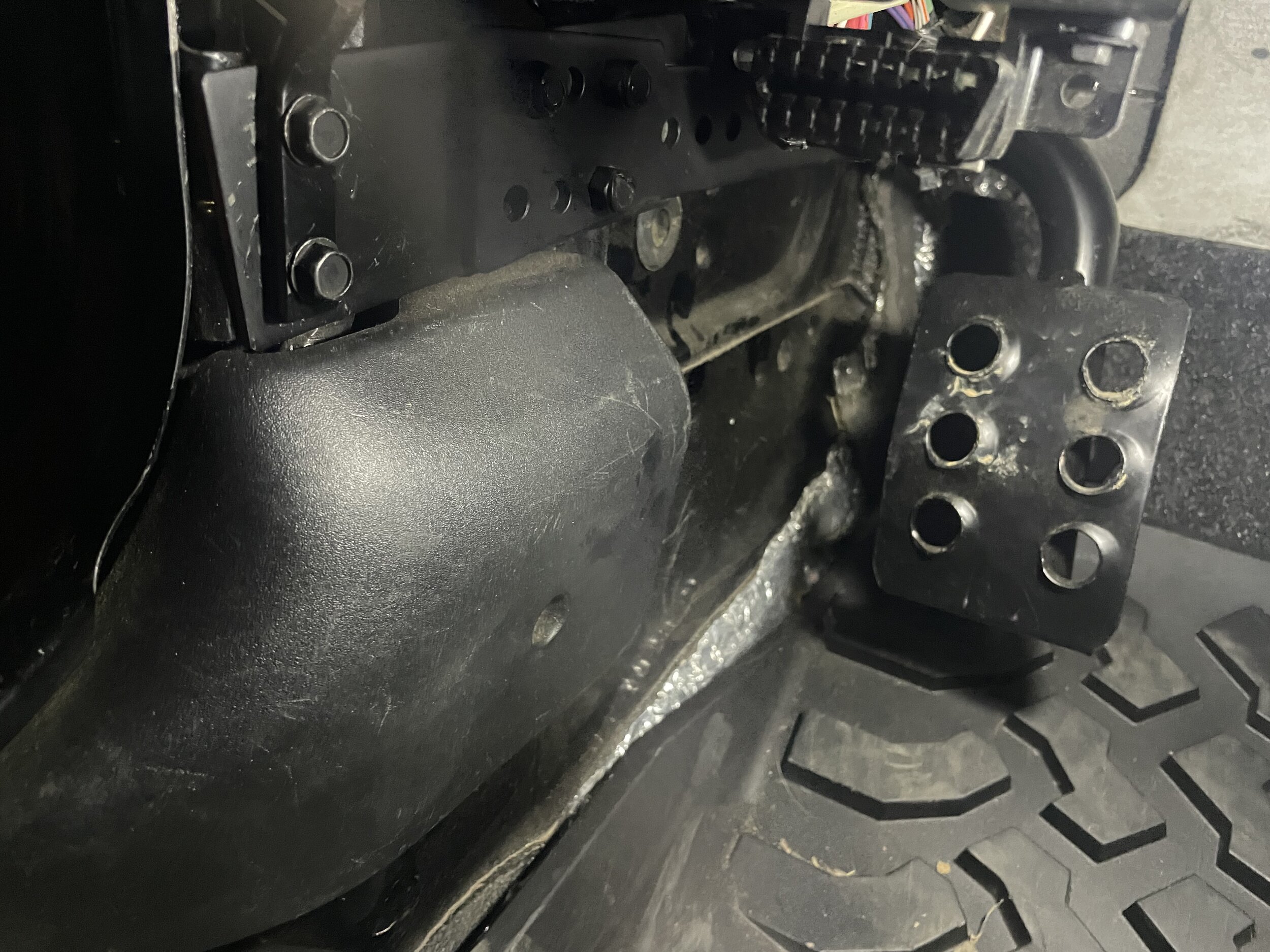

Installed JK dead pedal from my TJR , fits better at length I made it
Lengthened jk dead pedal for TJR and installed

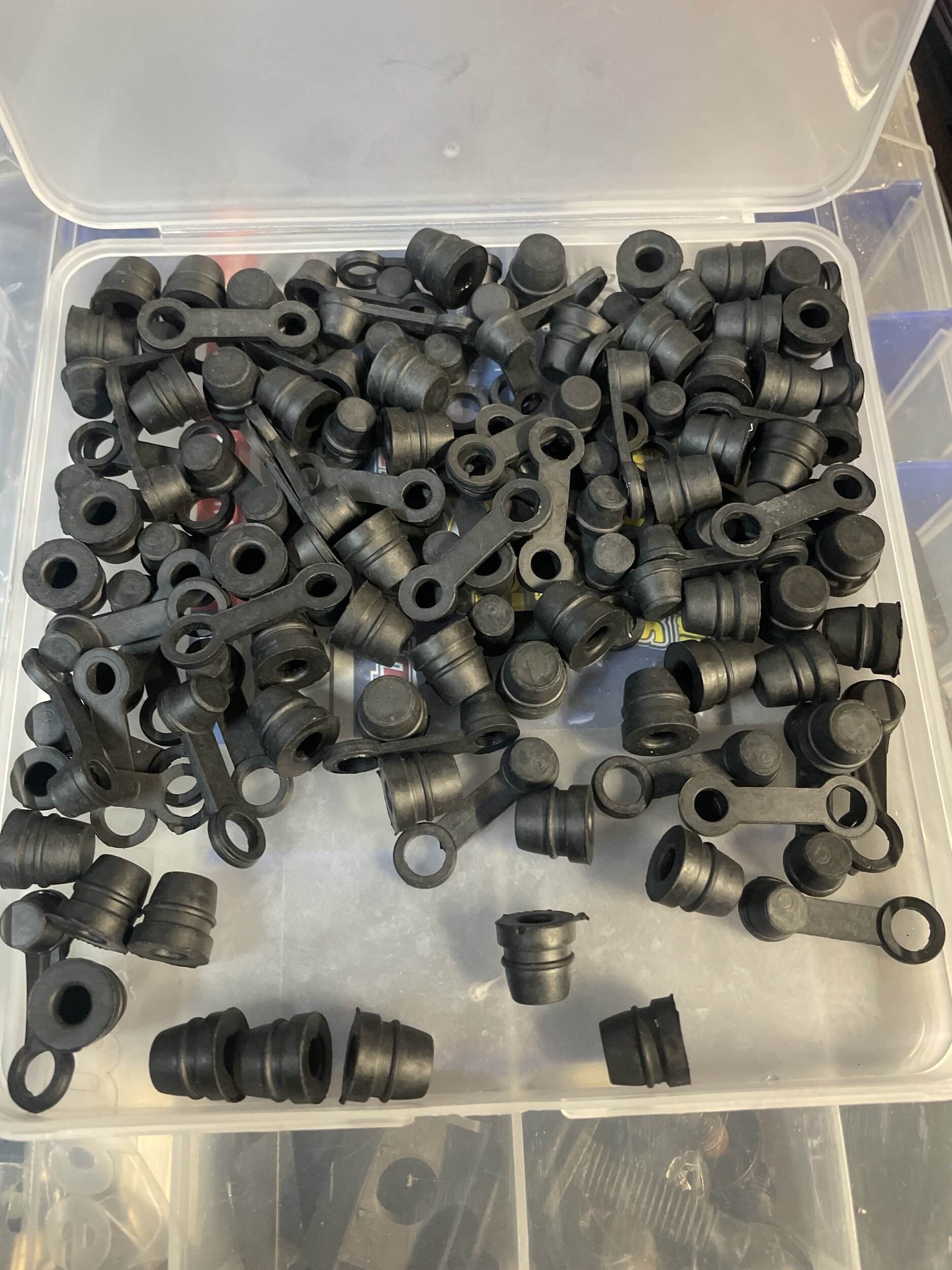

Just a reminder you can get these little cap kits cheap on amazon- like 7.99
