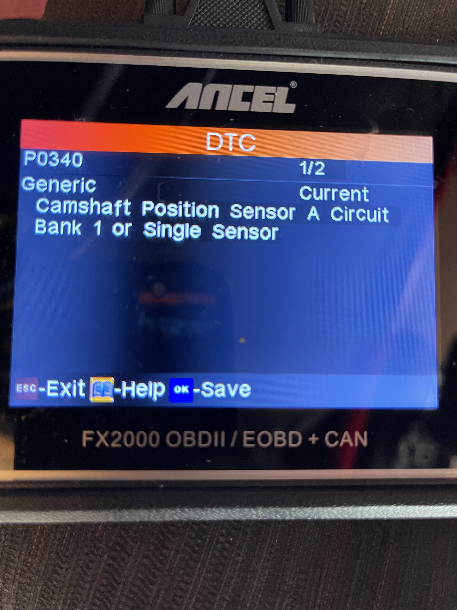

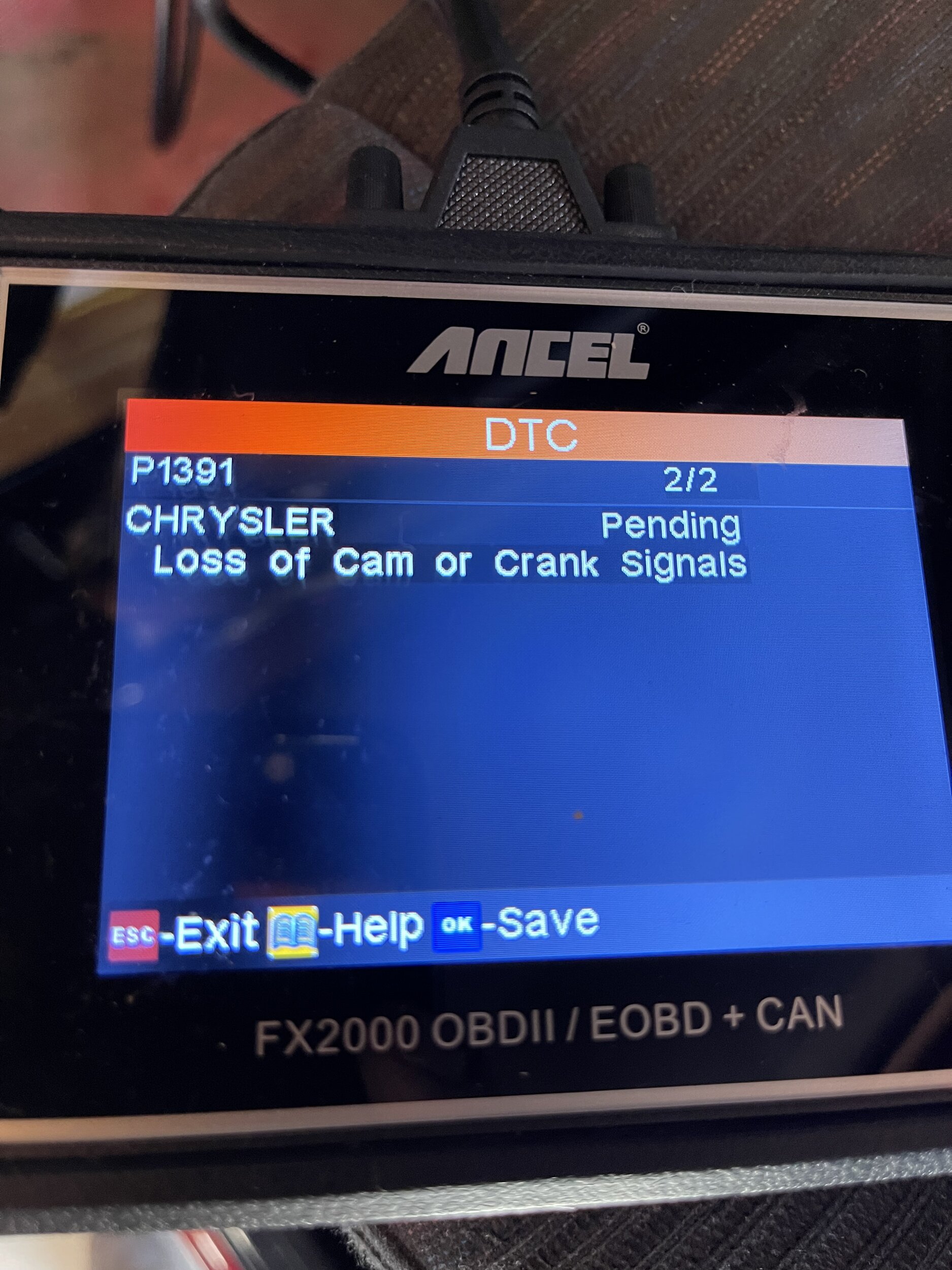

Checked with my SIL’s code reader;

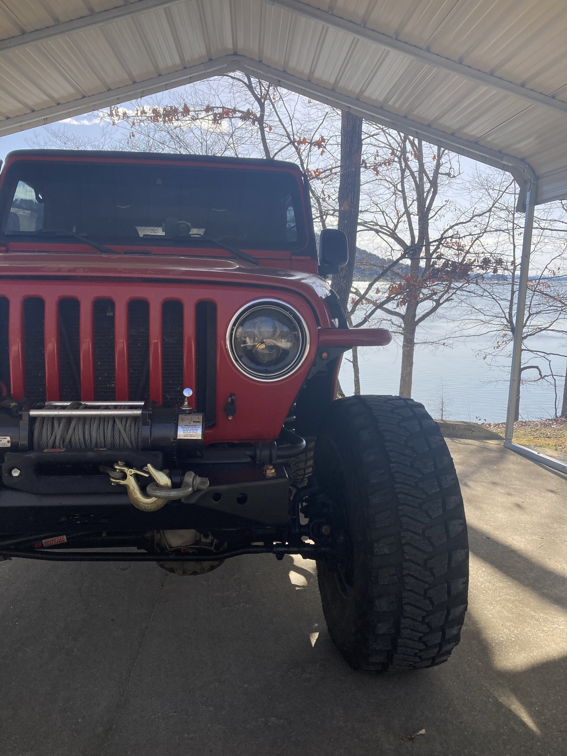

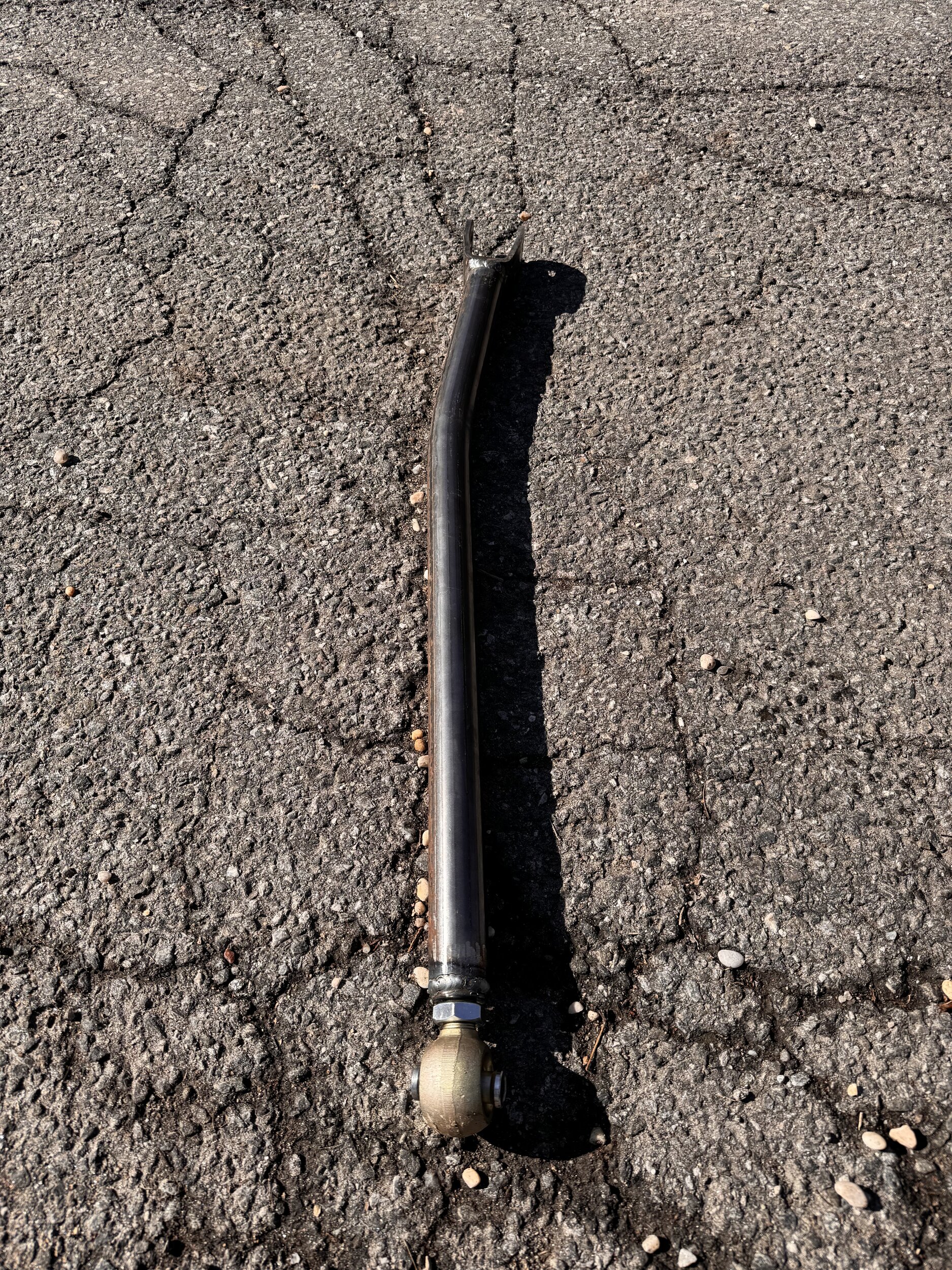

Welded up the front upper control arm for the 3 link today, and tossed it in and got everything all set. Used a Barnes enduro joint so I will see how it holds up compared to my Johnny joints.

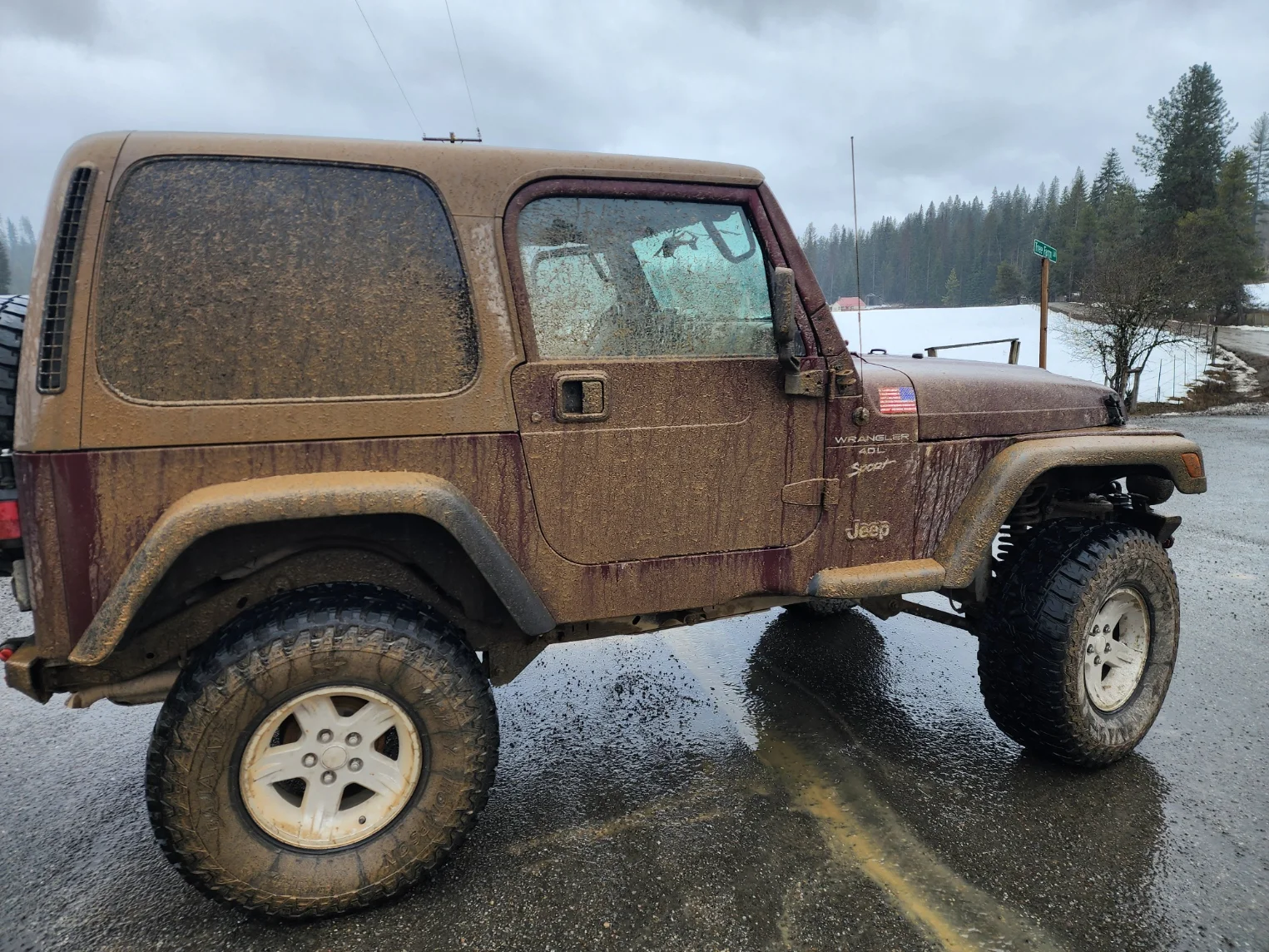

Did the 500 mile, break in, oil change on the rear diff and decided to double check my pinion angle. It was low by almost 2* so I bumped it up to 0* +- .3. that little adjustment removed a good deal of vibration at 70 mph. Liking it! Went out on Sunday for an easy trail ride in the snow and mud and now I'm really starting to consider some wider flares. Barely can see out the side windows or mirrors.

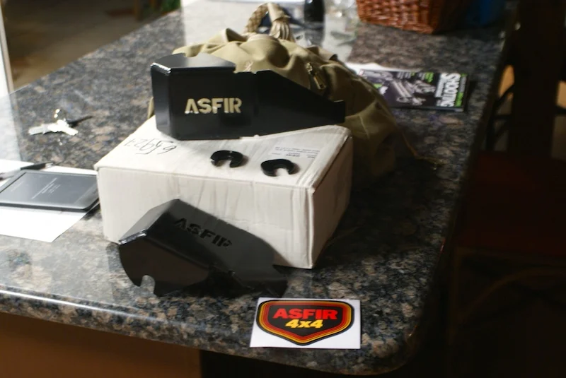

An accessory company in Israel that nobody's heard of before! The thing is certainly very well made - whether or not it makes sense is another question.
They make aluminum skid plates that are pretty well known in the Land Cruiser community. I didn't realize they made anything for TJs but see a few pieces on their website now.
