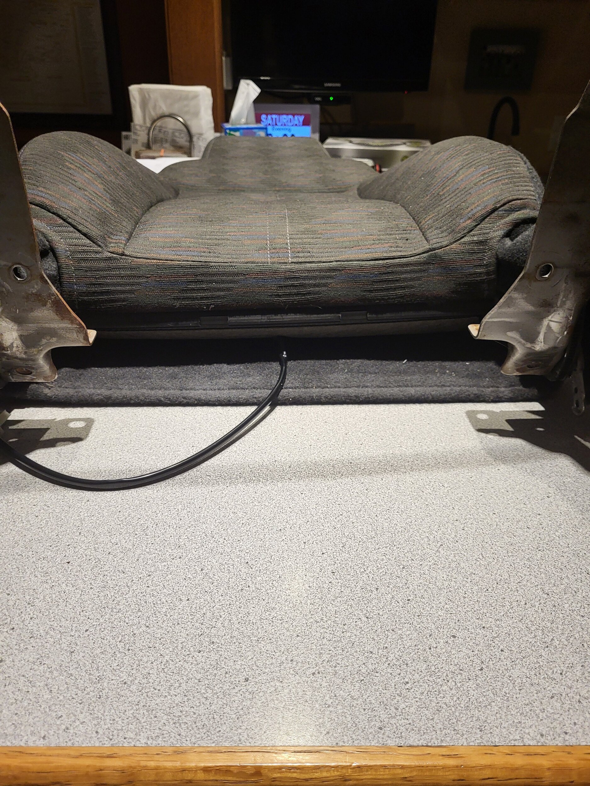

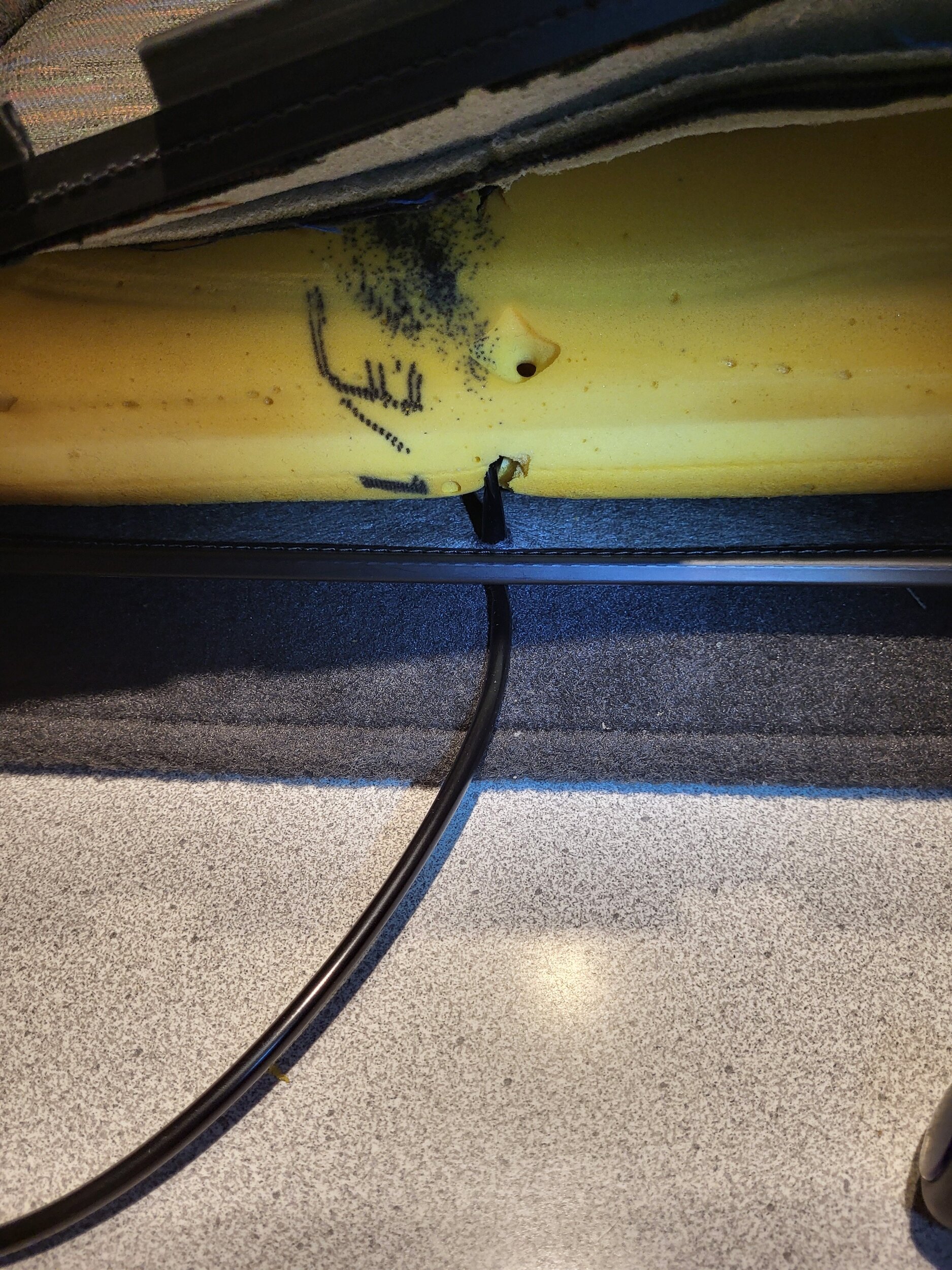

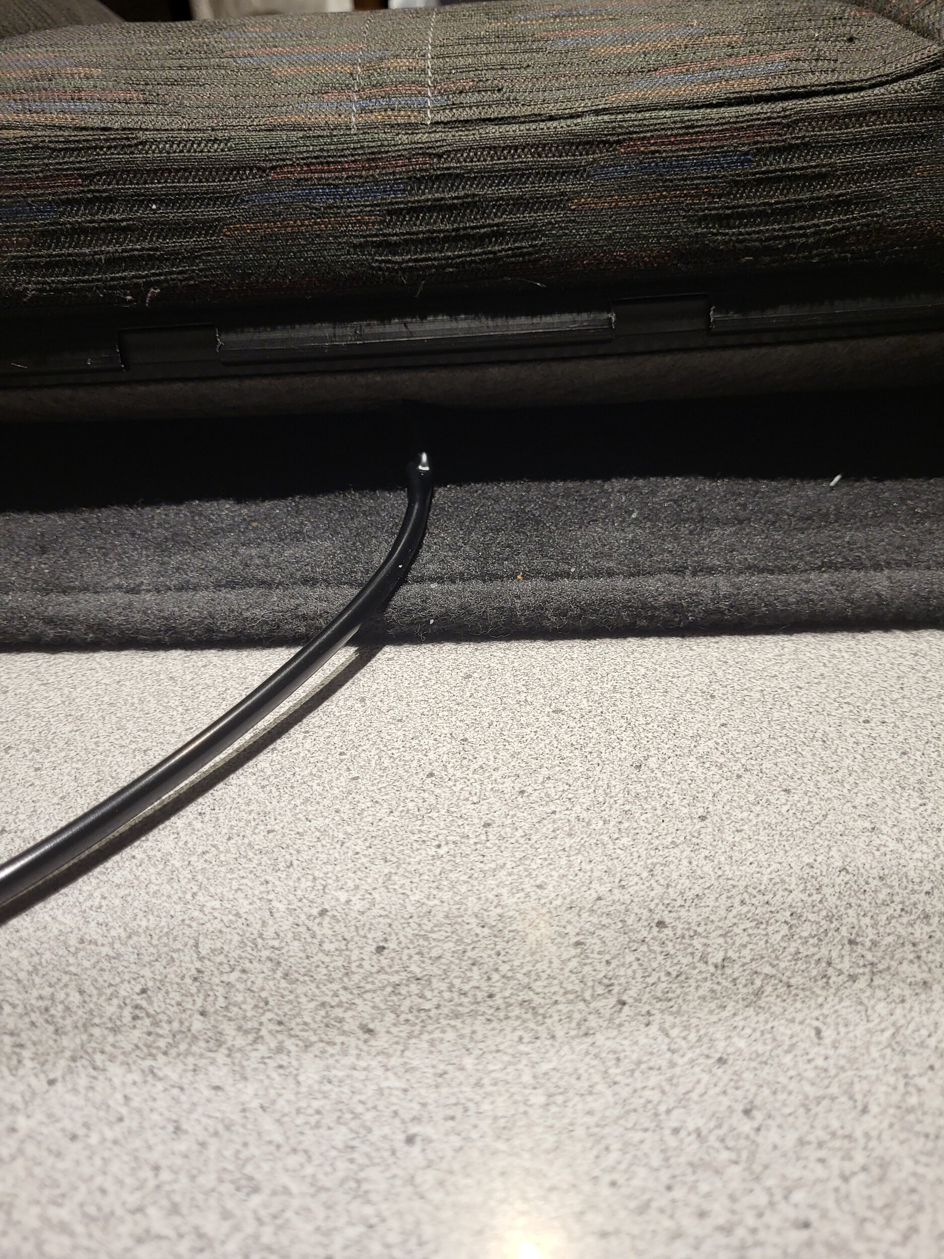

Is there a specific brand kit everybody is using for installing seat heaters?
Might as well add them while it's apart.
I used Metra because they have phone support and spare parts available. I traced out the wiring to see how they work and drew out the schematic. I cut the heaters down to fit. The wife likes hers a lot.

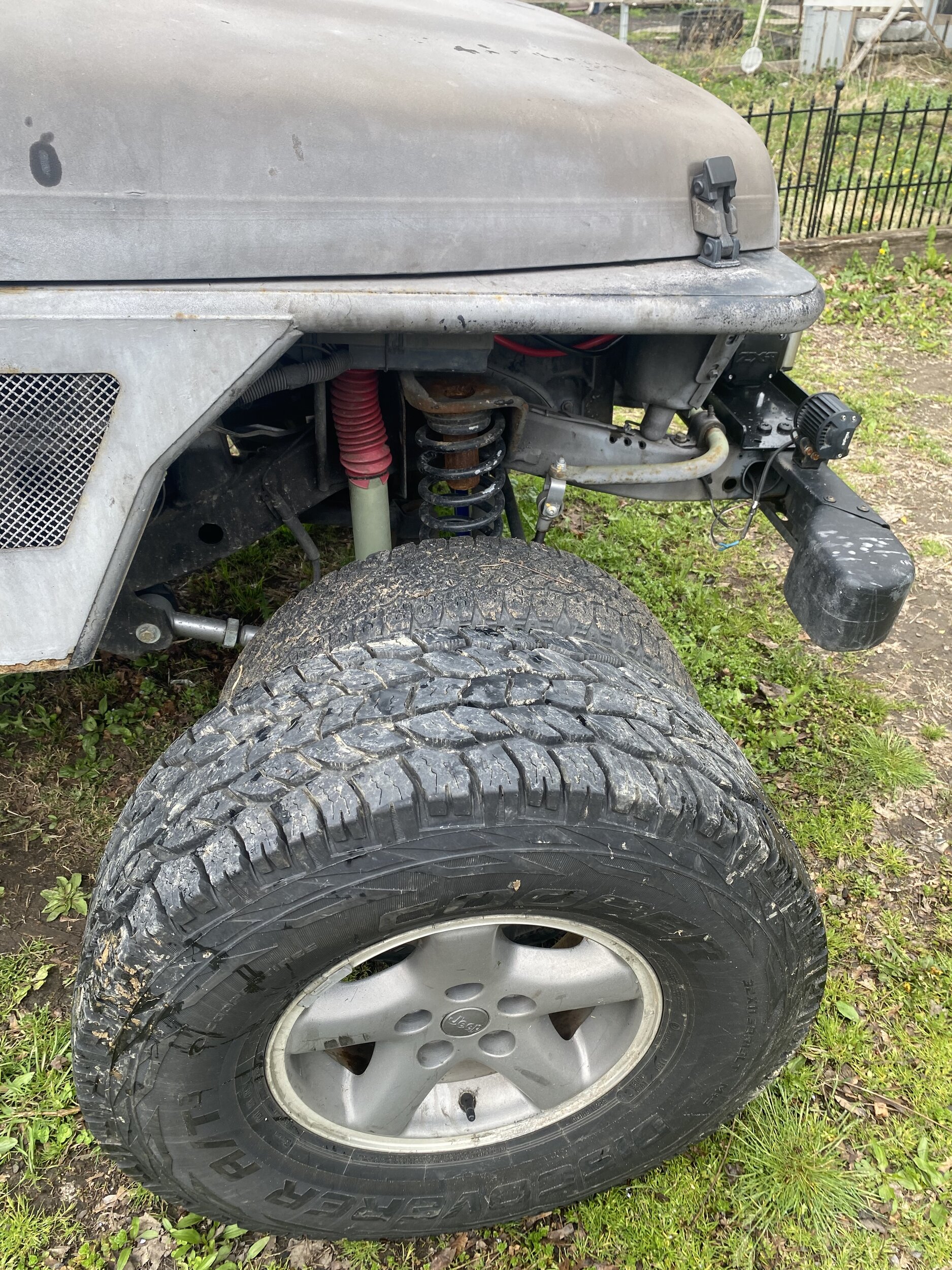

Found a decent set of TJ rims with some 32x10.50R15 Cooper Discoverer AT3 tires for $400. The next nice day I’ll try to get the old 235/75R15’s off and these on. I believe it’s about a 3” difference so they should fill up the wheel wells and look better than the stock sized tires.
Those 32”s will fill that gap nicely

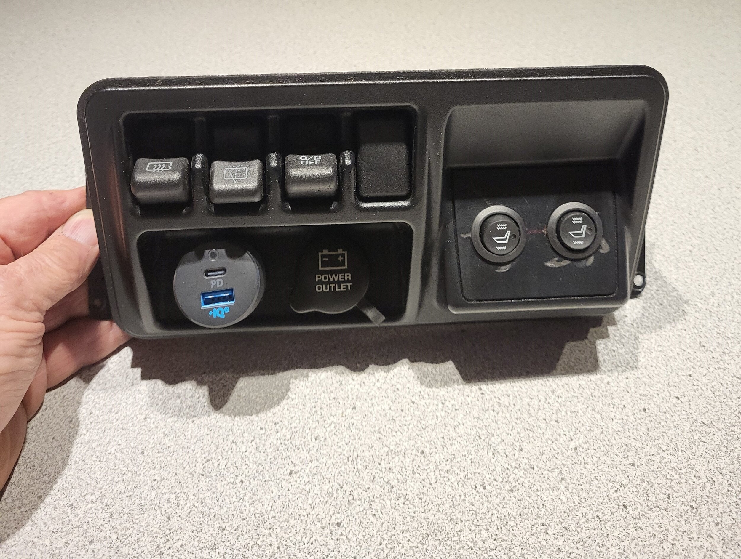

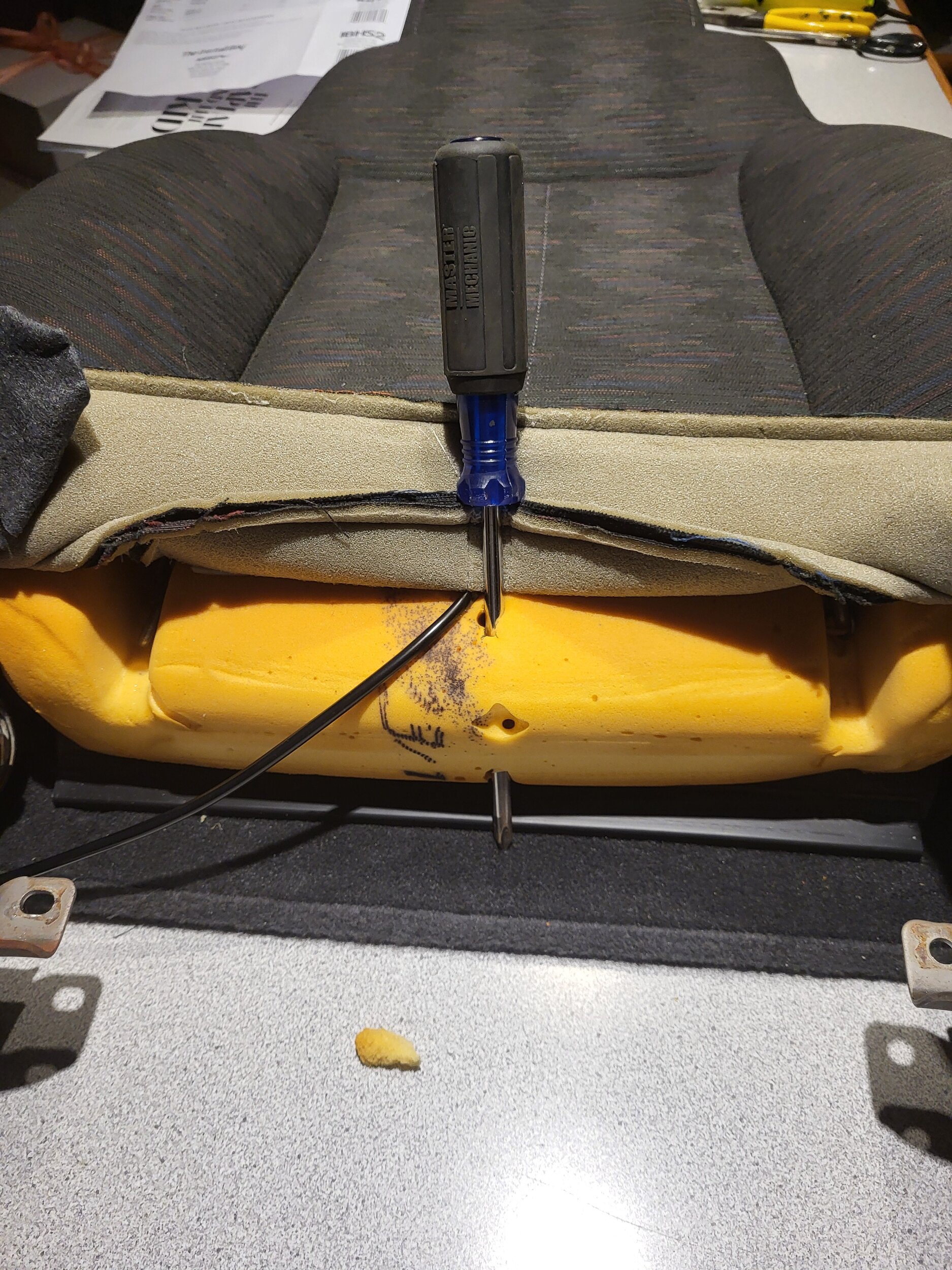

I used Metra because they have phone support and spare parts available. I traced out the wiring to see how they work and drew out the schematic. I cut them down to fit. The wife likes hers a lot.
I took the Metra wiring harness apart so the red power wire only goes from the switch to the fuse in the glove box. The ground is behind the dash and ties in near the switches. Then I added 5' of Black/White/Yellow from the switches, under the console, and across under the seats. Mounted the relays under the seats on the frames. It was just a bit confusing that Metra uses red wire for the +12V to the switch and also from the relay to a heater.

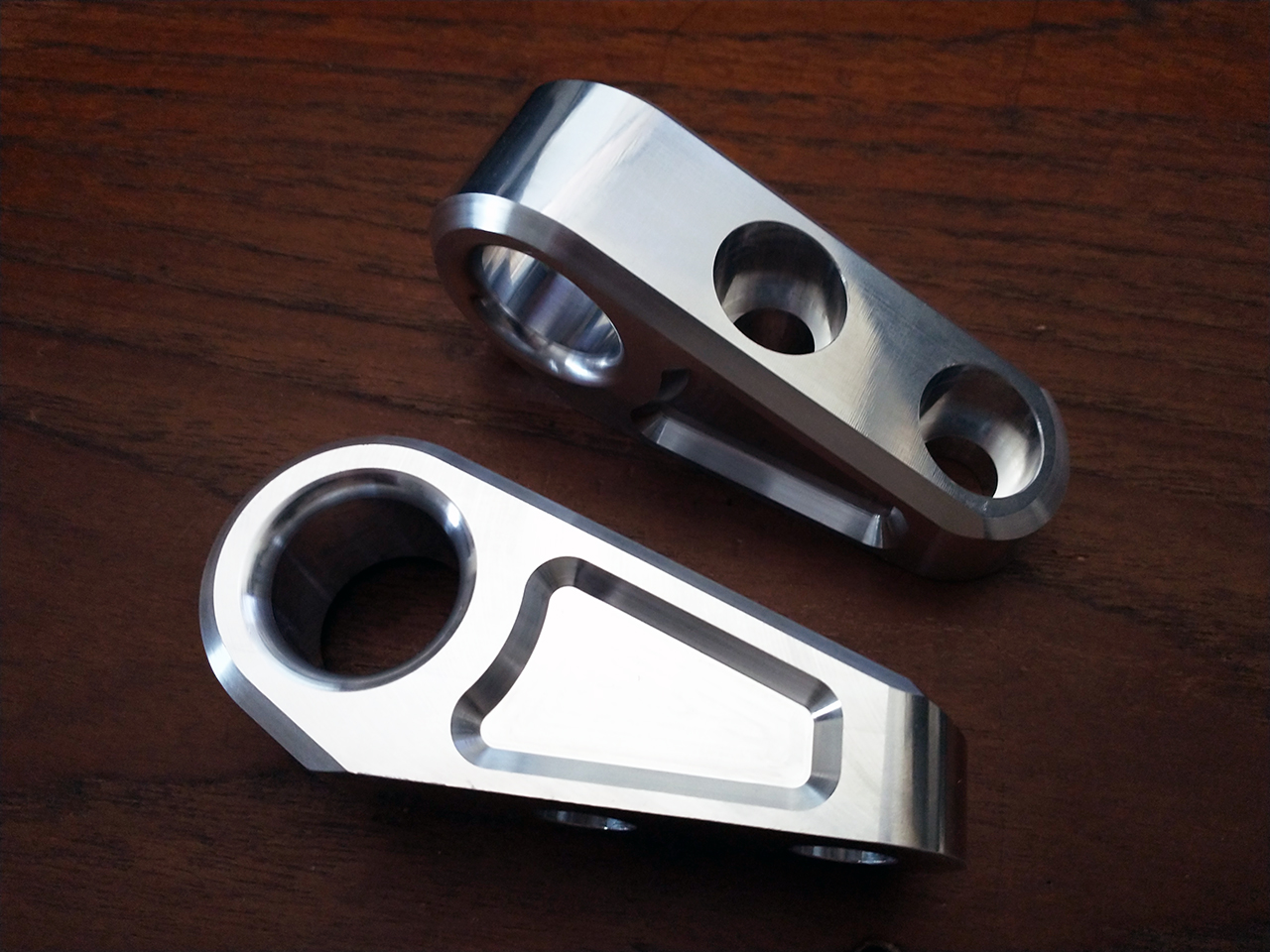

Not sure what those are but want some, in the first pic-
Those take the place of your front tow hooks!!!!!!
...and, as I understand it, they're manufactured by a member of WTF as well. The factory tow hooks are alright but I've already caught my self on them while working around Tessie's front end and I feel like they won't work so great as a safety line tie down point for my plan to haul my surfski on top due to their style and orientation. Sure, I could just lash the line around the bumper, but I think these will not only look better but offer a better fixed point for attachment. Kind of wish they came in anodized black, but not a deal breaker for me. I can always cerakote them if I feel froggy.
They're a nice design, appear to be well made and come with new stainless hardware. (y)
Thank you sir for the information and pictures. Something else to order this week and add to the growing pile of parts to install!
