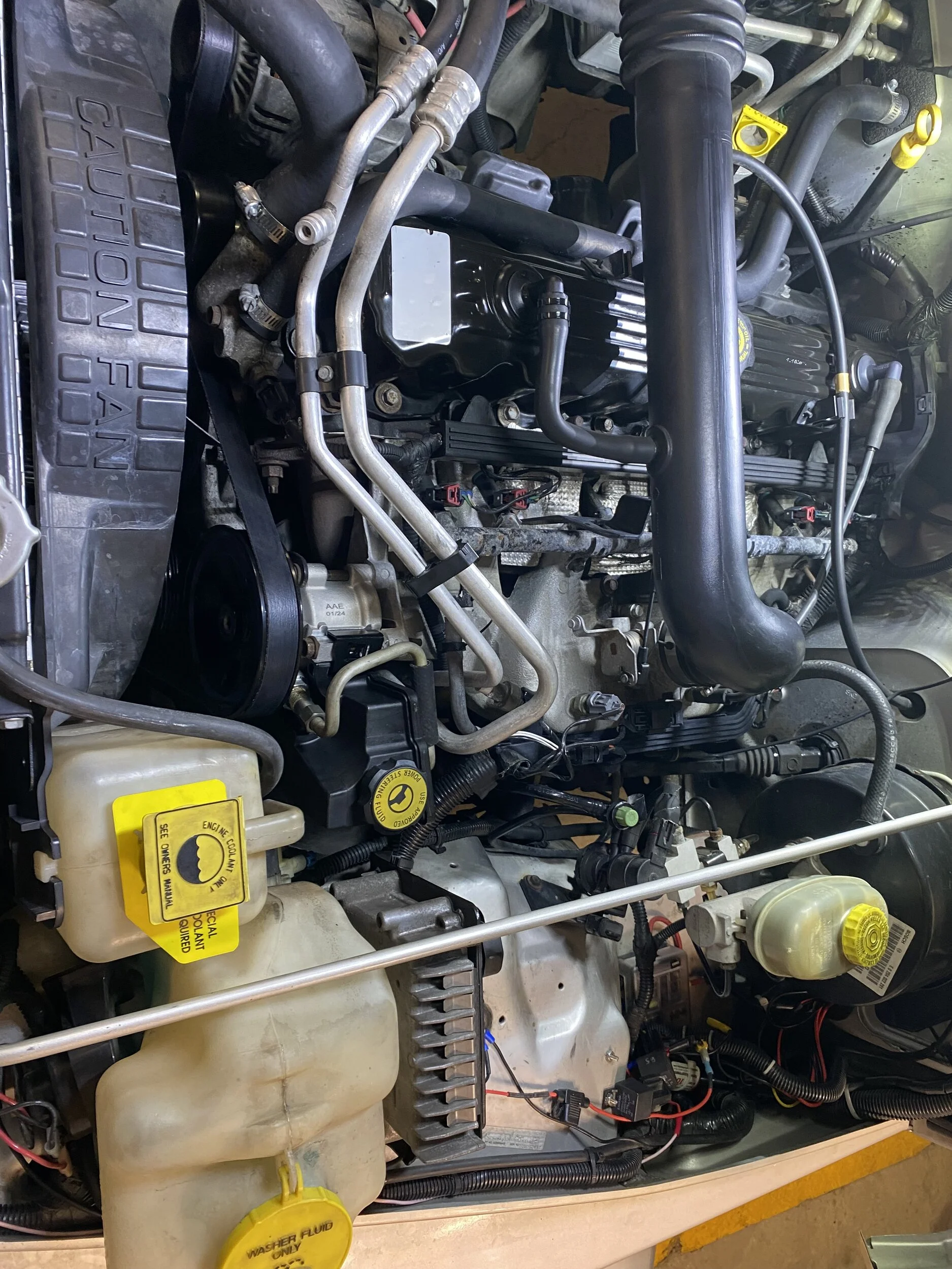

Going to install the old PCM just to double check.
Ok, I am calling this job complete!!!!

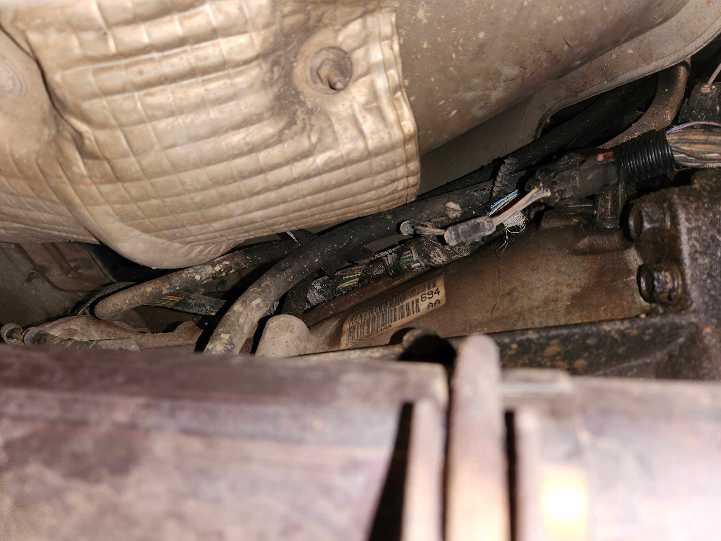

Just felt the need to go back over the harness one more time!
Started on the driver's side and slowly worked my way to the passenger side.
Moved some crumbling loom and found a bare wire.
Got a short peice of loom that I have, it's to small, Ben here's that a lot, taped up the spot and put new loom on.
Left the old PCM on and cleared the codes, PO765 and O2 Sensor heater, pulled out of the driveway BB shifted through the gears perfectly.
Came back and the only codes were for O2 Sensor heater so I reinstalled the Wranglerfix PCM and went for another test run probably 16 miles round trip with a stop about halfway. No coded and shifting perfectly.
Win win.
Win win.
What location on the harness had the bad spot?

Passenger side right above a sensor? The old loom as you can see has crumbled completely apart. Looking at the picture it wrapped in the new loom to the left.
Glad you got it fixed. Making a mental note of this in case I have this issue in the future.
