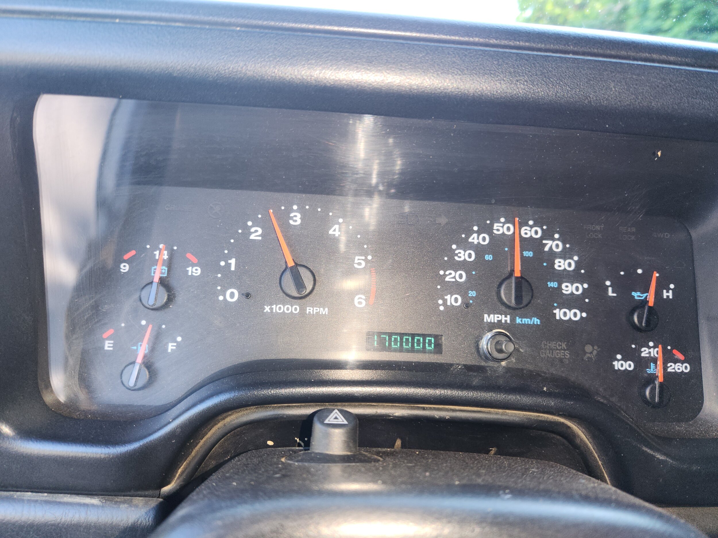

Shed a tear for BB, my Jeep is growing up fast!!!

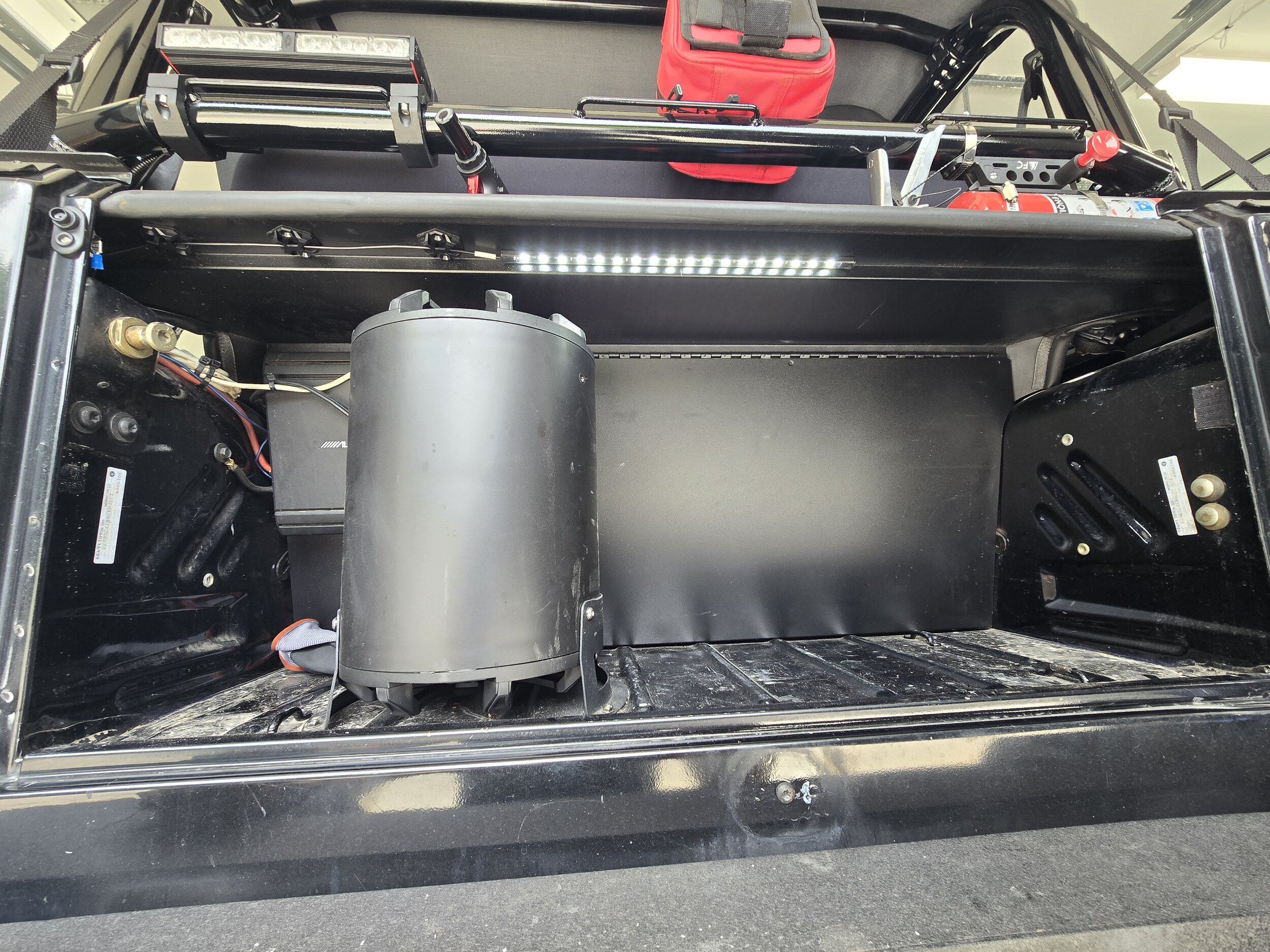

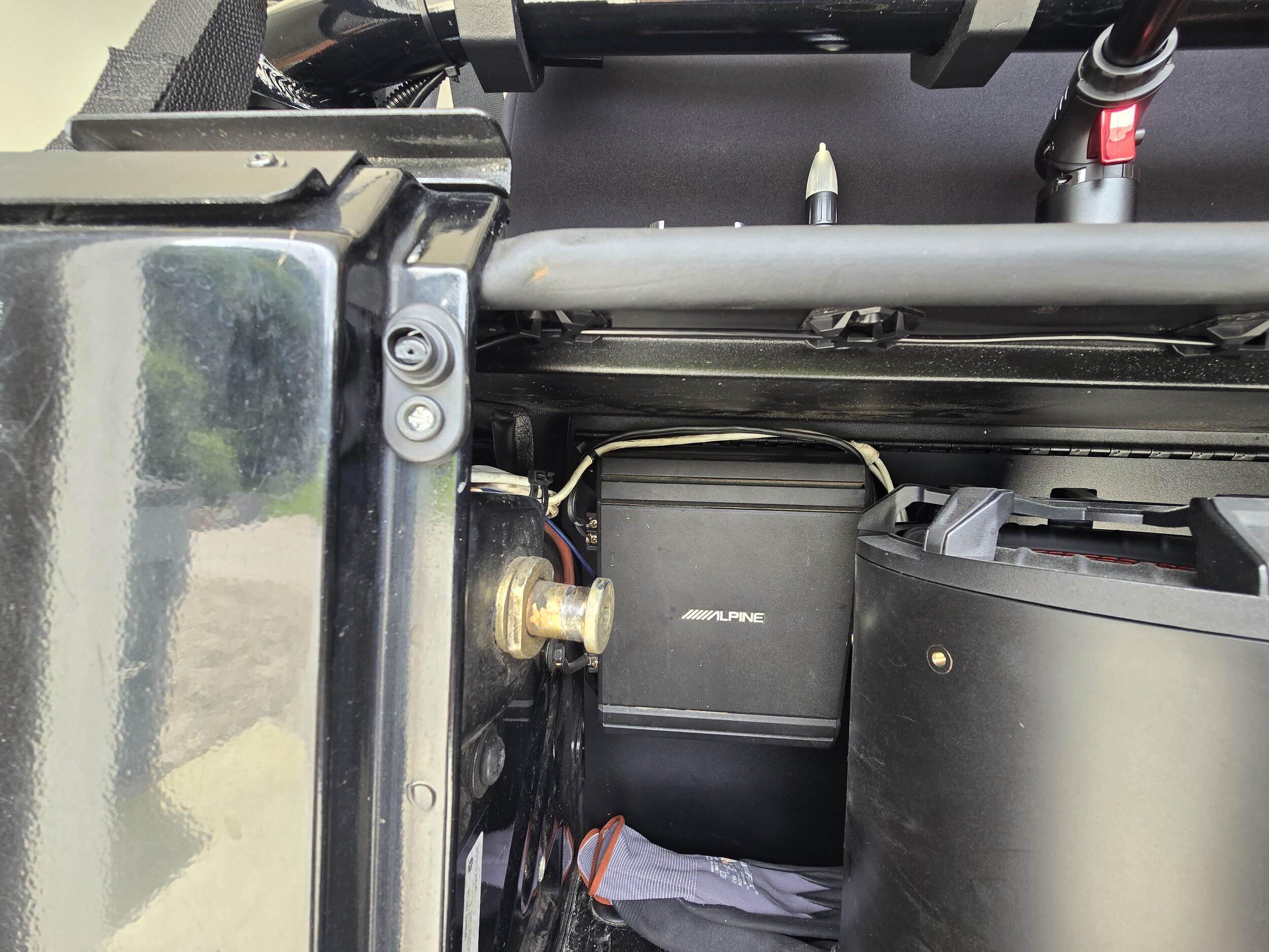

I installed a LED strip light in my Tuffy InstaTrunk that is ground switched by a door pin switch. I used the switch as the ground for the light, that is why I switched the ground side.
If you are local to Southern Indiana/Louisville, KY I will give you 1 of the 2 extra I have. If not, here is the switch I used. It needed a 7/16" hole for the plunger and a small pilot hole for the screw.
https://www.amazon.com/dp/B081MTFTDL?tag=wranglerorg-20
Thanks to @MikekiM for the idea and the switch to use. I've been wanting a light in this area.

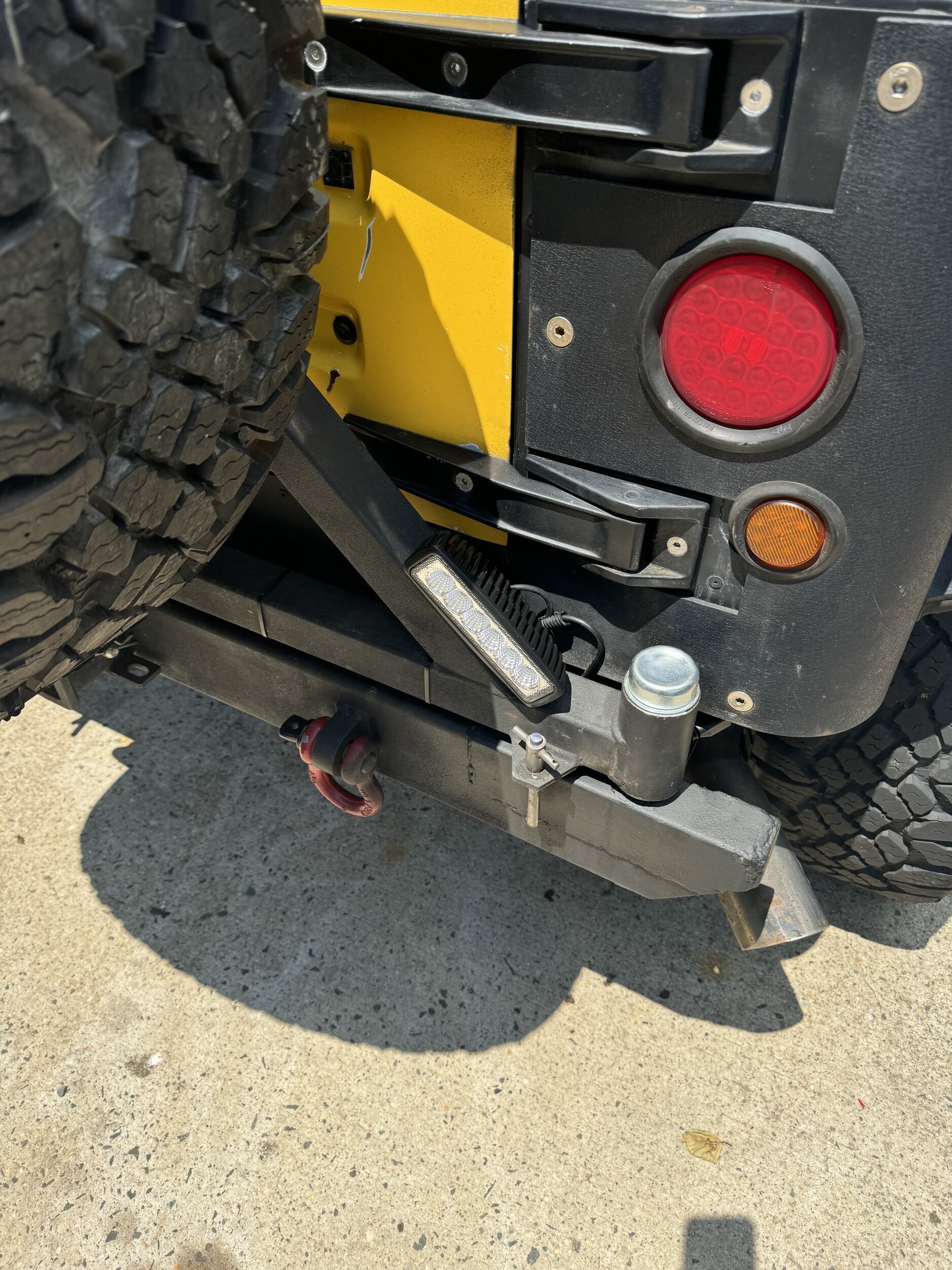

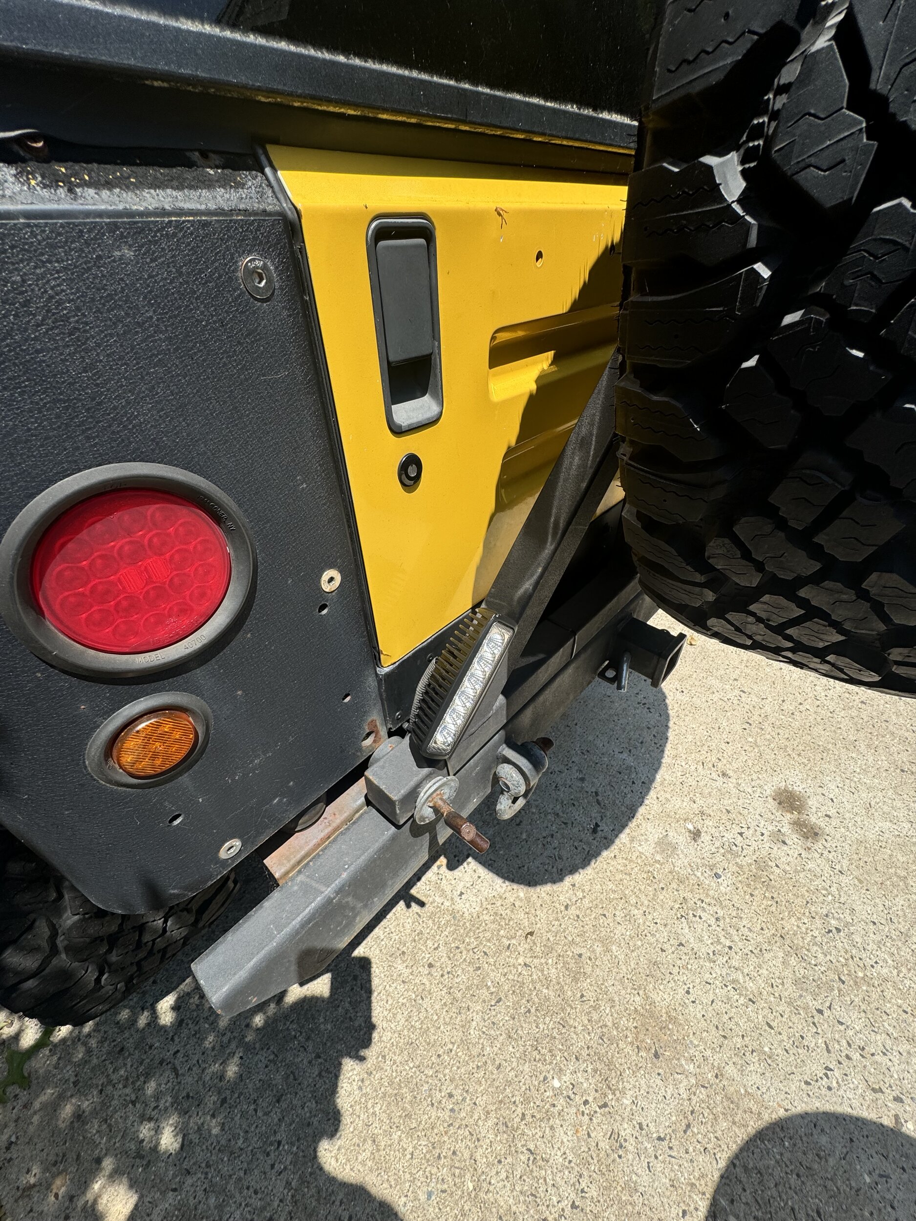

Installed some flood lights to the swing out tire carrier so I can actually see where I’m backing up now. Install took some time but I’m pretty happy with how it came out. Went with the harbor freight 6” flood bars well just have to see how they hold up. View attachment 533864View attachment 533865
Love the rear tail lights….

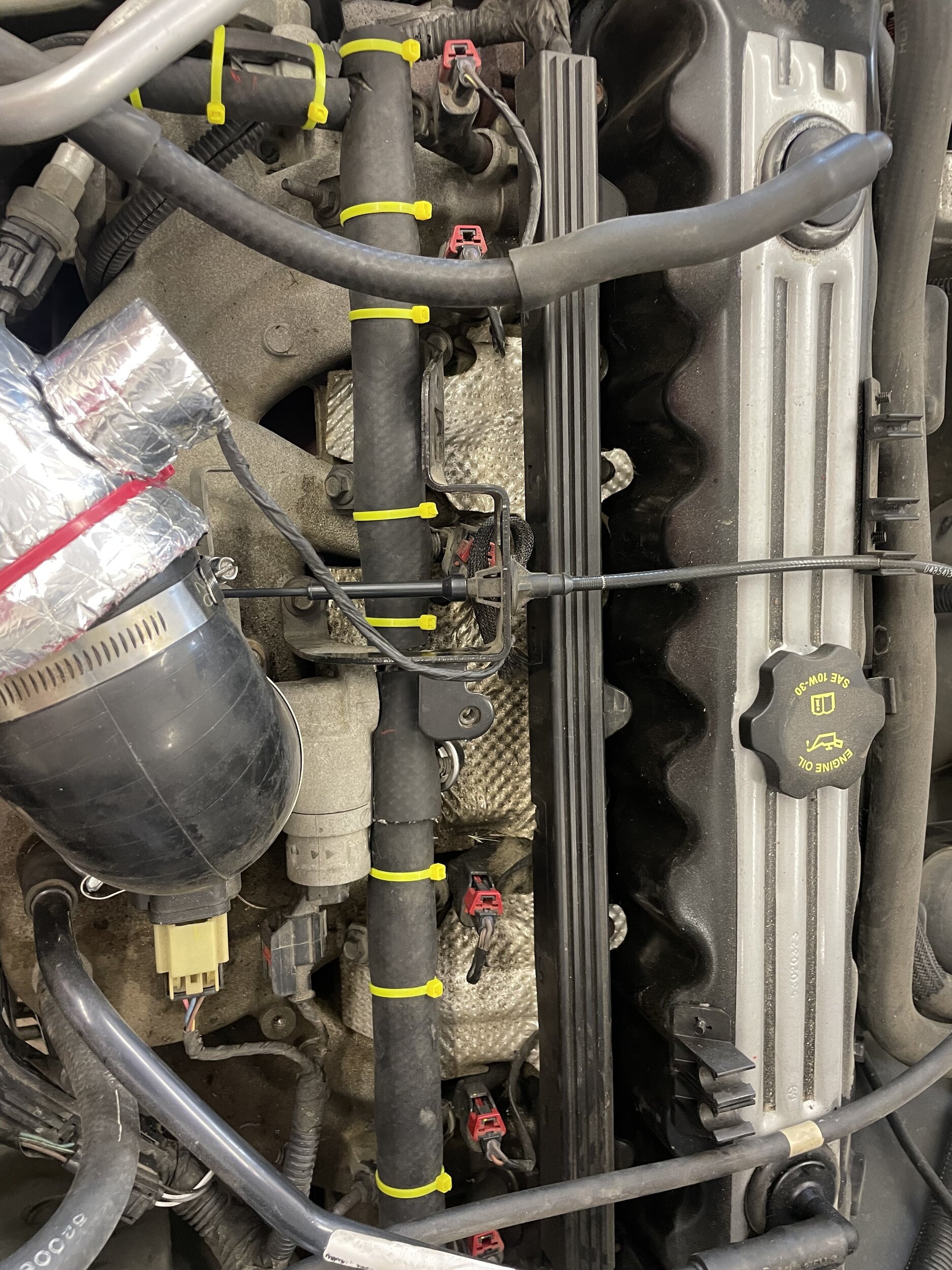

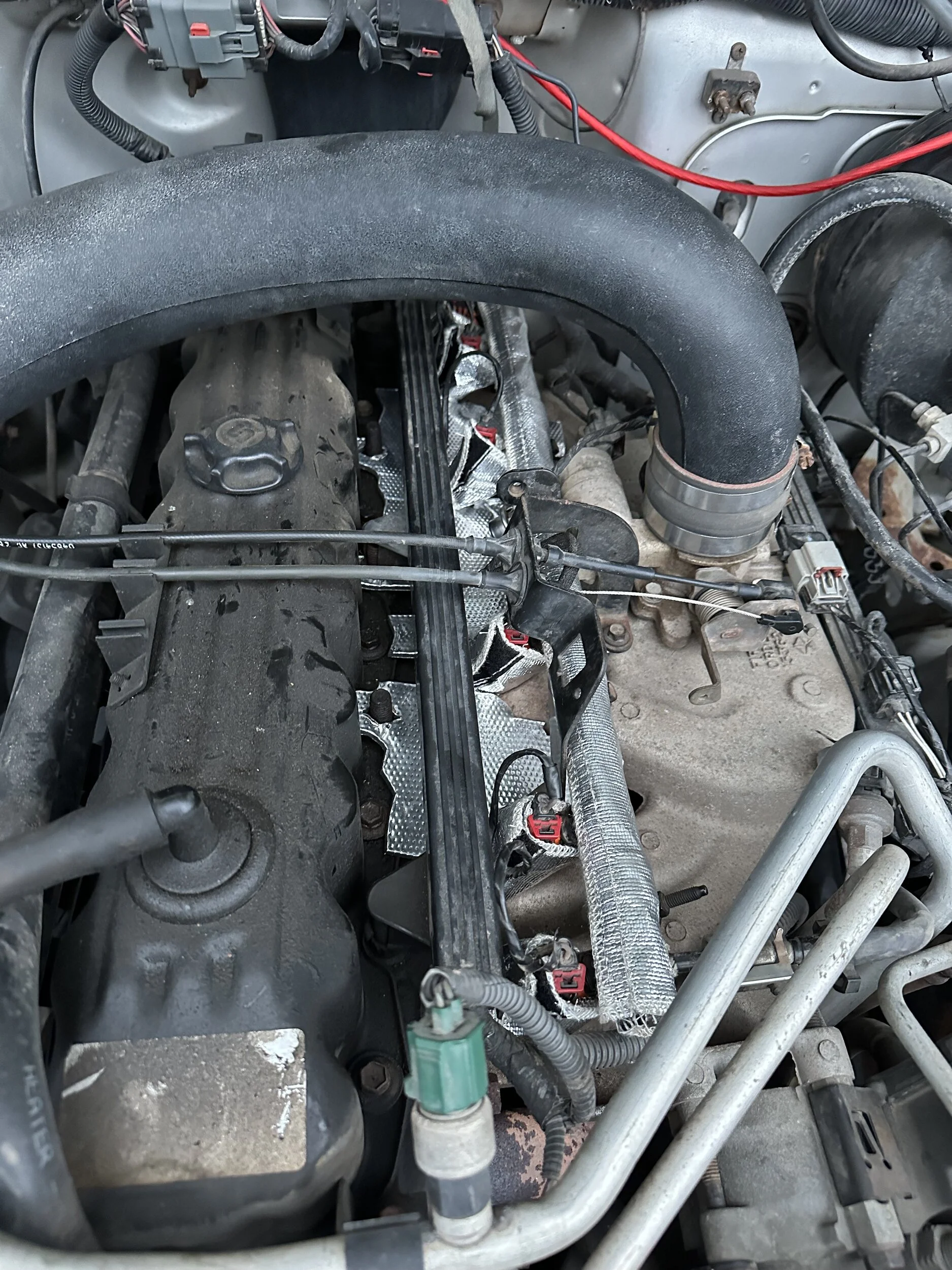

Installed new precision auto injectors (credit to @macleanflood) so far they are working well! Also installed a DEI insulation kit.
Man the throttle body and injector ports were DISGUSTING! Guaranteed they have never been cleaned before. Cleaned them out good, now to tackle a small evap leak CEL.
OK I am thinking I would like one of those insulation kits because the motor takes a bit to restart after a bunch of slow rolling on the trail. It starts fine after 30 seconds or so, but I figure this could help. I REALLY don't want to do a Google search for "DEI Insulation Kit". Whatever comes back is going to be wrong in SO MANY ways. Any chance you already have a link?

That sounds like some classic heat soak!
I had to slightly modify mine to get it to fit my 06 LJ. Here’s the link. Double check your injectors for any cracks too, convenient time to replace them when installing this kit.
DEI Insulation Kit
DEI Insulation Kit
Yeah, probably be a good time to clean the intake, injectors and redo the valve cover gasket. This thing has 335K miles on it and who knows when the last time it was done.

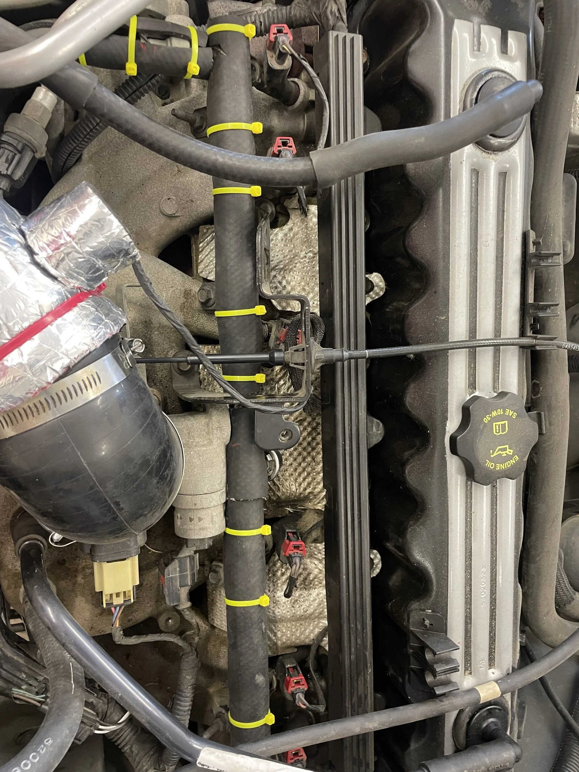

I notched/ran heater hose around the fuel rail all the way to the frame.Using my temperature gun to do a before and after. letting it idle for full 5 mins ….after a 15 minute commute home last summer- dropped the surface temp of the injector rail 25 degrees. Still going to wrap it it reflective material. Just part of my attempt to get cooler/air and fuel to the motor.
Edit: added the picture
