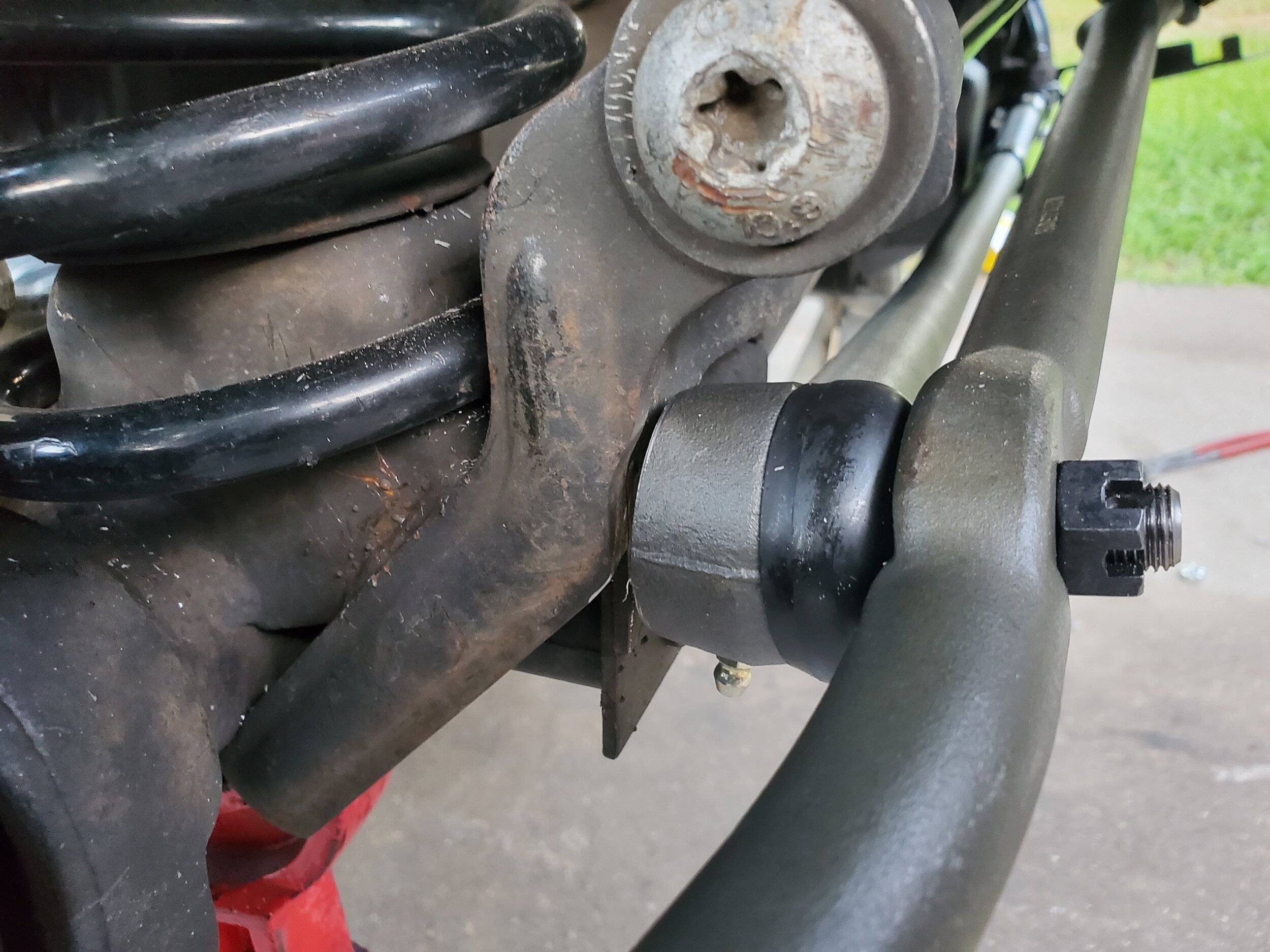

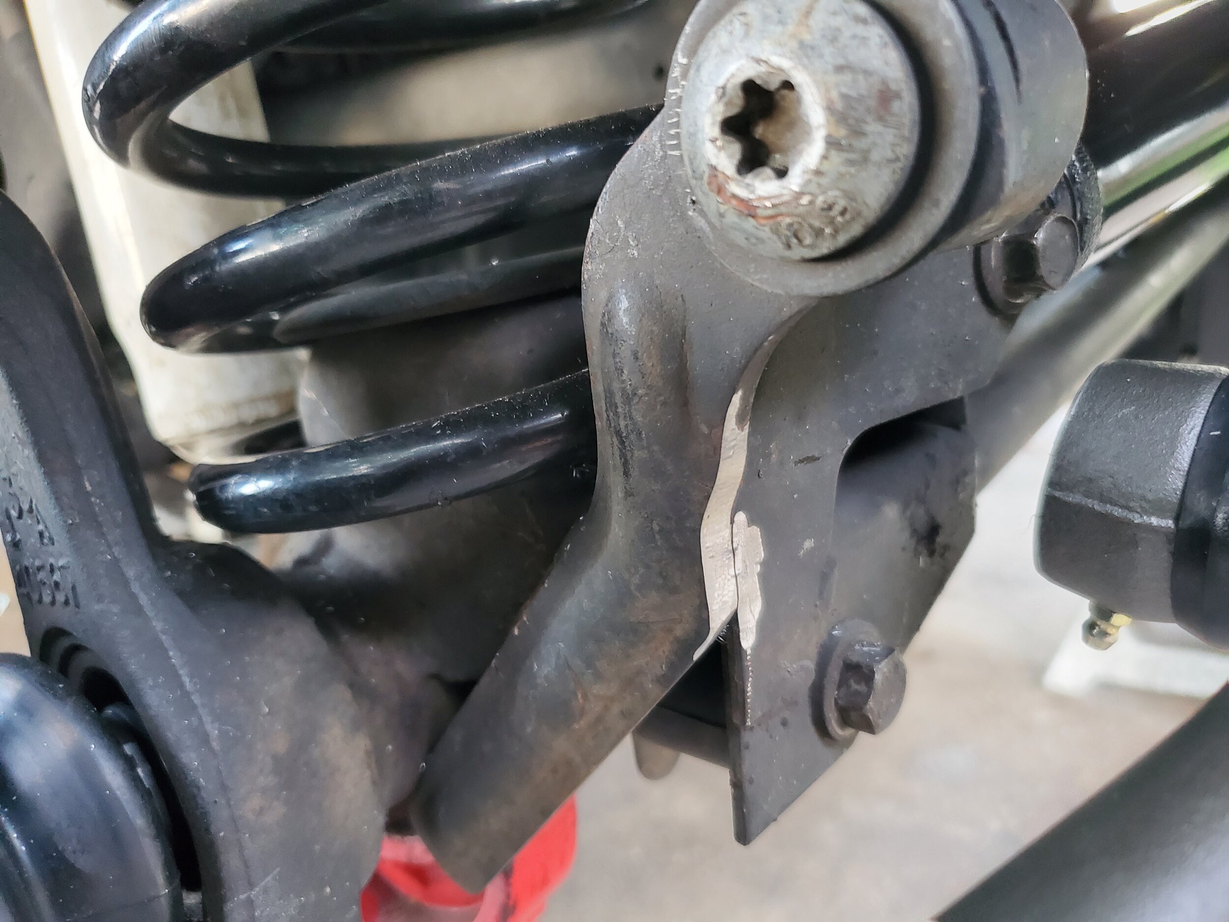

EDIT- I forgot to mention,I had to clearance my sway bar bracket a tad since the joint would smack the bracket ! No biggie about a 2 minute job with a die grinder
At full lock,I wonder if it'll hit once the joint gets older and starts to flop? I imagine so....View attachment 539103

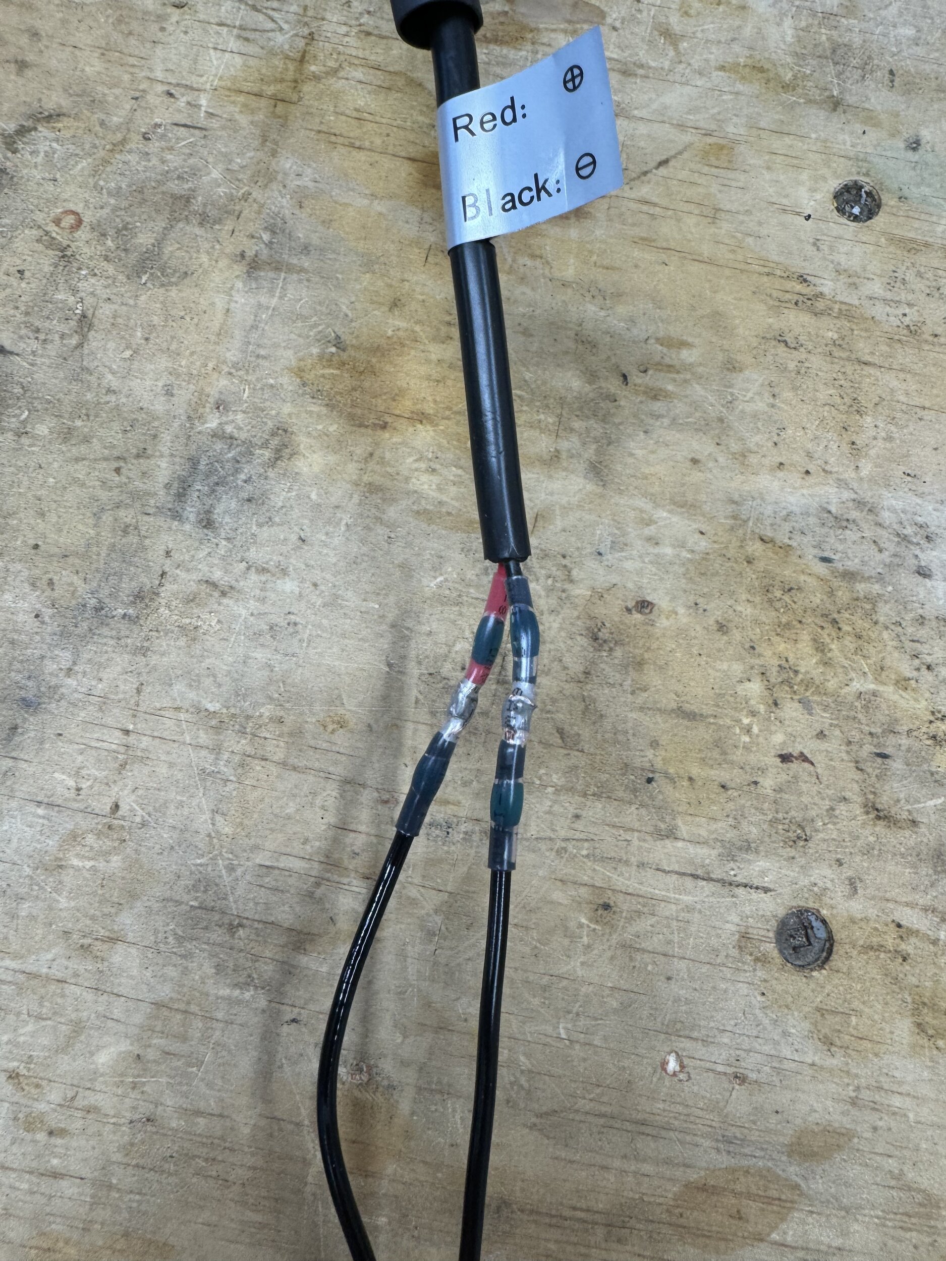

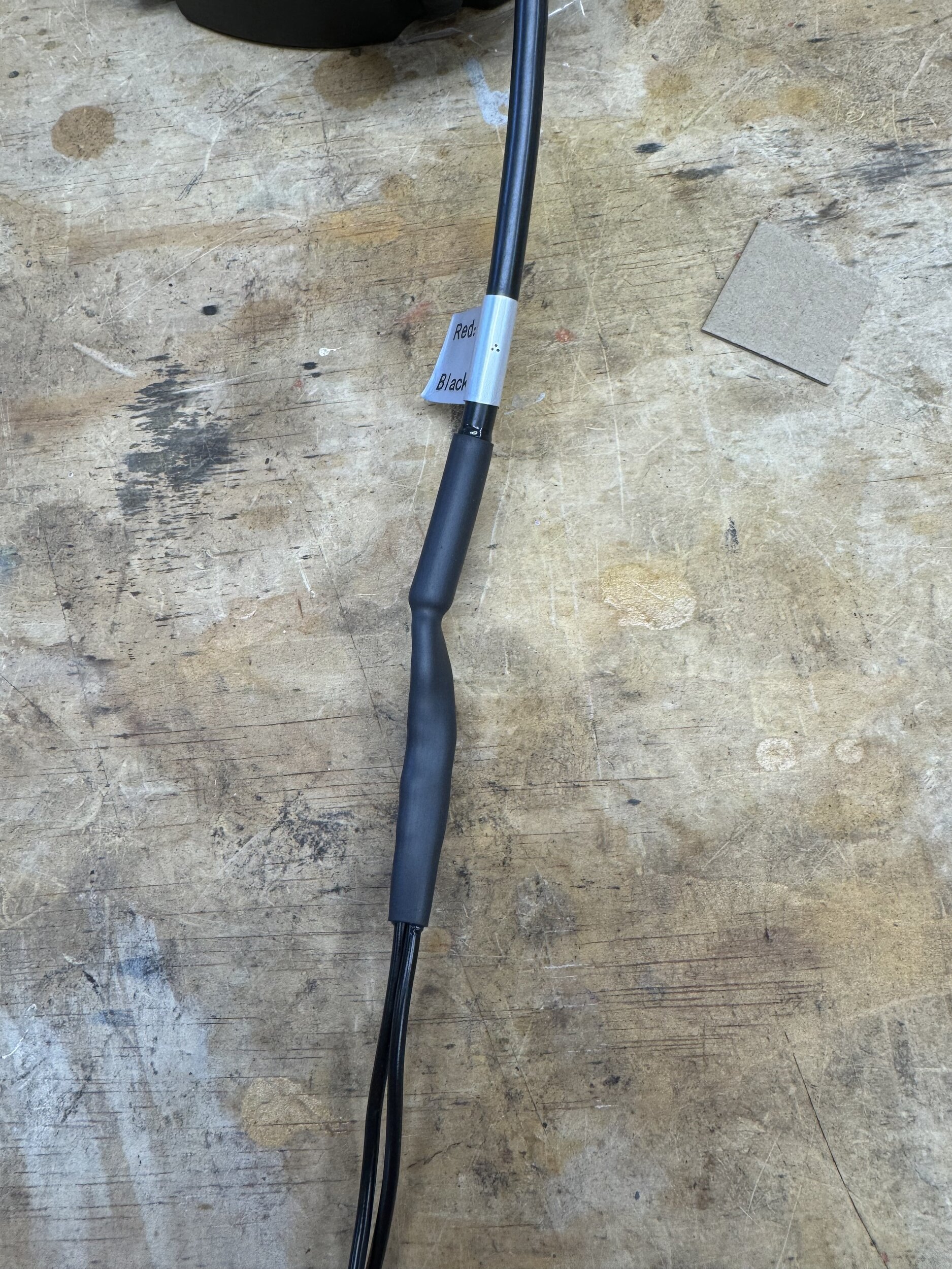

I got some fog light pigtails with the wiring harness. I spliced them into the lights and used some solder seal connectors instead of traditional solder. I found these connectors when doing the stereo work and I liked them then. So, I put them here. I then put another layer of shrink tubing over that just to make it look nice.
