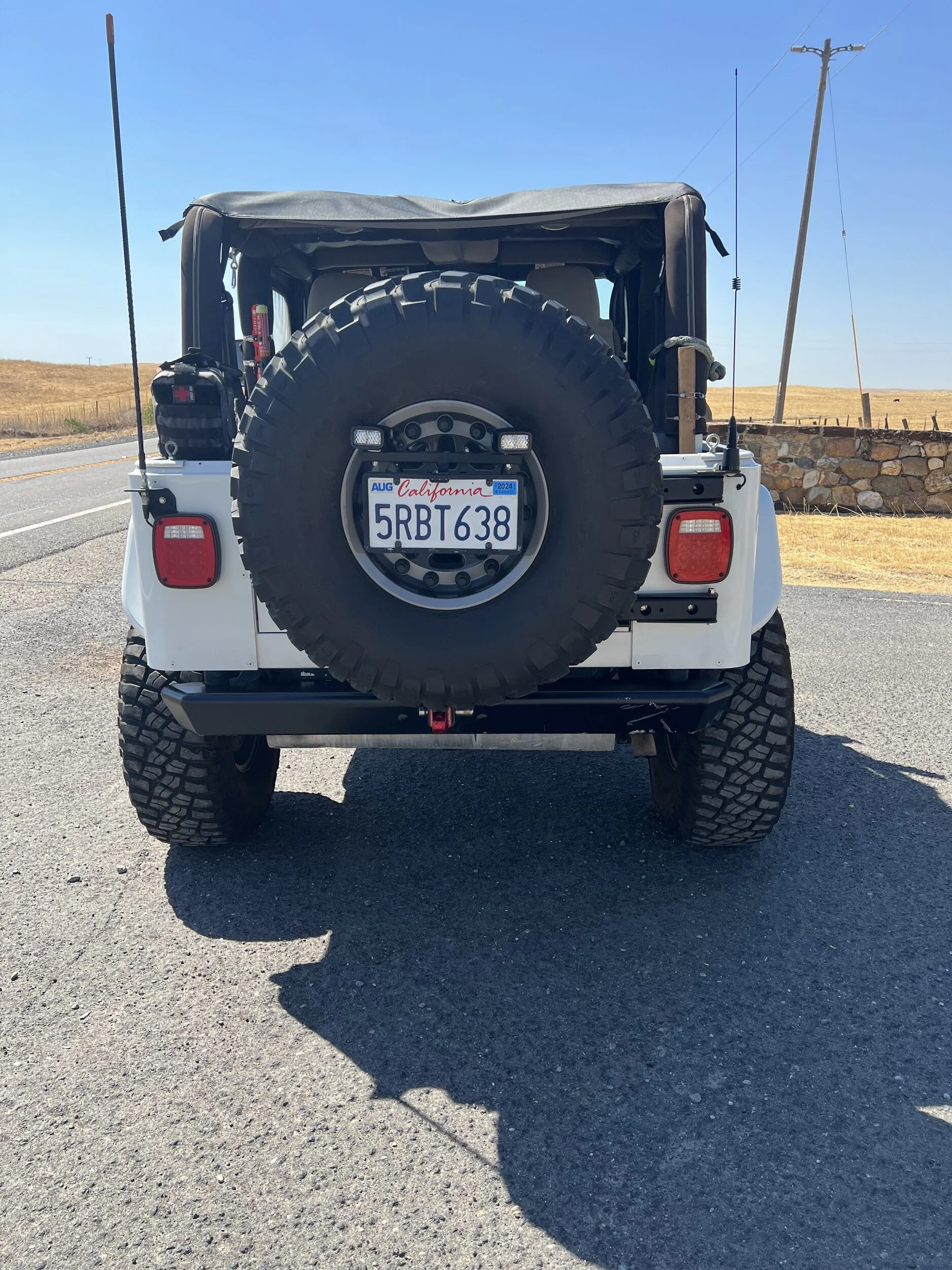

I used one of these for years.
Amazon: D-Ring Hitch Receiver

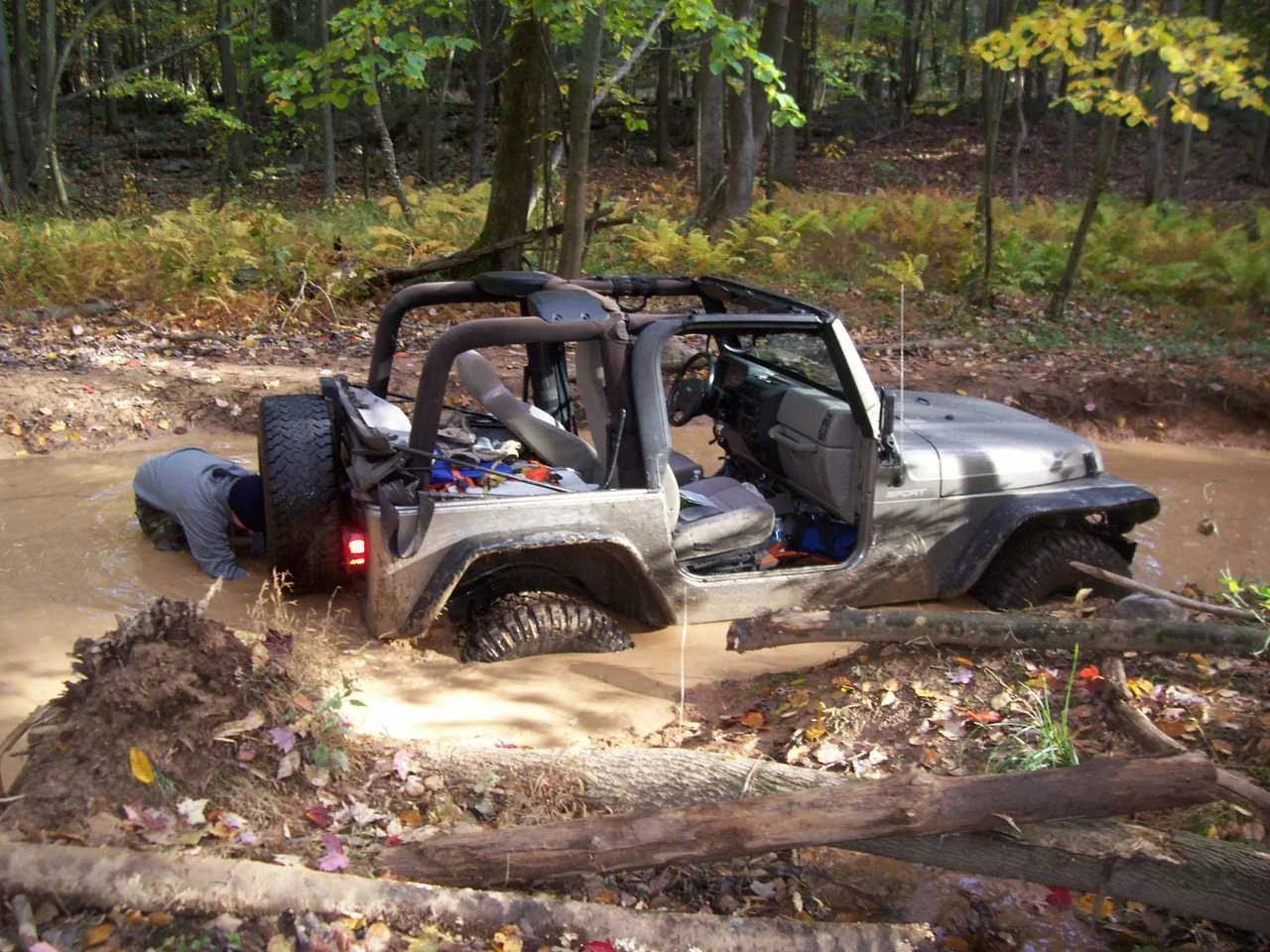

It worked for me in situations like this:
But, this situation had me hooking up the recovery strap to the D-ring and throwing it up in the bed at the start of future rides to be ready to recover.

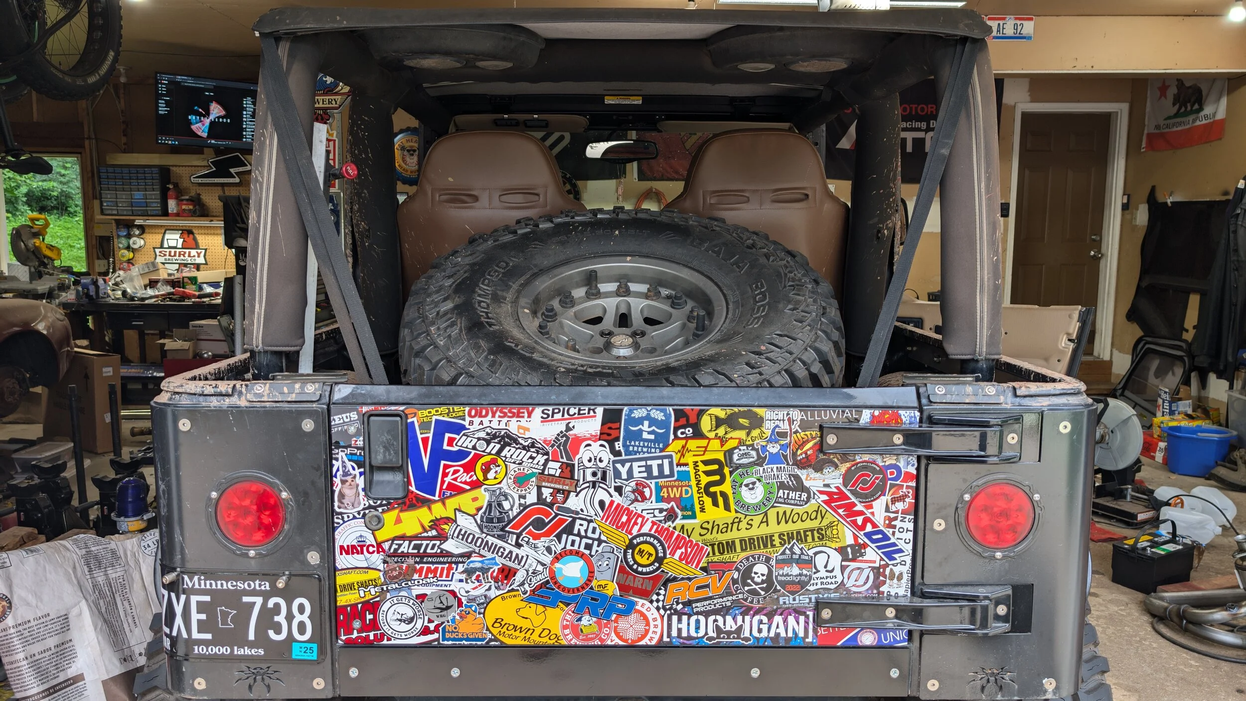

Otherwise, you look like this...
If you don't play in mud, that prep hook-up may not be needed, but the recovery point works well paired with a good snatch strap. I have a 30' non-stretch (aka not a Bubba rope) that served my group well.
I've had this strap that served me well: Strap
you've got a smile on your face. I don't see the problem here.

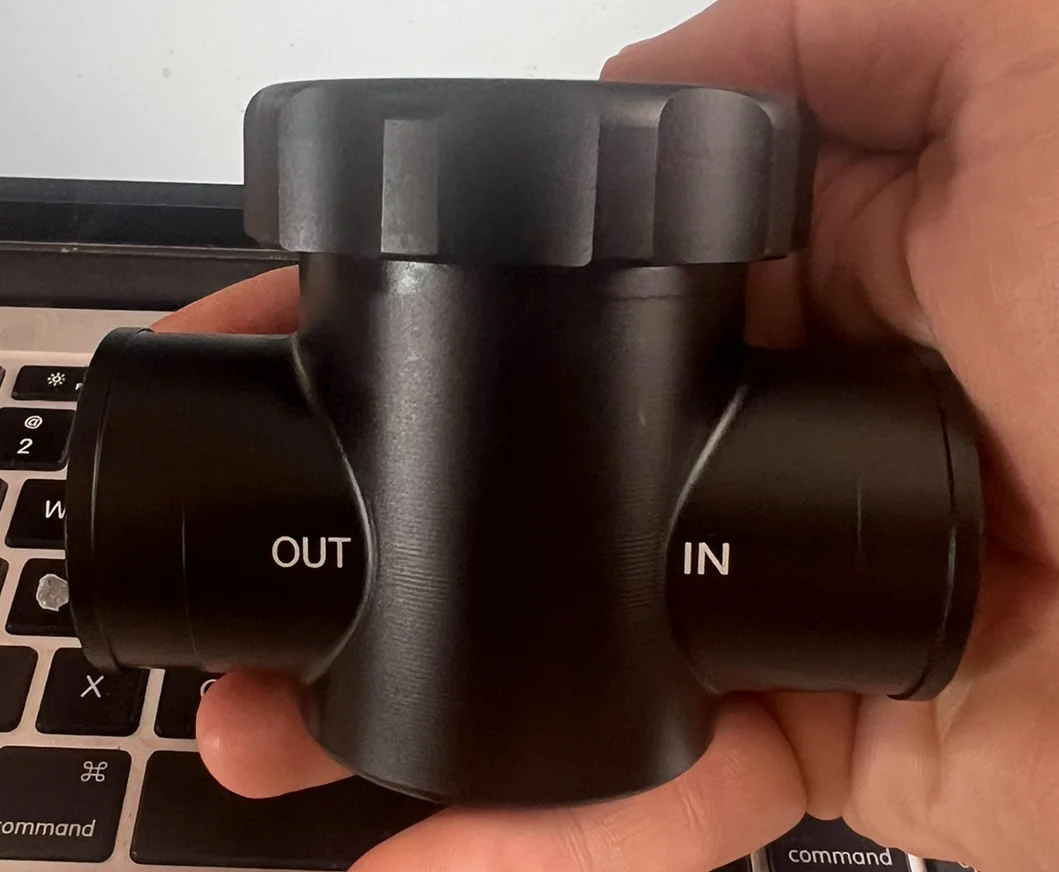

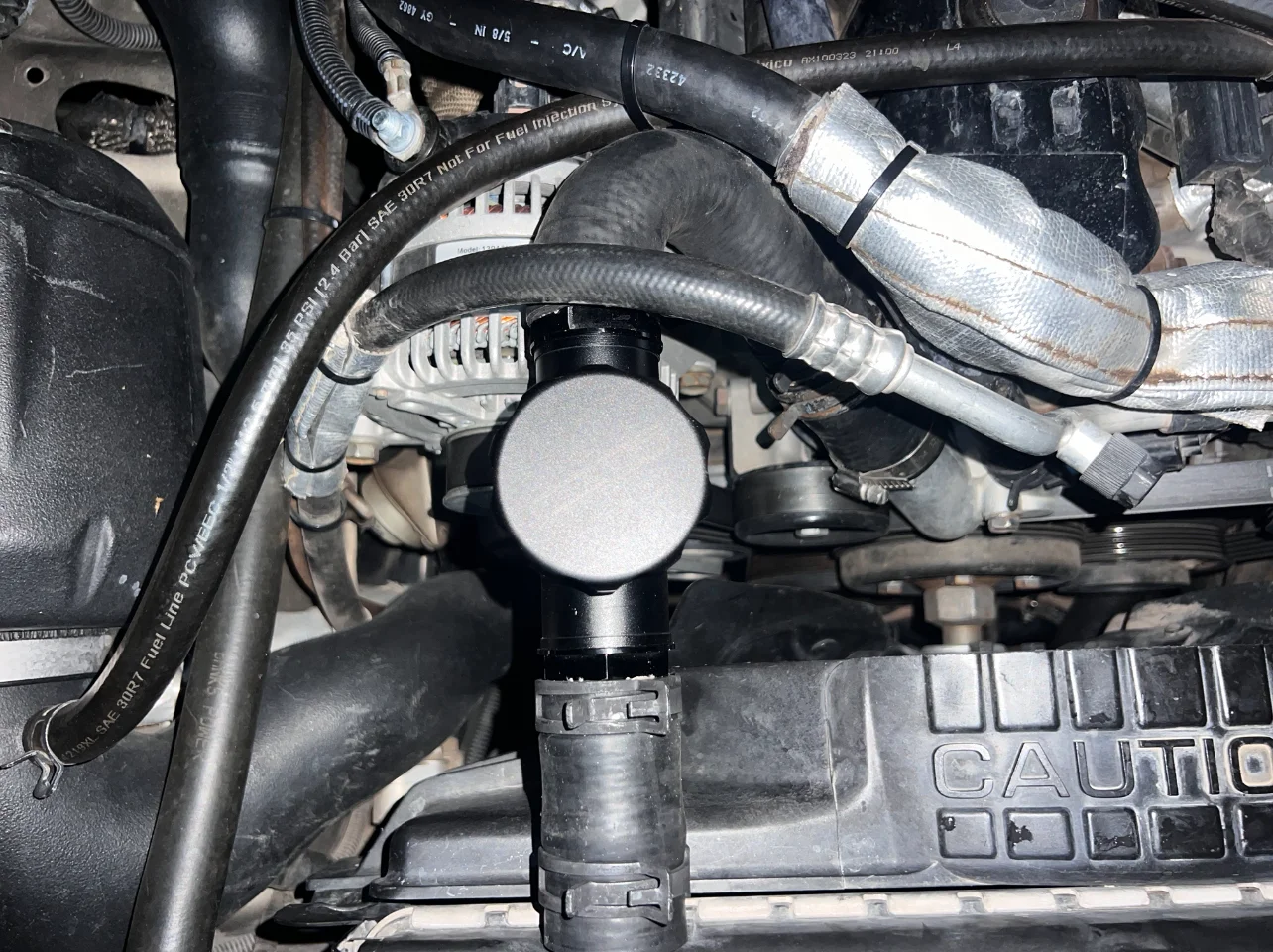

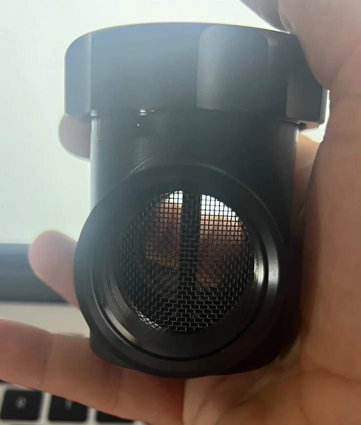

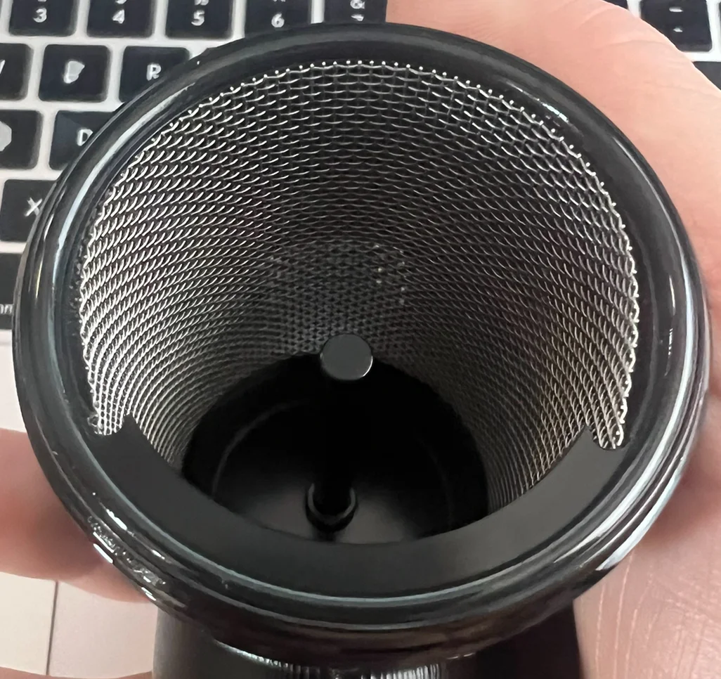

Moved the coolant screen to the upper radiator hose after taking a flapper wheel to shorter fittings I found online and getting the plumbing to fit & align. This should help prevent flakes and crud from plugging up the radiator.
What exactly is that? How hard is it to check to make sure it's not plugged up? Is it able to be cleaned or maybe have a replacable filter in there?
Not that I need one now but you never know what Jeep comes next.
It’s an inline screen and also a filler. It was the only option I found that didn’t seem like a bad idea.
Aeroflow PN: AF64-2043
The cap comes off and the screen comes out. No worries about it getting plugged up due to the internal design.
Edit:
@Duner @JEEPCJTJ @JasterMereel42 … I was able to clog the screen up last night, which caused over heating issues…I did so by using thermocure flush with the screen in (it got hot and the thermocure solidified against the screen). So it is possible to clog up after all. I pulled the screen and all is normal. I’ll put it back in after the thermocure flush is complete. I didn’t have this issue before when it acccumulated smaller bits, but I now know it’s possible to act like a closed thermostat. I don’t want to hurt anyone so I wanted to share this right away.

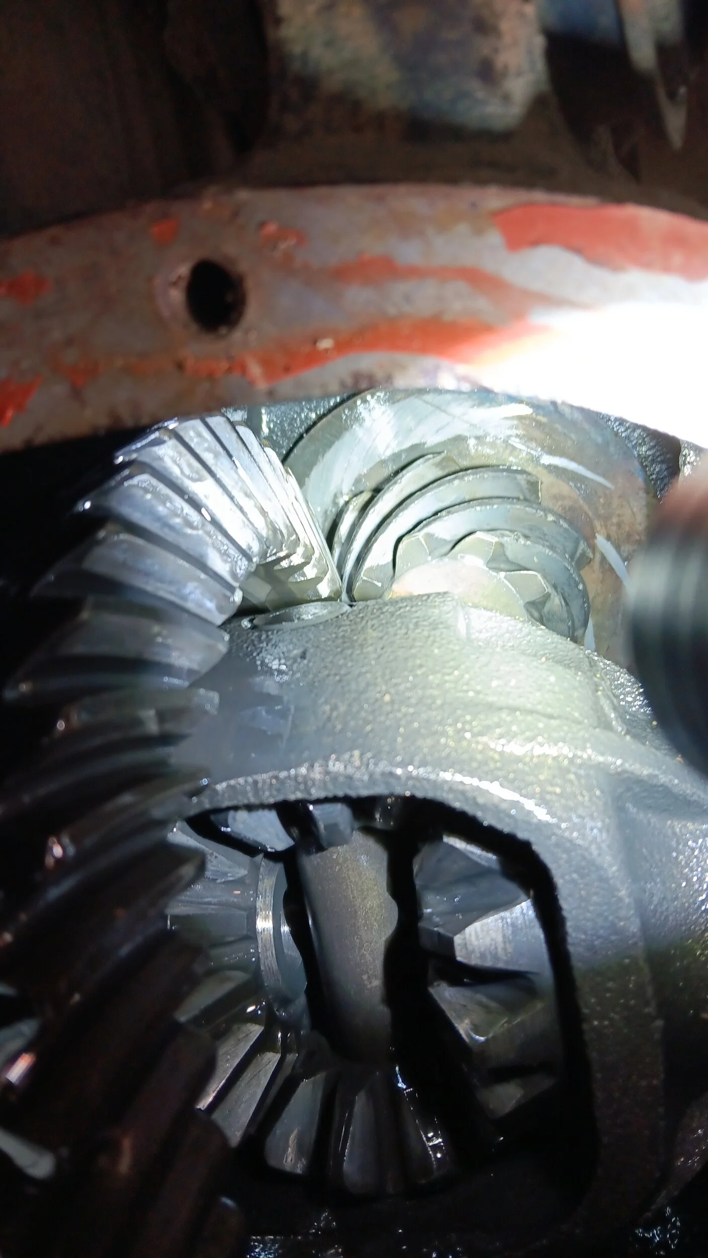

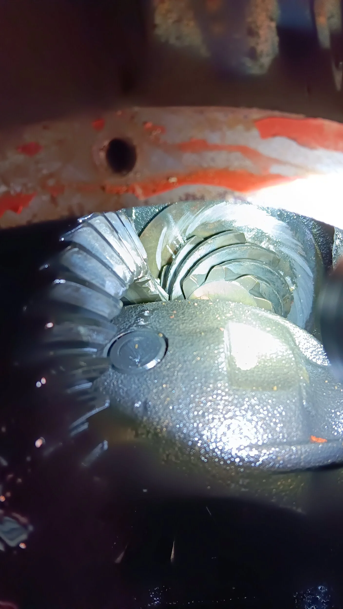

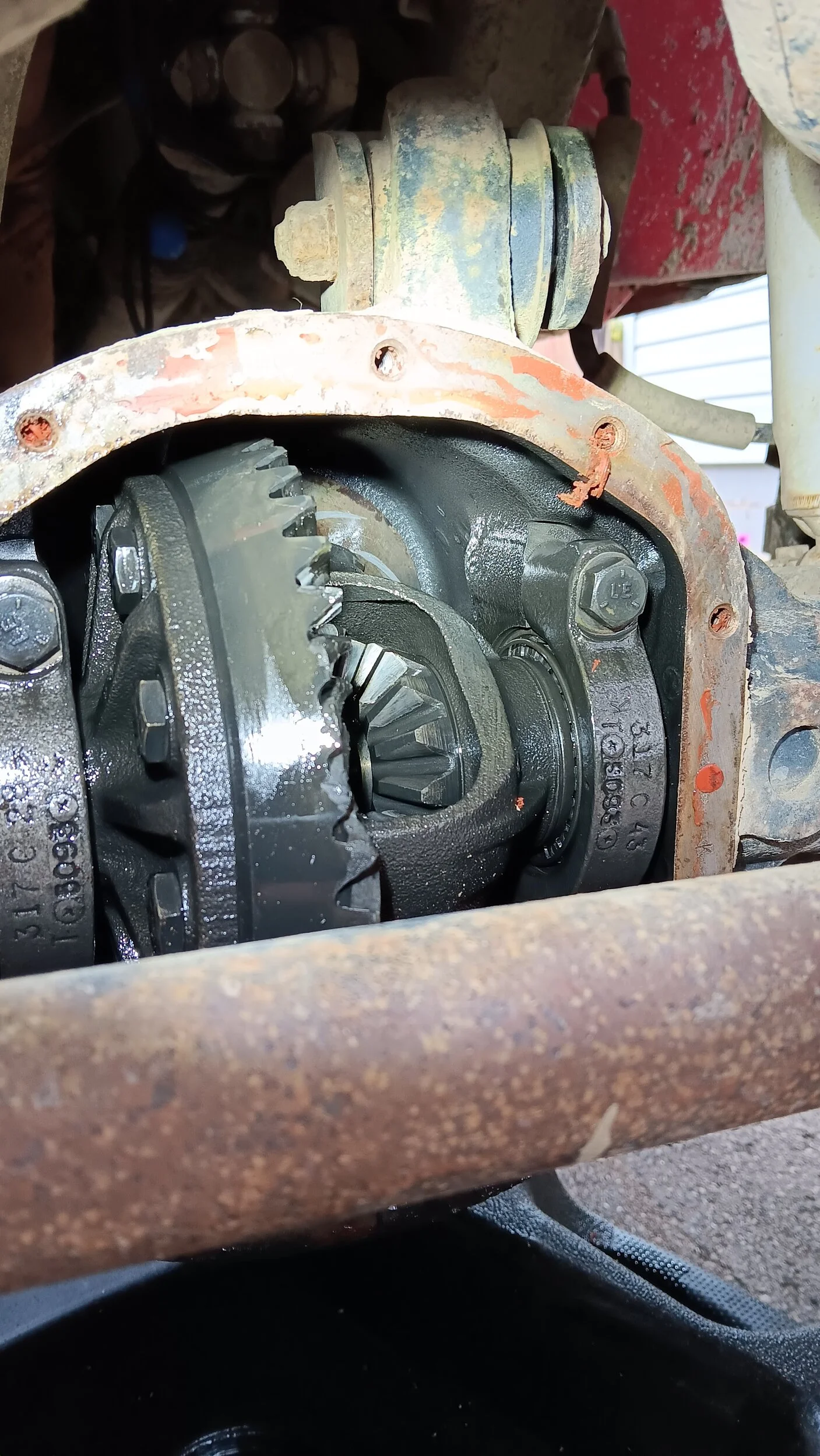

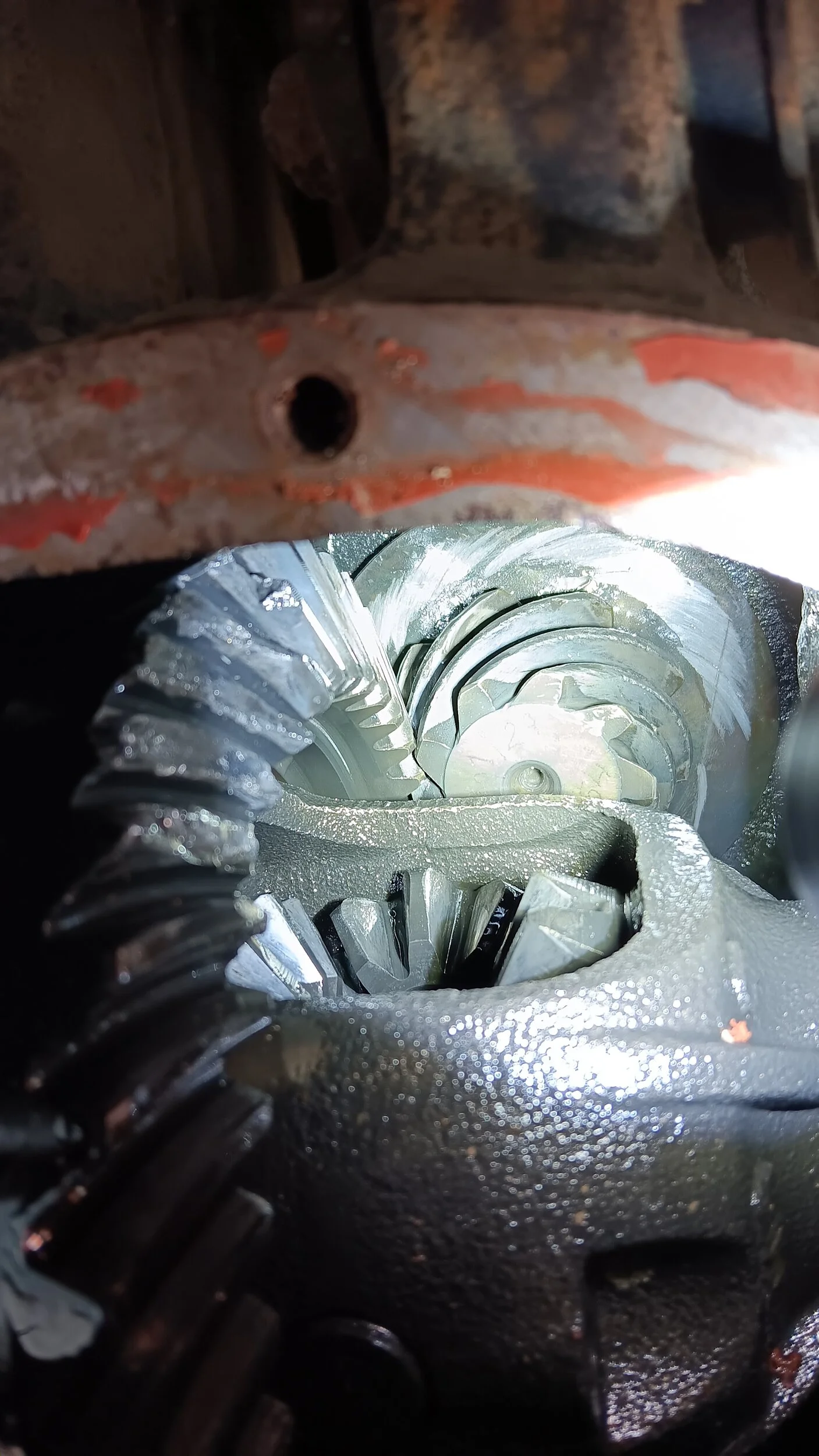

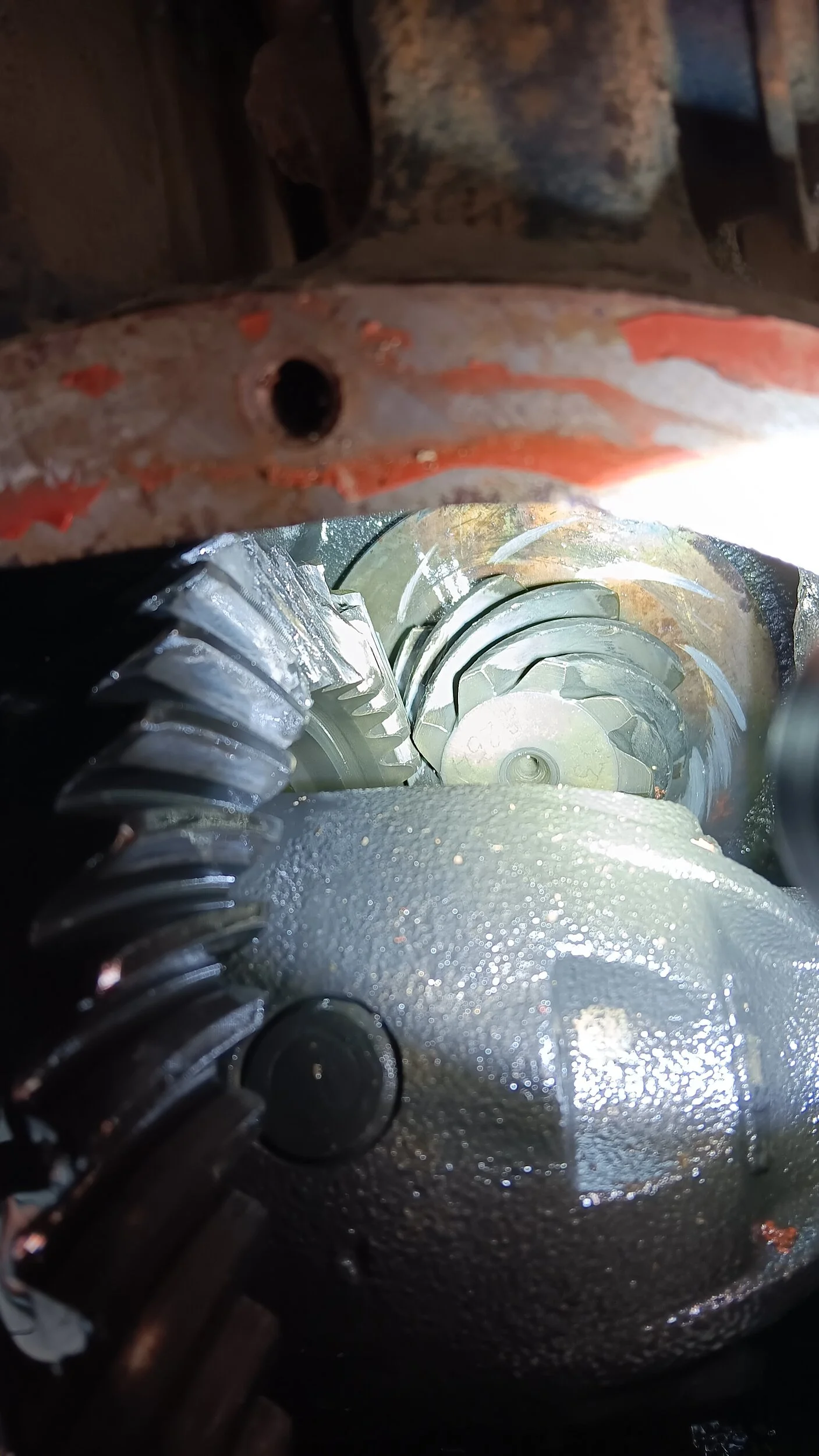

Opened the front diff today. Fount teeth missing off the ring, but the pinion looks ok. A finger across the points of the pinion teeth feel a little rough, but none broken or chipped.
The question is, just a new ring, or would an entire gear job be advised?
97 4.0 5 speed 4.56 35s hp30
Thanks for any input
@hosejockey61
@Blackjack
@hosejockey61
@Blackjack
Replace the ring and pinion , inspect the spider and end gears , replace the bearings and seals after a through cleaning.

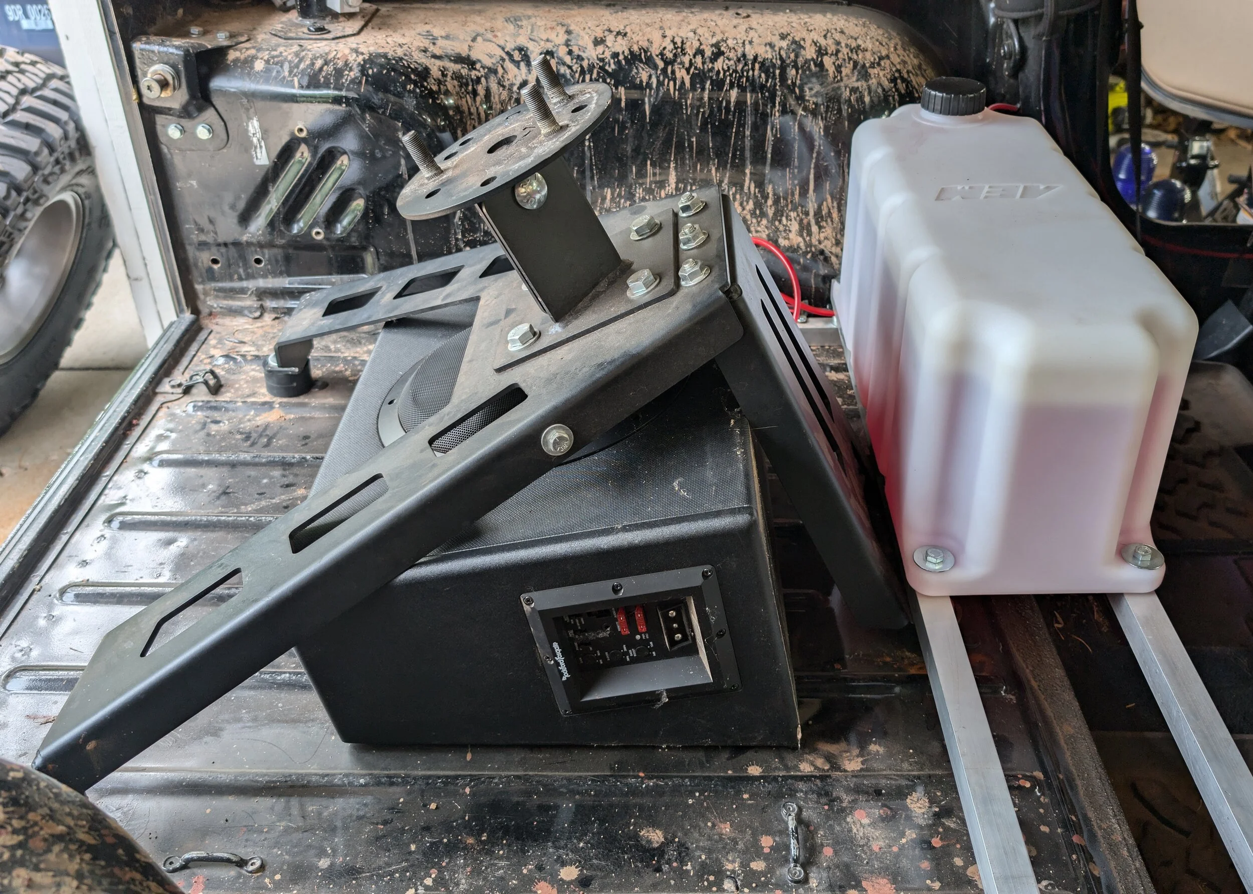

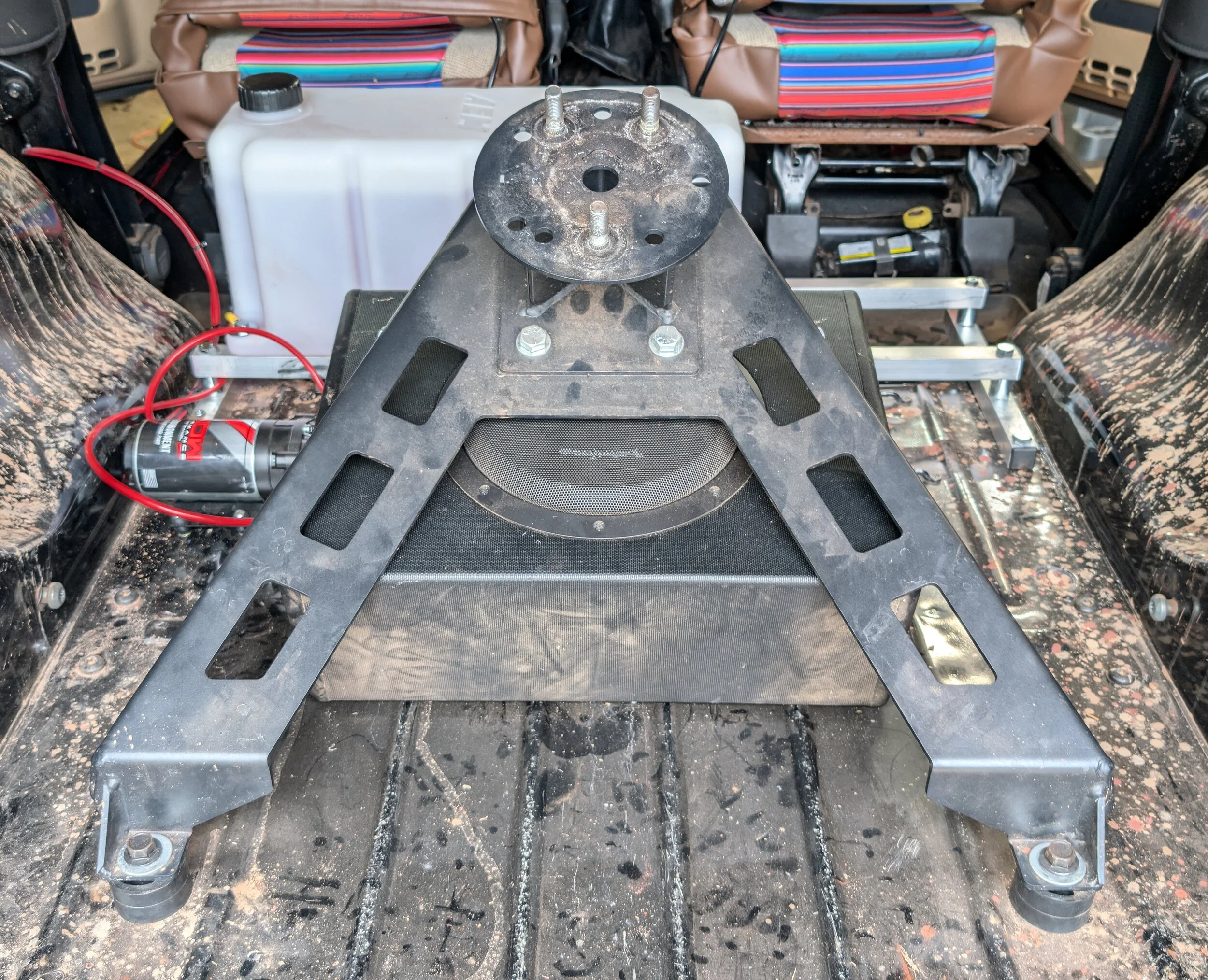

Didn't do as much today as I wanted to. Pulled the center console to run heated seat wiring, then saw that stupid factory sub box and remembered I had a 10" Rockford Fosgate in the corner of the garage, and had an idea. So, I found a place for the sub. Need to order another wiring kit for it.
I'd love to get my hands on one of the big empty center console inserts if anybody has one... would trade for the sub enclosure and coin tray insert

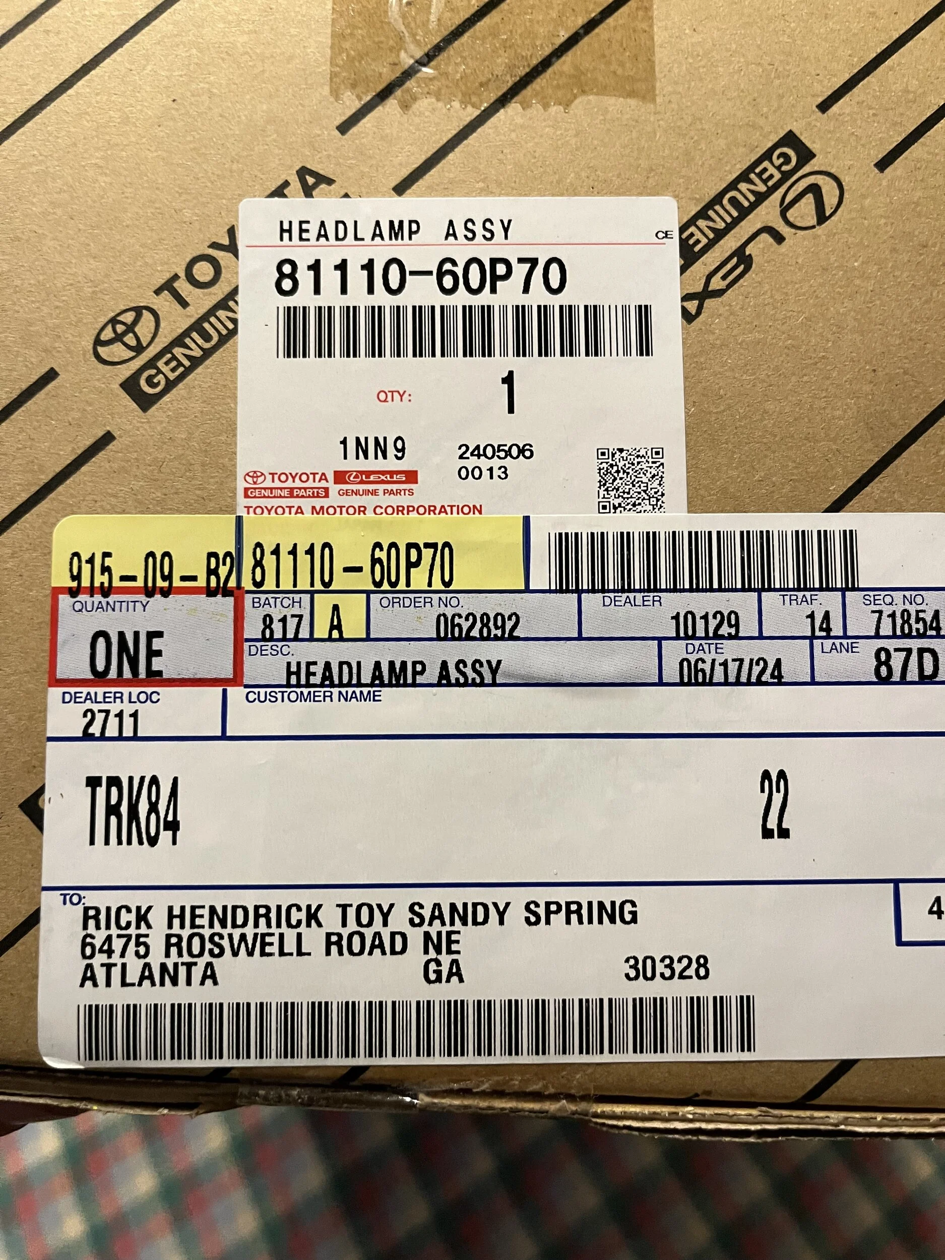

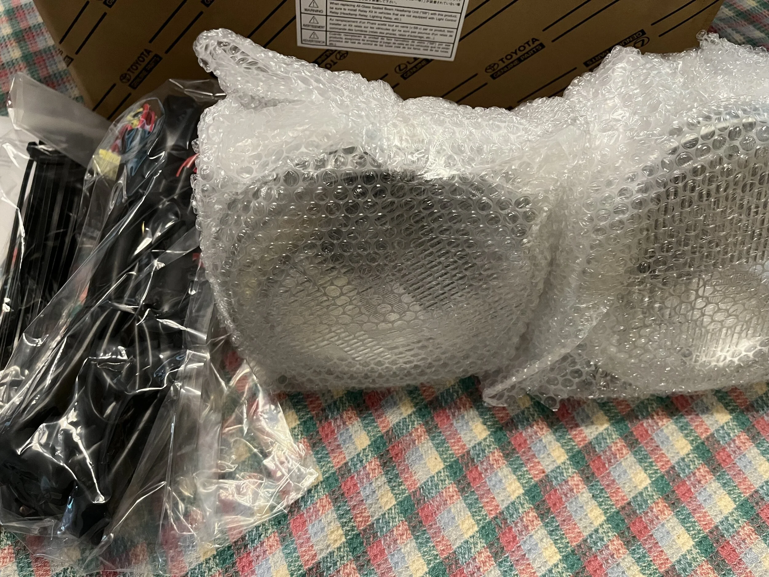

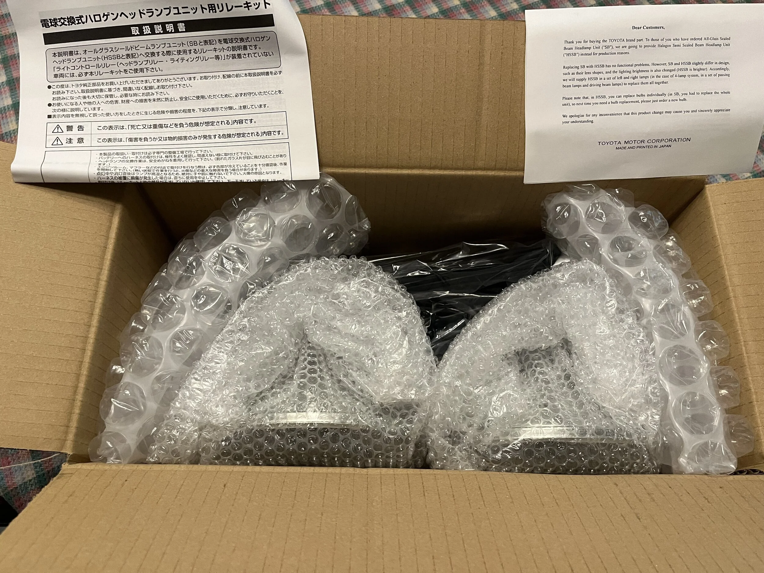

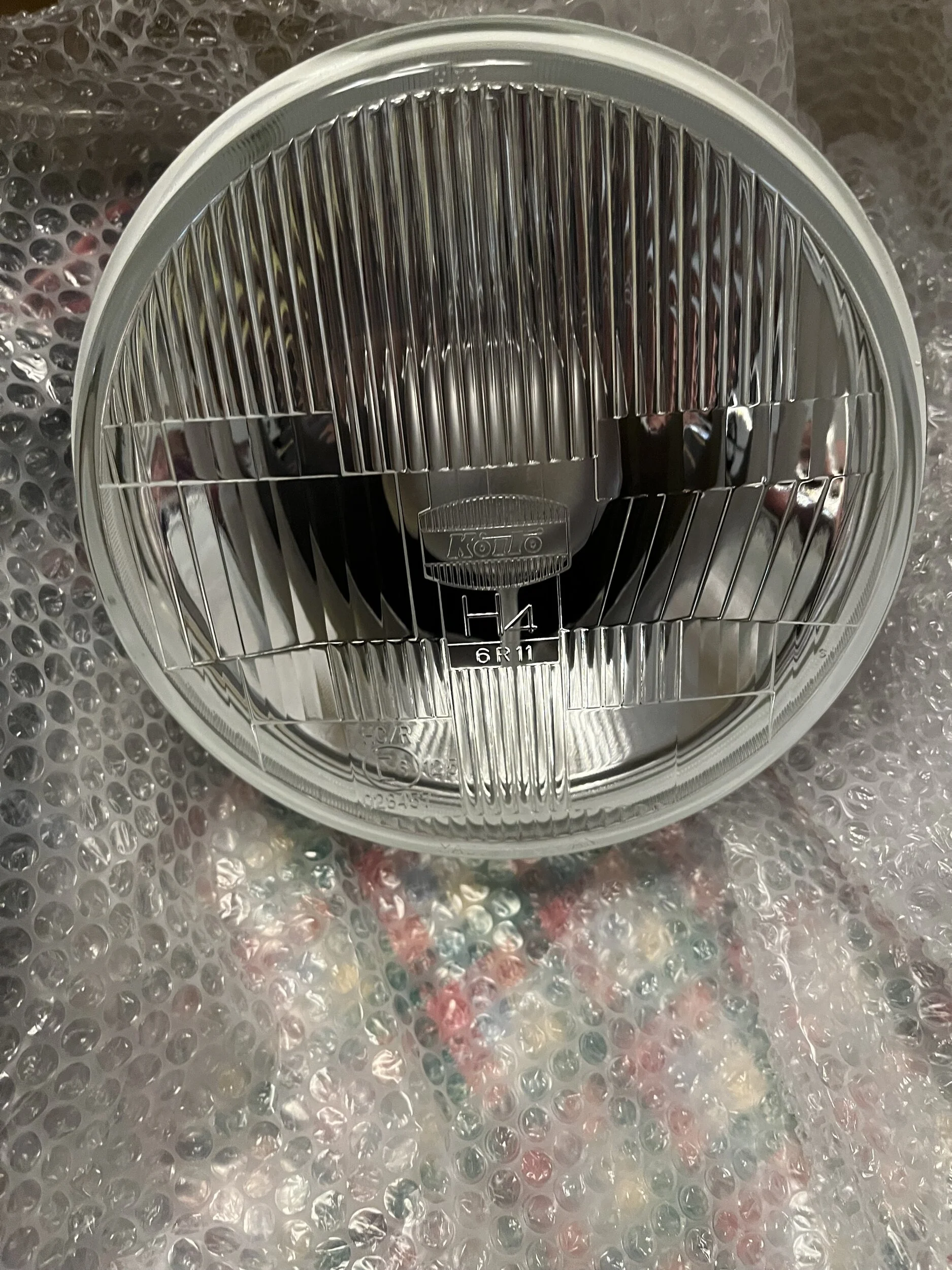

Picked up my light kit from the Toyota dealership today.
Many thanks to @red02tj for pointing out the $14 price.
When I walked up to the counter and the guy brought it out, he says, 'So what year is your Jeep?" 🤣
He said they process anywhere from 17-20 of these kits per week, most of them shipped out.
Hopefully get a chance to install it soon.
Heck of a kit for $14.
The harness and relays are very beefy.
It includes a handful of heavy duty zip ties as well.
