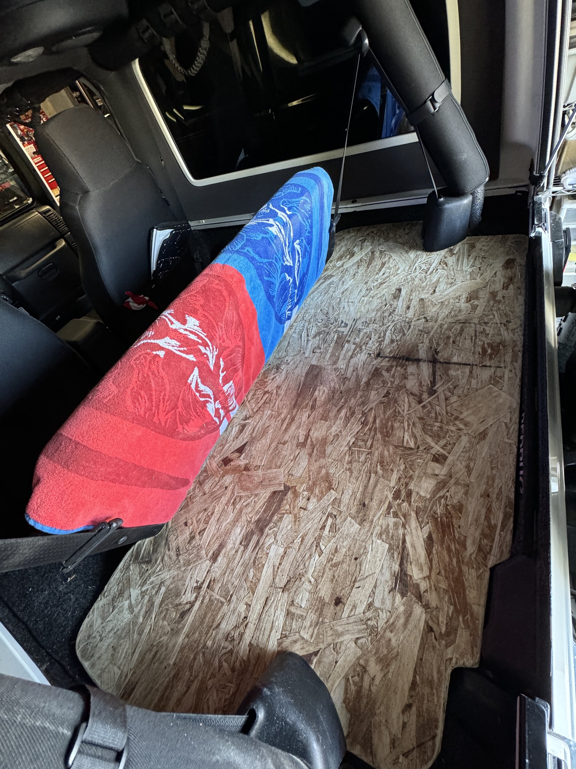

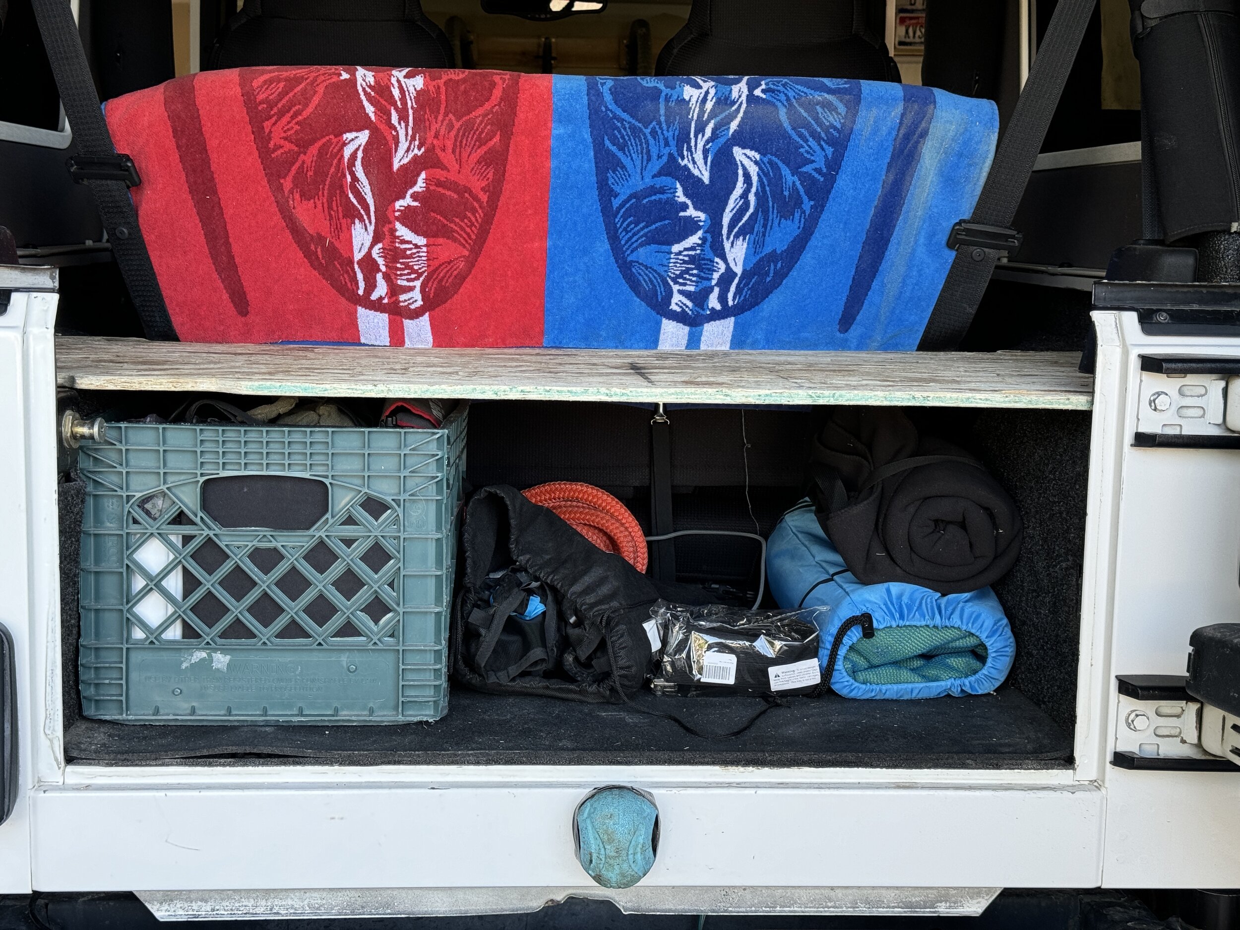

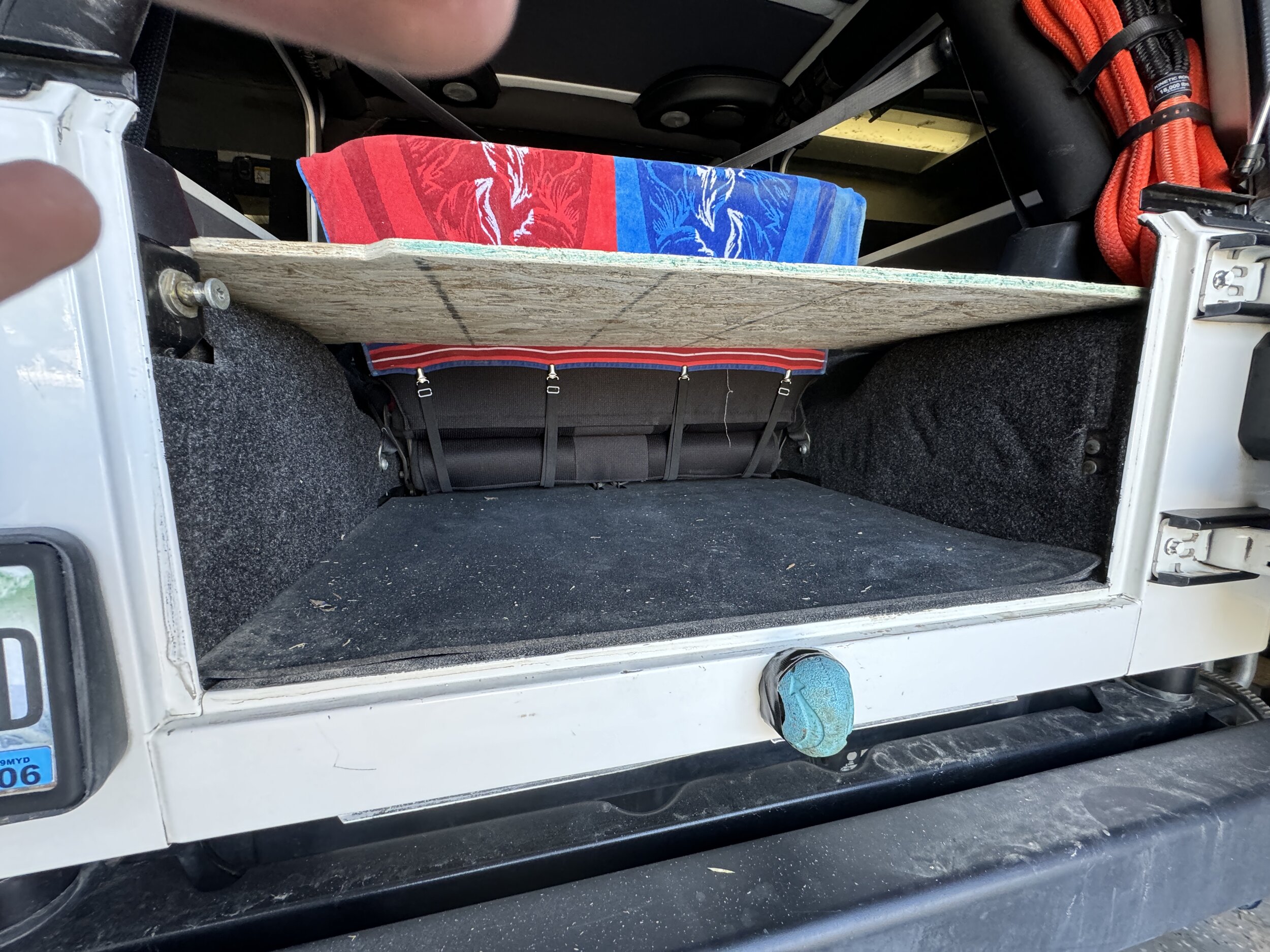

Been wanting to build a cover/storage for a while. Liking the first prototype so far. In the future I’ll use better quality wood, rubber (1/4 treadmill mat has worked really well for the bottom of the cargo area), and probably some kind of tracked tie down system on top. Also will do some type of system to tie it into the seat belt bolts on the bottom to minimize risk of it moving around.

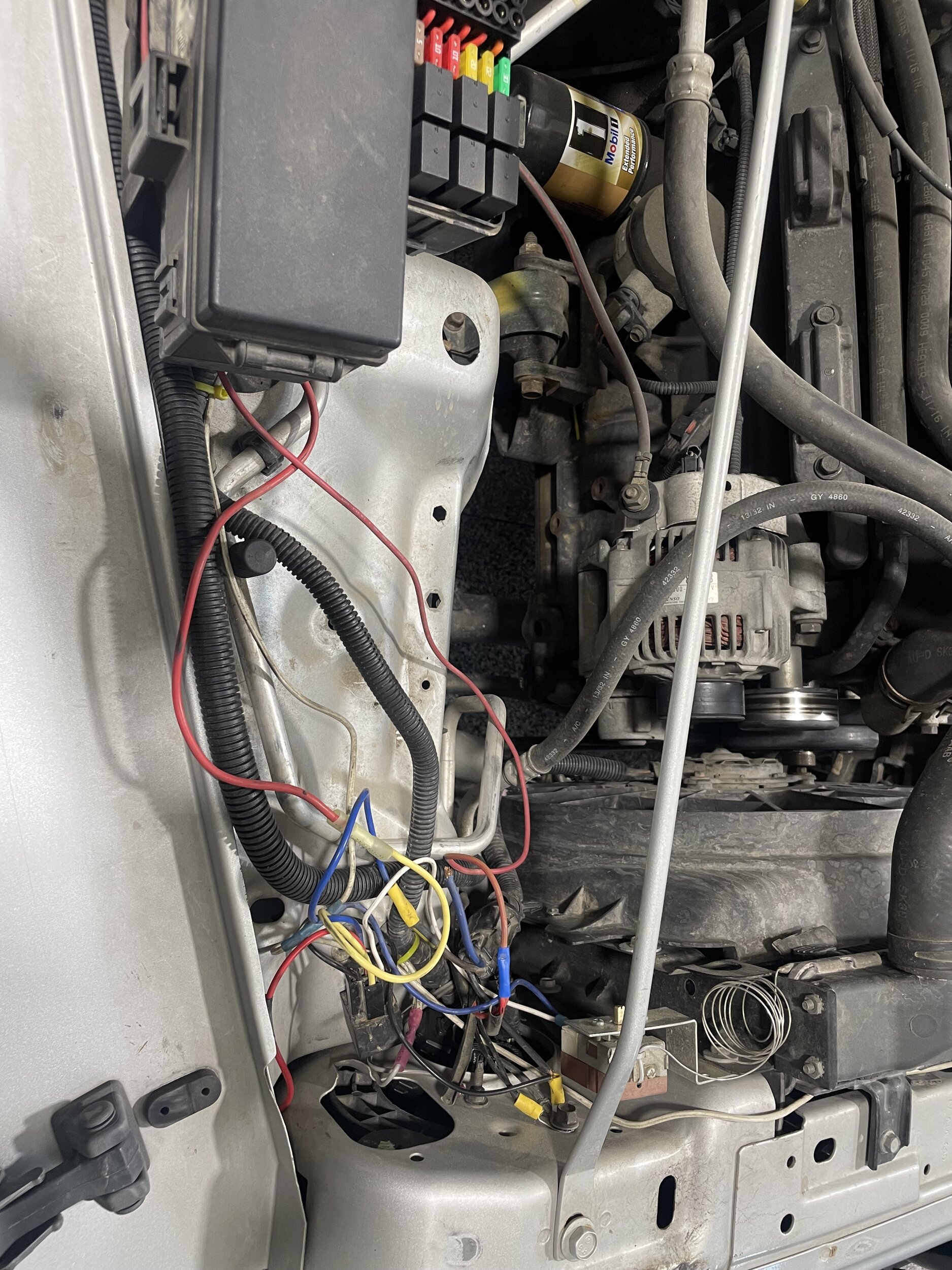

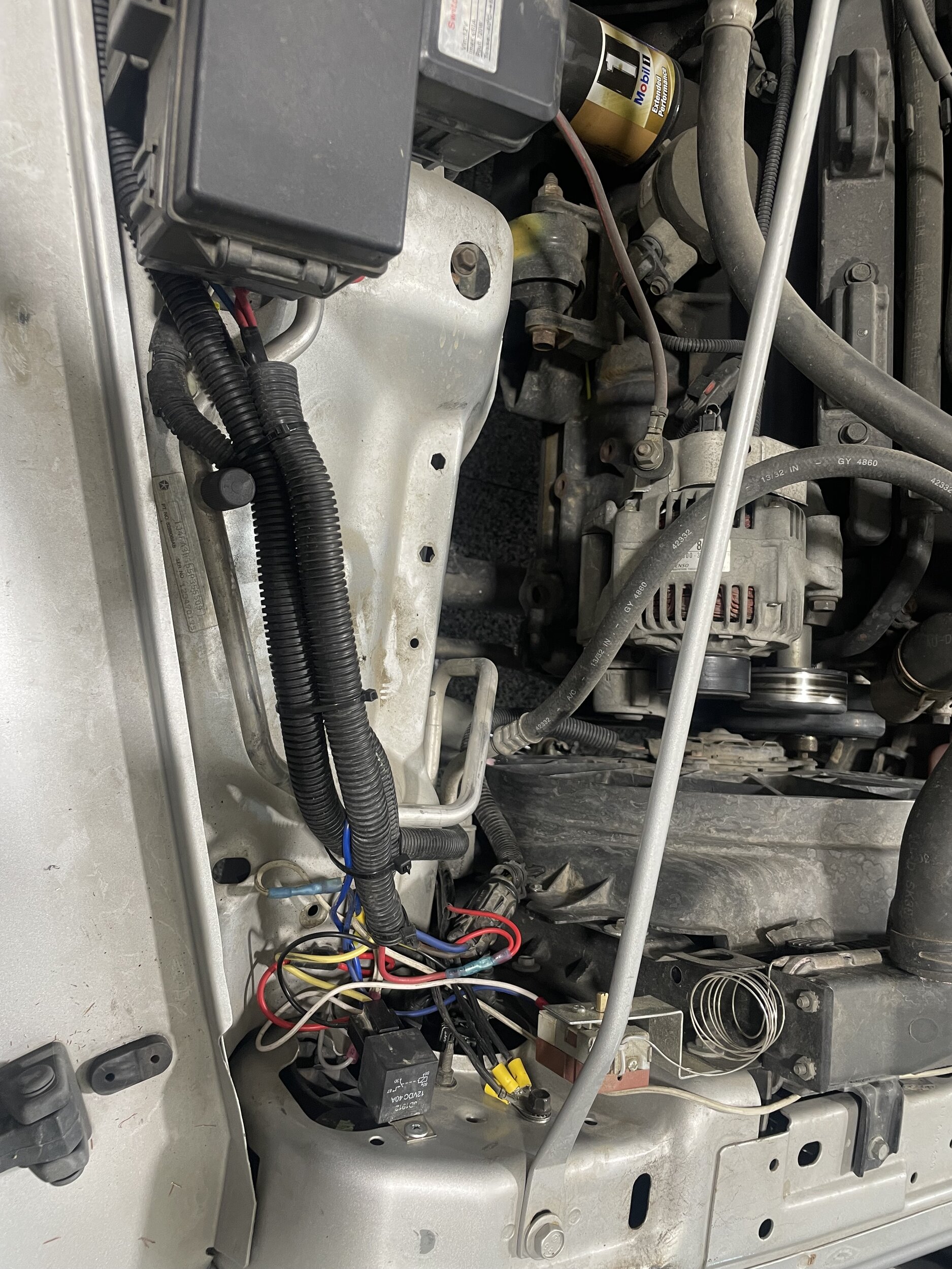

Keeping out of the heat -decided to take on this little rats nest that developed. A little cleaner now and also hooked up the second speed of the cooling fan to a AUX panel. Moves enough air now it could effect my passing speed 😉

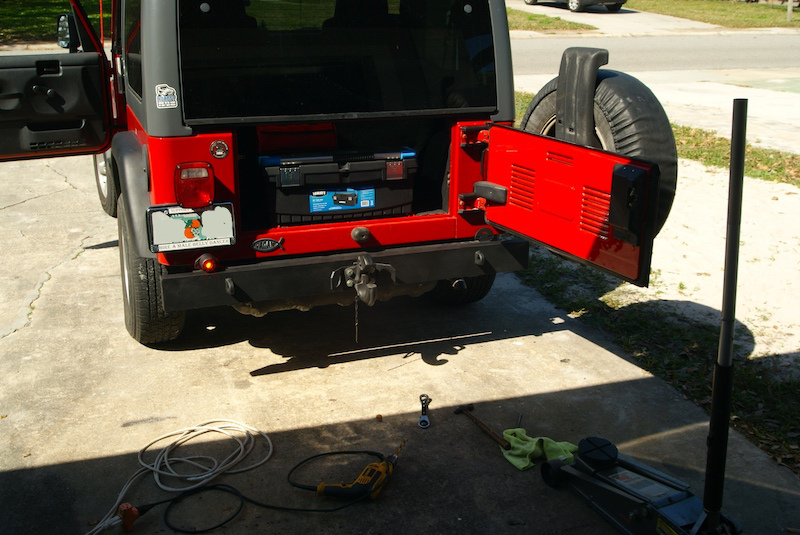

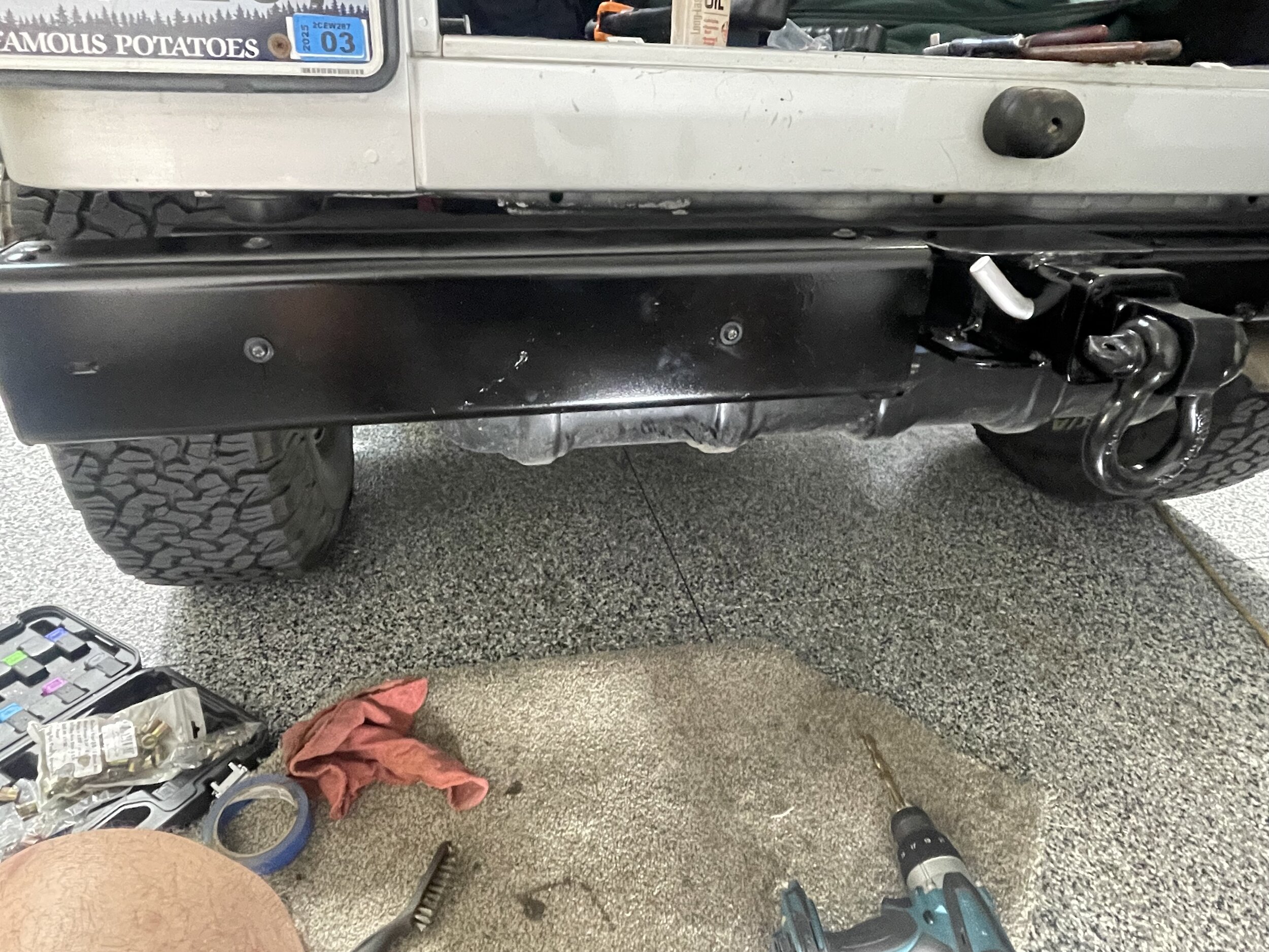

I believe every 4 wheel drive vehicle should have a Pintle Hook. I prefer them to attach a kinetic recovery strap or rope. I bought this adapter for my 4 X 4 Tacoma before I bought my TJ.
Amazon https://www.amazon.com/dp/B0BDF9WT2R?tag=wranglerorg-20 you can get other configurations to drop or raise the height if you need to.
I didn't like the way it stuck out so much with the factory 5/8 hitch pin hole so I drilled another hitch pin hole about 2 and 3/8ths inches further back. You will need to carefully locate and center punch the drill bit starting pilot hole. clamp the adapter securely on your drill press table and drill slowly working up in drill bit sizes about a 1/16th inch at a time. I called a machine shop to have it done but his minimum job charge was $110.00.
Installed in standard hole
Installed in the hole further back
