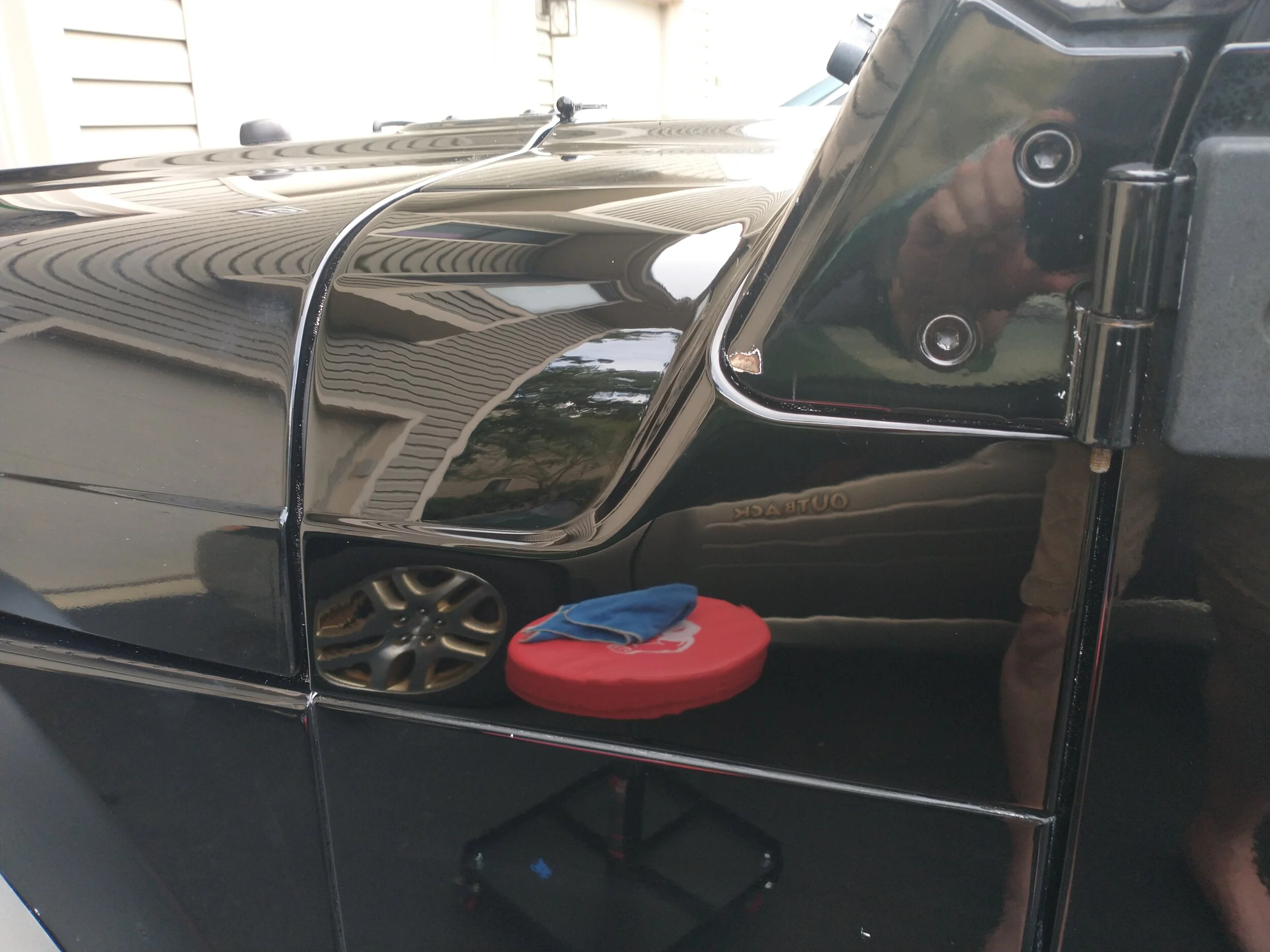

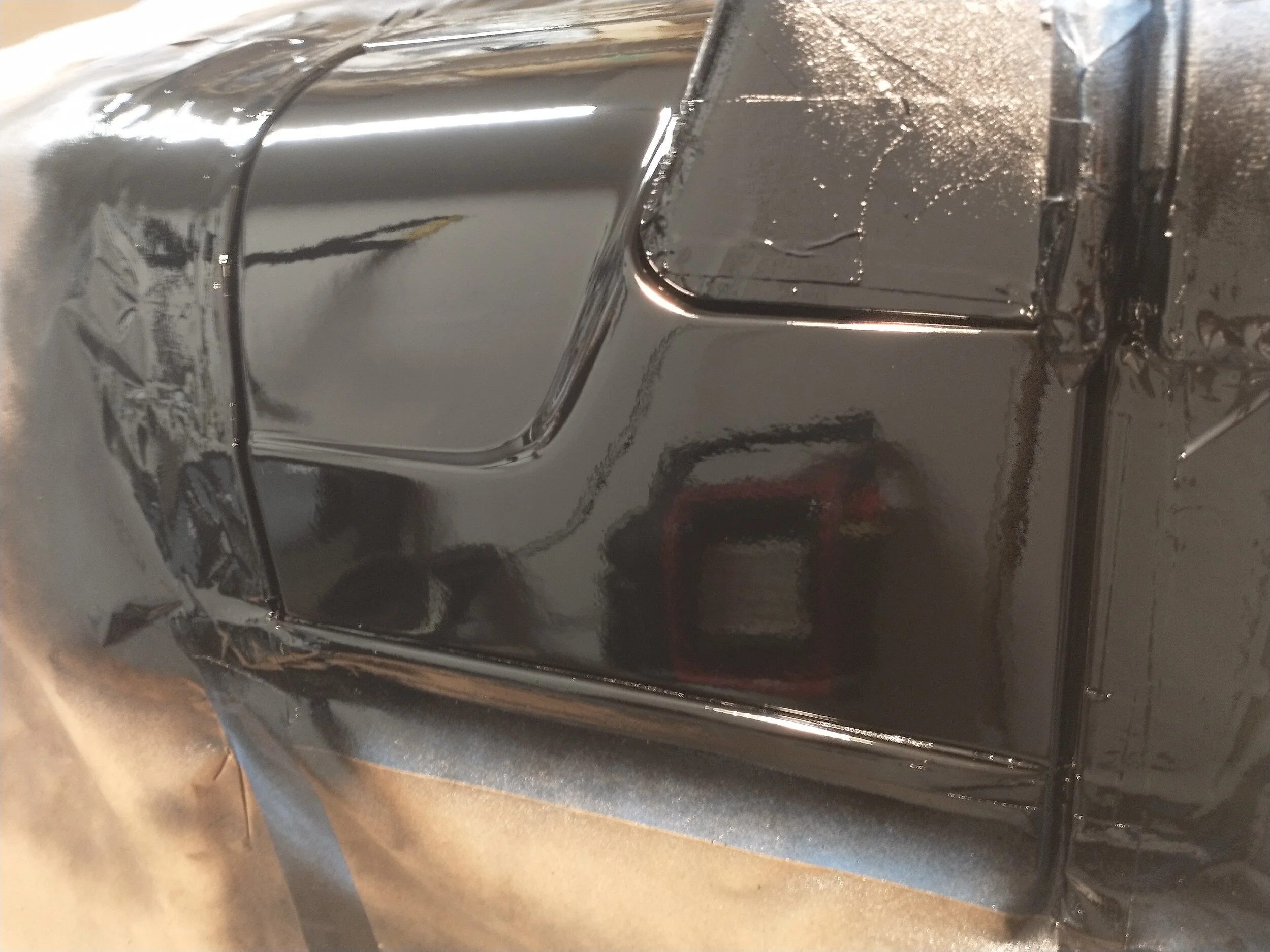

Finally got around to finishing up a body repair this weekend that I started last November. My LJ had one rust issue when purchased in May '23, a nice blister formed over many years under the "Trail Rated" logo on the driver side.
I cleaned out the rust and shot it with a couple coats of color followed up by a catalyzed 2k clear coat. Not too bad for rattle cans in my garage in winter but I had plans to do more with it when the weather improved.
After letting things cure well and, quite honestly, forgetting about it for a few months, it was time to flat and polish the area. After 1500 and 2000 grit wet, hot enough to melt the balls off a brass monkey so the wet sanding was a welcome task.
After a few passes each with compound, polish and wax. I'm old school and used to using corded cast metal buffing machines with wool bonnets, but I managed this with a Ryobi 18v cordless 5" DA polisher and a variety of foam pads. I snagged a red "Trail Rated" emblem from a Trailhawk (?) to replace the original gray one, thought the red might look sharper on the black.
Pretty happy with the results, the only suck being that I now have abolutely no choice but to polish out the rest of the vehicle. :D I don't think that clear coat has seen love since it left the stealership back in '05.

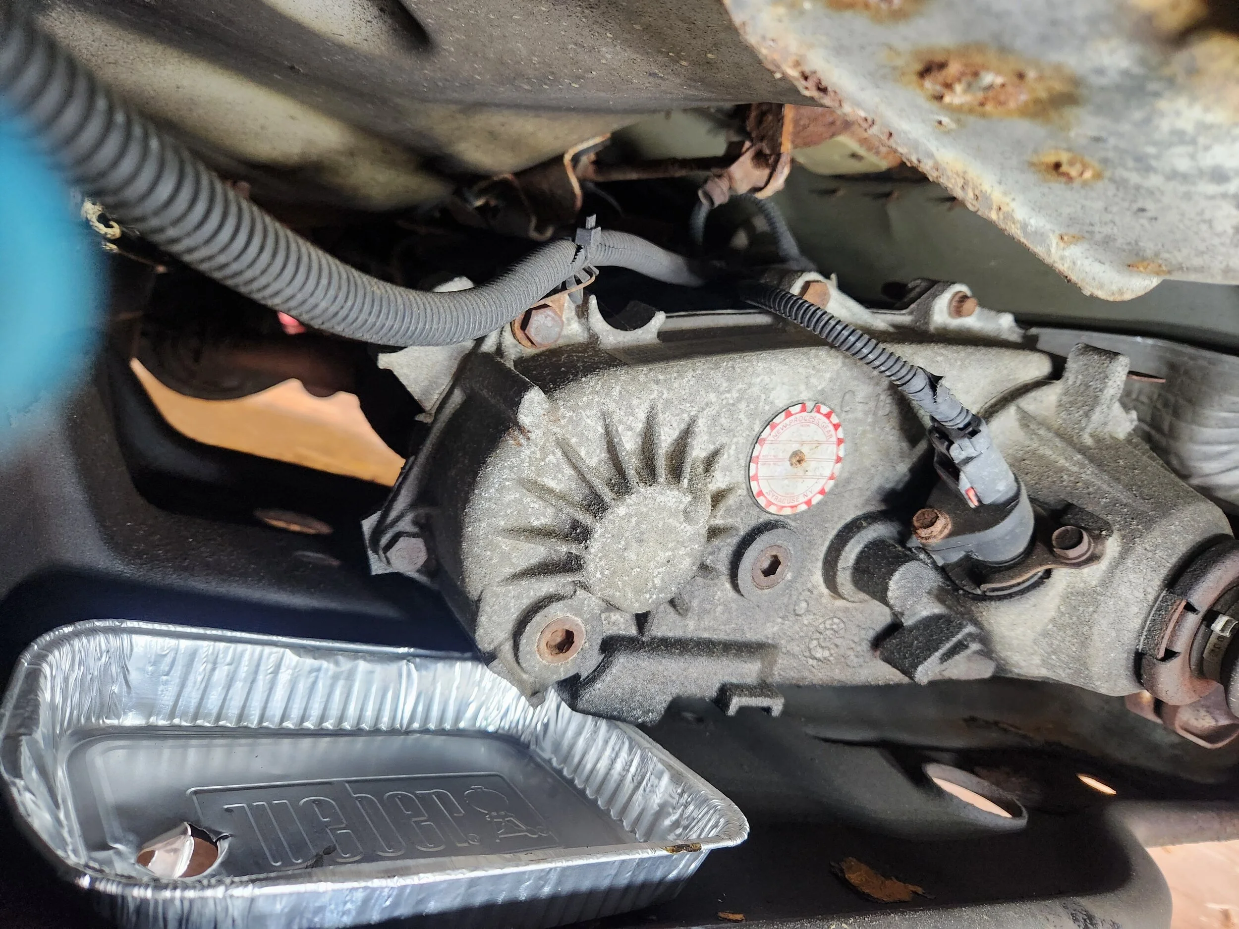

Transfer case fluid change. The fill and drain plugs were a b^!ch but a little heat and a few hammer taps got them broke lose. I watched a few videos on YouTube and it looked like the skid plate would make things a mess. I threw a cheap foil pan under the drain hole and then poked a hole in it that lined up with a hole in the skid pan. Mess free. 💪

I used to fold up flat aluminum foil into a little 'boat' and punch a hole through the skid - much like your pan there. Your use of the pre-formed pan is a great (better) idea!
Funny, I was about to reply saying his "bucket's got a hole in it", but then I realized what was going on there. :D I agree, not a bad idea!
