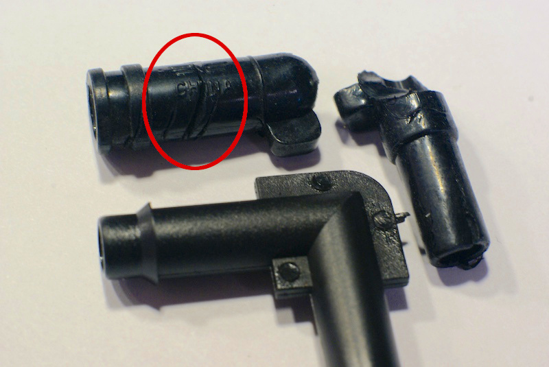

Had a hell of a time finding a suitable vacuum elbow to replace the broken one:View attachment 549582
I went to no less than three auto parts stores, before I found someone who actually knew what the fuck I was talking about. Guy at the first store - an Auto Zone - thought I was talking about a vacuum cleaner, the O'Reilly's I stopped at next was clueless - I looked over their Dorman "Help!" assortments (at both stores) and didn't see anything. Then I went to an Advanced Auto and the guy knew exactly what I needed and led me straight to it!
Forensic analysis: The soft rubber elbow that I installed a couple of years back couldn't take the underhood heat, softened, then broke. Thumbnail was able to cut through the thing with little effort (circled). OEM rubber fittings don't have this problem. New hard plastic elbow replaced it - hopefully with better long term results.

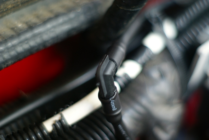

Installed. I used heat shrink to ensure a leak free installation.
Glamour shot - center vent functionality restored! Hopefully it'll stay that way. At least I got to practice my macro photography skills.
I had a similar experience on my wife’s Jeep. Ended up using a drip line irrigation 90 I had in the garage. A few years later still working well.

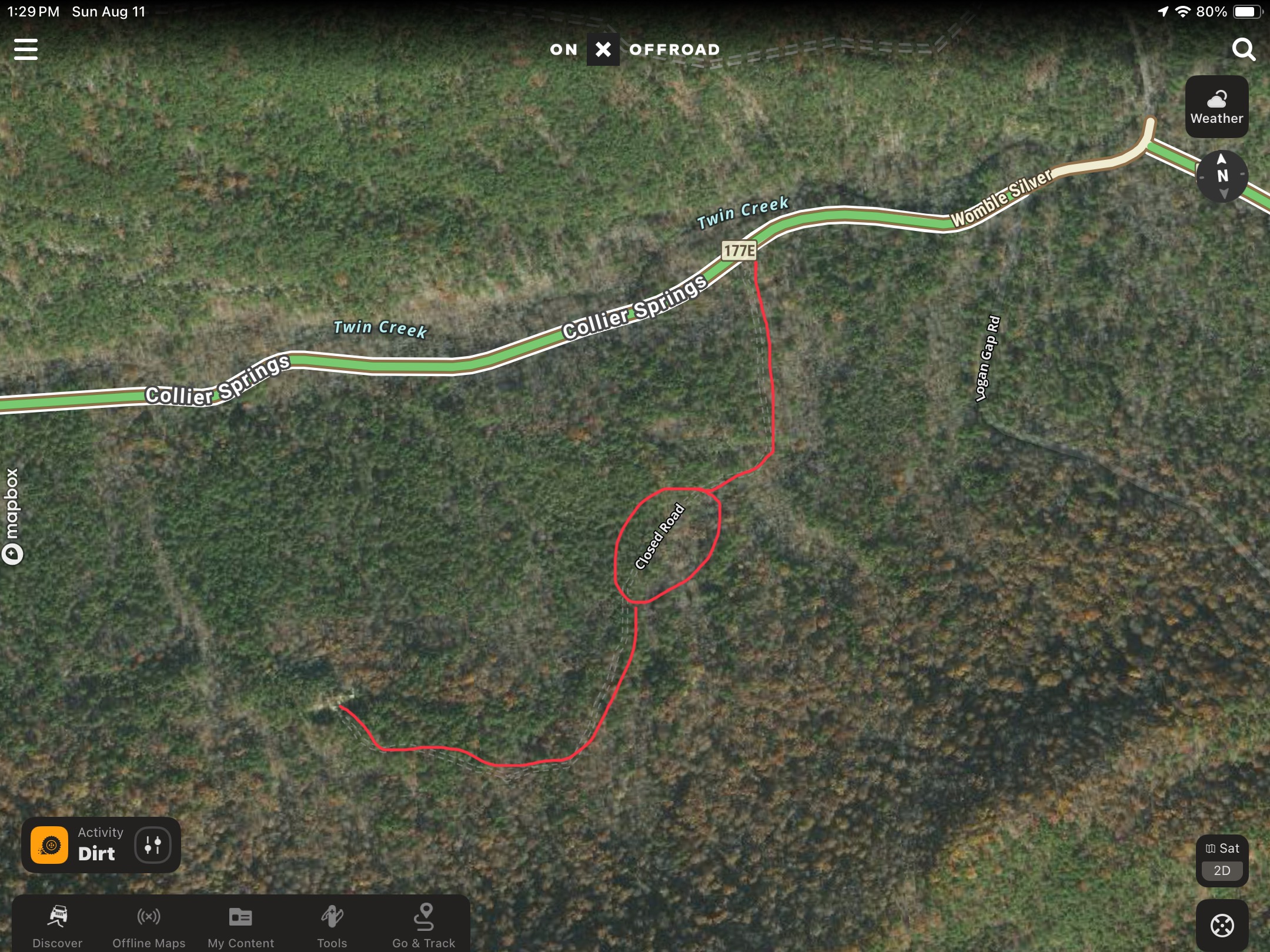

I couldn't get my carplay to work so I didn't use OnX, but I should've just made my 14 yr old run it on my phone. But that looks about right. Those fire trails don't usually dead end, I wonder where it comes out. I've mapped out a bunch on the east side of Logan Gap on a SxS. There's a couple of nice runs that I think I can get to w/o crossing a water bar, although one entry has a big tree down that needs cleared. If you know where Dozier Hollow is, there's a gate there. Either direction at the fork is a nice ride, occasionally muddy. :)
Probably won't be back for any real amount of time till November.
It ends on top of the mountain… if I had a guess there was probably a fire tower at the end at some point… back in the 40’s and 50’s fire towers where scattered all over these mountain tops while they were logging them…

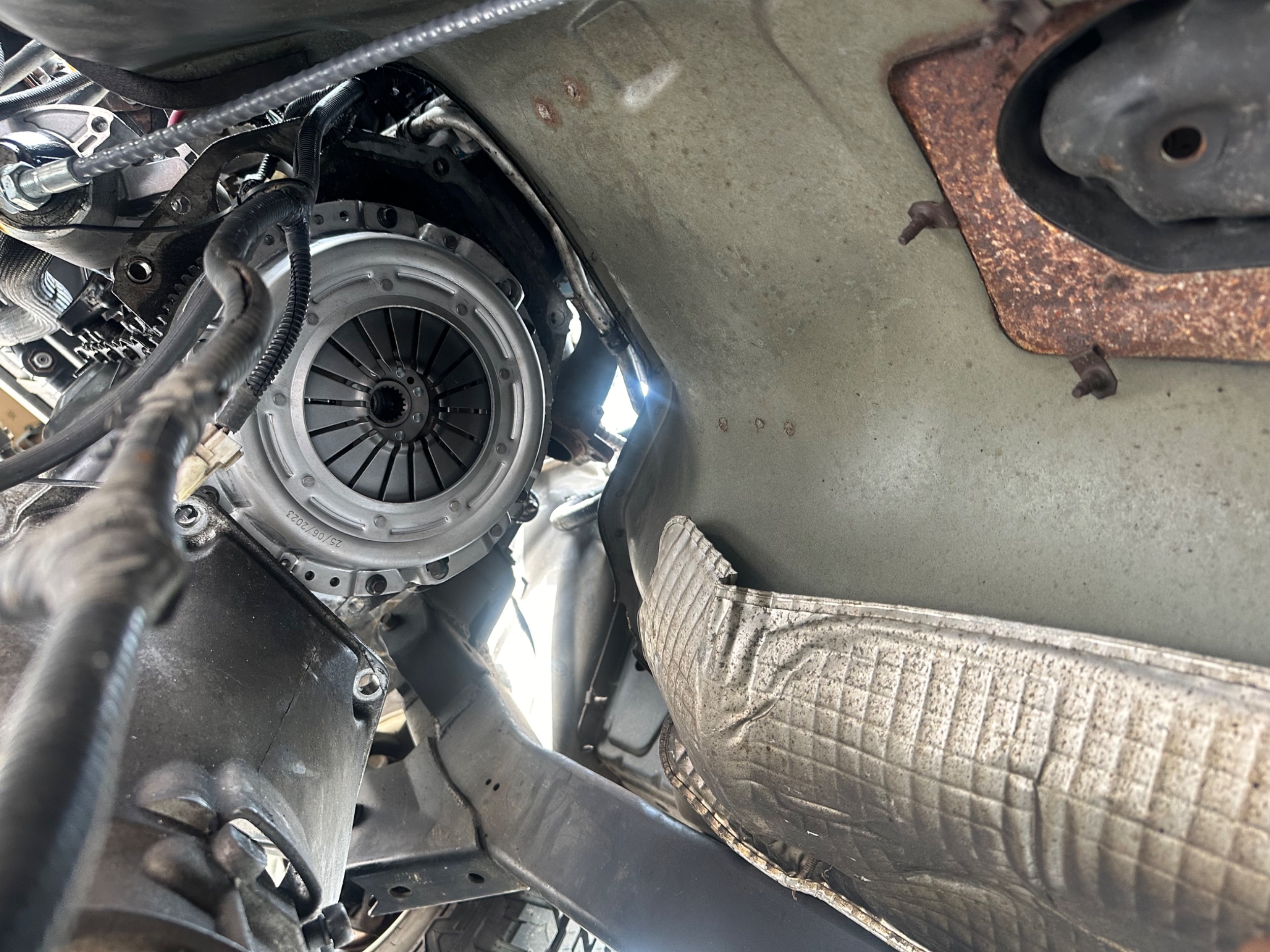

2.4 rebuild is complete! Fixed the leaking rear main and put a new clutch kit on while I was at it. Took it for a test drive and it seems it’s still down on power once I’m in any gear other than first…. Initial “droning” sound still is present when I’m accelerating.
No CEL/codes. I’m starting to think maybe the PCM is going bad? @Wranglerfix any input?
I replaced the fuel pump way back when but I didn’t replace the regulator, maybe that’s it? I’ve almost eliminated every possible source 😂 someone help me before I lose my mind LOL.

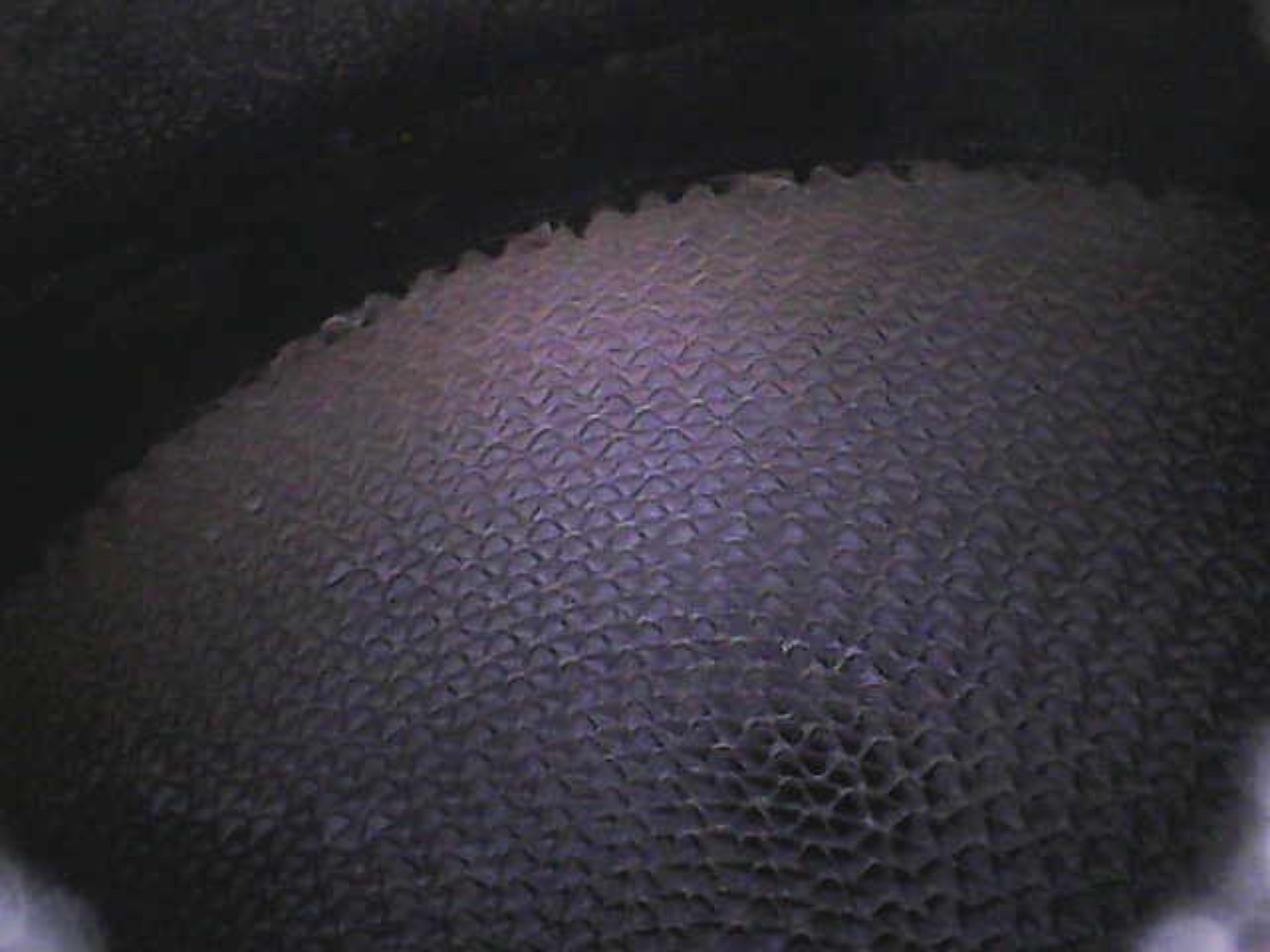

Have you checked/replaced the cats? They could be restricting flow enough to reduce power but not enough to trigger the sensors?
Reactions: Duner

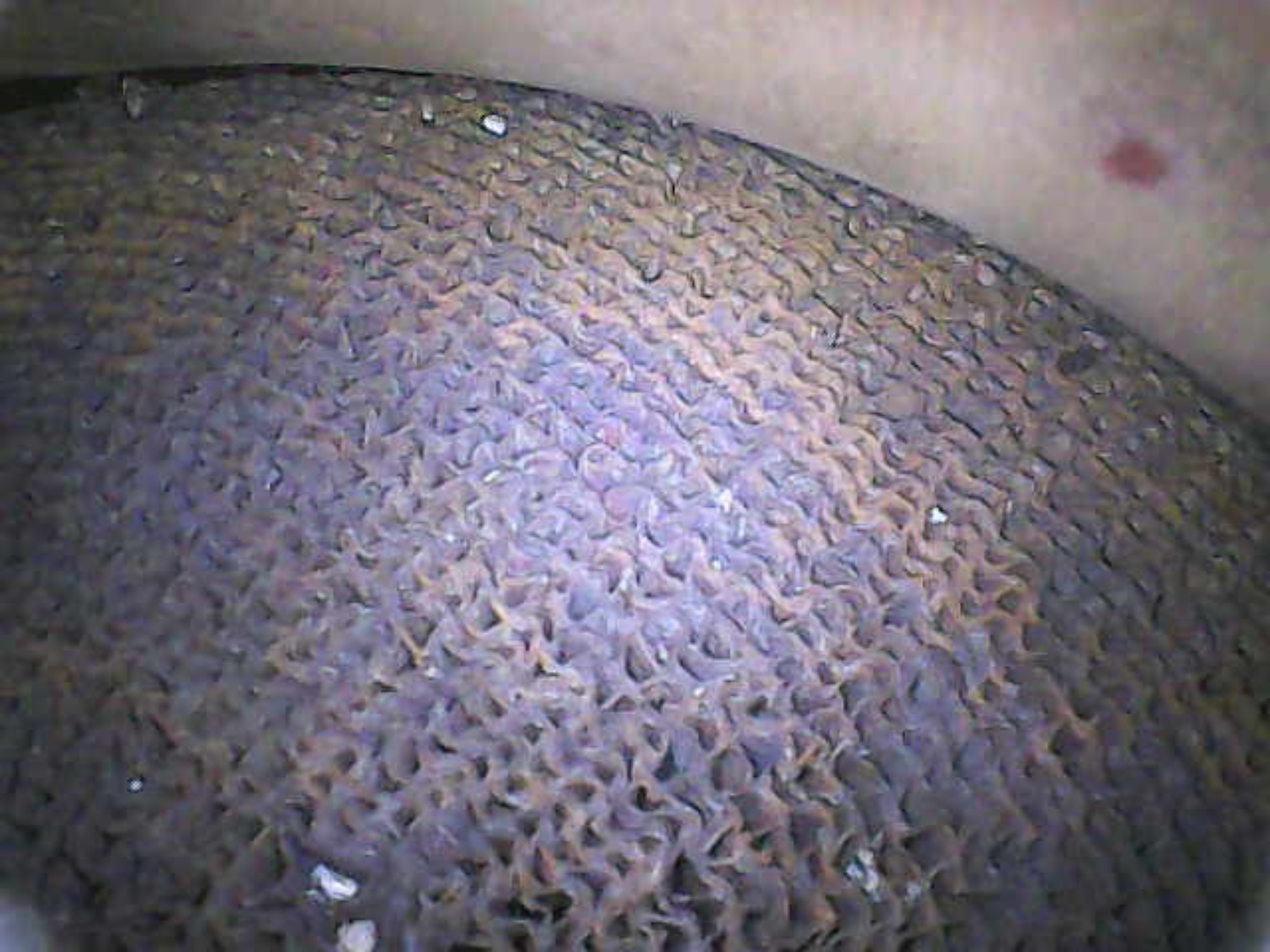

I looked at them and they seemed fine. Here are the pics I took of them with my wire cam awhile back.
You can definitely see some build up but I couldn't tell you if that's normal or not it's been a LOOOONG time since I had to deal with cat issues. I do have a new intermediate pipe with both cats sitting in the shop for my '03 Rubicon but I haven't even opened up the box yet
