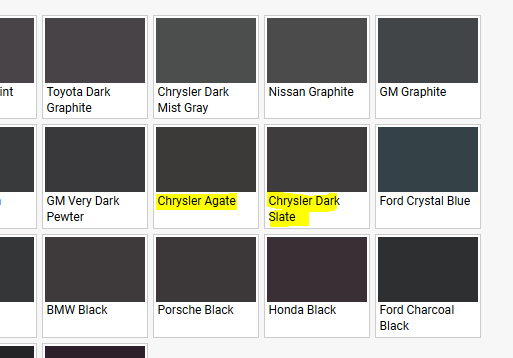

Is the Color Bond material actually designed to be a match for the factory slate (?) color or did you just get lucky and find something close? I say that as it looks mighty close in your photos...

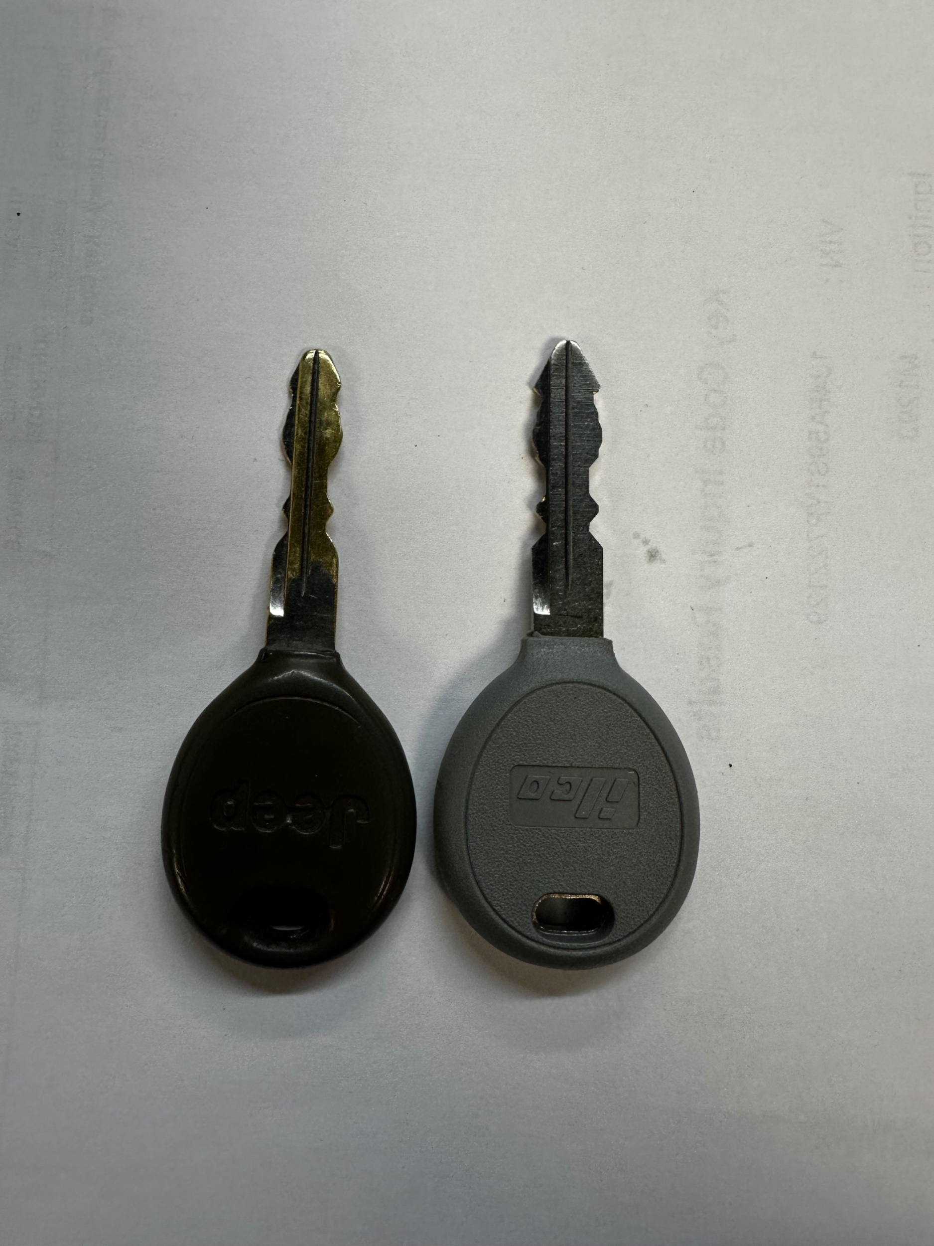

I had a new ignition key cut at the dealership based on my VIN. My other key had worn down so much from 25 years of being carried in my pocket that copying it would not have worked
Edit: I thought I needed a new ignition, but it turned out that the tip of the key was just so worn down that it was inserting too far into the ignition for the tumblers to line up right. Here’s a picture of the new one versus the old one:

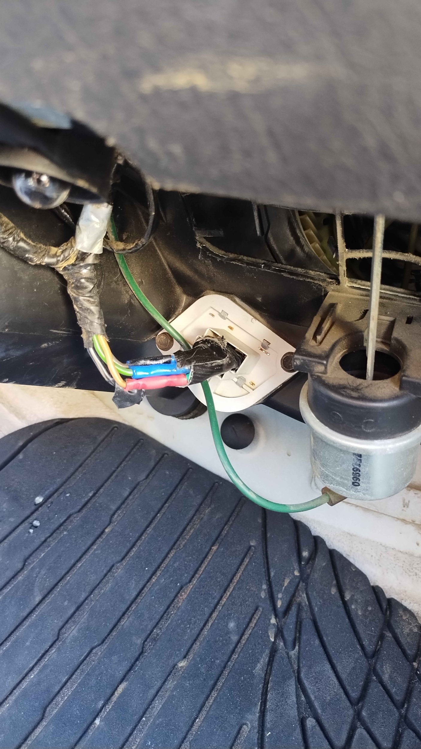

I fixed my blower motor resistor connector and wires. This is what it looked like for the last year. finally fixed it properly by soldering in a new connector and replacing the resistor.
Did you replace the blower motor, too? If not, consider replacing the motor, too. The resistors don't just fail. They fail due to excessive current, which is almost always caused by a failing fan motor.

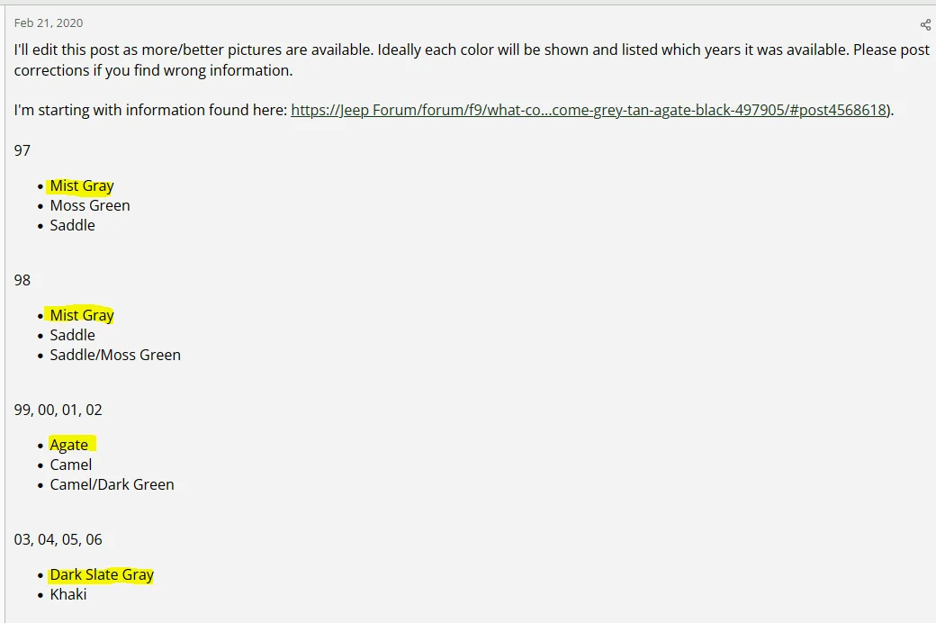

The Color Bond #163 is Chrysler Agate and is identical to my original color, can't tell them apart. I found that out on a search some time back, it's used on Dodge trucks as well. (Actually on my build sheet my interior is listed as Agate, not Slate so I doubt it would match Slate and I haven't seen anyone being able to match Slate in my searches.)
As far as scratching, after 36 hours I can't scratch it with a fingernail so I'm optimistic.

I'm not sure where I got Slate, but I'd say that's as good a match as I've seen to the color of my interior plastics (2005 LJ). I might just have a go with this product on the half door cards, which are the lighter gray from the early TJ's.

Looks like there actually was a color change for my year, but when I look at them on the Colorbond site, I can't tell the difference...nice that they have both...
