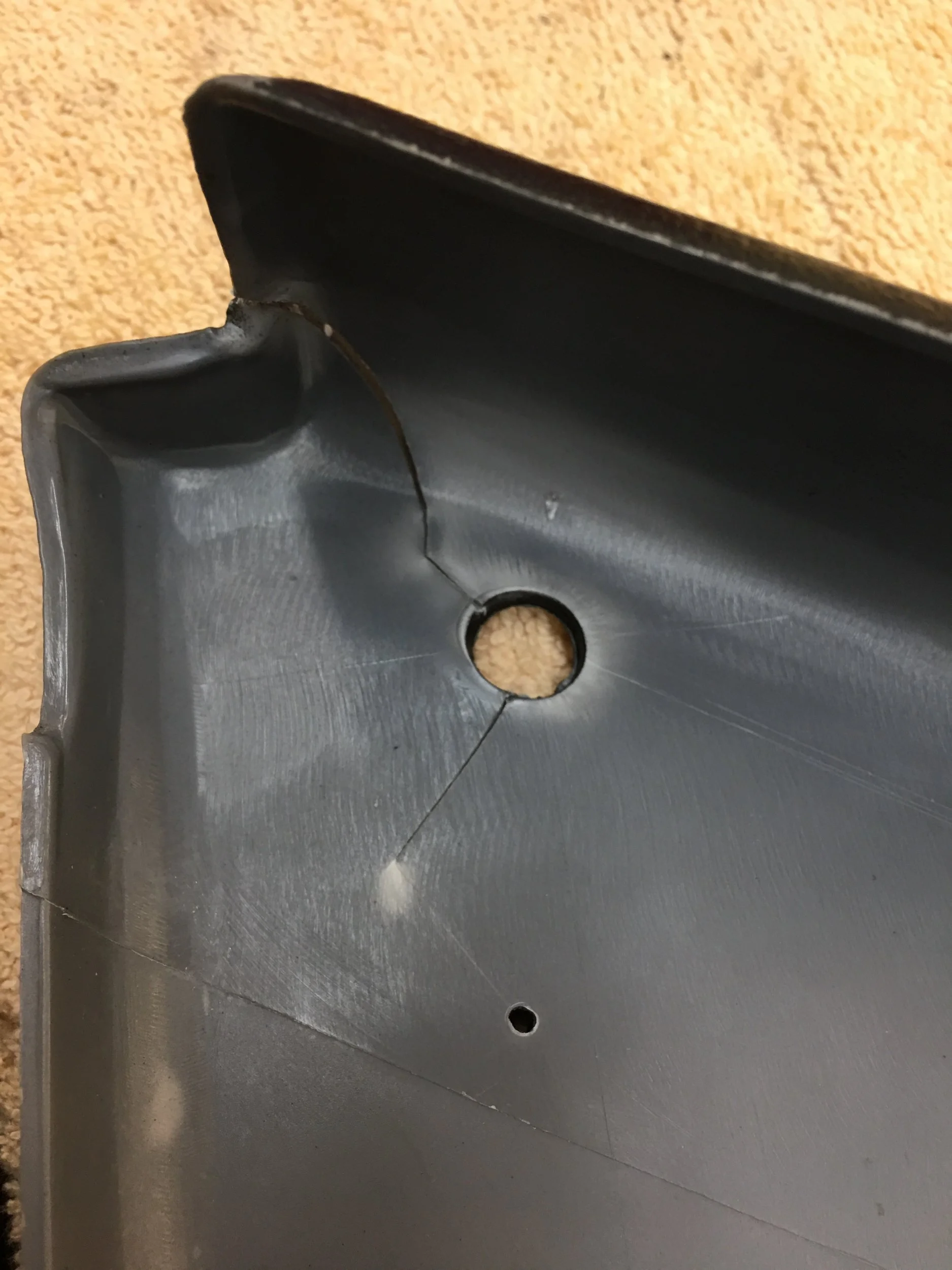

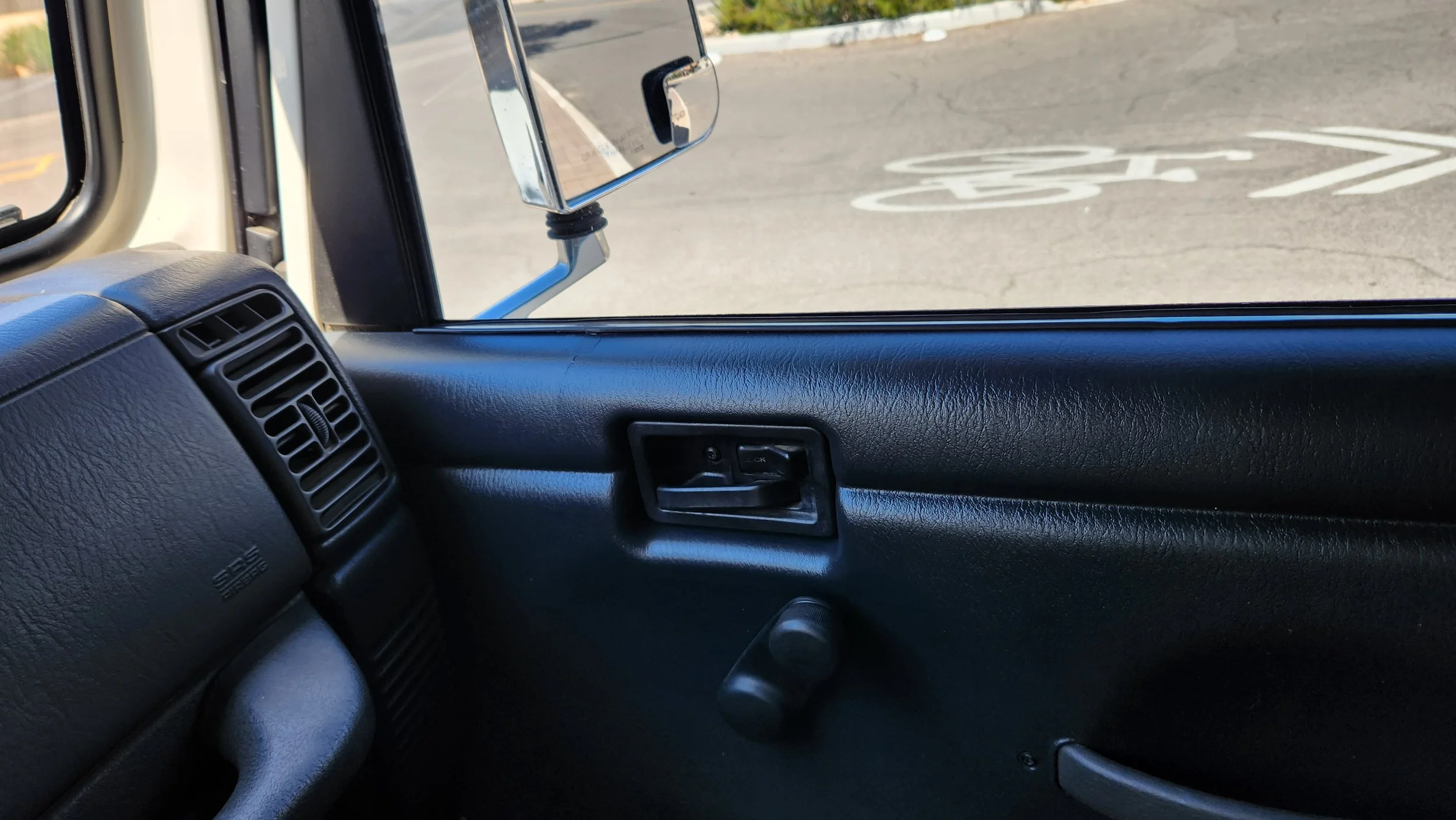

Installed the re-finished door panels today. The cracks are still visible but they are no longer open and they are acceptable to me. Sometimes if you try and work that stuff to perfection you end up making it worse.
I didn't force the cracks closed thinking that might cause stress and they will just re-open, Instead I left them relaxed and filled them . I taped the edges and leveled the JB Weld with a razor blade and lightly sanded it with some #400 once it dried. I bought the HF plastic welder but never took it out of the box, decided to use JB Weld plastic bond instead.
After careful prep, multiple color coats and 3 days baking in the Arizona sun the finish is very hard and I am optimistic that it will hold up.

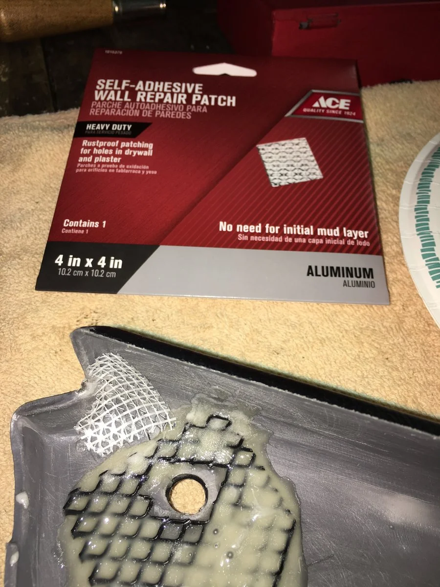

I'm not sure the extent of your crack repair on your panels, but if the cracks come back, drill a small hole at the end so it doesn't spread. I used some wire gutter guard and JB Weld plastic bonder on the inside of the door panel, after scuffing the plastic with some rough sandpaper, to reinforce it. The gutter guard worked, but @zebra12 suggested this ACE Hardware self-adhesive drywall patch. It worked great and was way easier to cut and form than the gutter guard was. Both have held up well so far for 5 years.

I actually did back up the repair with the yellow mesh for roofing repairs. My cracks were only at the usual top area where they all crack, and only about 1.5" long.
