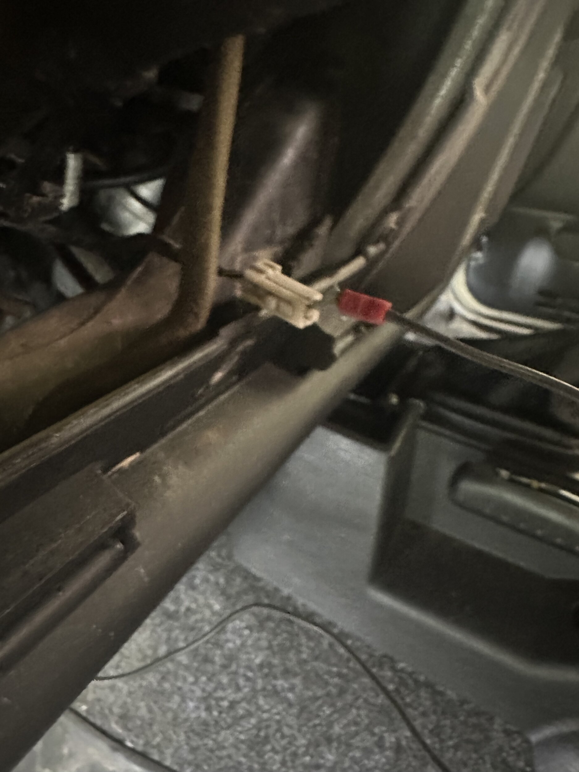

Here’s one for you, been hunting why my voltage gauge goes haywire randomly, been an issue since I purchased my 98 a couple years ago. Well I can officially say I found the issue.
PO wired up the cigarette lighter with 14 ga solid copper wire, half-assed wrapped around the lugs on the back side of the lighter plugin, and then clipped some ring terminals in half to shove into this white plug under the steering wheel to get power. Been shorting this out under my dash for some time now…
Now I wonder where the plug went that is supposed to plug into the back of the cigarette lighter.
You can see the other wire laying in the floor board, it just fell out when pulled the cigarette lighter to install my fog light switch.
Just happy I didn’t burn this thing down, especially after finishing my LS swap…

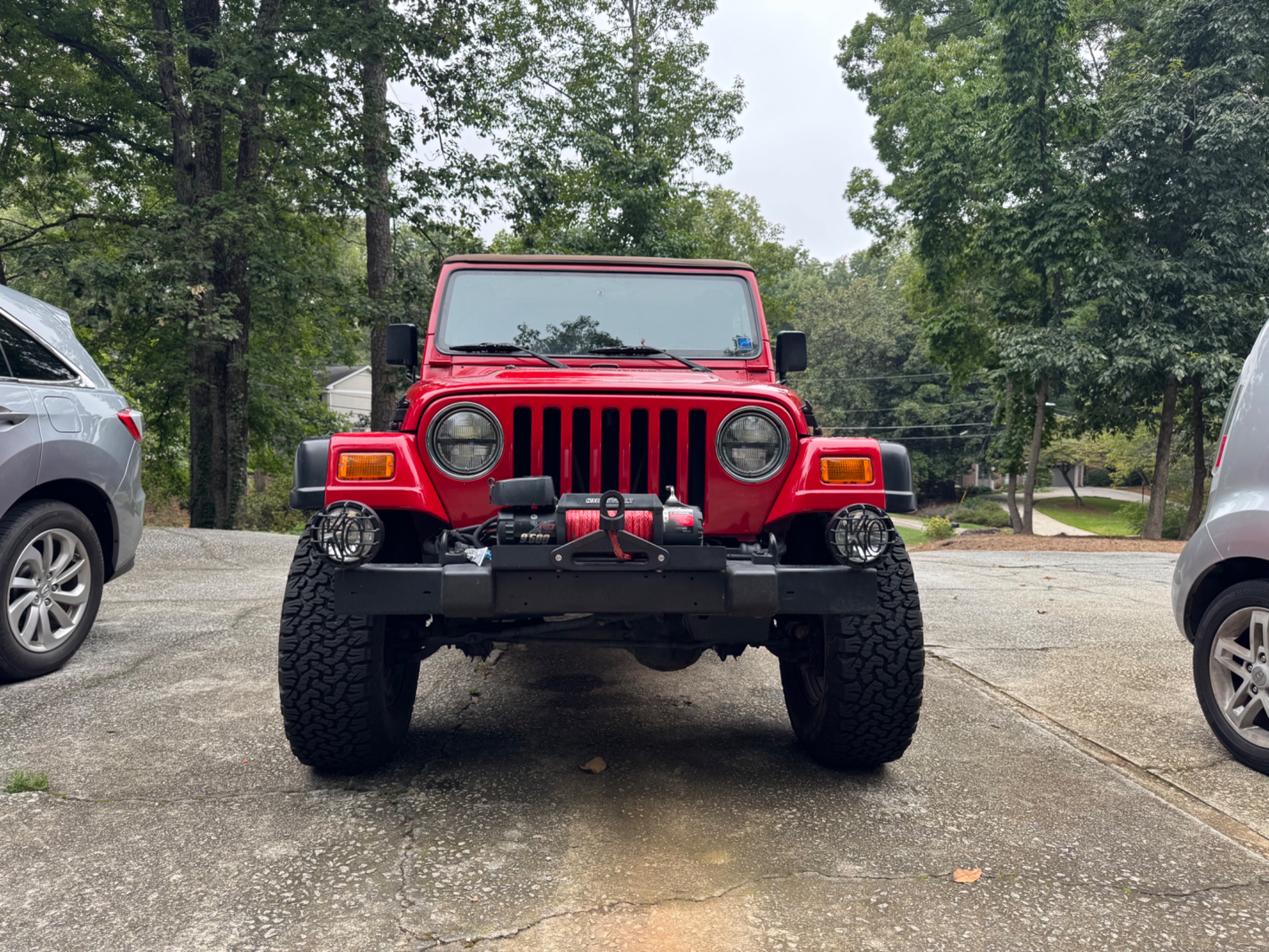

The pre-production sample I saw looked good so I picked up a set of the summit LED headlights to install over the weekend.
https://www.summitracing.com/parts/sum-rp22677
I will be interested to see how you like these.
I second how you will like these. Post a picture of the beam pattern at night if you can.

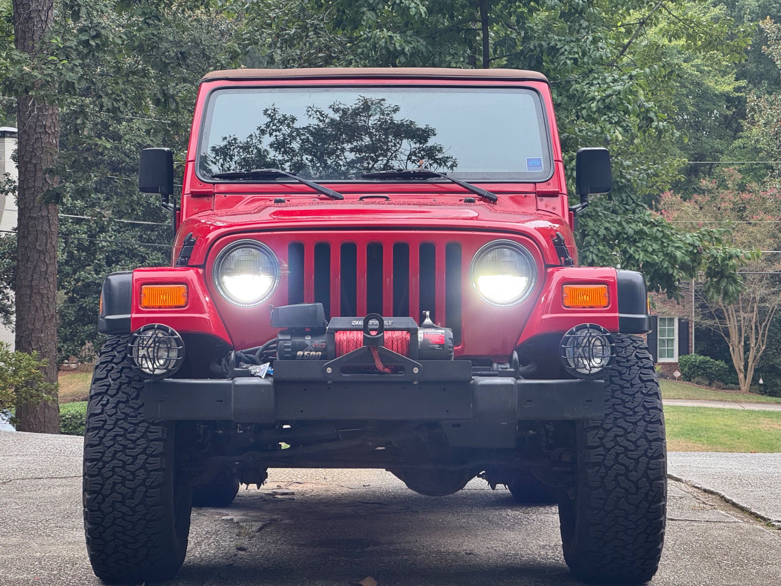

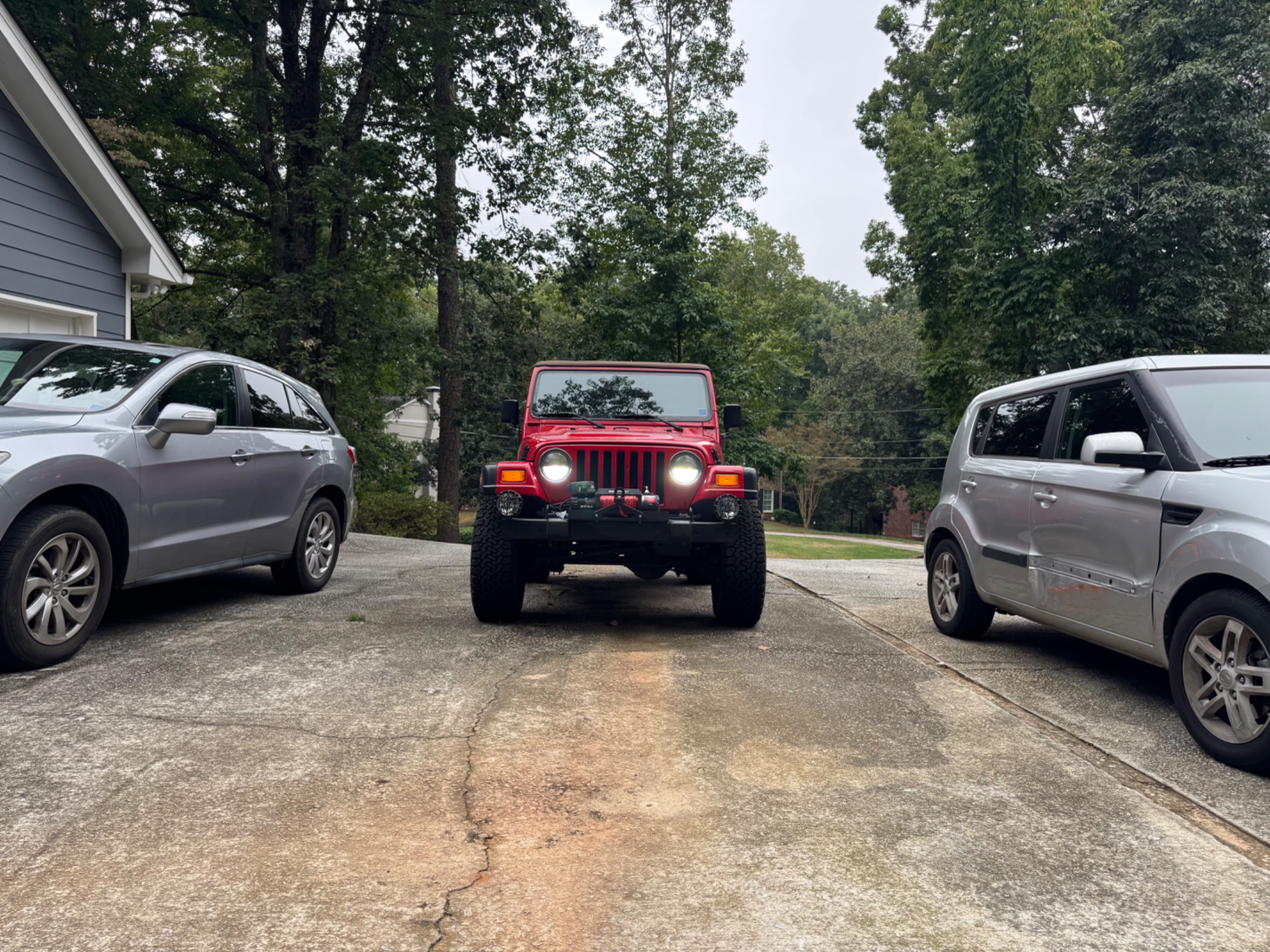

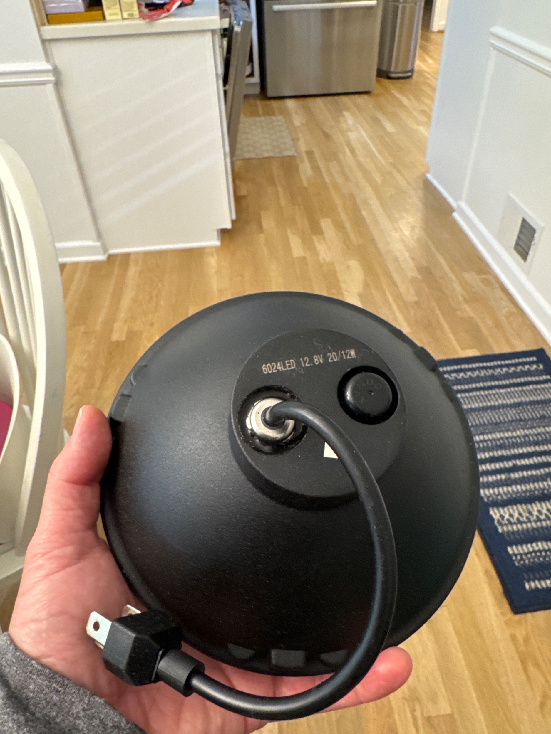

Installed the Summits, glass feels solid, seals on the back look good, and enough length on the plug.
Will post some beam pics when I duck out one night this weekend.
