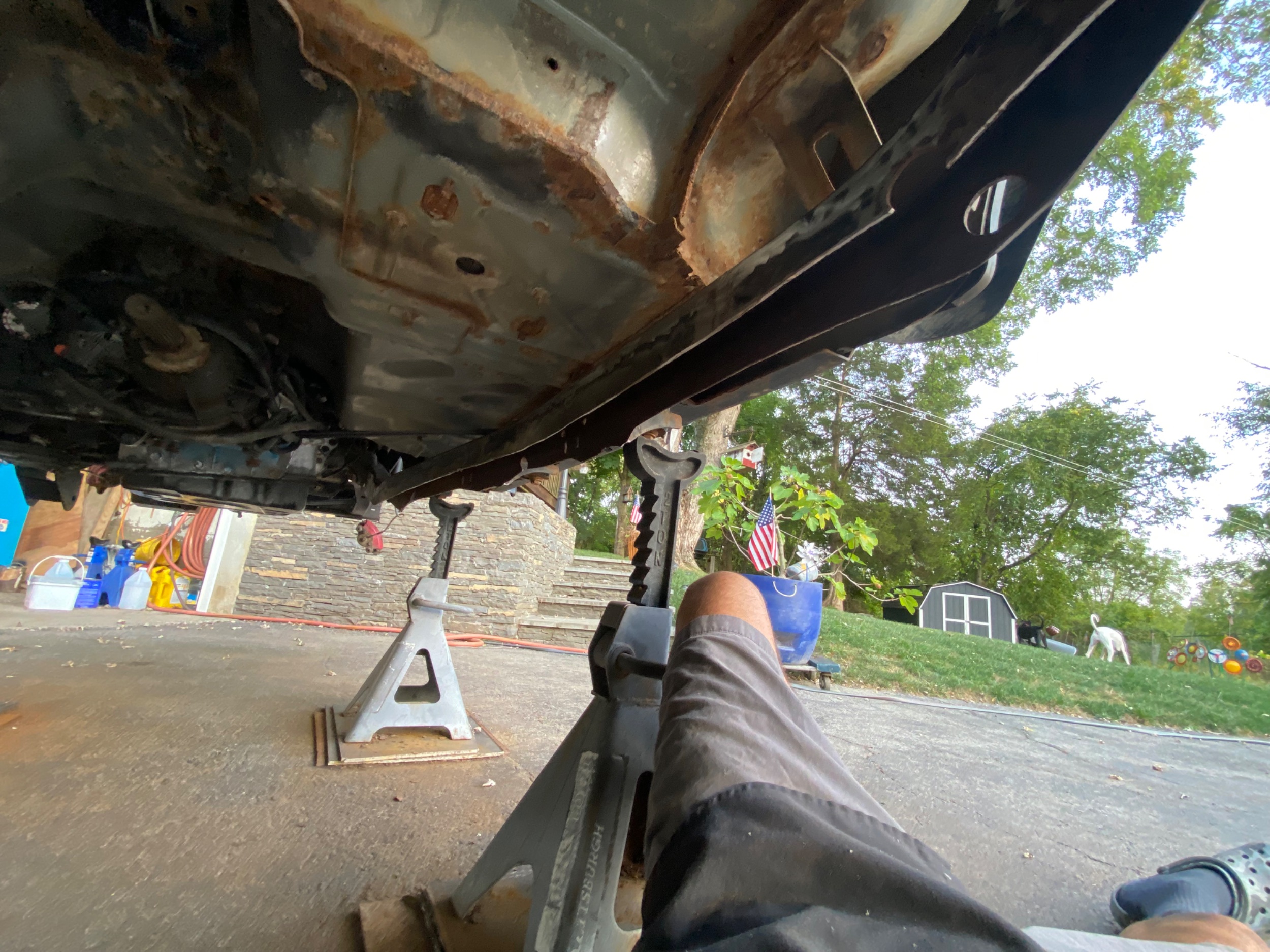

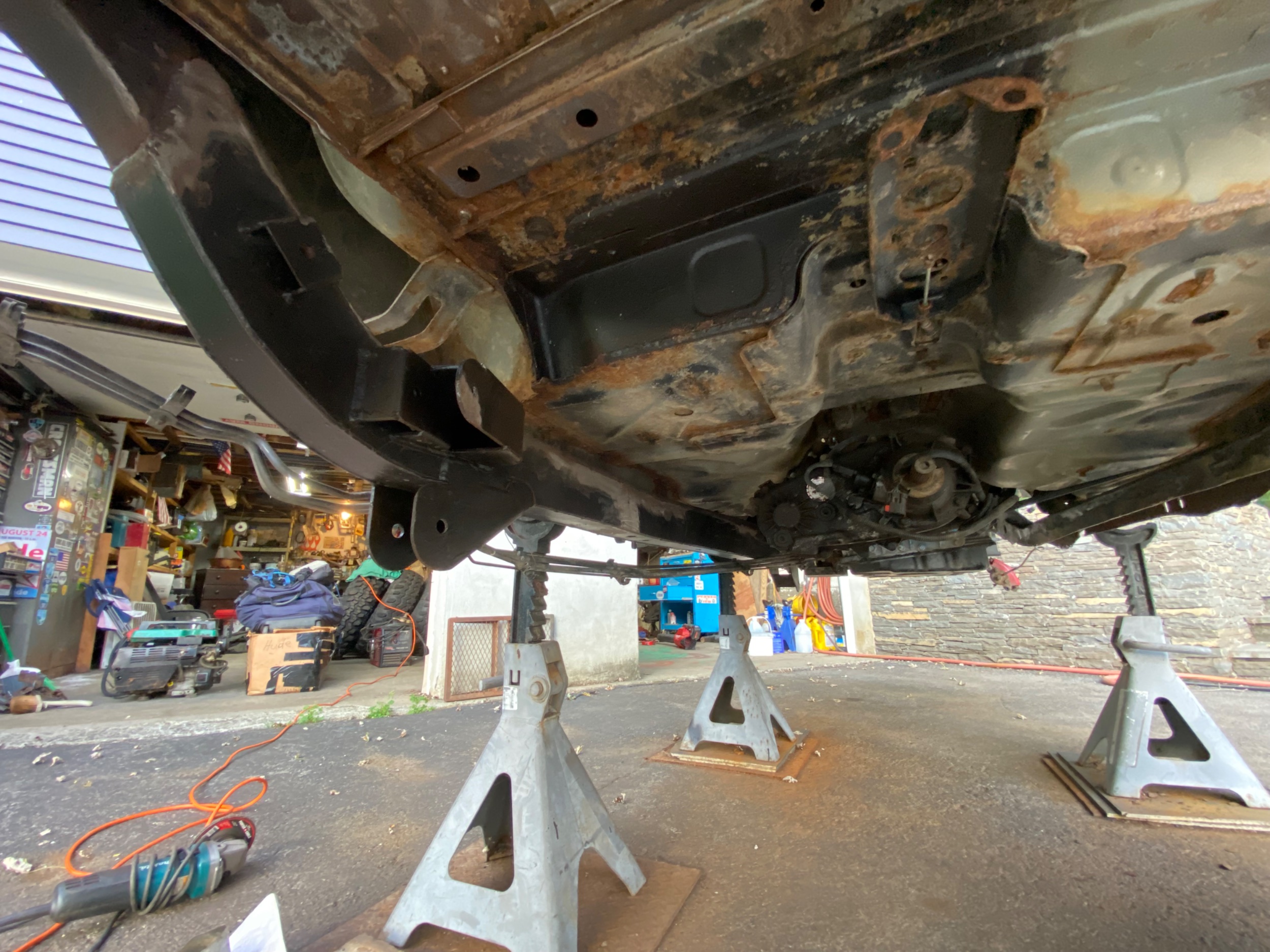

Slow but forward progress on the frame repair project.
Three photos.1. Pass side frame cut out ready to paint inside of frame then install patches 2. Underside of tub. Been slowly cleaning it up for coat of paint 3. Drivers side with patches welded in with more to do.
Progress is slow but I’m busy and not in a rush.
Just gotta beat the cold weather.

Had to zoom in to realize you were using the body mounts for the jackstands. On initial look - I swore you were using magic to levitate the Jeep... :D
Congrats on the progress. You have great dedication and hard work!

Welding on your back sucks!!!. I remember doing my torqe boxes that way. I hated it.
Looking good though!!! 🍻
Actually the Jeep is jacked up just enough that I can sit under it on a creeper and roll around. Only super tight spot is under the transmission so that’s more of a sit squat move. I do wish I set it up a few inches higher but too late now. 🤒
