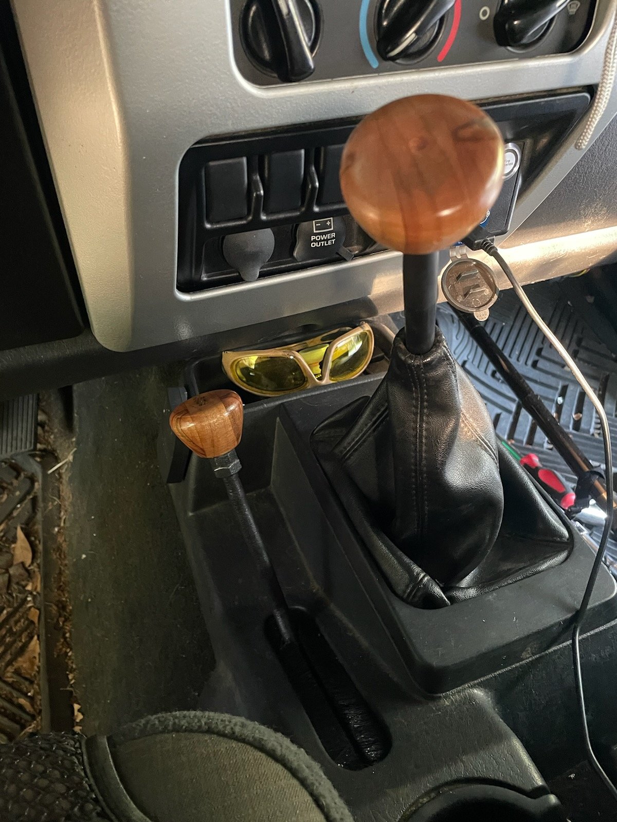

I'd almost forgot this little project I started about a year ago that kept getting put on the back burner due to other more pressing concerns. I got another transfer case shift lever, cut the top bend off of it, welded on a straight section, then welded on an old M10 bolt with the head cut off so I could put a matching shift knob to the one I made last year for the transmission shifter (only a bit smaller). I like the old school T/C shifter sticking straight up instead of hiding in the side of the console. Plus it's easier to reach.
