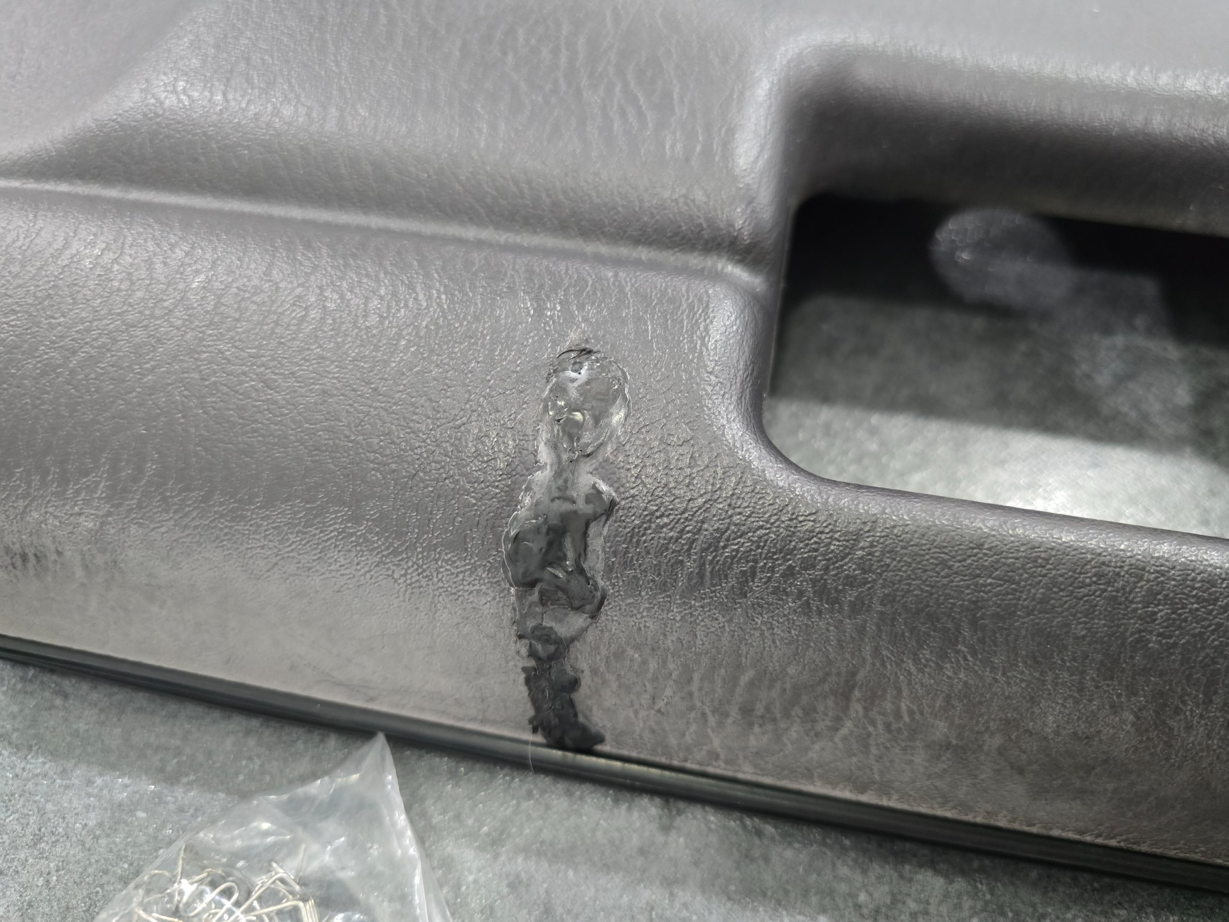

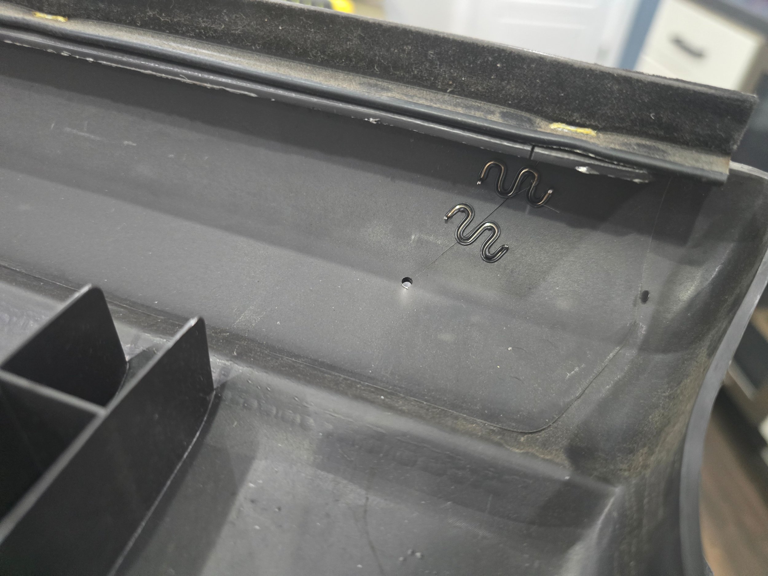

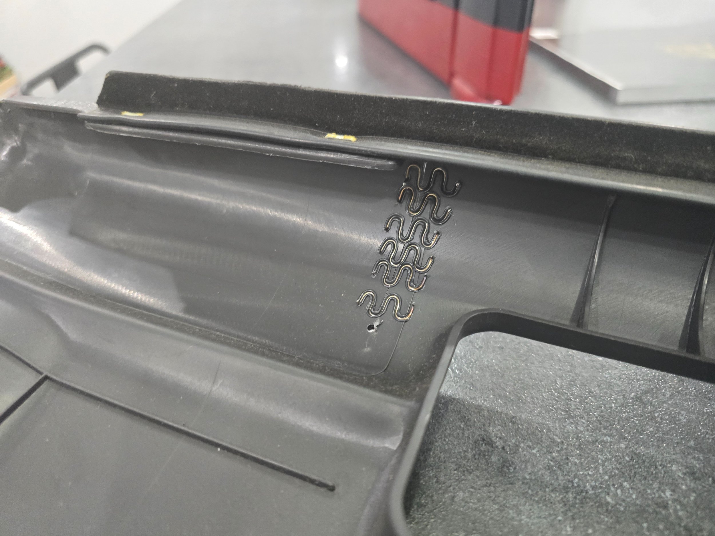

Started repairing the 2 cracks on my driver door panel. Now just got to find time to sand and paint both door panels.
I’d love to see how you did that.
I used this kit.
Upgraded 220W Plastic Welder, 2 in 1 Plastic Welding Kit Plastic Repair Welder Kit 1000PCS Hot Stapler Soldering Gun with 100PCS Plastic Welding Rods Car Bumper Repair Kit for Most Plastic Repair https://www.amazon.com/dp/B0B4RDHKDR?tag=wranglerorg-20
It has the metal pins and a lot of different plastic fillers that you can heat and melt into the crack. It took me longer to R&R the panel than it did to do what is in the pictures. The metal pins push in the end of the gun, you put the pin where you want it, pull the trigger, and it instantly heats the pint and melts into the plastic panel. There is a knife end that you can melt the filler material into the crack after it is pinned.
I drilled a small hole at the end of the cracks to stop them a couple months ago.

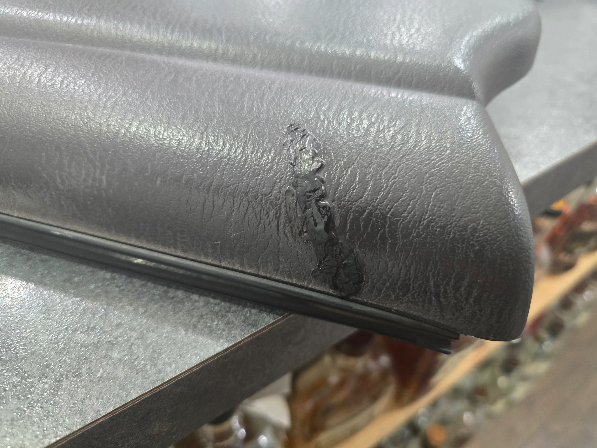

Once sanded and painted, I do expect to still see where it was done since the texture won't be the same.

Thanks for that. Nicely done.
Before I sand and paint, I probably will go back in on the back and fill in some of the filler material on top of the pins just to help it hold better.
I you want to go full anal-retentive, you could probably do a little work to the visible side of the repair with an o-ring pick or scratch awl and recreate a bit of the graining texture in your repair once you have it sanded down to where you want. As @NashvilleTJ said, nice work so far.
Might just have to pick one of those tools up myself. Only the passenger side is cracked on mine, but someone had pulled the door card at some point and must have gotten a bit ham-fisted when doing so as the inner weatherstrip has been jacked up a bit in the area of the split and is all wiggly now (that's a technical term ;)).
I am OCD so I will do whatever I can to recreate the texture. It is going to drive me nuts for the next month with the filler like it is in the pictures. I just have other things I need to get done before finishing this.

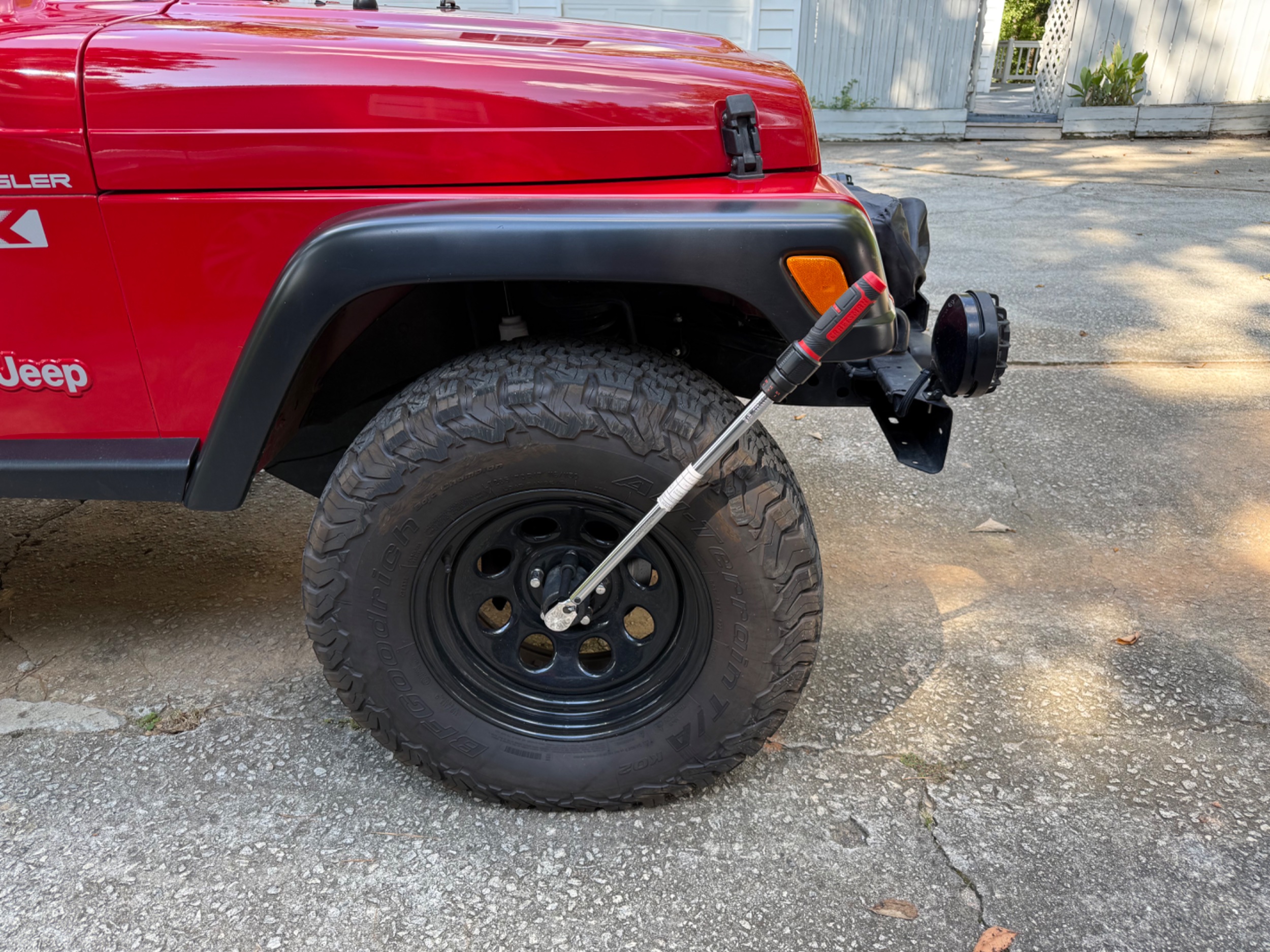

Honorary @AndyG post rotation lug nut check.
Chris please give him the Golden Lug Nut symbol on his header.
Good job sir.
