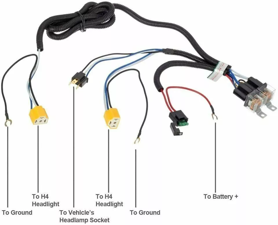

Since you are not using LEDs I would highly recommend installing a head light wiring harness with relay so the current doesn't go through the head light switch which is a chokepoint. Installing this harness is easy and will make your lights at least 50% brighter.
https://www.ebay.com/itm/1866909499...pid=5337789113&customid=&toolid=10001&mkevt=1
The Toyota lights come with a relayed harness as well. Another reason I went that route in the event I want to run 100W bulbs instead of what comes with them. I believe 60W comes with.

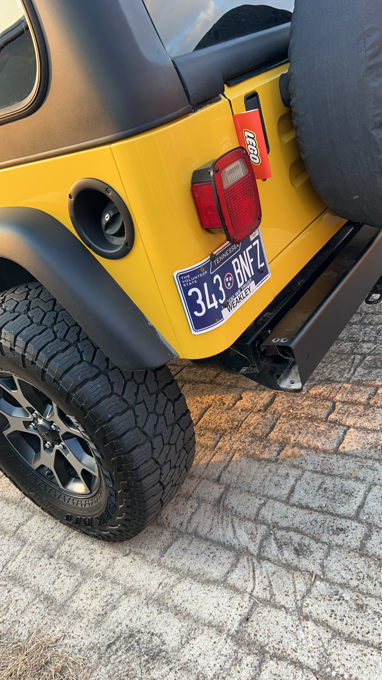

View attachment 567817Finally got rid of the chunk of plastic jeep should’ve never put on. Simple as can be. Spray paint can to form/test fit, some stick on spacers to keep it off the body, and drill new holes in the plate!!!
Looks good. Be sure to put down a good coat of wax on the paint because you will accumulate dirt and want to protect the paint.
I did that harness upgrade on my XJ and it made a big difference, even with halogen headlights.
