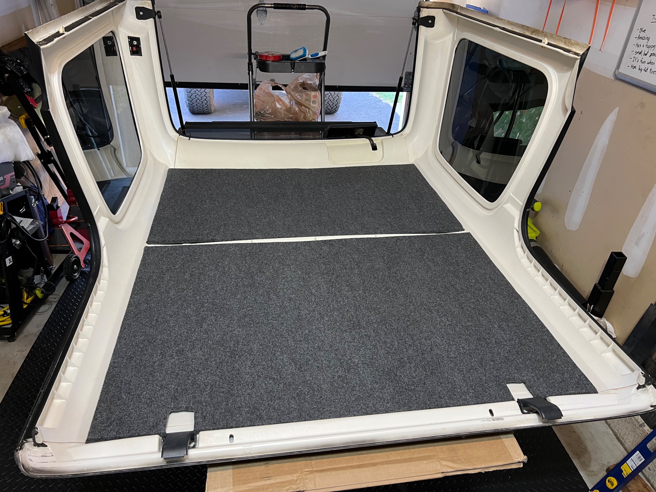

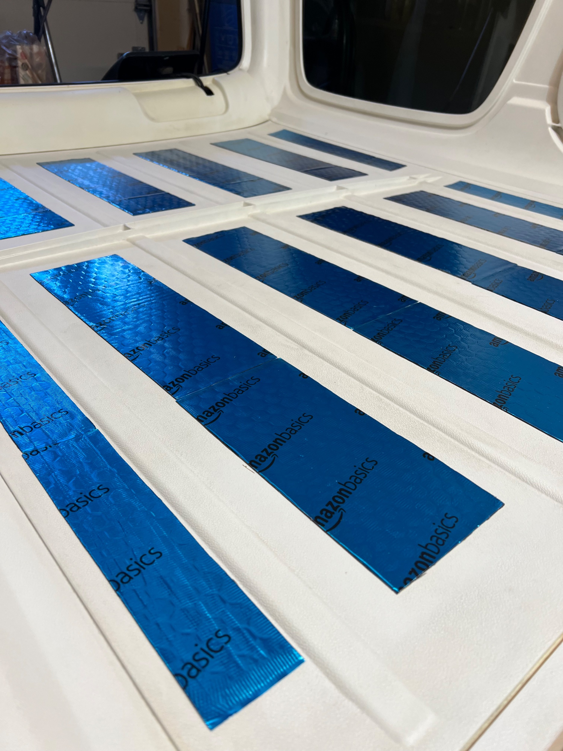

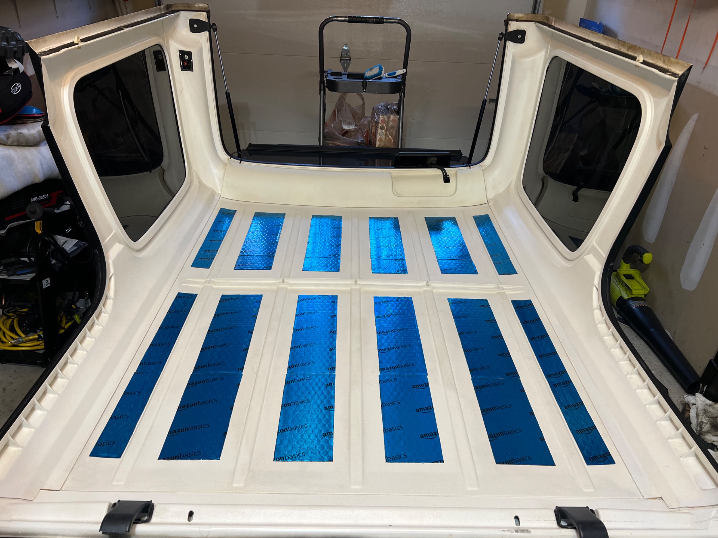

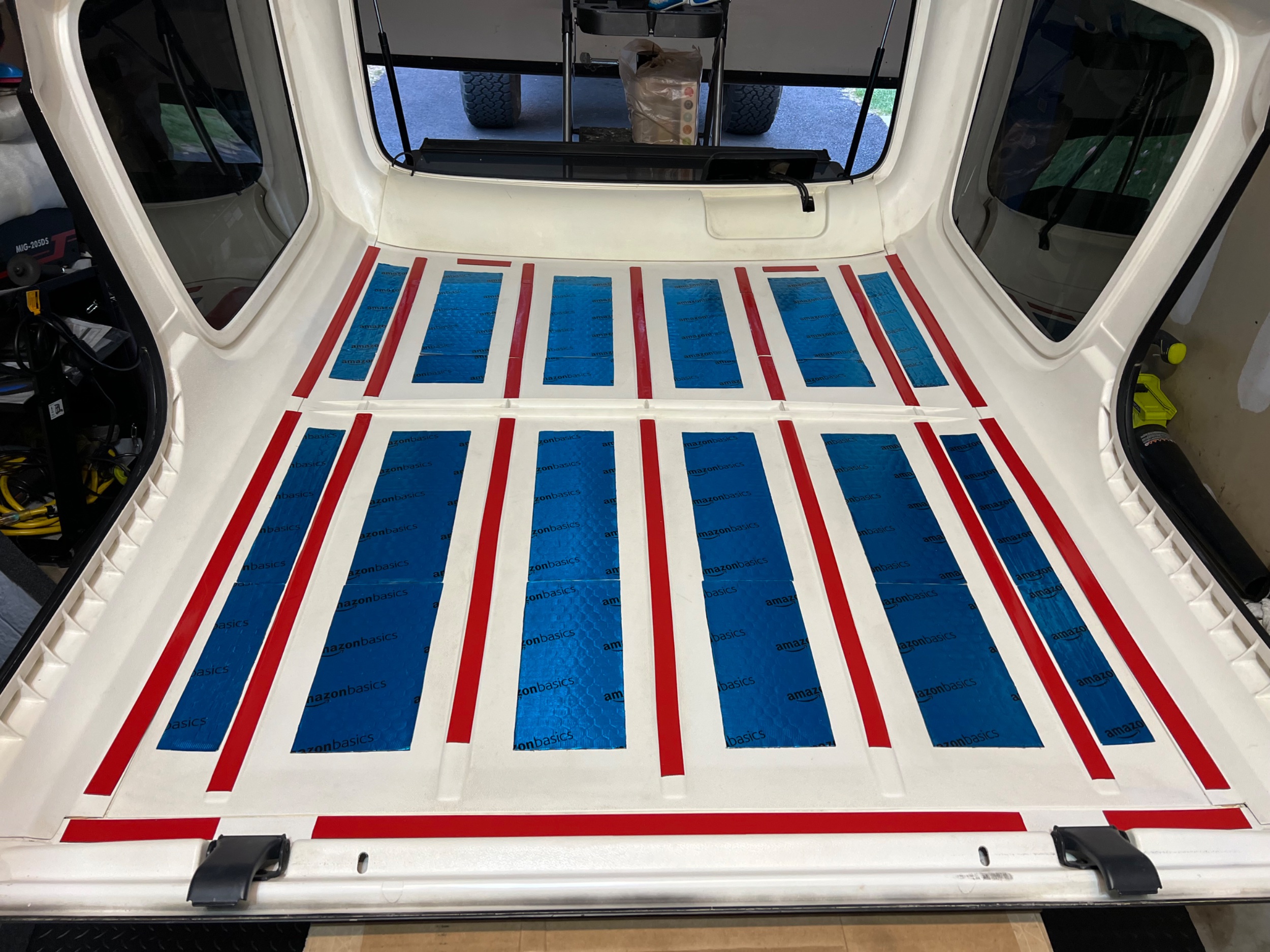

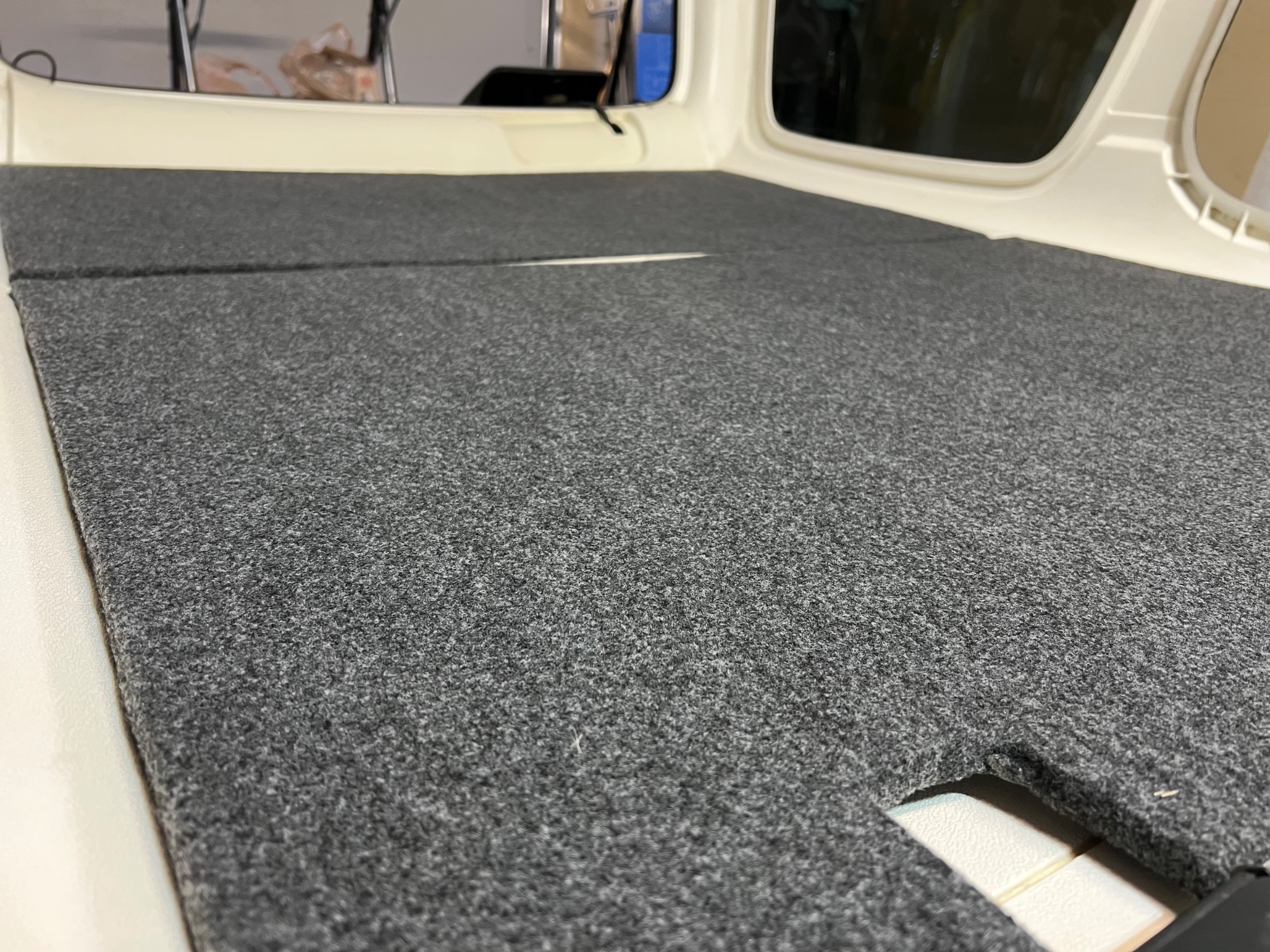

Been awhile since I did a TJ project but did a relatively easy/quick one yesterday. Was extremely close to selling my hard top (sold 2 previously) but decided to hold on to it this time. Gave it a good cleaning and added some sound deadening and DIY headliner insulation. All in for about $100. Not bad compared to $300 Hotheads.
View attachment 567938View attachment 567939
View attachment 567940View attachment 567941View attachment 567942
Do you care to share links with the materials you used? I'm getting ready to put my hard top back on and would like to do this prior to.
Reactions: reddvltj
Magic Eraser-$6 Home Depot
Amazon Basics sound deadening 10 pack- $28
4x8 1/2” foam insulation board w foil-$25 Home Depot
3M 77 adhesive spray can x1- $13 Home Depot
3M Extreme heavy Duty double sided tape 400”x1” roll- $23 Home Depot
2 yards of trunkliner felt fabric- $8 Joann’s Fabric
Additional things you’ll need if you don’t have already
Acetone for prep cleaning
Sound mat rollers
I found this video helpful

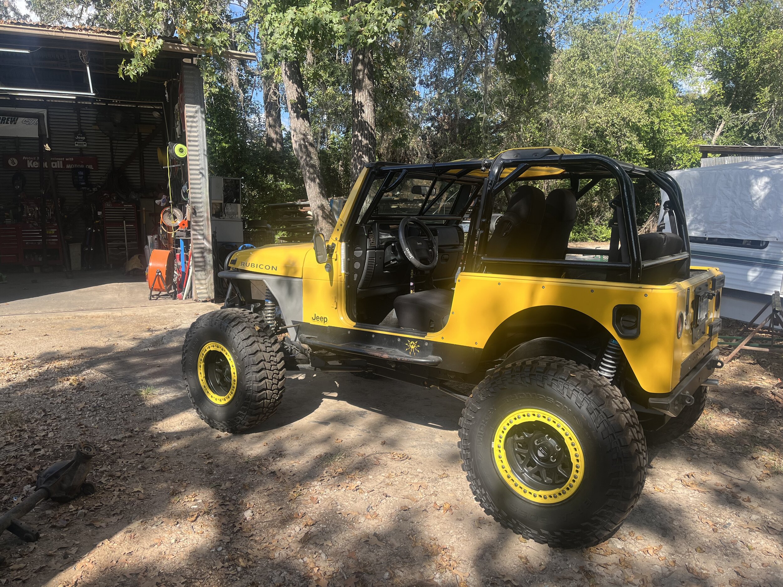

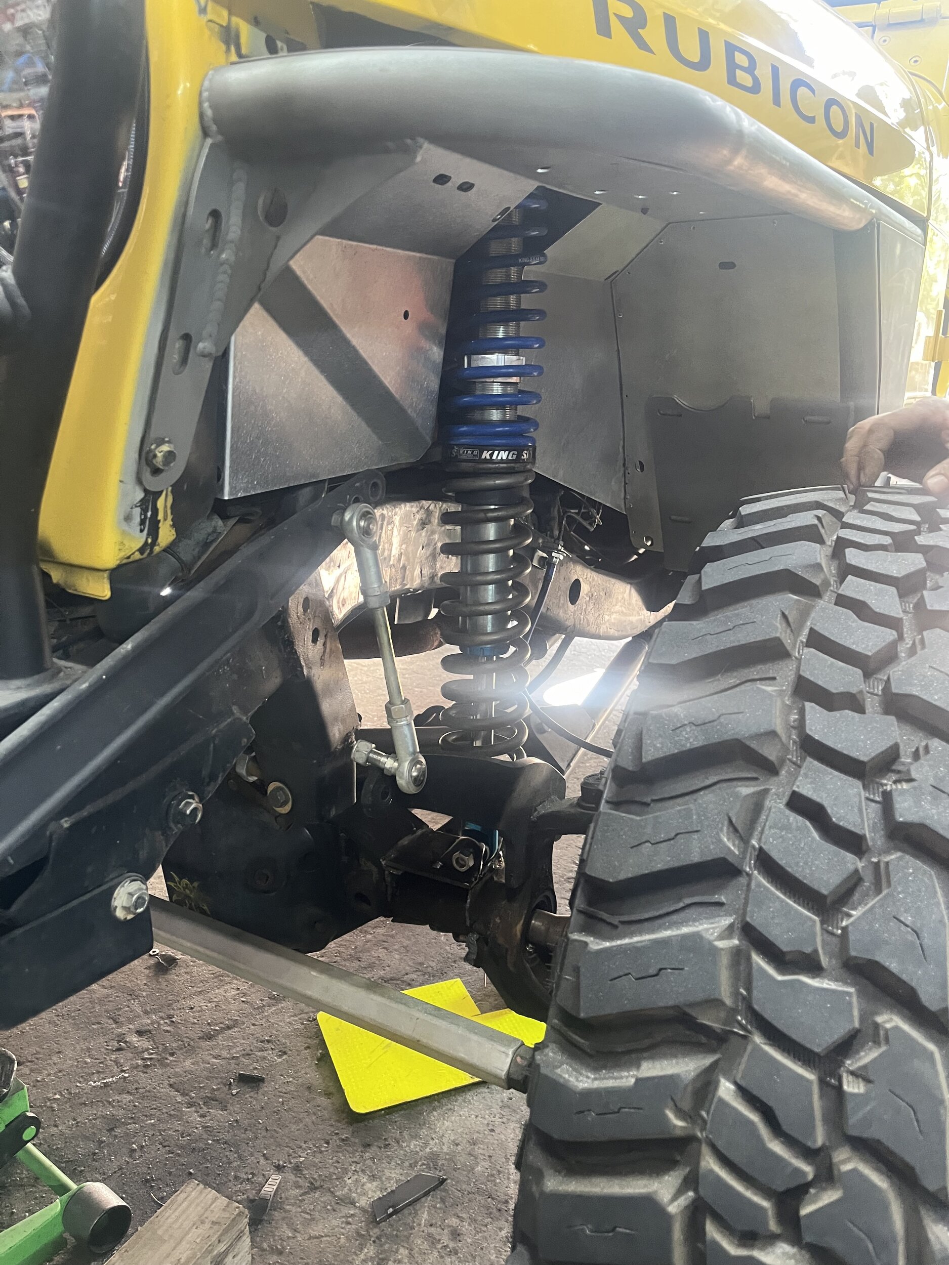

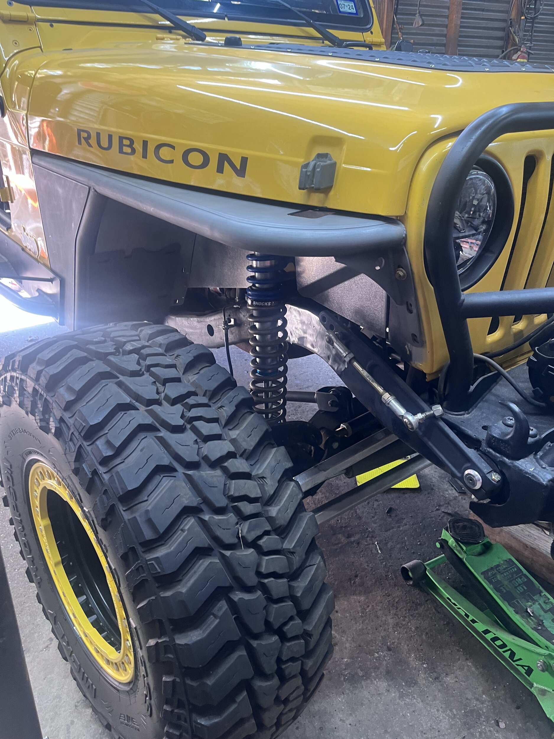

Some teaser shots, sitting on its own weight, front come back apart finish welding rework some stuff long overdue on steering but light at end of tunnel for coilover swap and stretch. Hoping for a shakedown run end of year, gotta get bump stops and limiting straps sorted but should be driving in next couple of weeks. We went into this thinking front would be straight forward but ran into more head scratchers and pivots then the rear. Will do it all over again with a buddies next but excited to see it done.
