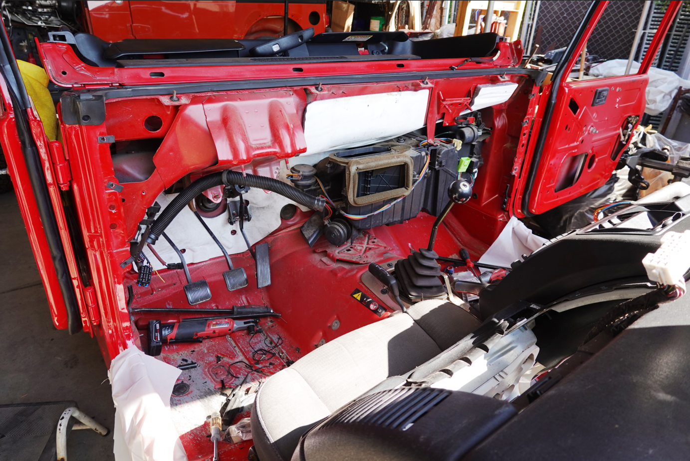

Well, I can tell you that installing the correct XBODY harness to get the hard top to function as it came from the factory is not for the faint of heart. You will touch every part of the rig from under the hood to the tail lights to get that swapped in including pulling the dash.
As I’ve said before, you are a good man @mrblaine
We have the factory harness purchased from a member here but like you said, I’m a bit faint of heart and he lives primarily in Va Beach area so how necessary is a defogger in Va? IDK.
We are good at swapping harnesses and I was astounded at the effort we put out to get that one swapped in as something that was a stand-alone swap. As part of some other work, it wouldn't be quite so bad. As a stand-alone, it pretty much sucked even given the fact that we didn't have to fully take it apart. We were in the process of assembling after paint so bare bones.
We are good at swapping harnesses and I was astounded at the effort we put out to get that one swapped in as something that was a stand-alone swap. As part of some other work, it woudn't be quite so bad. As a stand-alone, it pretty much sucked even given the fact that we didn't have to fully take it apart. We were in the process of assembling after paint so bare bones.

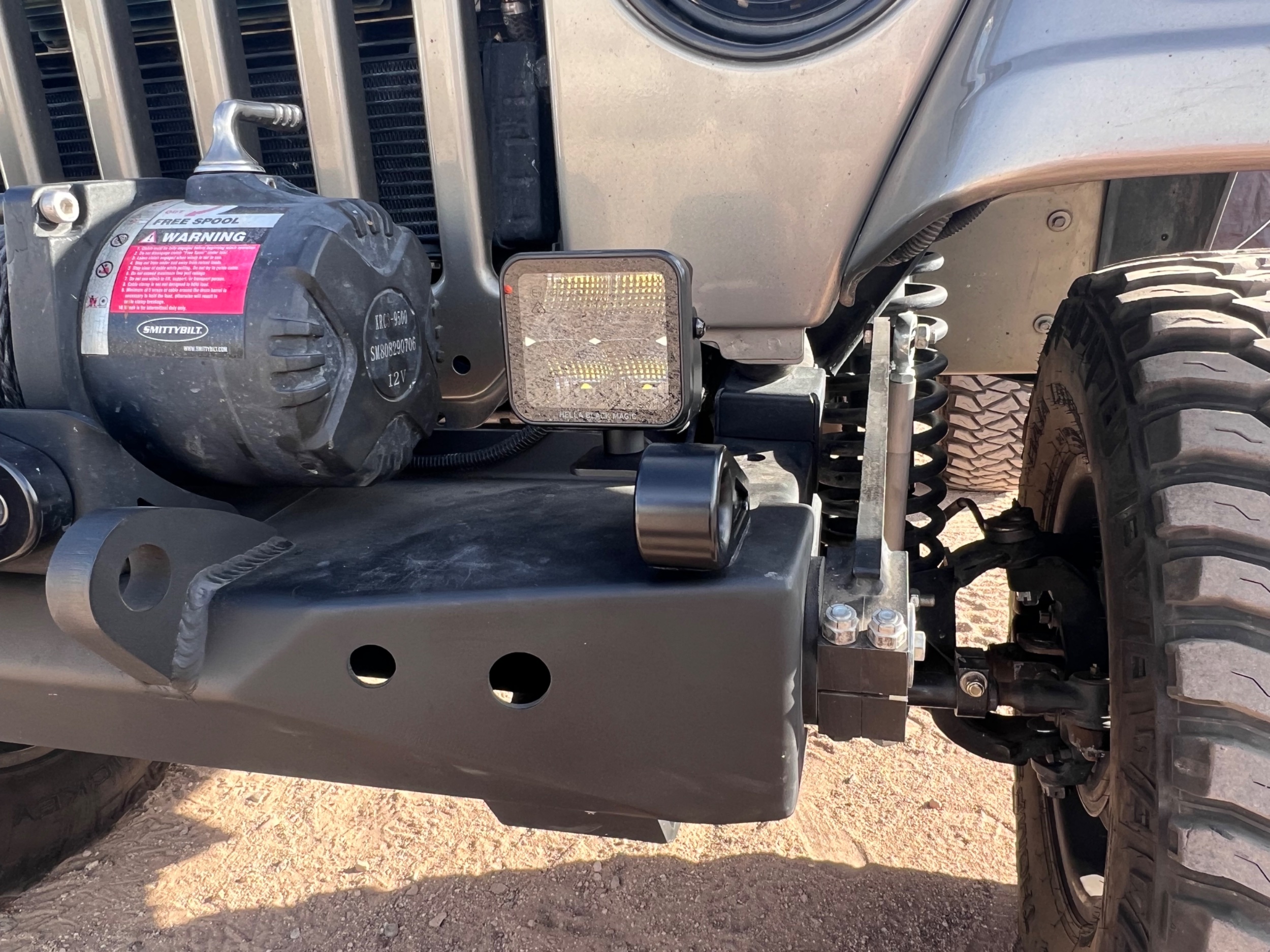

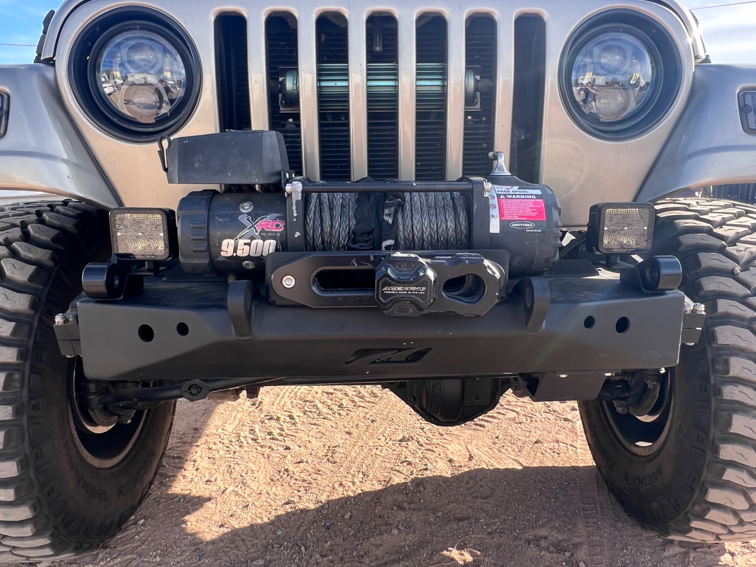

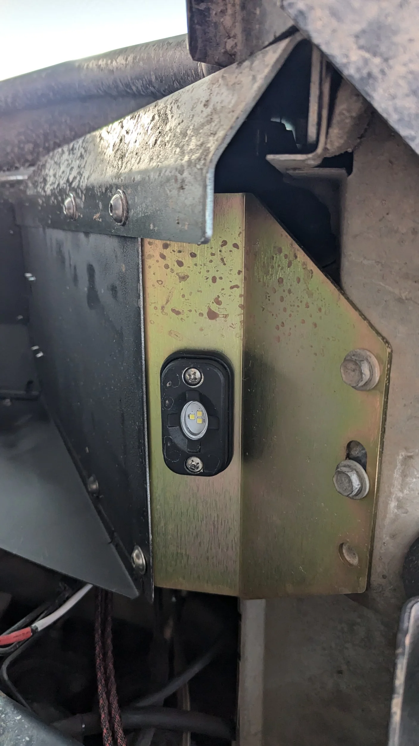

If you don’t mind sharing, let us know where your switch is located along with your final mounting locations.
Locations are kind of a trial and error deal. May move them around to see what happens. Still figuring out a location in front of the rear tire.
Front crosses beams to avoid shadows. Rear is tucked up to avoid rocks.

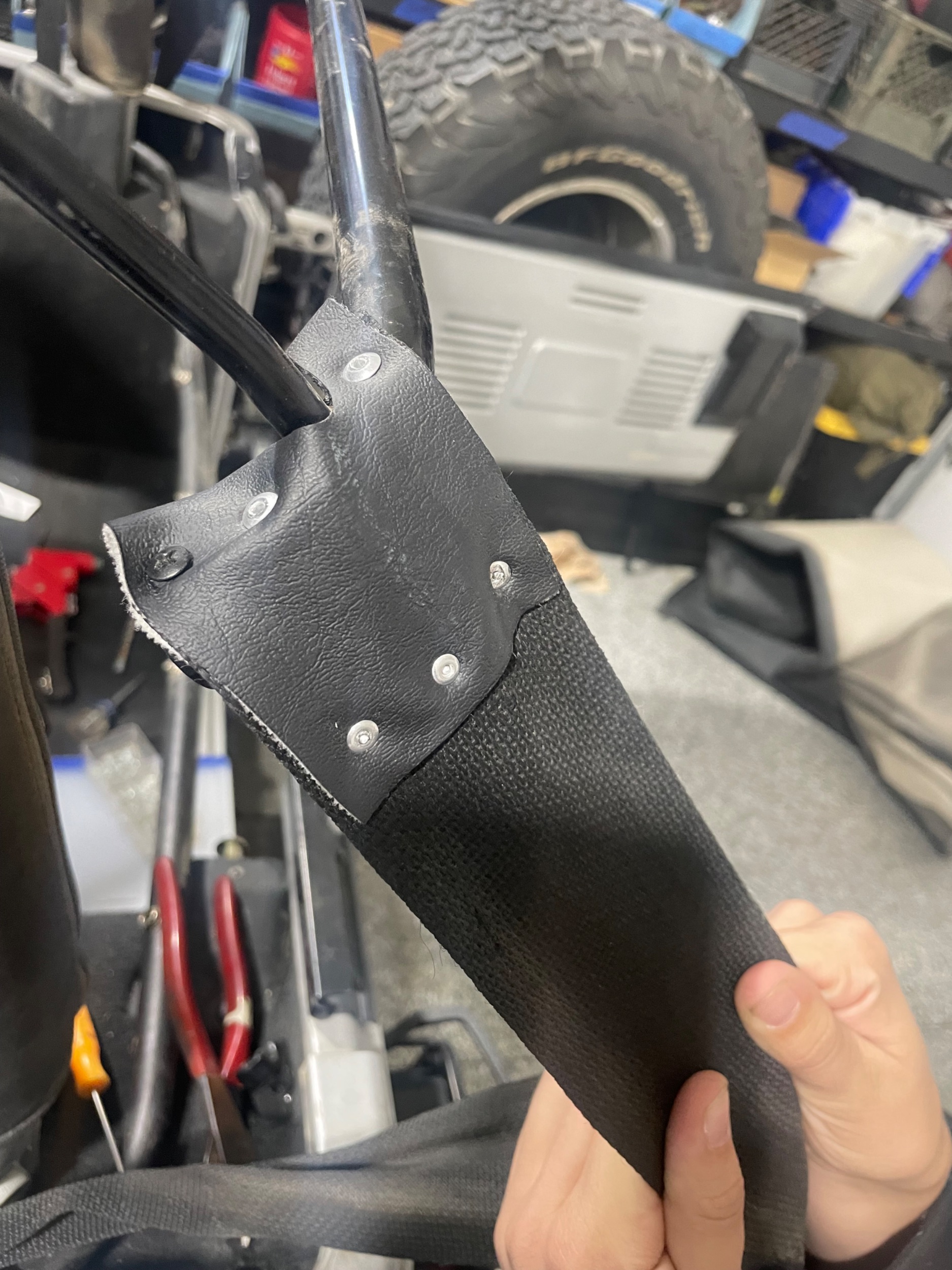

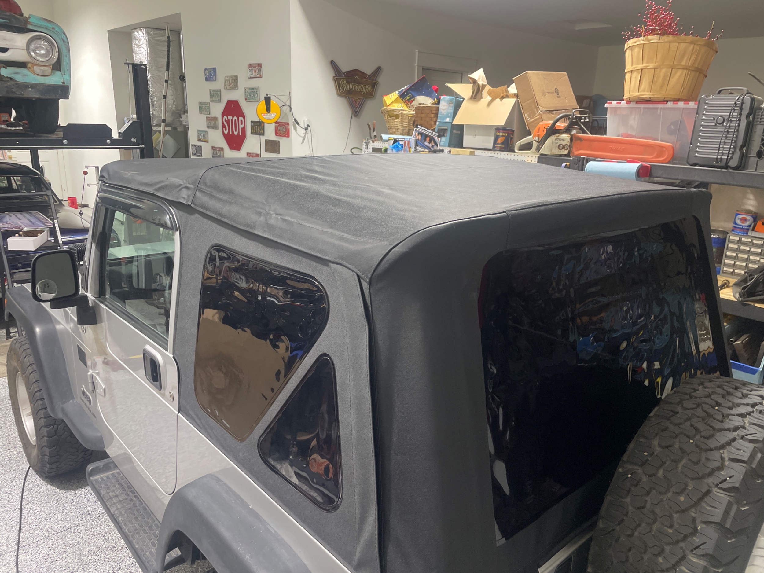

New soft top arrived, I am in the the throws of getting things to line up..but for now here is a shot of my strap repair. They were hanging on by a rivet or two so with out any webbing I came up with this ideas to reenforce the ends so I could keep motoring on with the project… my daughter joined me for the evening and that was nice to have the extra hands.View attachment 569390
fought that corner for a good hour last night trying get everything zipped up good and proper. Left a space heater it over night 20 mins this morning everything is looking good. New top definitely spruced up the look.

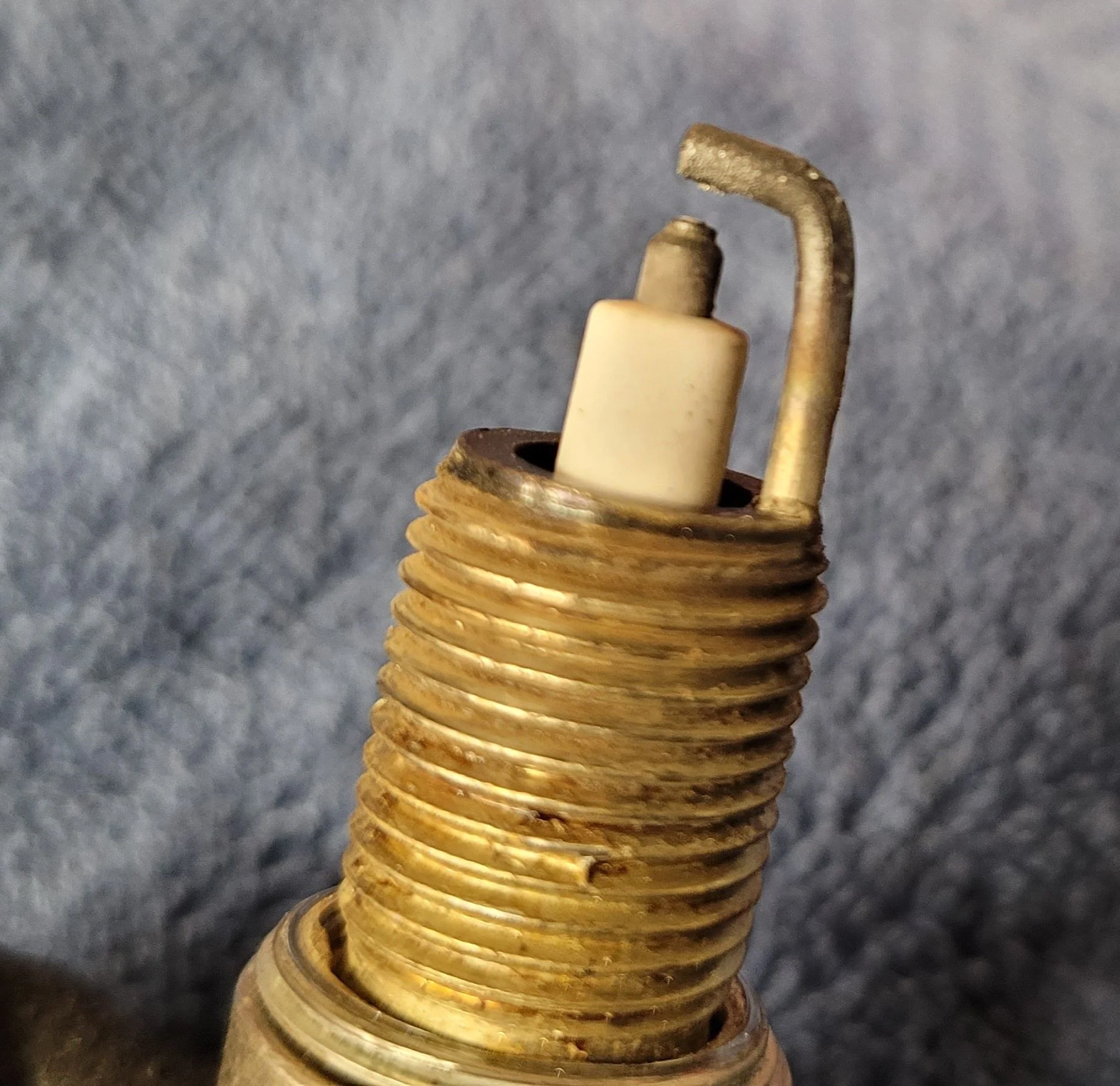

I think it was two weekends ago when I started troubleshooting the occasional P0301 misfire.
Pulled, checked, and adjusted the cylinder 1 plug. I think it looked fine? I look at charts of these and think this looks normal-ish.

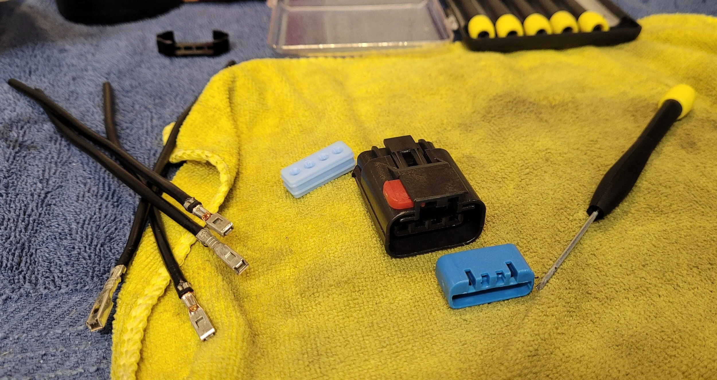

Got pissed at how difficult it was to reattach the coil connector. The rubber seal inside the connector was breaking down and made it damn near impossible to fully connect and lock. I got it connected, but needed to use the handles on a pair of pliers so both hands could push the thing home enough to lock. Total PITA.

Then I disassembled and de-pinned a coil connector pigtail (Standard Motor Products) to swap it with the PITA original.
Dissembled the one on the vehicle, and then put it back together with the replacement connector.
Now it attaches and locks with light pressure.

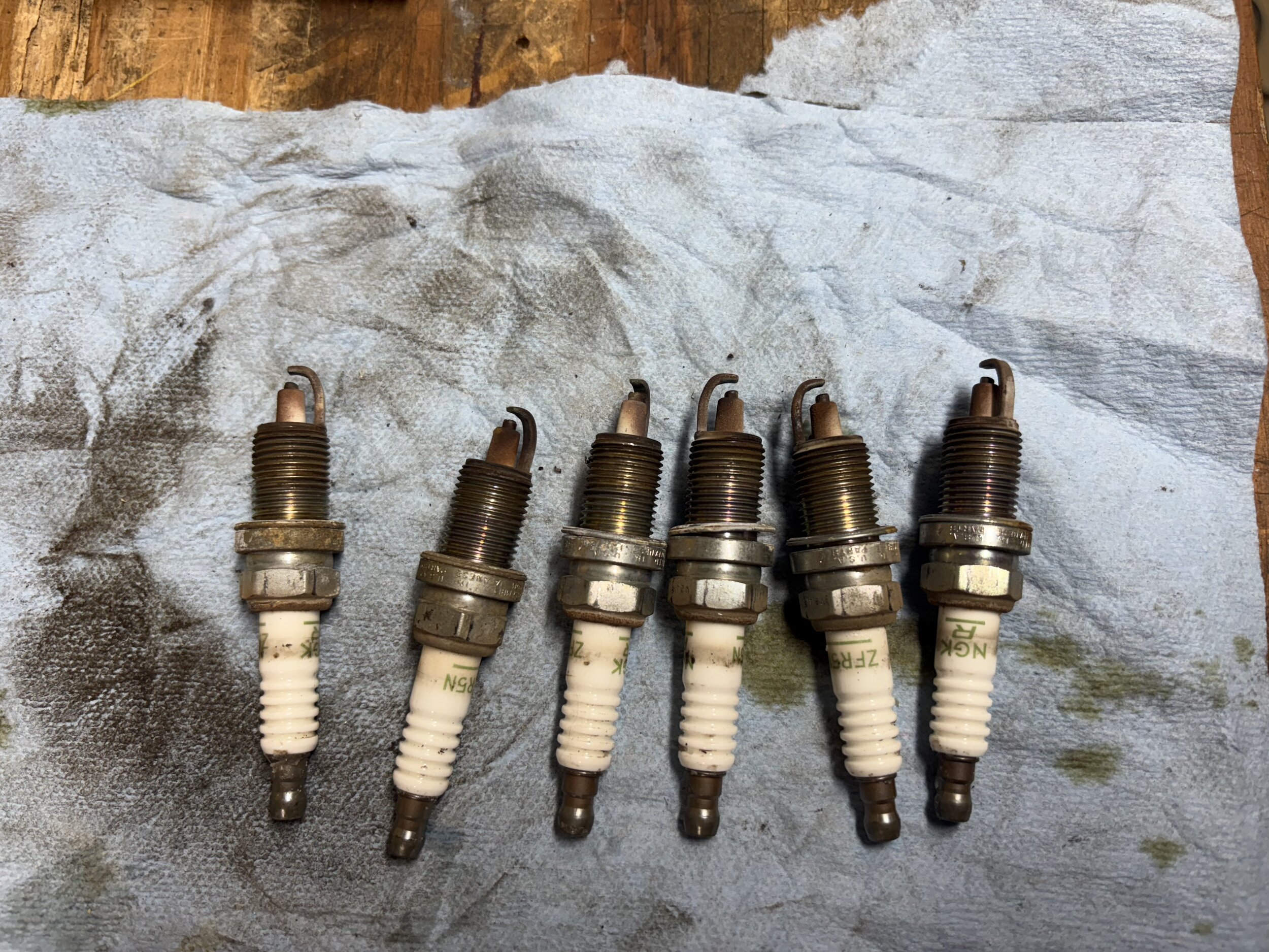

Ruby has about 119,500 and change on her. So today she got new plugs, coil boots and was due for an oil change so did that too. Still need to flush the cooling system and replace all the components minus the radiator.
Plugs seemed okay, per the maintenance record from the PO 60K service was done so I assume the plugs were replaced then.

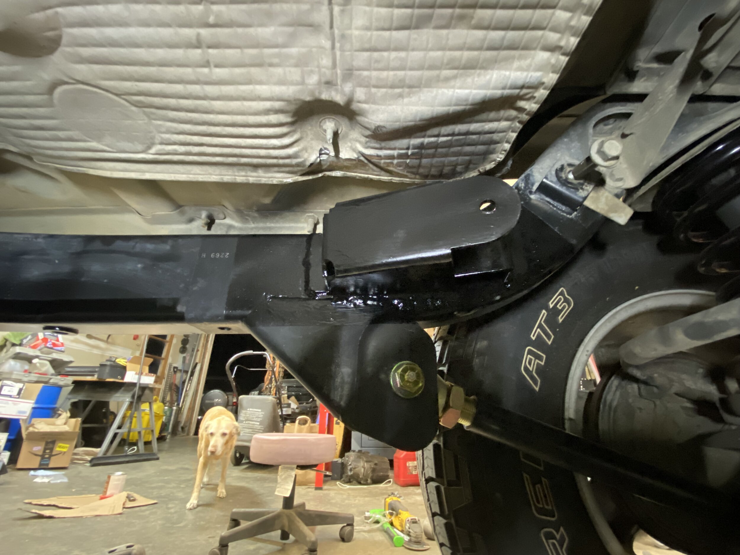

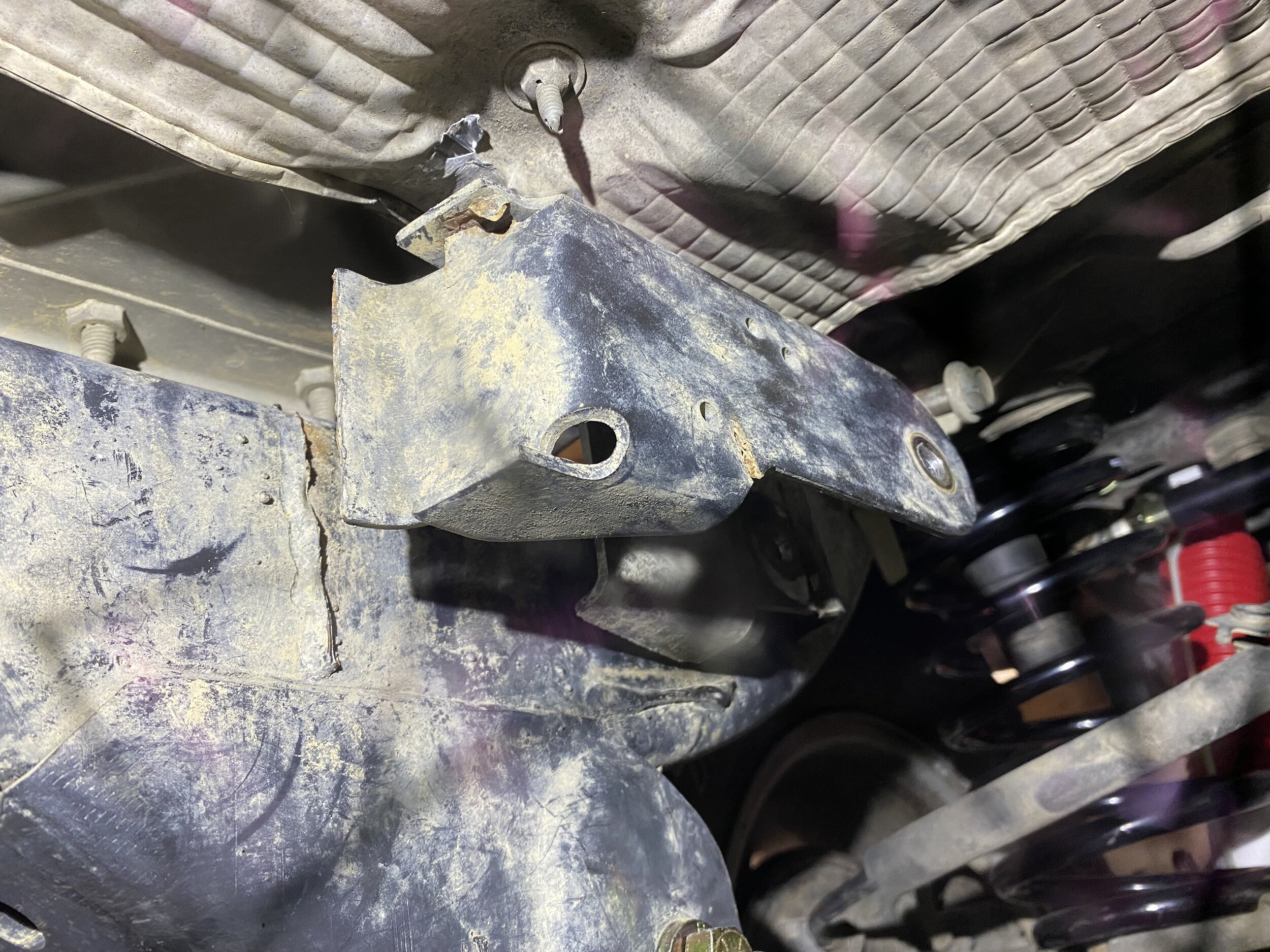

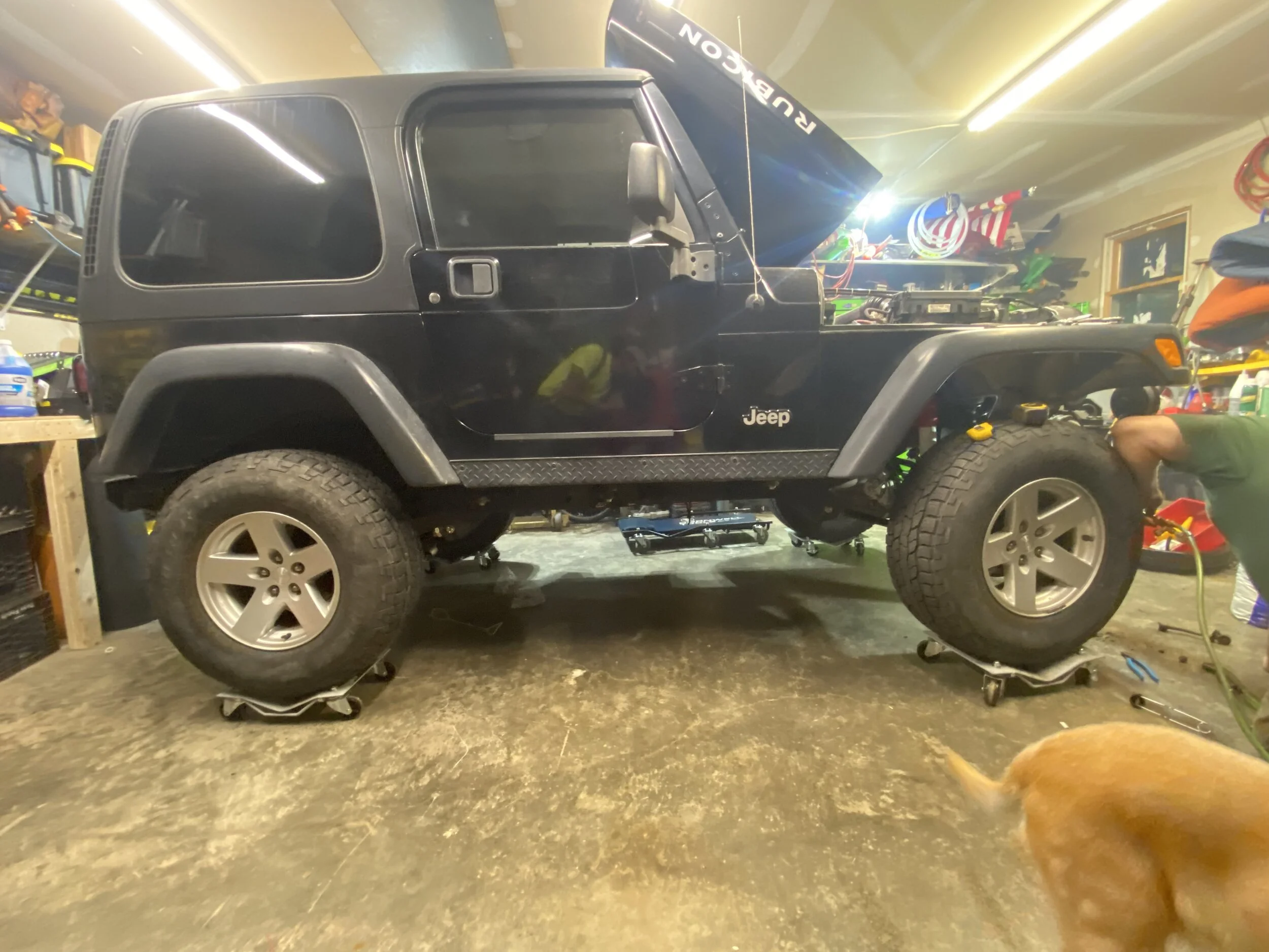

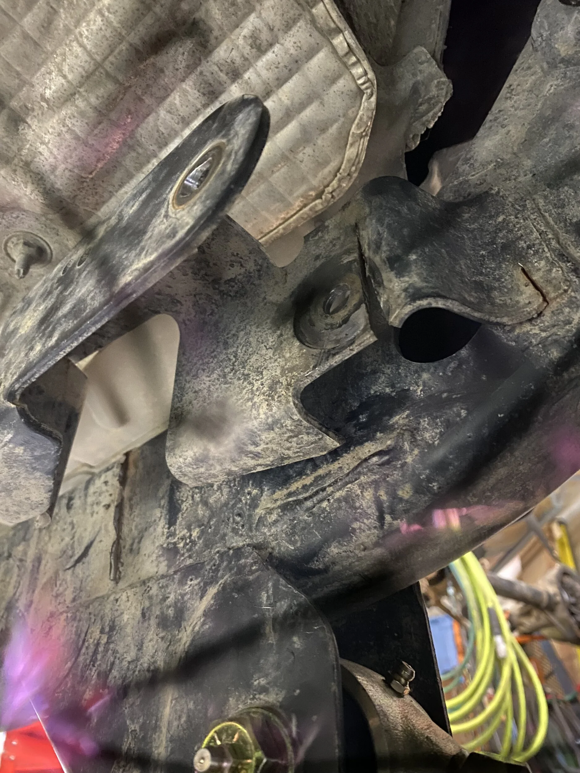

Few hours a few days after work this week and we are making progress with “Bens Deployment Build “. While cycling the rear suspension and wondering what that “clunk” was we found the stock passenger side UCA was about to fall off and had been that way awhile…
Edit: note the factory UCA mount welds were never done properly from the factory.
Got Barnes on the horn and in two days had the replacement on hand.
Mike came by Thursday night and burned it in for us (Dave and I are not welders🤣)
Put some paint on it last night then moved on to the fuel tank skid…
I can’t tell you how much joy there was when the skid I picked up a few weeks back from @Drastic solved all our track bar/fuel tank skid clearance issues.
Moving along smooth.
All new brakes arrived thanks to @mrblaine and his excellence. I mean what better of a man tells me to buy the rotors elsewhere to save $$ and then blesses Ben with the parts I couldn’t seem to locate.
New @Shawn at Tom Wood's shafts on order, A++ for tech support and good ole’ salt of the earth customer service.
Gonna spend some time on it this weekend too.
