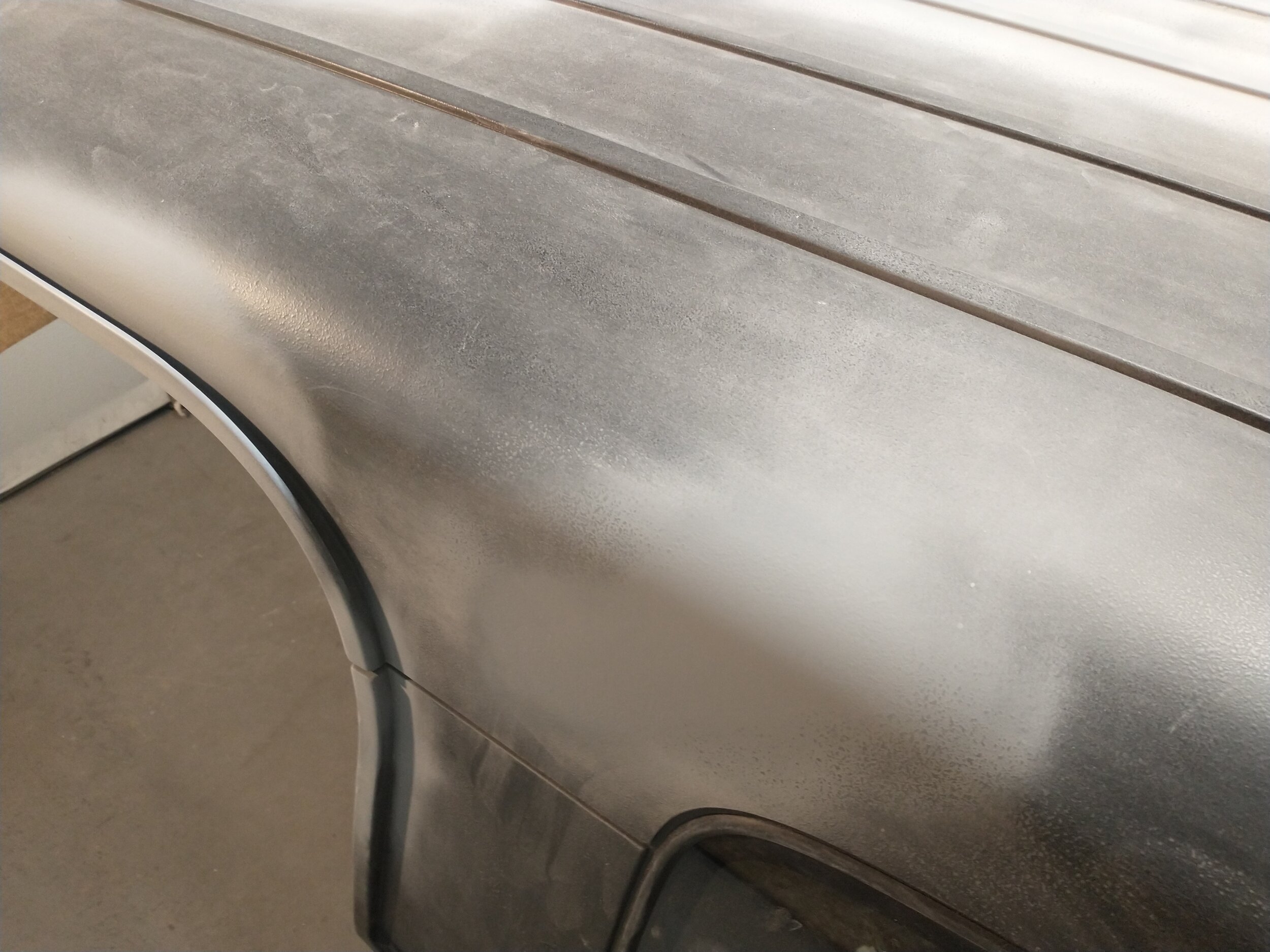

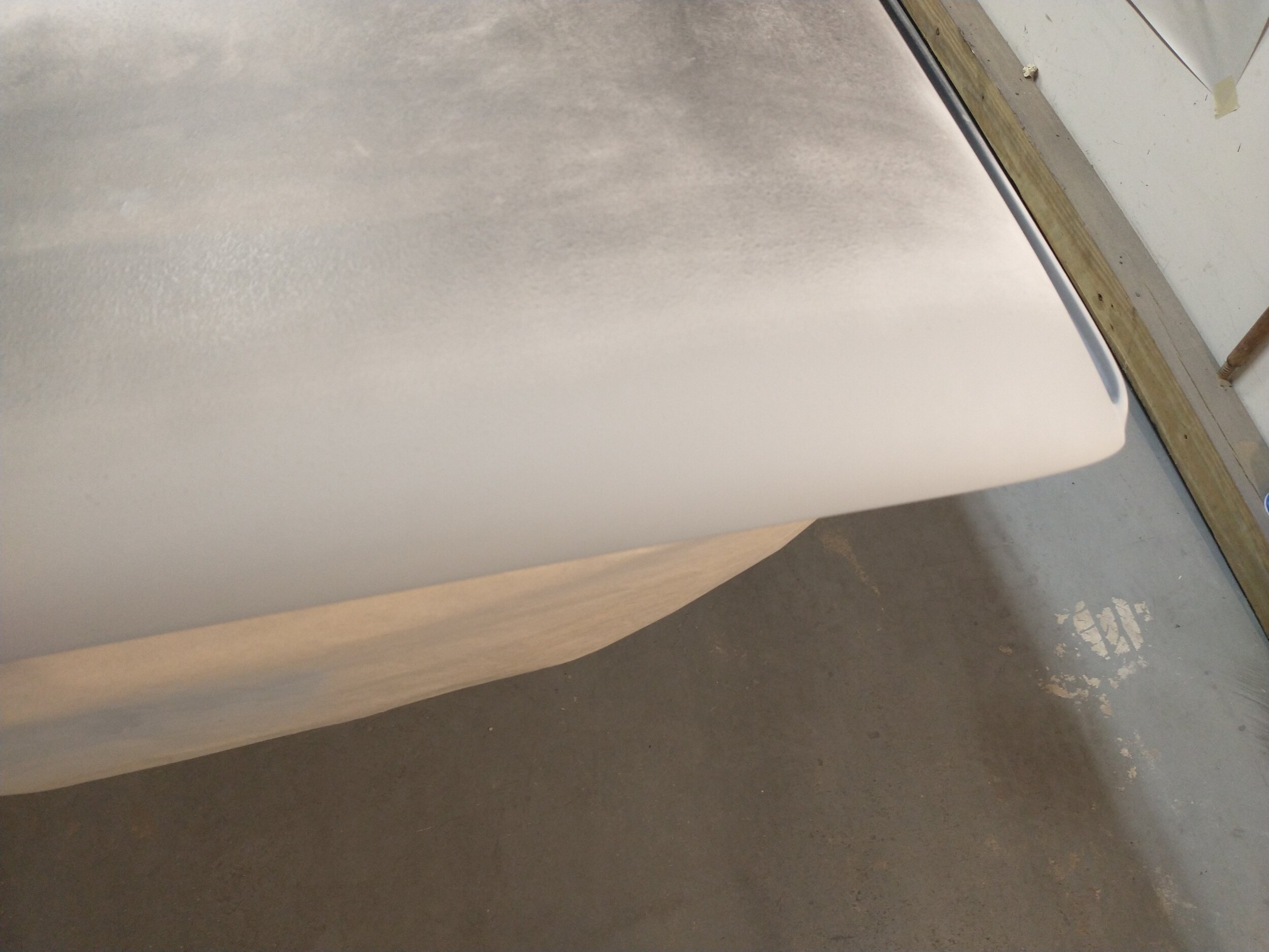

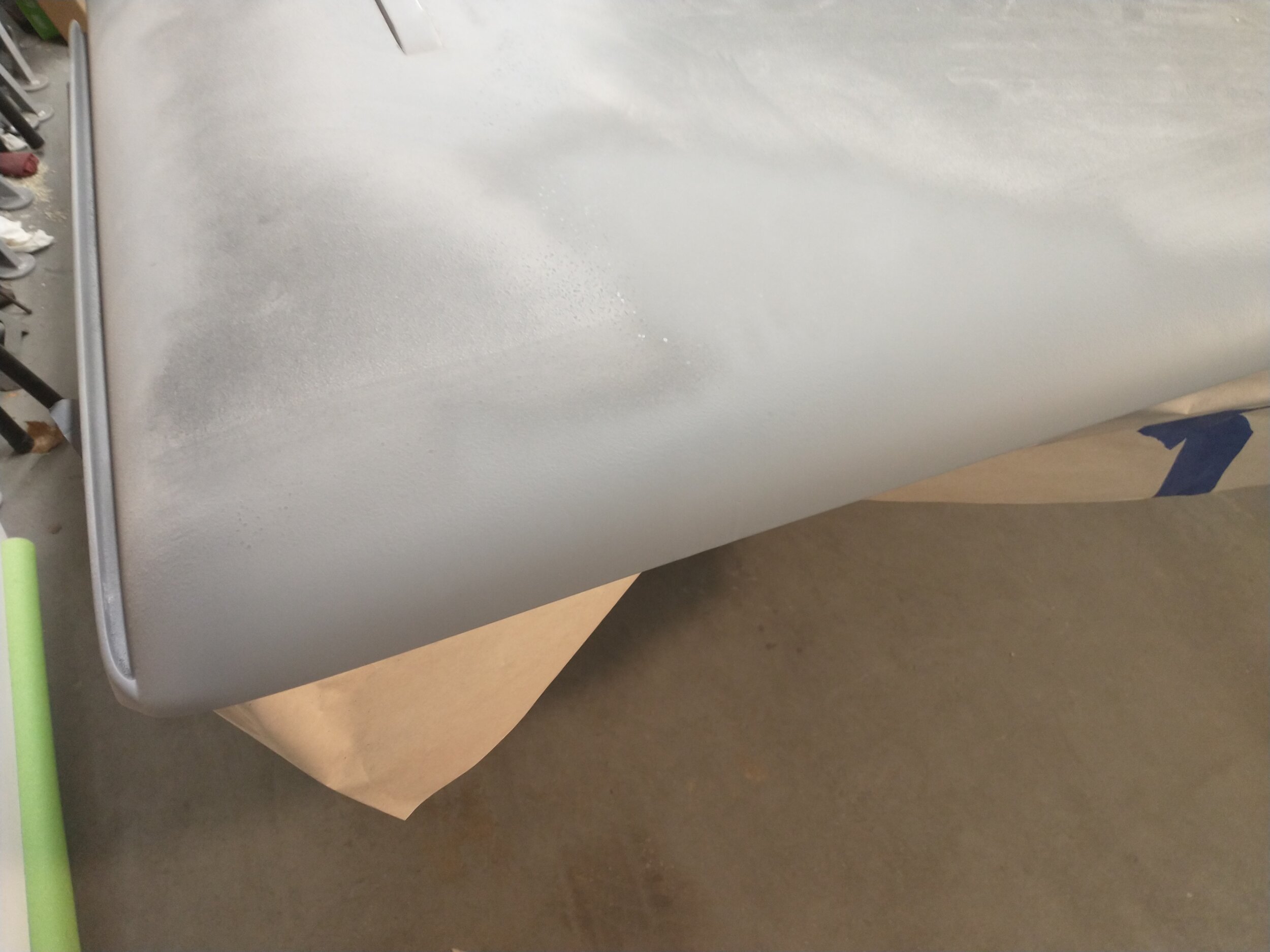

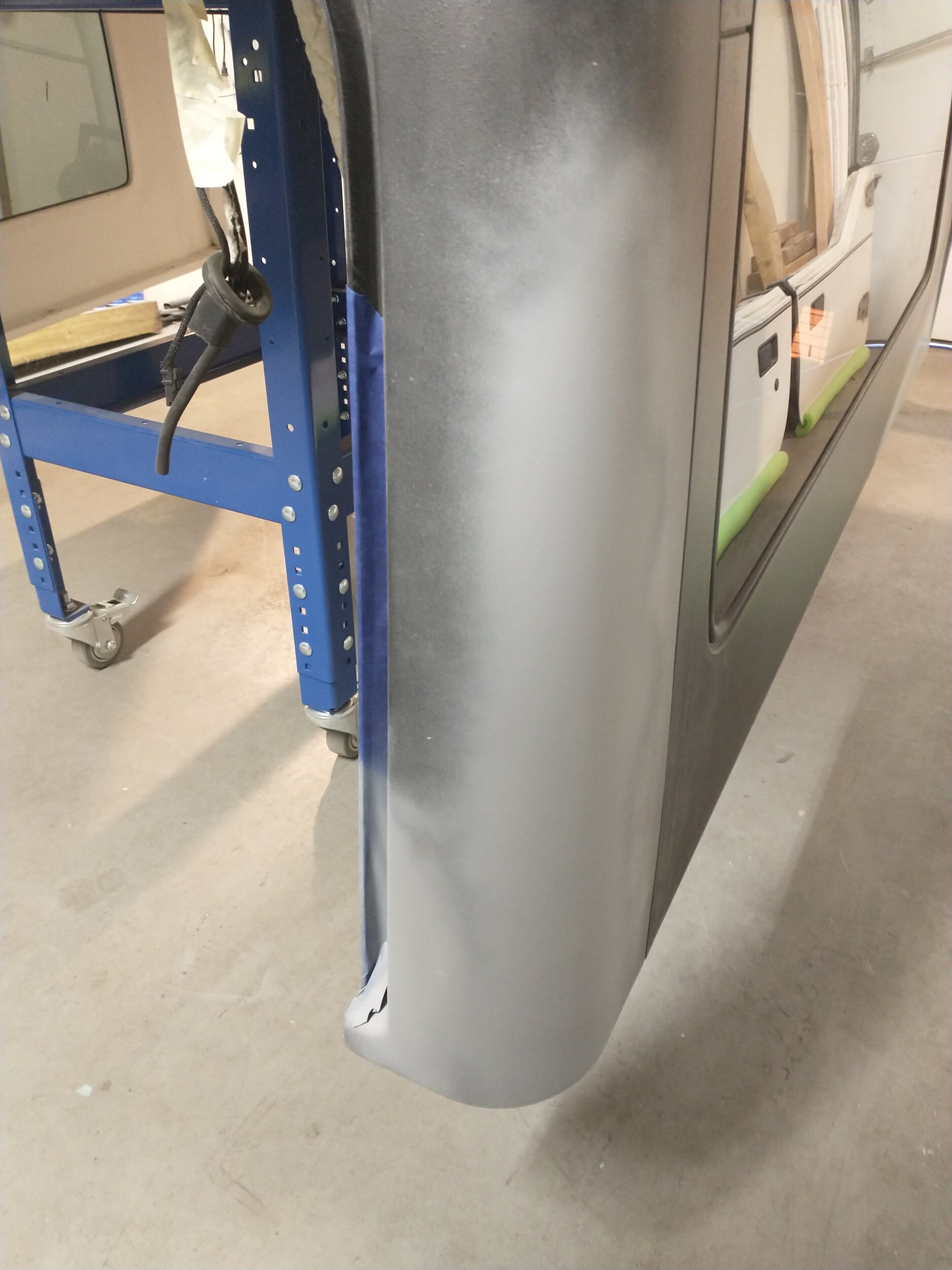

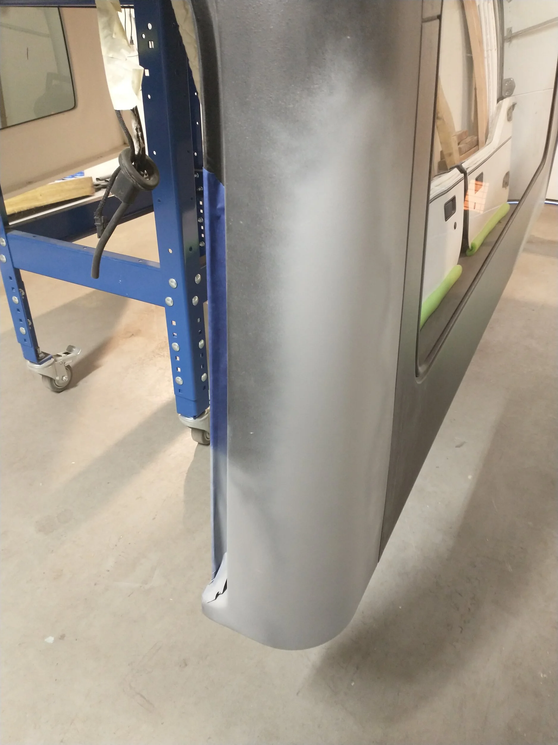

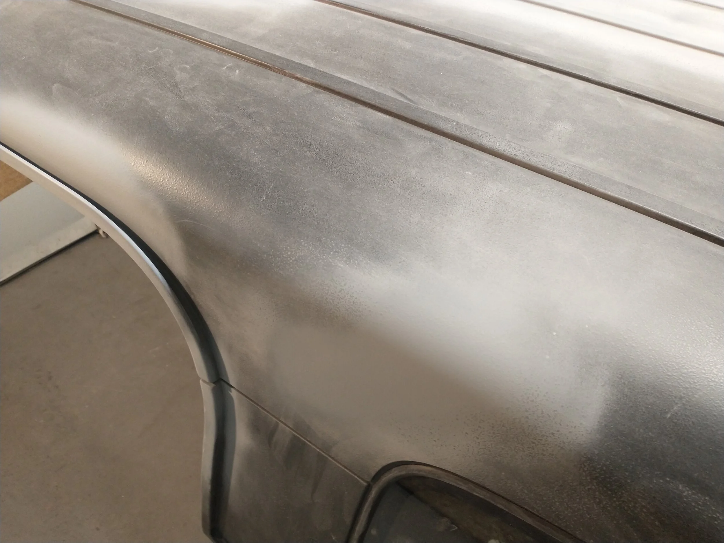

Been about a month since the last update to the ongoing saga that is Project Long Jeep Hard Roof Rehab, so here goes...
Last time I'd just finished up the major repair just behind the passenger door (missing chunks of SMC fiberglass), flipped the top (thanks again to my neighbor) and started work on the issues topside. Finished off the remainder of the filler work yesterday, today I applied two coats of primer/filler and started blocking it back.
IMG_20241103_164812167.jpg IMG_20241103_164805860.jpg IMG_20241103_164504524.jpg
Pleased with how all of the spot repairs turned out, though all of this is getting a bit more difficult since the temps dropped. Buddy heater to the rescue once again, but the garage is quite small and I don't like sanding with the door closed. Fortunately, the end of the repairs is in sight...
...but that means it's time for refinishing. I had planned on spraying it myself, but out of courtesy for the folks living in the unit above the garages, I'm considering having it sprayed by a shop instead. As a former body/paint tech, this is a painful decision for me but if feels like the right thing to do. They're nice people and I don't want to gas them out with catalyzed paint fumes.
Before the refinishing, I've got a rather major decison to make...to texture or not to texture, that is the question. I've been playing around with two different products, spraying test panels, and I think I can come pretty close to replicating the factory texture. Spot blending the texture is another matter entirely. @DuckNut had mentioned a friend of his repaired his top and sanded the thing smooth before re-texturing for a consistent finish. While not a bad idea, initially I was hoping to avoid sanding the entire top smooth, but that was before I started the topside repairs, which ended up being more extensive than originally planned. Since then, a third option has materialized. I happened upon @UND_Sioux's build thread, where he's building up a black crystal clearcoat LJ (not dissimilar to my Tessie) and he had his hardtop sanded smooth and base/clearcoated to match the body. While it would still involve sanding the whole shebang-a-bang-a smooth and require the repairs and prep work to be arrow straight (or else risk looking like shite), it would have the advantage of being a much more durable finish, and one that would be easier to maintain. I submit exhibits "Sioux1", "Sioux2" and "Sioux3" for your consideration...
I actually think it looks quite good, but then the old school Jeeper in me waffles on it ('cause it's supposed to be matte black textured, dummy), making the final decision as to which way to go harder. Interested in what the WTF flock sayeth...

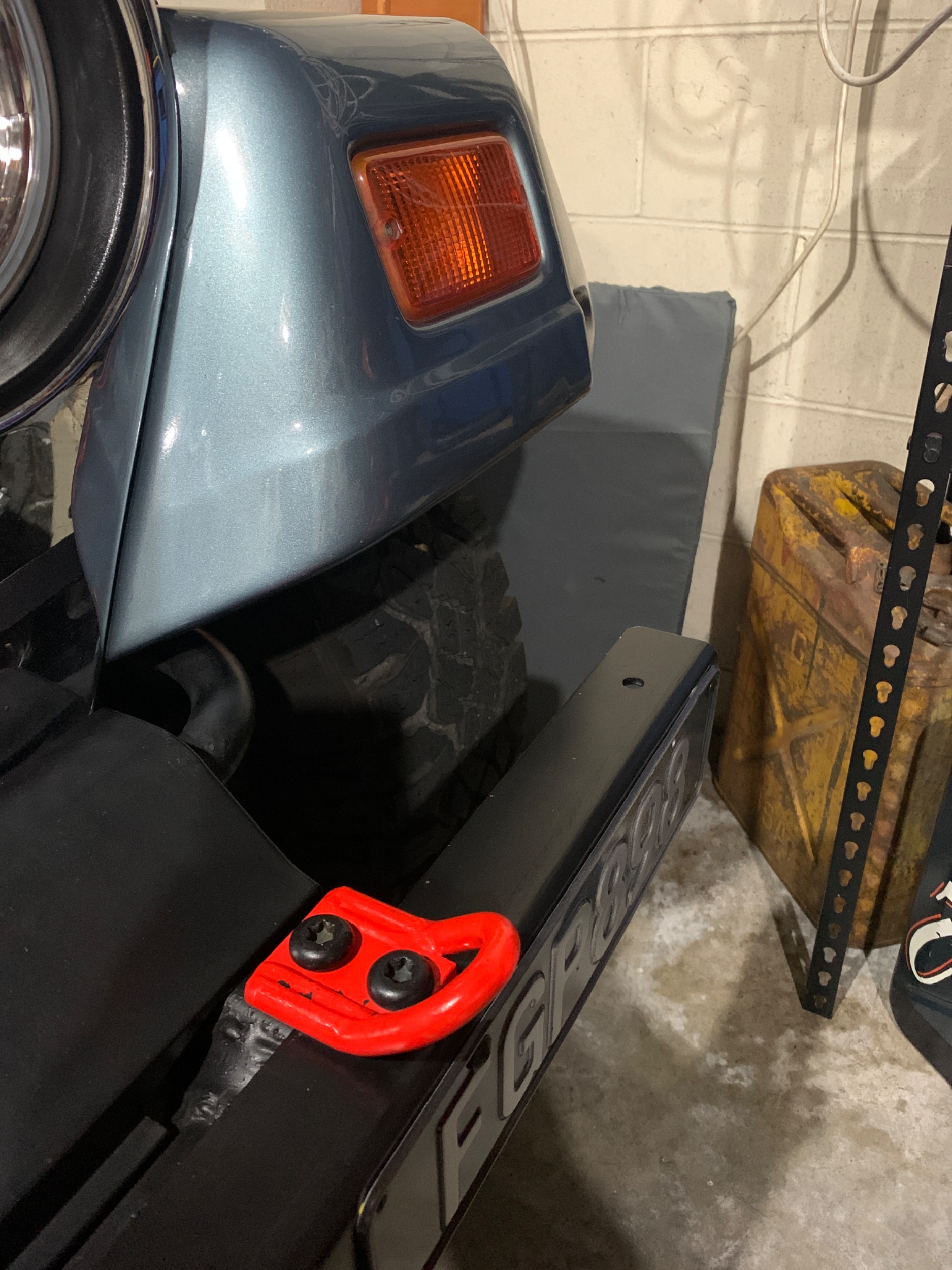

Good design, solid product, and made here by an American. Hard to beat that hat trick.
I can't speak to how the factory hooks, or even these, work with soft shackles, I'm intending to use mine mainly as forward safety line tie-downs when hauling surfskis (a job the factory hooks suck at). That said, I've now been "hooked" twice by the factory jobbies while working on Tess, fortunately without blood loss or permanent damage to any squishy human bits....but it sure woke me up! :D
Been there done that 😂 I have a few pairs of shorts with rips in them from those damn hooks..
The solution was to either change them to hoops or start wearing Daisy Duke shorts 😂😂
I went with the first option.
No doubt your neighbors appreciate your choice. :D
I saw your loops before, though I just figured your nanny gub'ment had outlawed sharp stabby bits on motor vehicles in your island paradise. :sneaky:

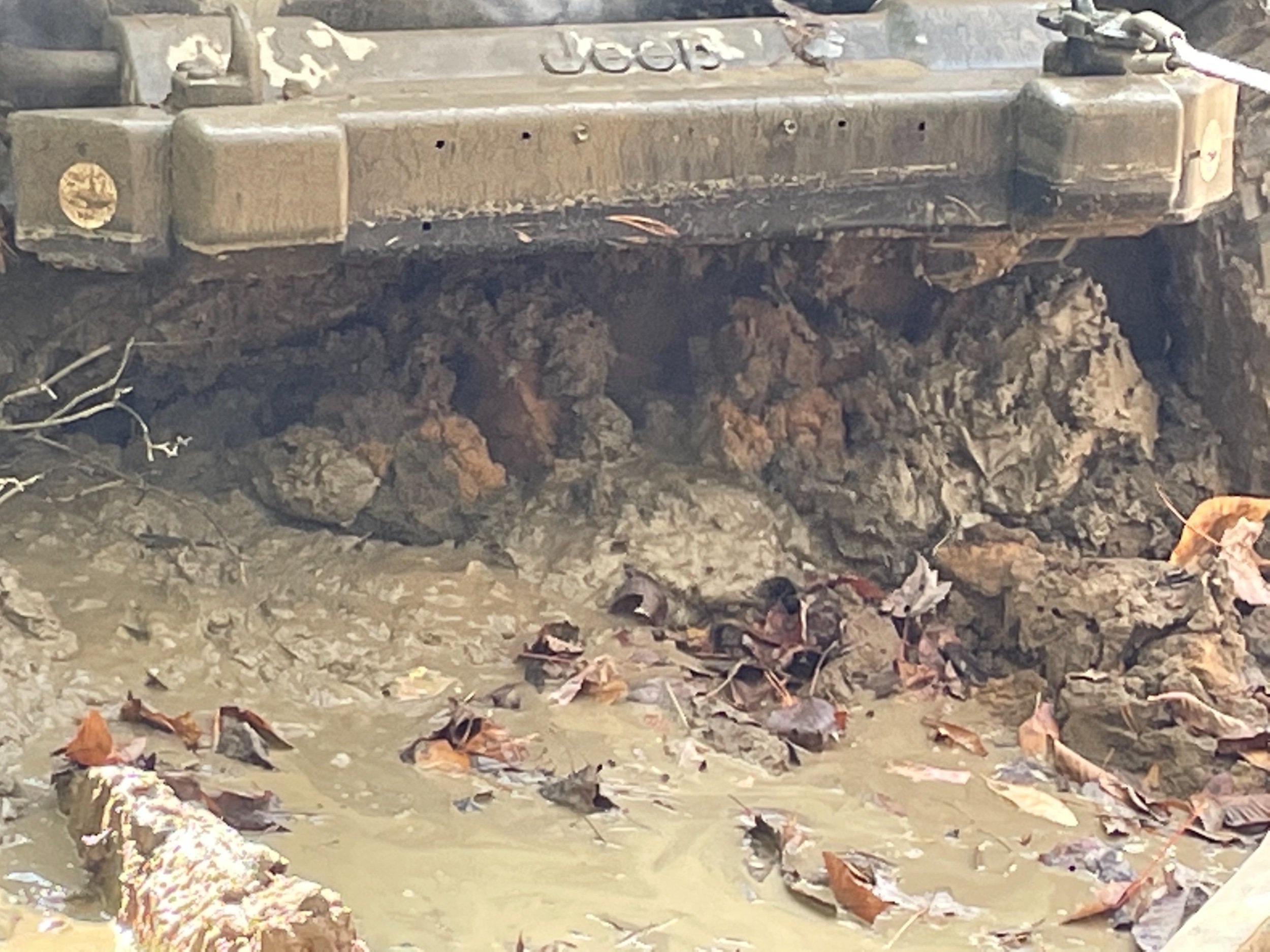

Is that clay in the last photo? If so, I feel like you'd have had better luck driving through setting concrete... :D
View attachment 569847 View attachment 569848 View attachment 569849
View attachment 569850 View attachment 569851

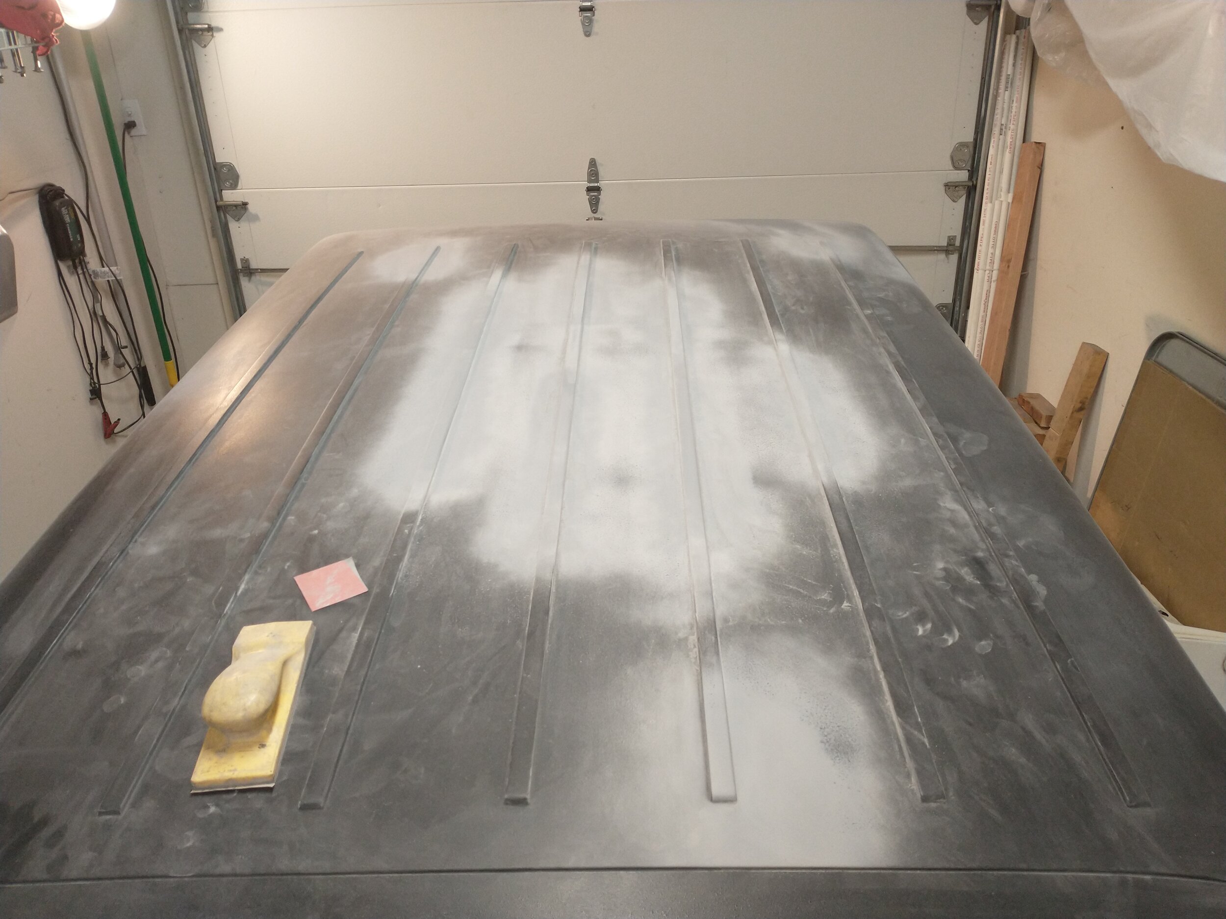

My friend who sanded it smooth basically had to go make all the repairs. I do believe that absolutely no sanding would be required if you had a body shop spray the "chip guard" texture over what is already there. The new texture would easily cover the original.
Here is a snapshot of the textures that can be had.
In my opinion there is no need to sand smooth. A professional body shop should be able to achieve a great finish.
Project is looking good.
Edit to my above post.
I think a DIY'er could get a great finish too. This is a two part product and as long as you follow directions you'll achieve good results. Using a quality top coat of choice is also easily attainable.
What I do know about paints is a 2 part paint is not the best choice. Yes it is superior in every way except the one that matters. It is nearly impossible to make repairs due to scratches.
I would go with a single stage satin clear over an automotive paint. On our classics I personally do not like the matched tops. I also like the contrast between the shiny body and the satin top.
That may well be the case, though it feels like I'm already a third of the way there, and I'm not done blocking the filling primer yet. :D
The crux of the biscuit, as they say. Being that I did this kind of thing for a living in a previous life, I'm a bit leery of others doing the work and tend to be very picky/critical if someone does. While there may well be some quality shops around, finding one that won't bend you over the desk on price is another matter, entirely. The premium/penalty one pays for living near absurd wealth, they figure everyone can be had...
I haven't started the process of finding a shop yet, but that will need to commence shortly. Any idea what your friend paid to have his done? I'm assuming he did the the repairs based on what you said and that the shop handled the texture and topcoat. I would ask @UND_Sioux the same, but I believe he had everything painted at the same time, top, body and flares. Tess doesn't look too bad from 10ft away, but she could use a respray...not really in the budget at the moment.
I really need a 2 bay shop and suitable air compressor, I've still got my spray guns... :cautious:
Appreciate that. After dicking around with it on weekends over this summer, I'm glad to be finally finishing up this phase of work.
Many are not catalyzed, but I did notice that about the SEM product.
Base/clearcoat systems tend to make spot repairs easier, but that applies more to body repairs where you have panel breaks to work from, where you can blend the base beyond the repair area and then clear beyond that for better color match and uniform finish. This approach does tend to require a larger repair area as well. That said, not really feasible on the hardtop as it has no physical breaks, you'd end up re-clearcoating the whole top anyway.
This is the bit I'm wrestling with. One day I think I'm going for body matched base/clear, the next I've convinced myself the traditional look would be better. Shame I'm not married as the wife would surely make the decision for me...and I'd have a scapegoat if I didn't like the results. 🤪

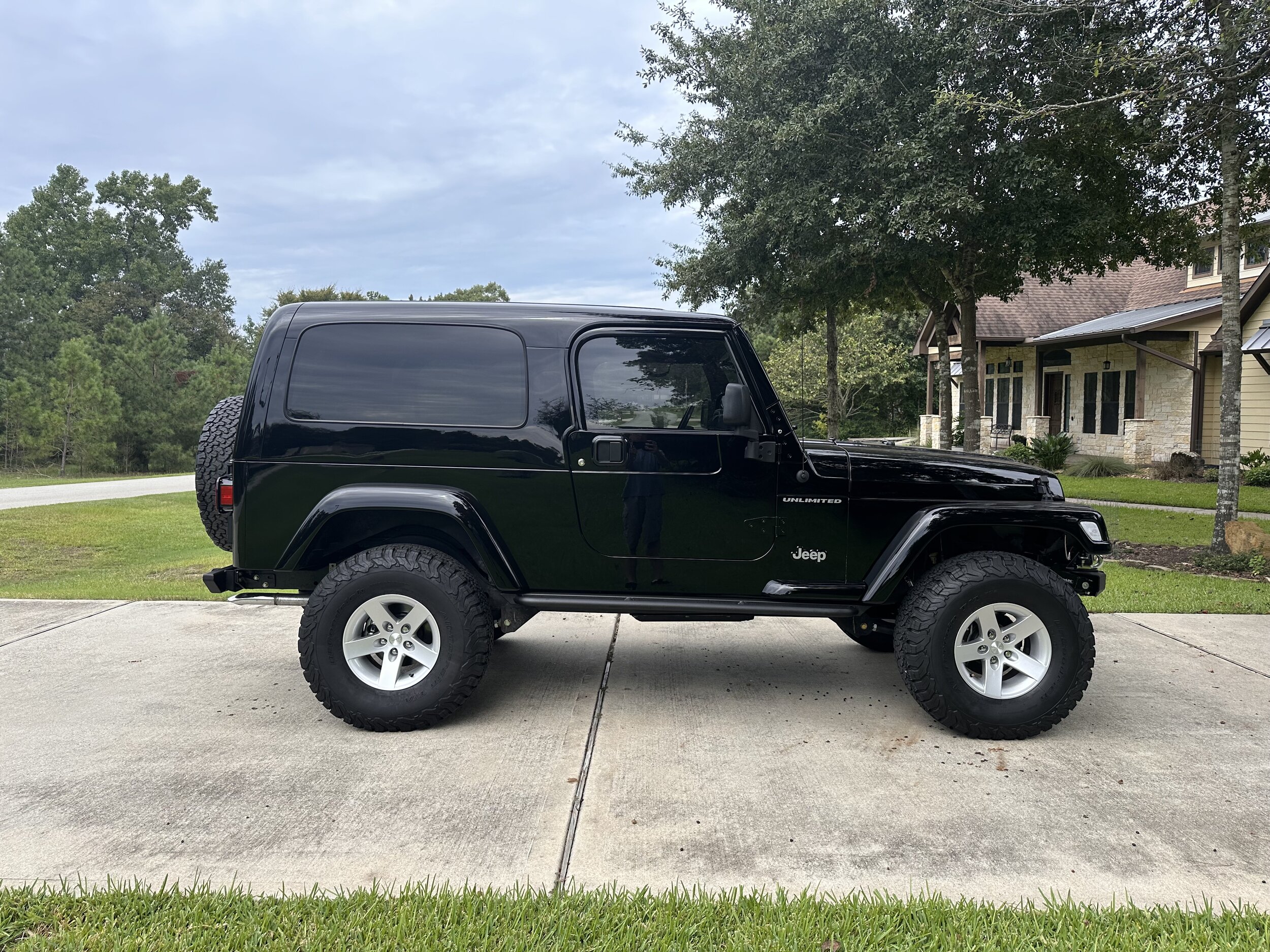

I feel like I can chime in here, I recently bought some parts from @UND_Sioux and as I live in driving distance had the pleasure of meeting him in person. His LJ is great and I saw the top while I was there.
It wasn’t the main topic of discussion, so I didn’t go over it with a fine toothed comb or anything, but I thought it looked fantastic.
As a fellow black Jeep owner I mentioned that I had the front half of mine resprayed at one point. If I remember correctly, he told me about having his resprayed and having the top done like it is at that time. I hope I am remembering this correctly, but he talked about doing the top the way he did specifically because the body is black, and seeing it in person I totally agree.
So that’s a long way of saying I have seen it in person, totally digged it, and as an old school TJ purist, I think you wouldn’t go wrong at all if you do the same.
