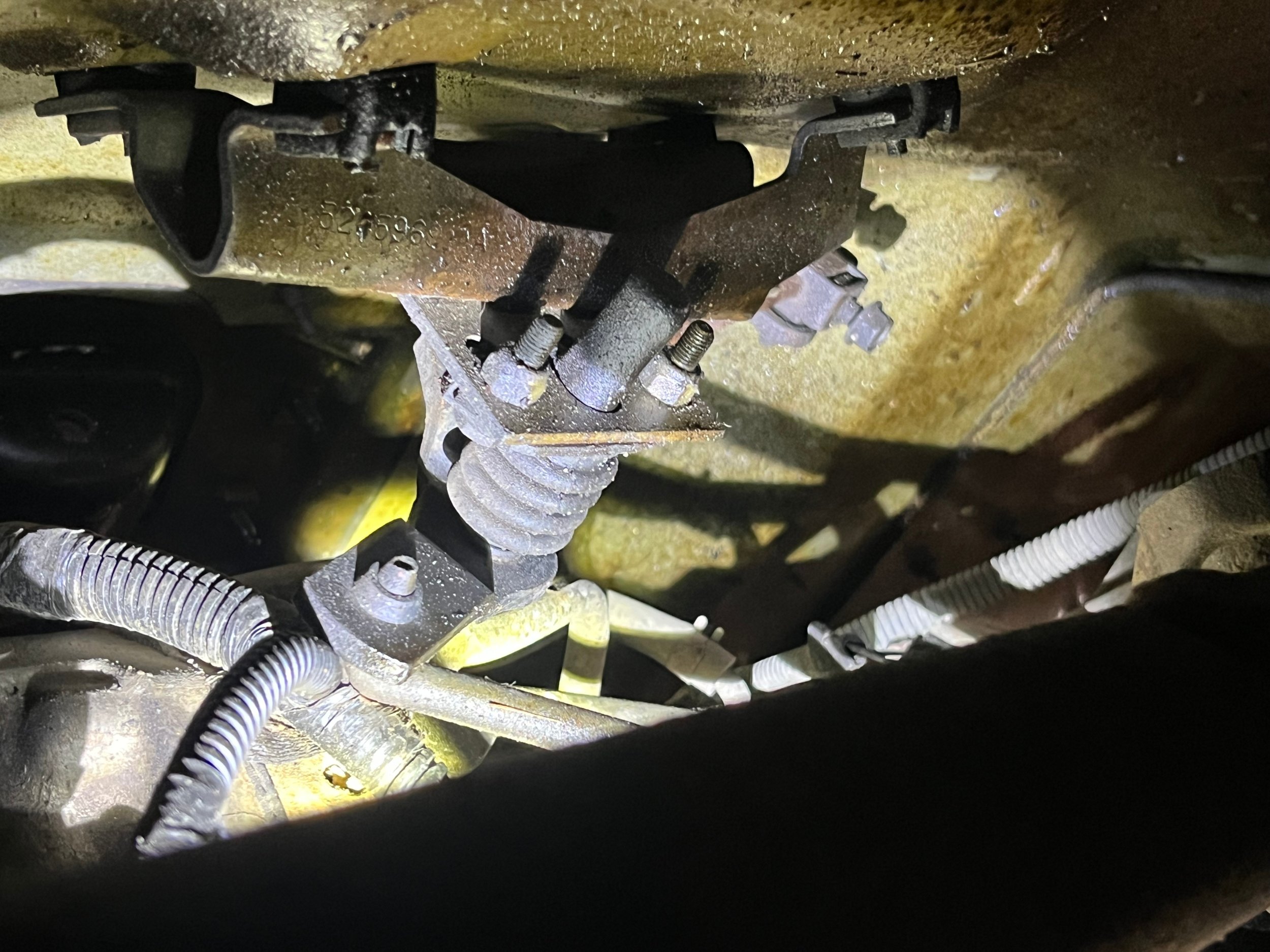

This is what I see under Mine one side goes to the automatic bottom lower left side of picture
one goes to the 4WD linkage upper right side of picture
im missing something

Yeah, looks like a stock transfercase shifter with a drop plate.
Just to be clear what exactly are you trying to do?
Are you removing the transfercase skid plate drop and wanting to return the shift linkage back to it's stock location?

if you replace the stock linkage with a cable shifter all those link bars go away.
if you just want to keep the factory linkage just remove that flat plate that is bolted to the bracket on the underside of the body tub, and once you raise the transmission and transfercase back up that pivot rod will line up between the bracket on the transmission housing and the bracket on the tub.
