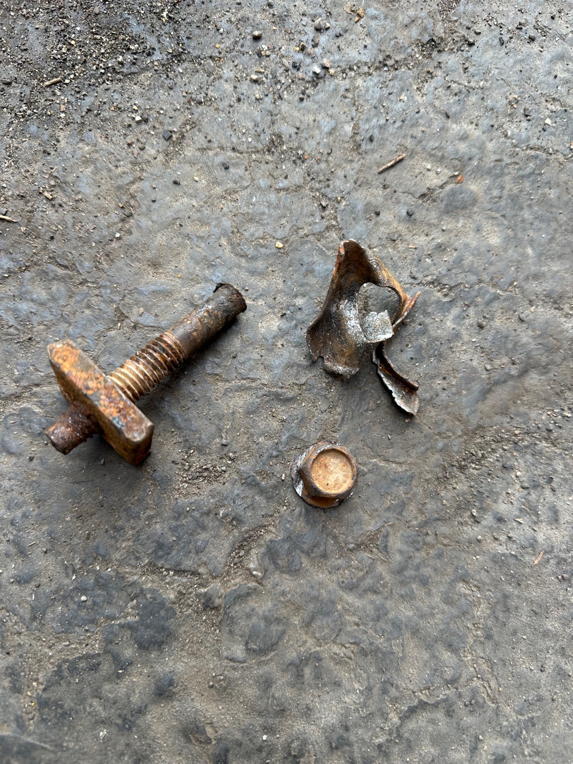

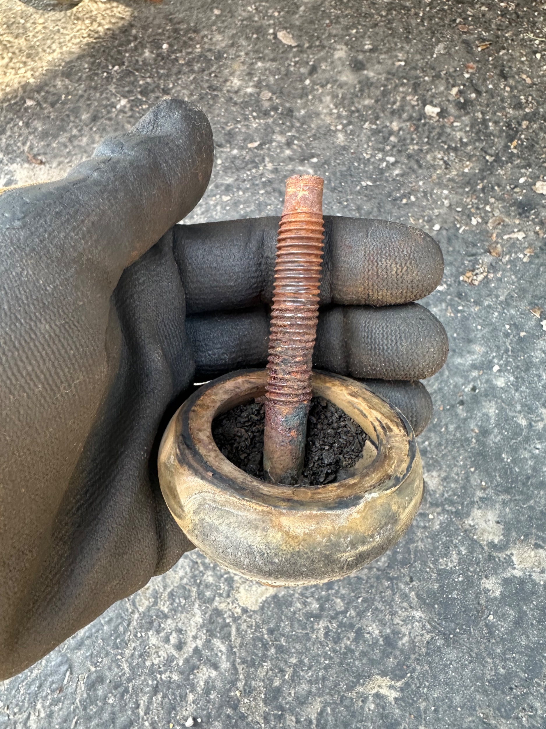

half installed my new 1.25 body lift from black magic today! First day back from Florida, looks like I brought the warm weather north.
Got all but one body mount off with the impact, same rear spinning one as the project Sahara. Had to cut the head off, cut an access hole, bash the bolt up to get the square retainer out of the way then rip it out. I’m not gonna lie I think everyone would be wise to cut this access hole. This spot loves to trap crap and it’ll rot the tub out from the inside. Some of the bolts were in terrible shape, also swapped in new body mounts while I was at it.
