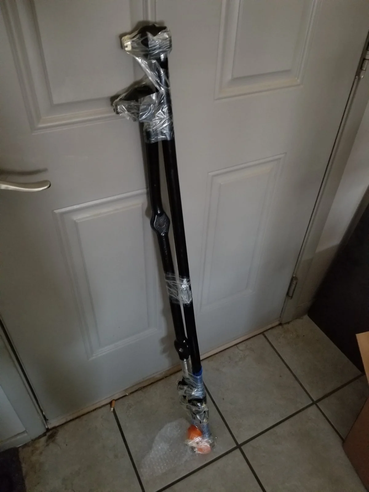

Hey man ,is that a long arm kit?
Didn't order a long arm kit.

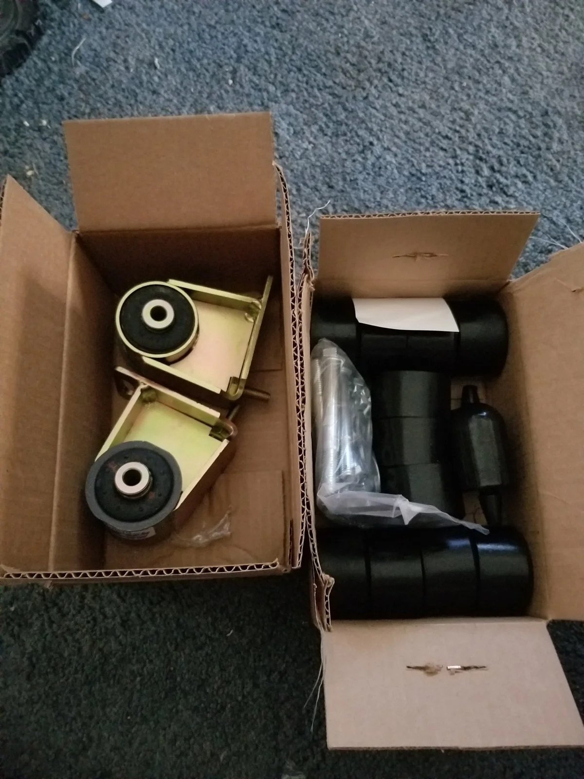

Right now I have a bunch of parts piled up waiting for my garage to be empty. Doing a engine rebuild on a 06 Hyundai tucson.
In the pile to be put on.
2 rear rancho shocks 5000x
Crown hd steering kit.
More bombproof mml
1.25" jks body lift
Monroe steering stabilizer (i know its cheap)
Inner shift boot
Speedometer gear (on order finaly shiped)
Led lights for the dash (blue)
Im going to be busy when i get done with my other projects.
