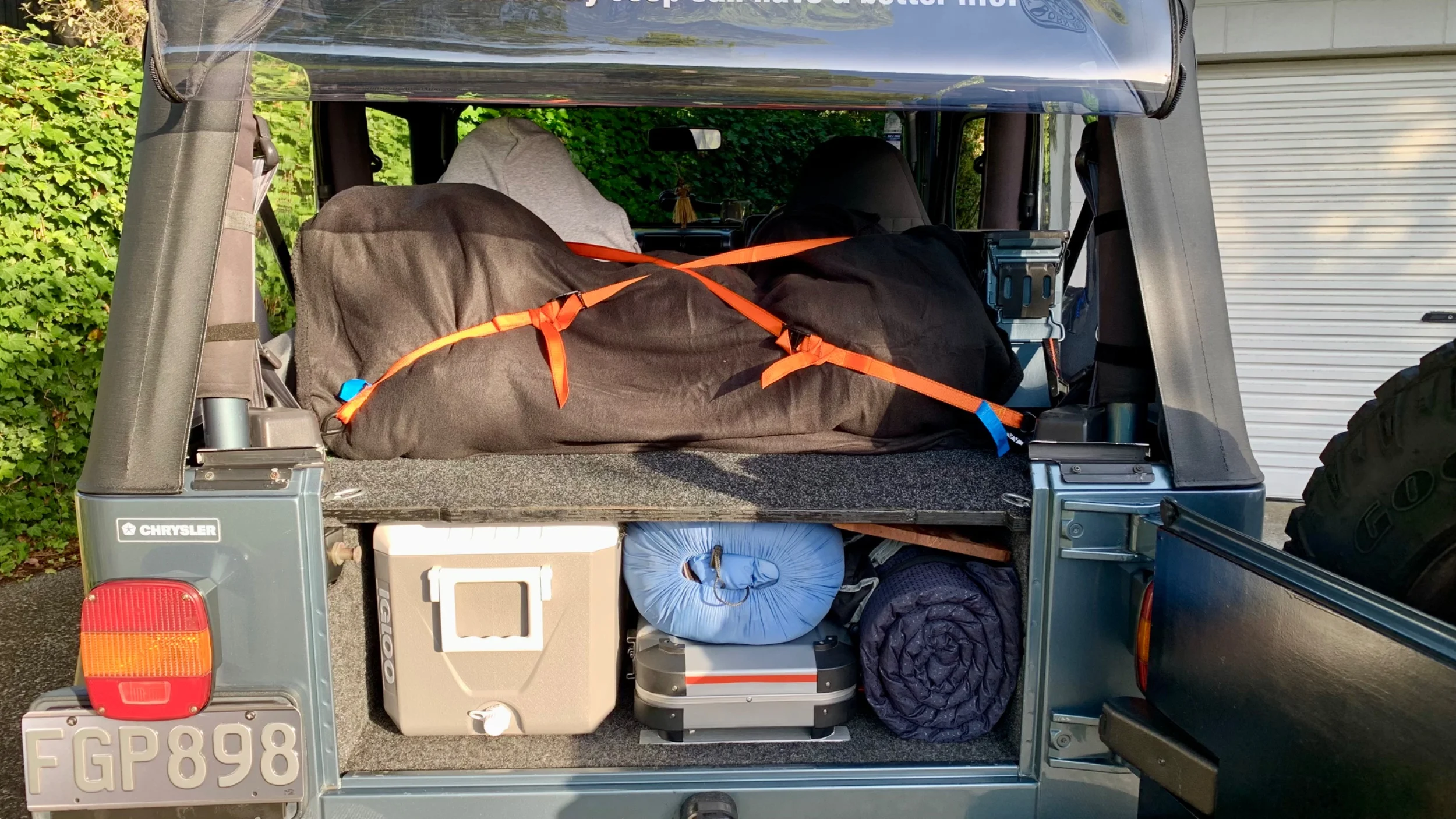

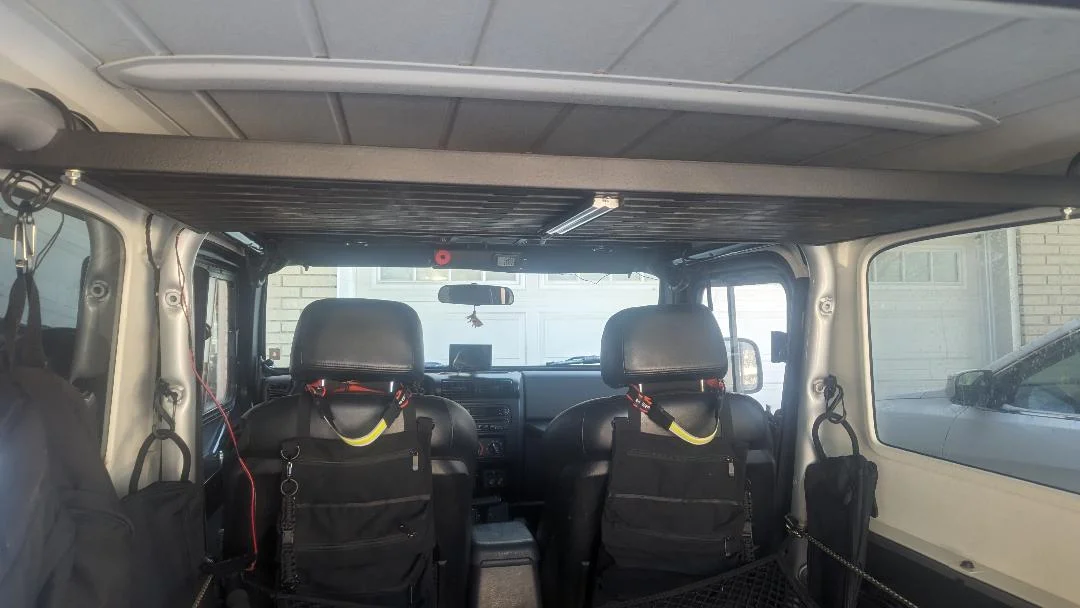

I built an attic for the cargo area of my LJ. It holds my half door soft uppers but I made it mainly to carry camping equipment (without the uppers). So far I've put (all folding) ... 1 camp chair, 1 2' x 4' table, 1 side table, 1 stool for roof access and a blanket/tarp roll in it ... and I still have some room left.
