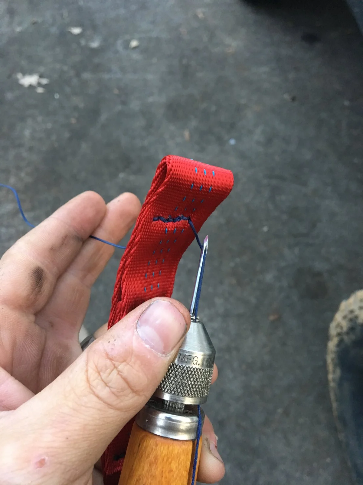

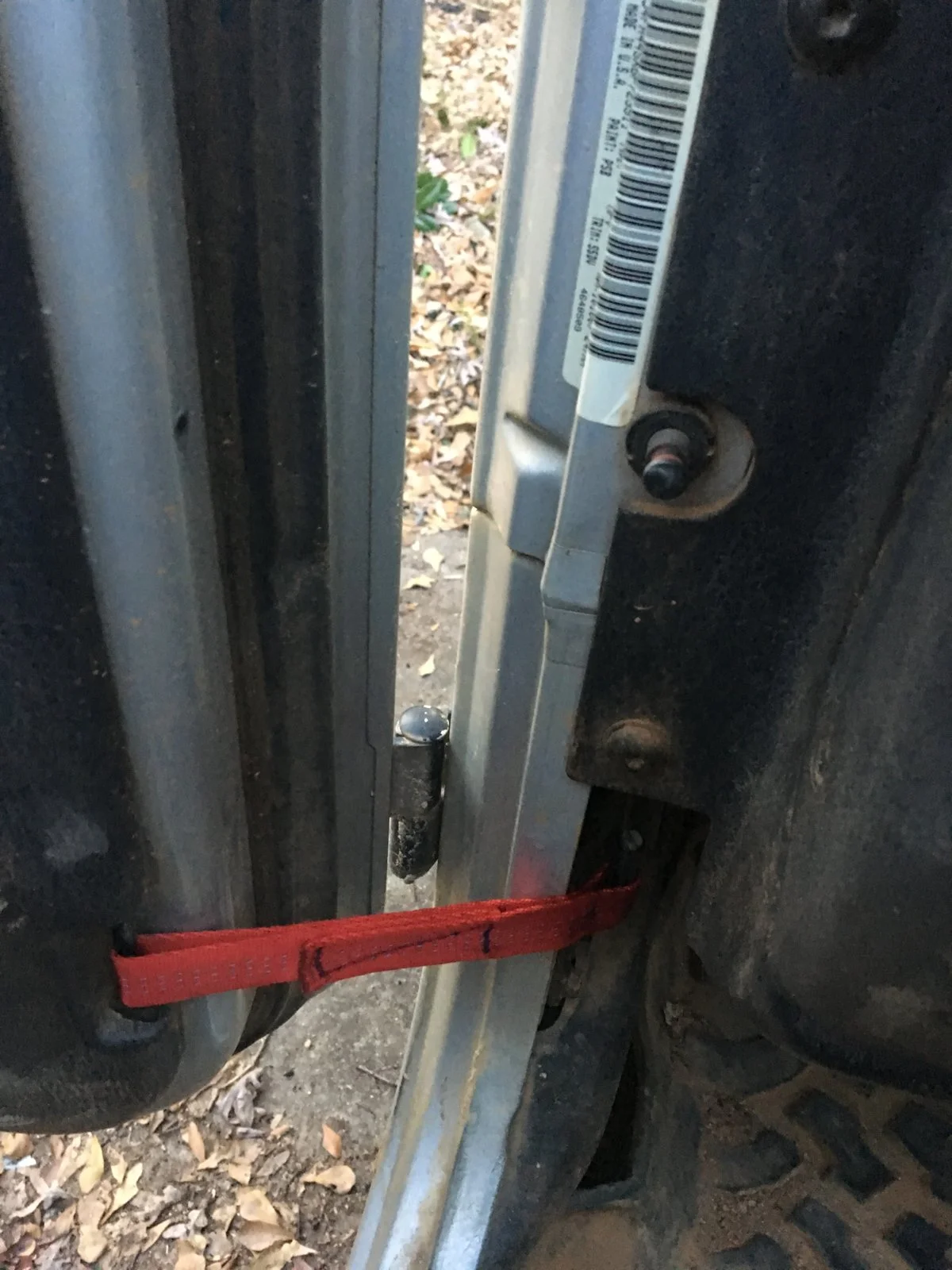

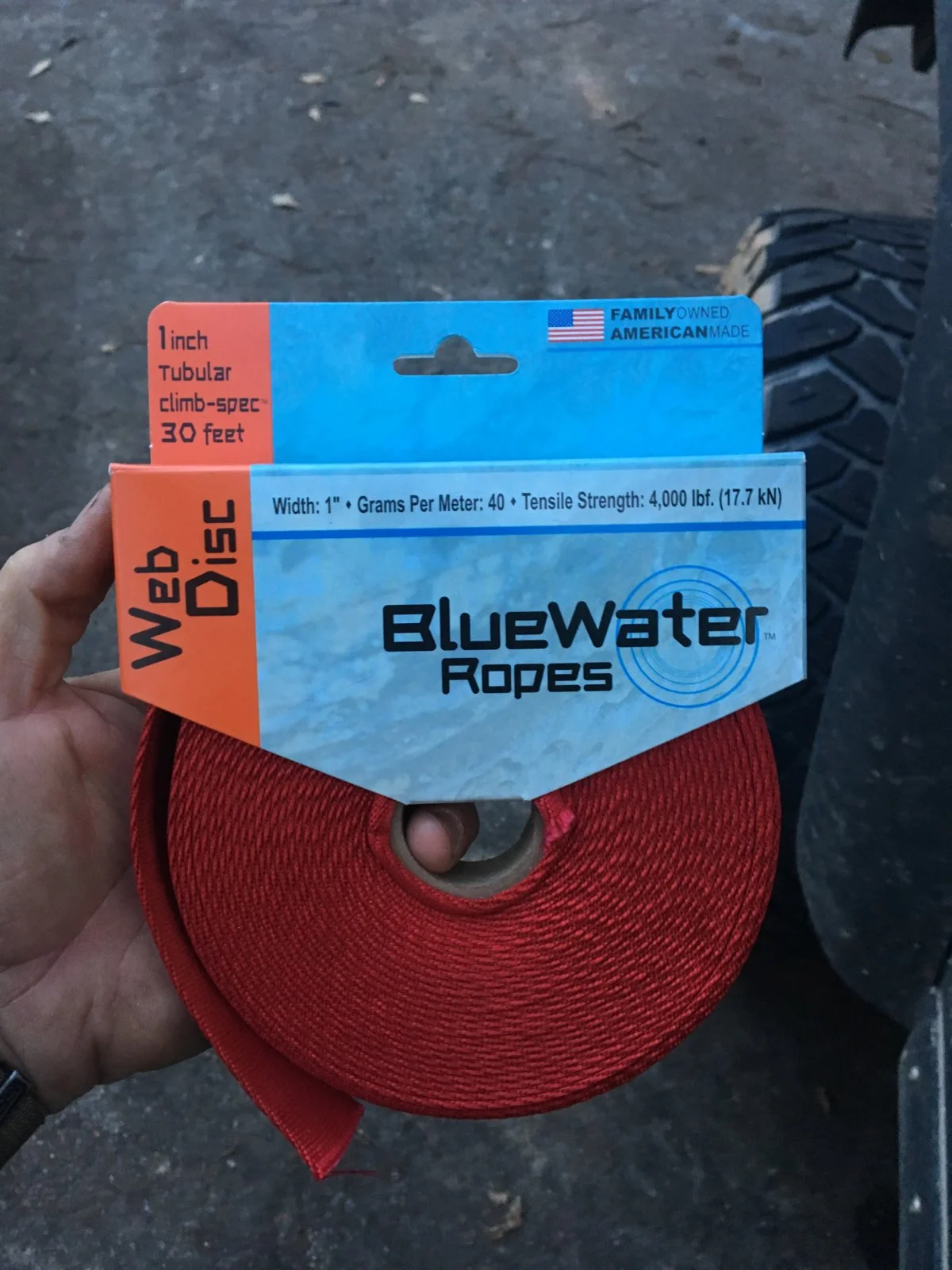

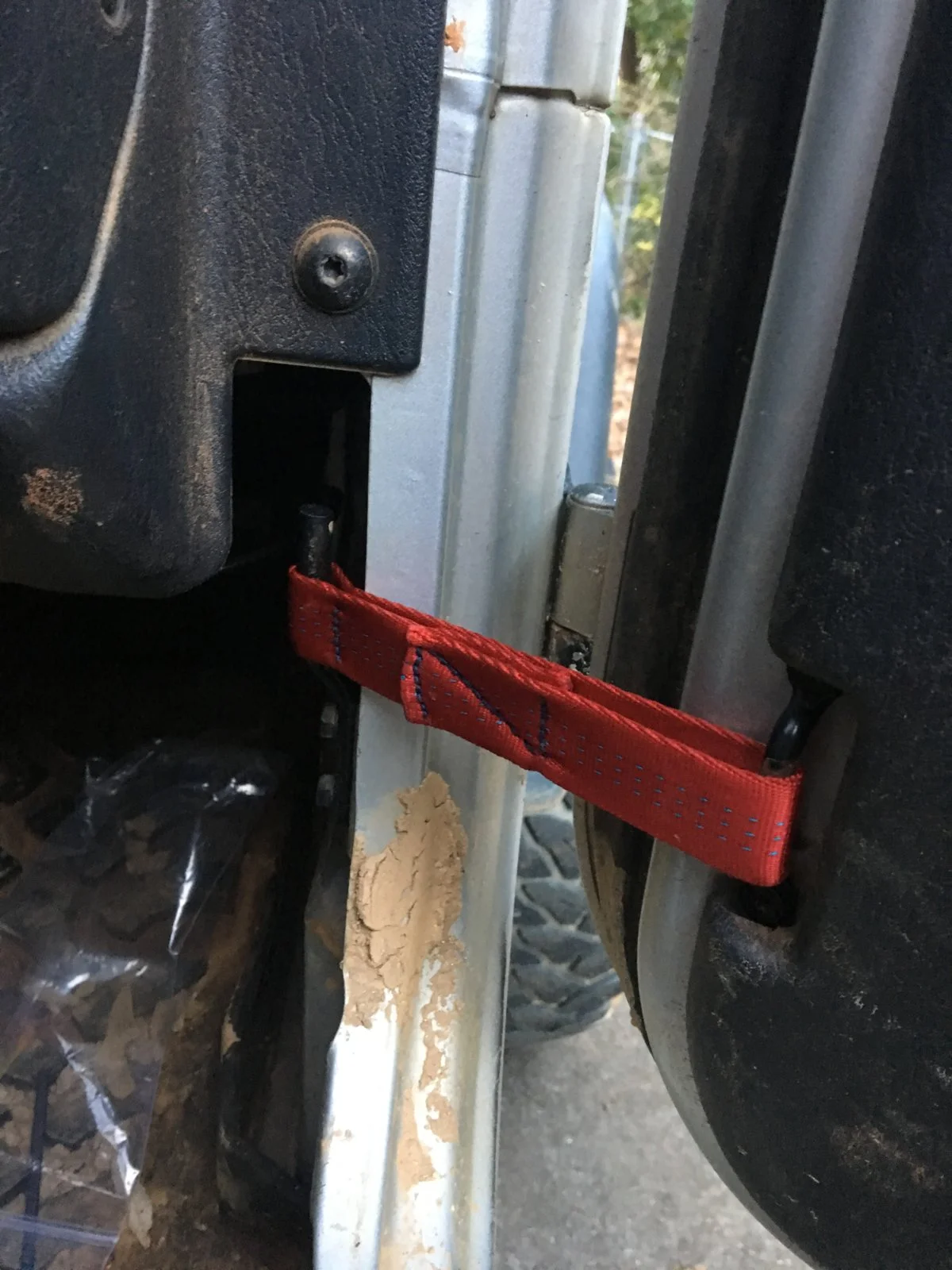

Made some new limiter straps for the doors. One was missing and the other was pretty worn.
I’m not crazy about paracord, so this was more my speed.
Picked up this roll of webbing for ~$15 at REI (went with red because it looks nice with the silver),
cut about 18” or so off the roll, stitched it with heavy nylon thread using a stitching awl, then fuse the ends with a crack torch,
rinse, repeat, and install.

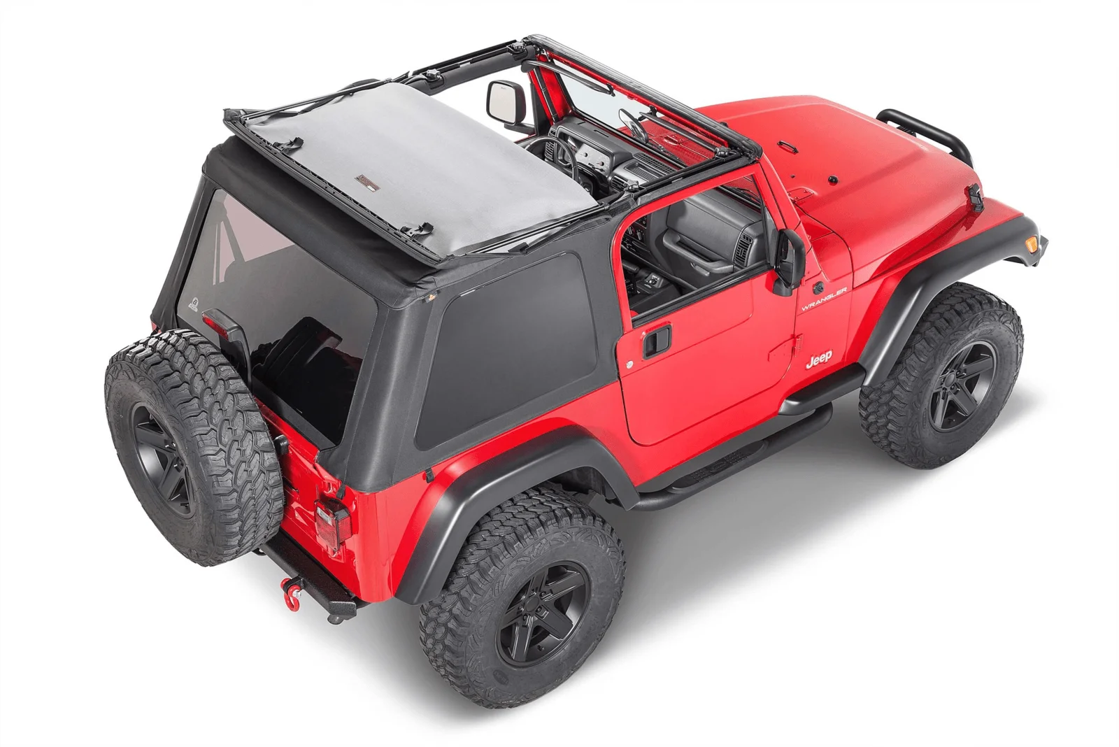

Bought a new top!!! Wife decided it was time to get one. (I asked her to tape the old one back up and she gave in.) might have to try something like that more often. Found the trecktop NX on sale for $580 on quadratech. The sale is only for black diamond in case anyone wants to look. Super stoked.
That’s a pretty good price. I’m thinking of going back to a frameless too when this one wears out (got this one for basically free).
The only thing that bums me out is that these don’t offer the “sun rider” option. I’ve grown to love it.
