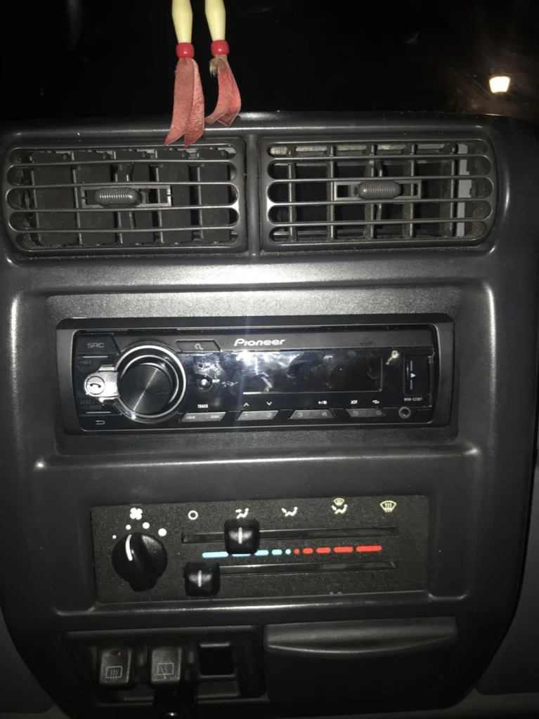

Replaced radio ! Old one just gave out randomly, also yesterday I busted my ass through trying to get a new 02 sensor into my exhaust that was stripped on the inside by the people who installed it last year.

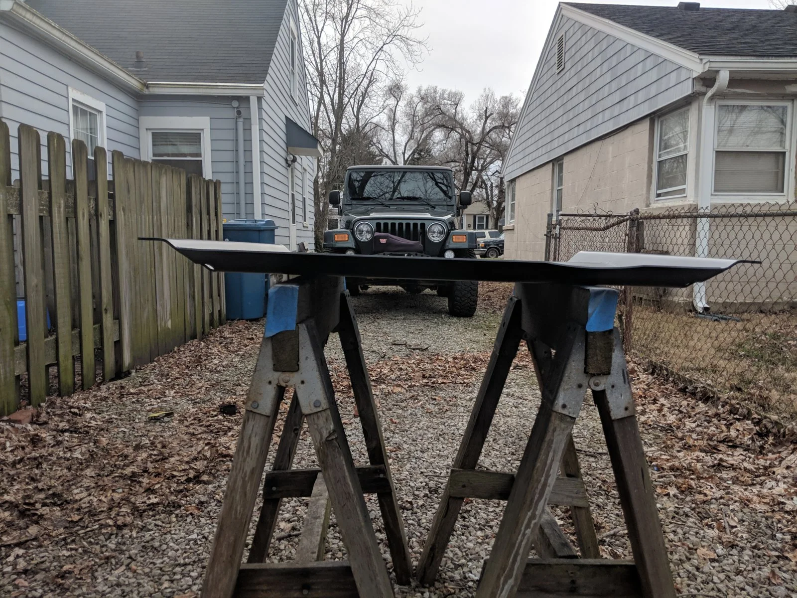

Finally had some spare time today to start my Ammo box center console...Ground off the hinges and carry handles and then had walk away (again) to pick up my daughter....for the last time though as she finally has her license now yaaaay

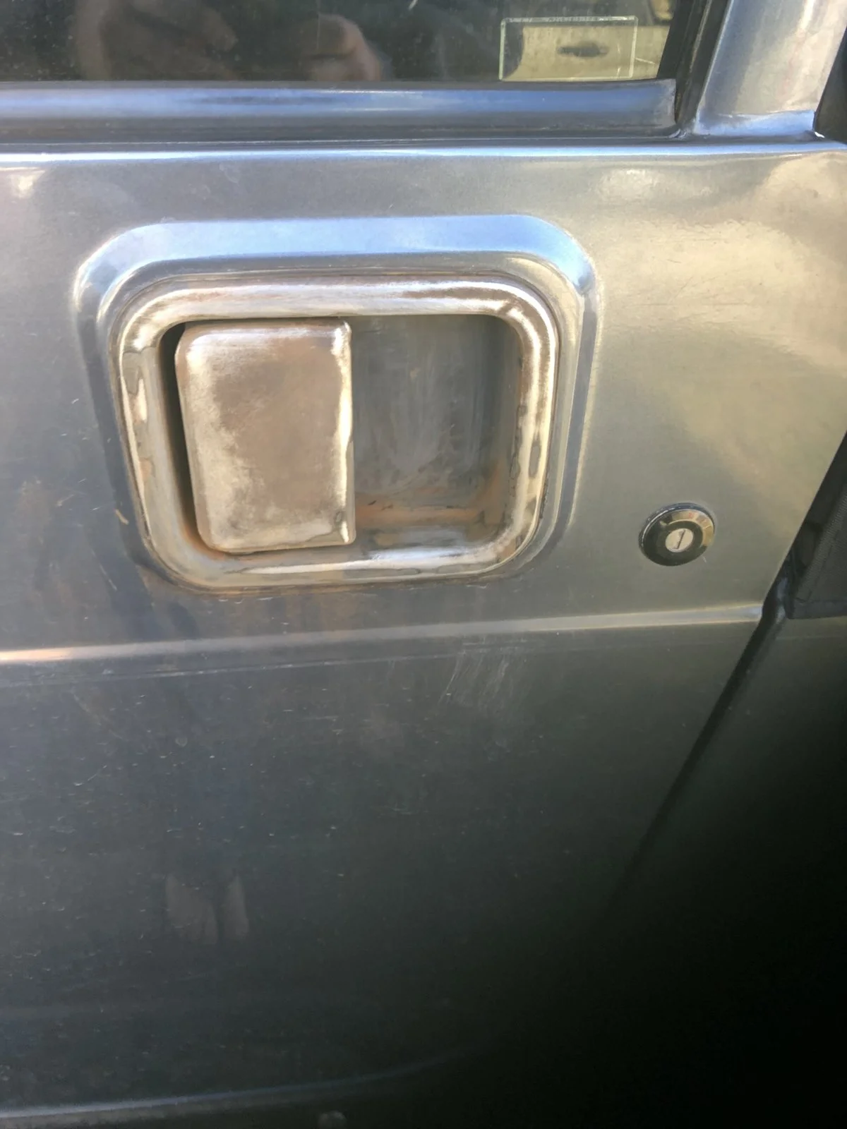

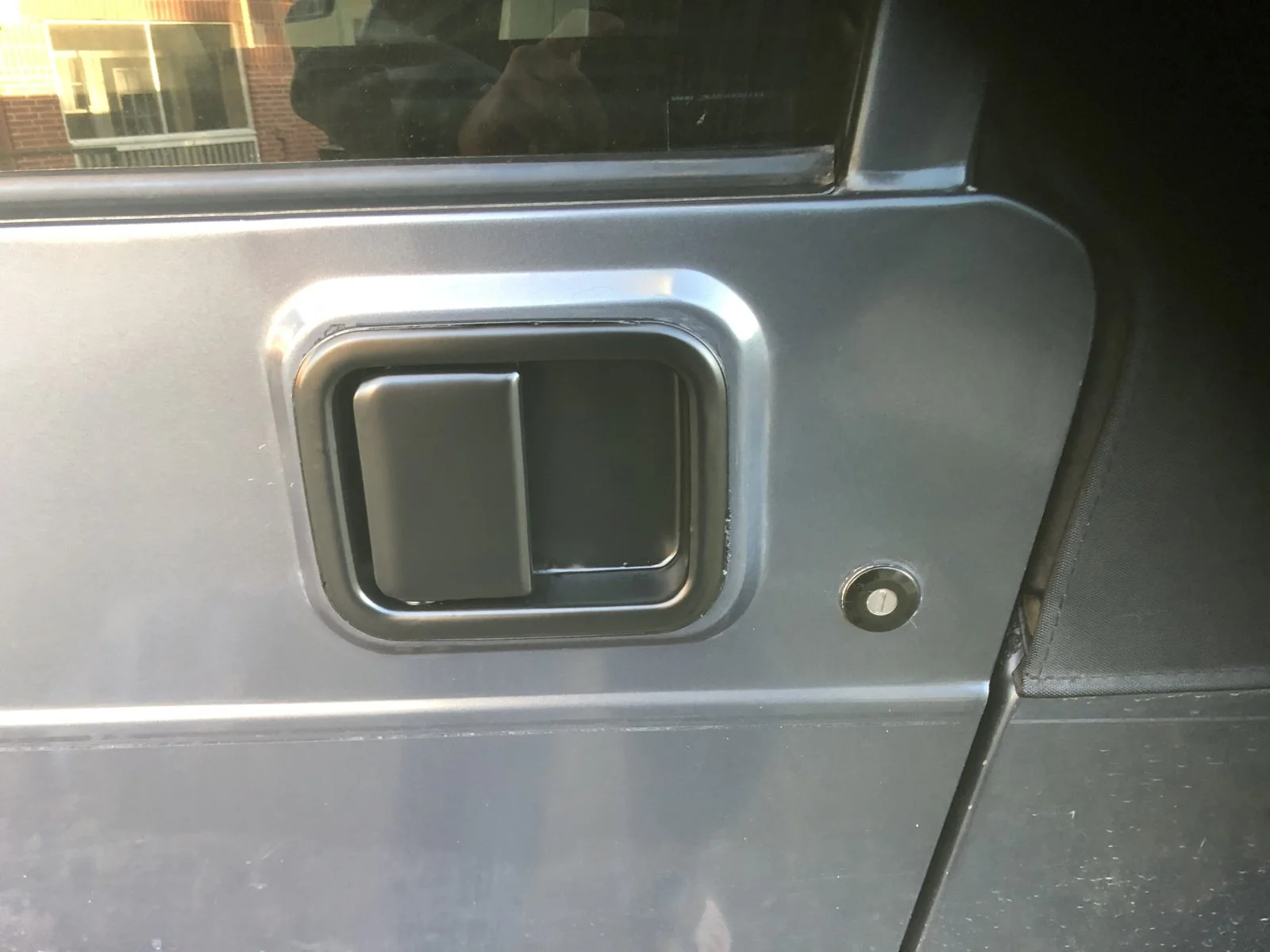

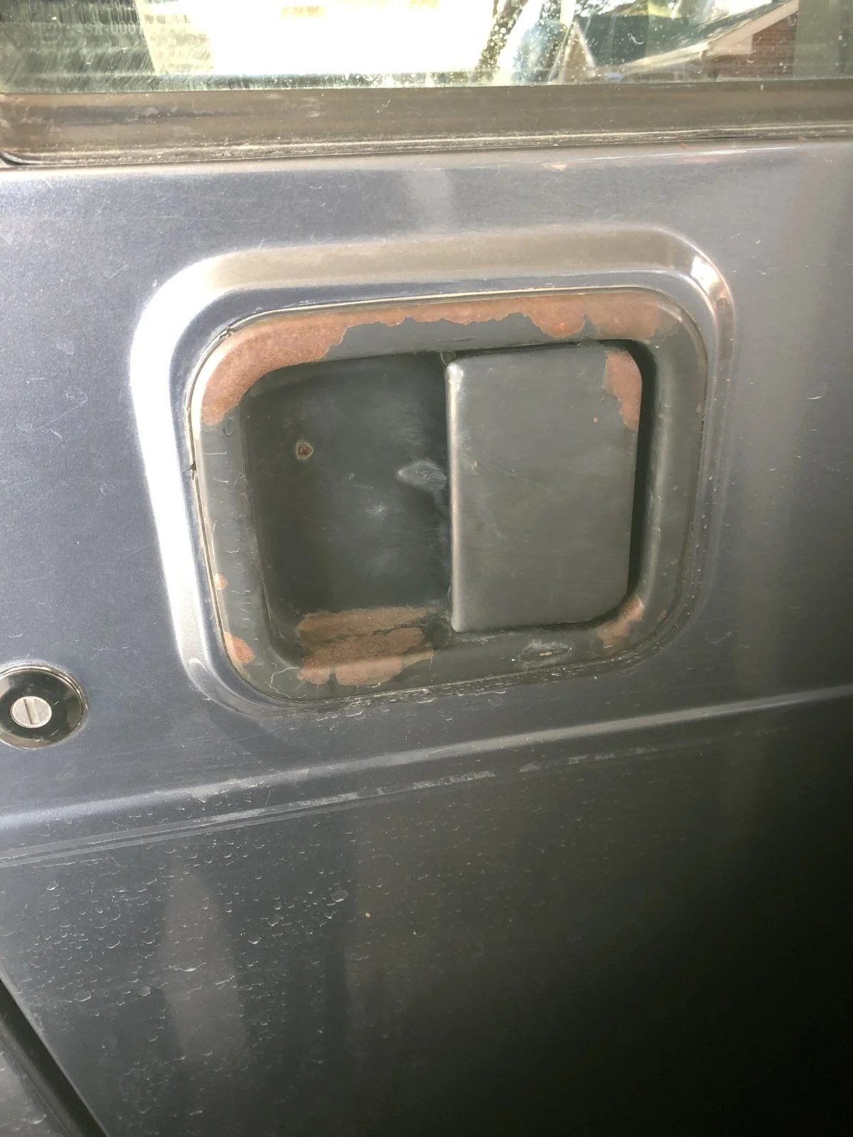

Tough to take em off? I tried re doing mine and I couldn’t seem to get the panel off
I didn’t take them off.
I cleaned the surface area really good, including sanding the handles.
Created a cutout template out of cardboard to mask the door and window for overspray.
Masked the area around the handle with painters tape and put the cutout template over that.
Then painted several light coats.

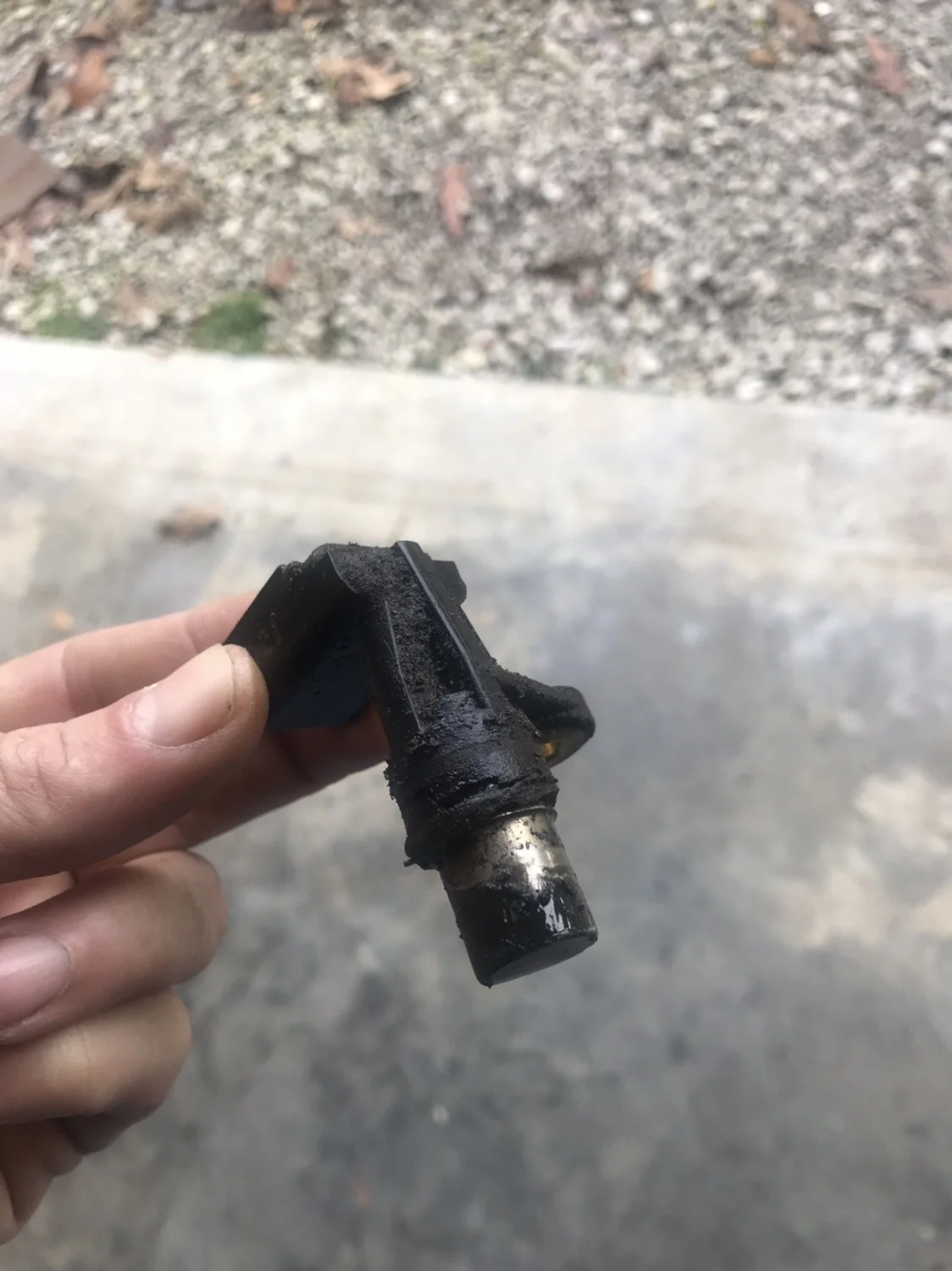

A continuation from this last week. Flashing CEL, long to crank, will not surpass 55mph.
It wound up being the Crankshaft Position Sensor. Interestingly enough there was a really HARD shift/jerk going into overdrive also went away so I no longer have to run around with overdrive off

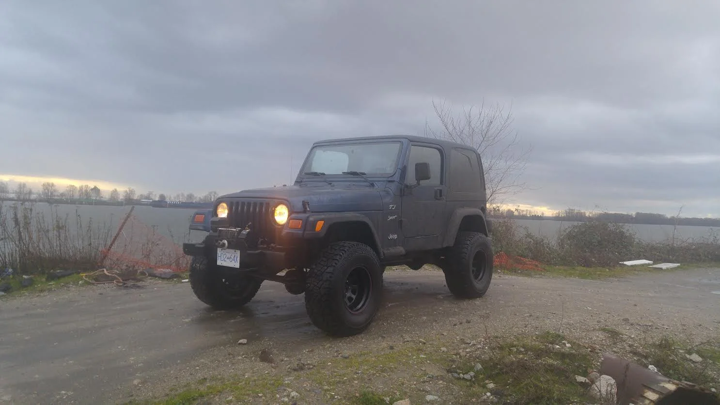

Replaced stock headlights with LED's (BIG improvement).
Replaced stock rear axle shafts with 1541H Rough Country shafts, and replaced 7 year old (sagging) TeraFlex 4.5" front coils with Rubicon Express 4.5" coils - restoring 5" lift-height - thanks to @ JMT and his TJ wizardry:)
