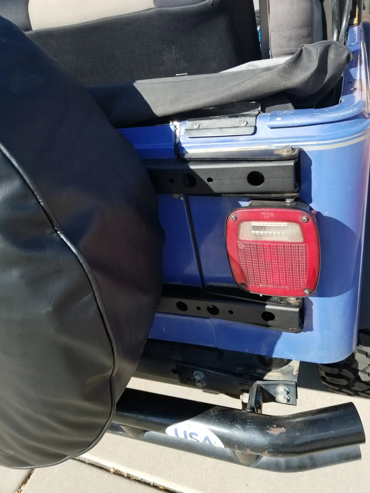

Finshed installation of my new moyride hinges.

I like those...where did you get them from?....an easy intall Im guessing?
They were take offs ans given to me for exchange for some wiring work on a friends jeep.
I ran into issues with a striped threads on the gate hole. I just drilled a access hole in the rear and installed a nut.

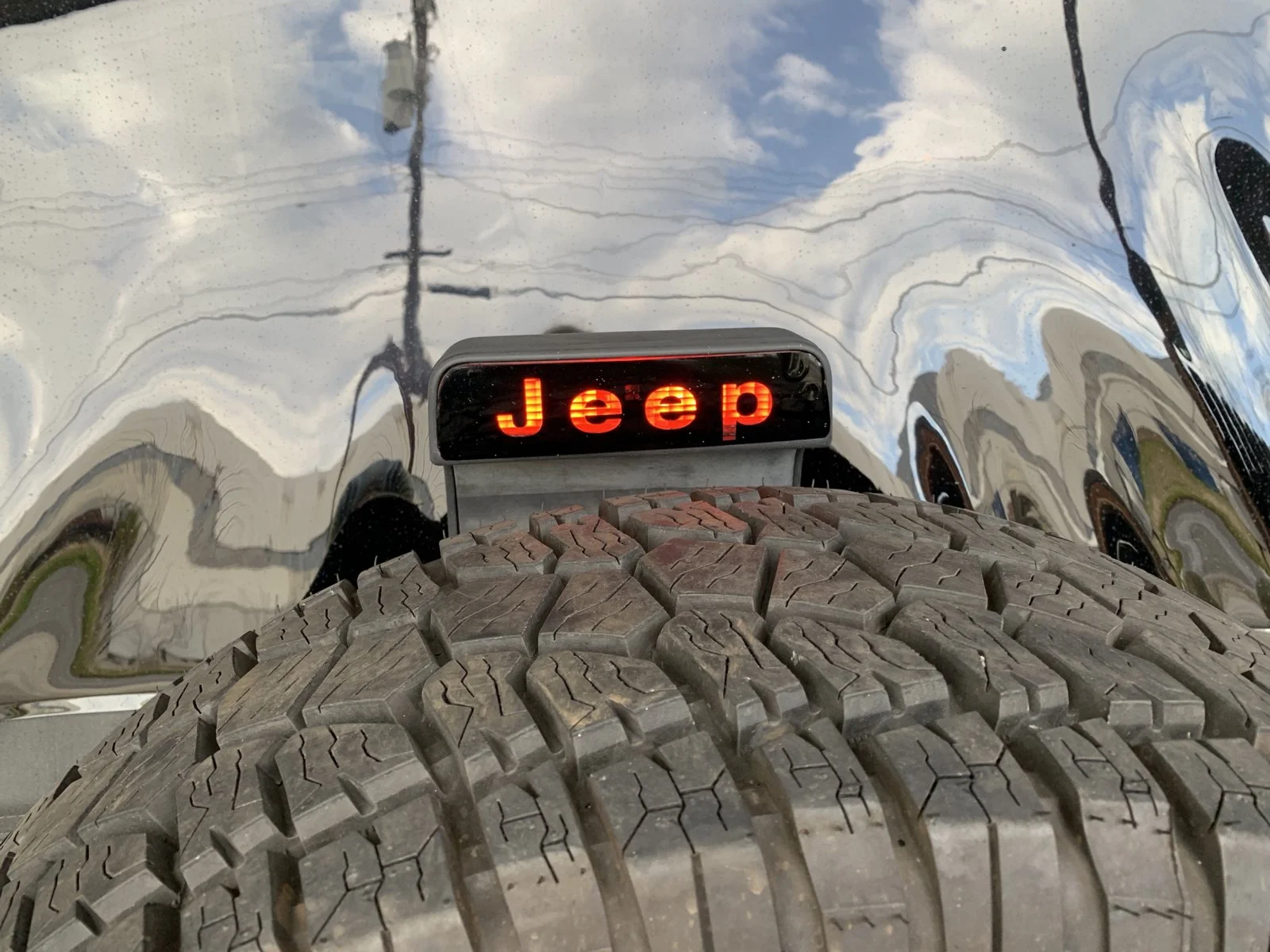

Made me a 3rd brake light sticker. I would show you what it looks like when it is lit up, but this is how I discovered it doesn't work. LOL So depending on the weather, tomorrows "what did I do" post will hopefully be a pic of it lit up. LOL It isn't the best and I need to do a little trimming but I think it will look great once it is lit up. :D

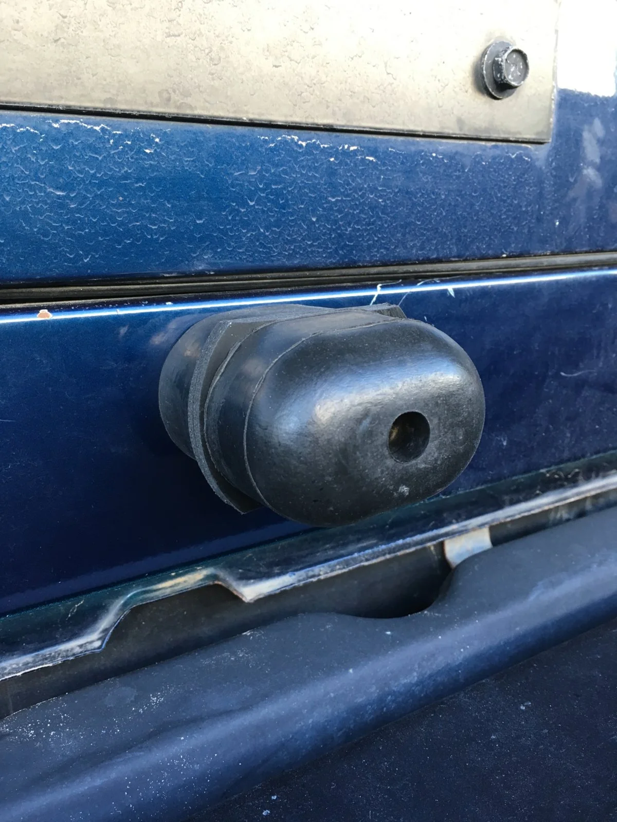

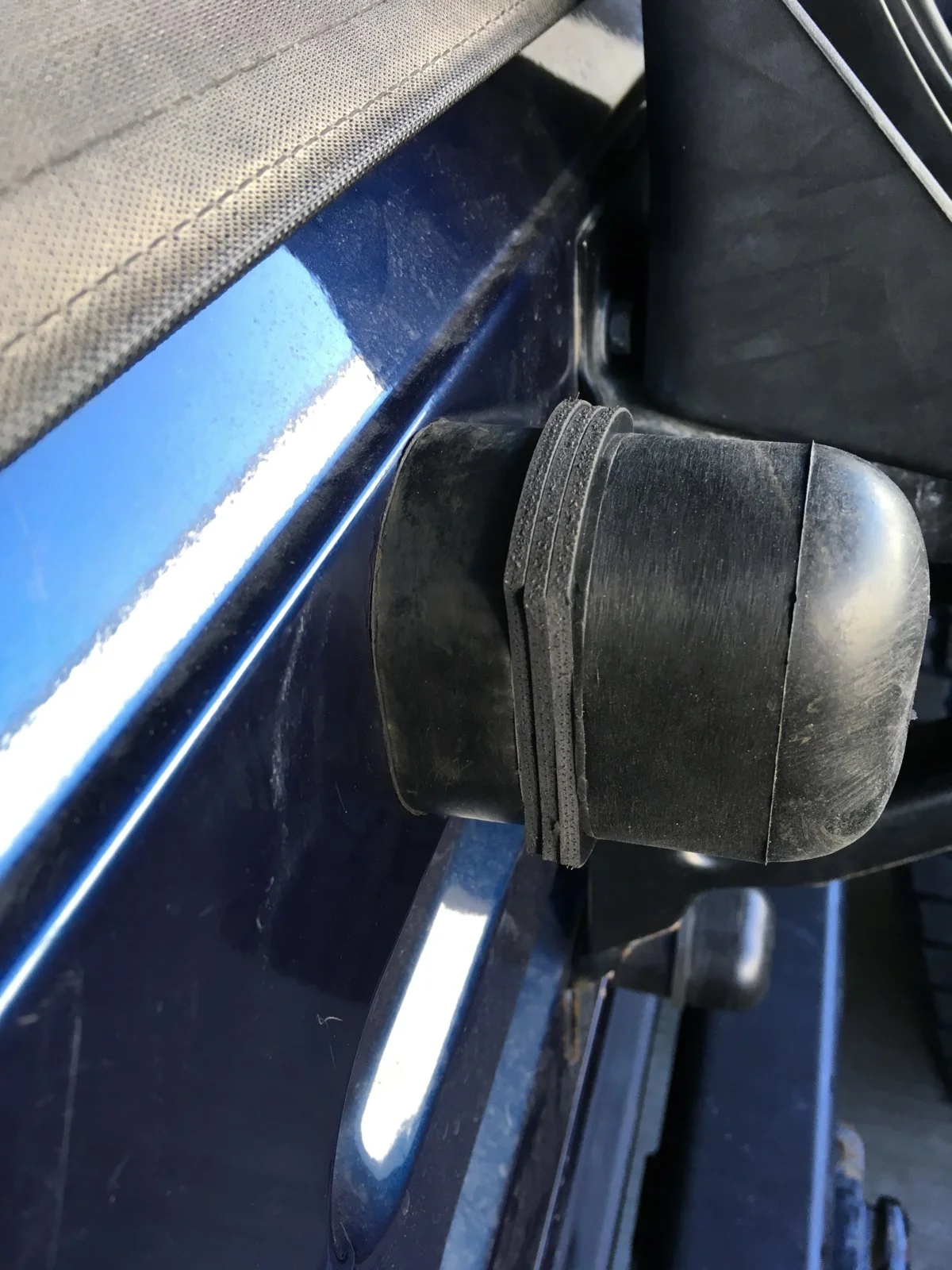

I did it. Figured out what was wrong with the 3rd brake light. Not sure how to fix it permanently, but it works for now. LOL I took a jumper box and clamped screwdrivers to it, then touched the studs on the tailgate. The light lit up, so that told me bulbs were good and wiring to through tailgate was good. Then I rigged the pedal to be depressed so I could go back and use a test light to see if the other studs had power. Yep, all was good there.
I was thinking that because my tailgate doesn't seem to shut correctly, it wasn't getting full contact. So I tried pushing on the tailgate and even though it did go in a little, still no brake light. I tried to twist the studs in the body, in hopes to unthread them a bit, but that didn't seem to do anything. I ended up pull out the ones on the tailgate a little. Now when it is shut, it comes on. Just don't know for how long. Anyone have a fix for this?
Here is the 3rd brake light lit up. I think I will order some Matte vinyl and remake it though, I'm not thrilled with the gloss look.

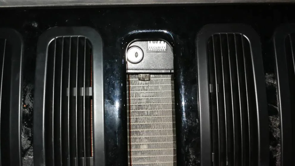

I spent the whole day installing the famous tuffy Hood Lock ... Honestly, this product is a waste of money ... It's as if I threw my money out the window. Already it takes several attempts to adjust the product so that the hood can close properly ... And still it s not yet well adjusted. But what disappointed me the most is when it's unlocked, I'm still forced to push my fingers to pull the hood trigger!?!
It is inadmissible anyway ... They could still make a Hood Lock that can open the hood without having to push his fingers. Otherwise what's the utility ?
For those who have already installed this product, I am curious to hear your opinion and if you have the same worries as me ...

still hope that it is me who installed it badly and that it really serves to open the hood without having to push his fingers in the vents of the motor...
