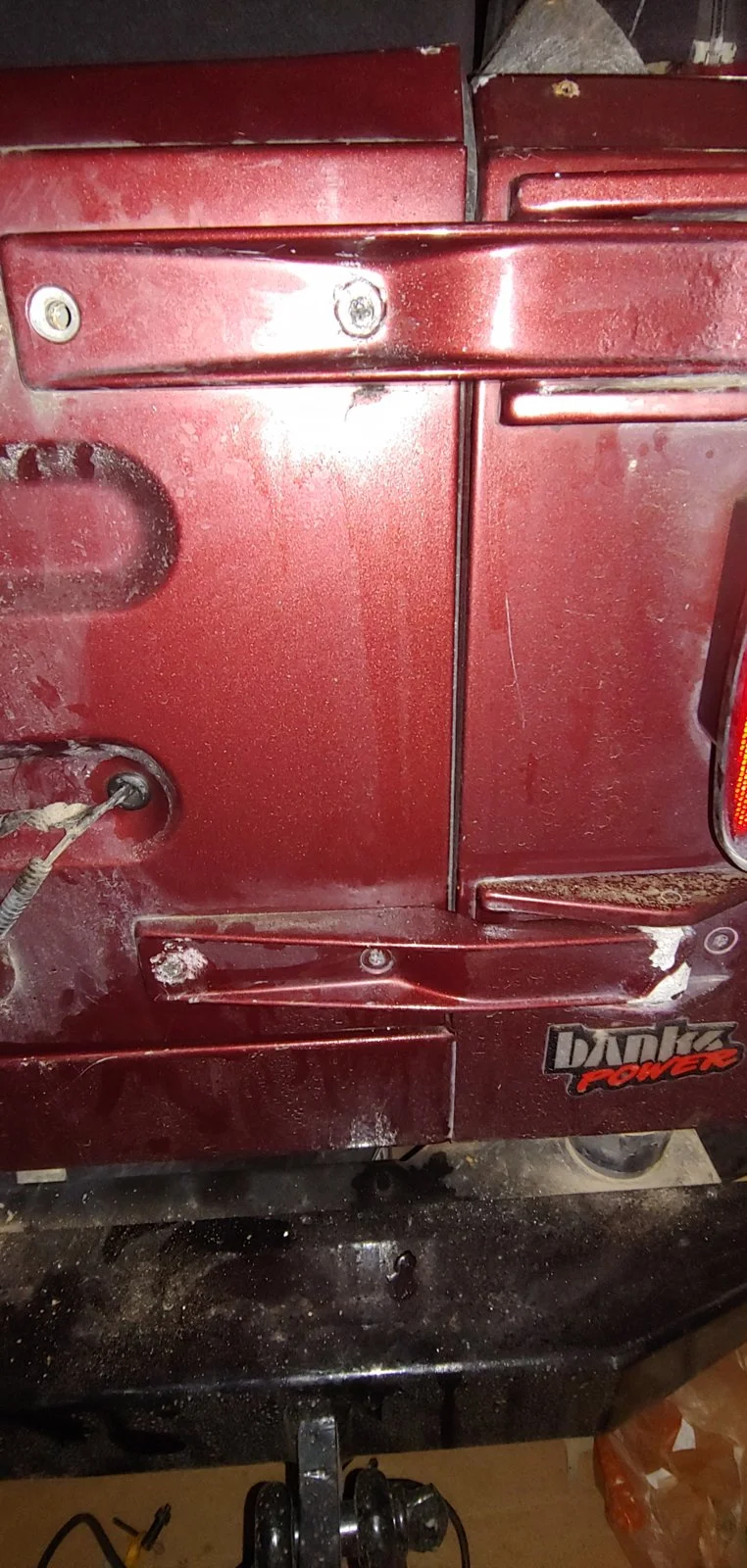

Started on the Morryde tailgate. I PB plaster, heated and still have three that won't come out. Biggest problem is cheap Chinese tools. I have two Crapsman torx break off in the torx head of the bolt. Then went to Home Depot (all the local Sears have shut down) And broke 4 Husky torx. I now have to grind out the hardened torx heads before I can drill them out. Just once on a TJ project I would love to not have to drill or tap.

I just went through this install myself. The first 2 screws came out with no problem but the next 2 broke. I had to drill them out to find that one of them was completely seized to the hole. I ending up giving up and taking it to a shop to finish.
I also had to shim the 3rd brake light pod to clear the opening and connect when shut as well. The tailgate is not exactly in the same place so there might be a little more adjustments to get it perfect.

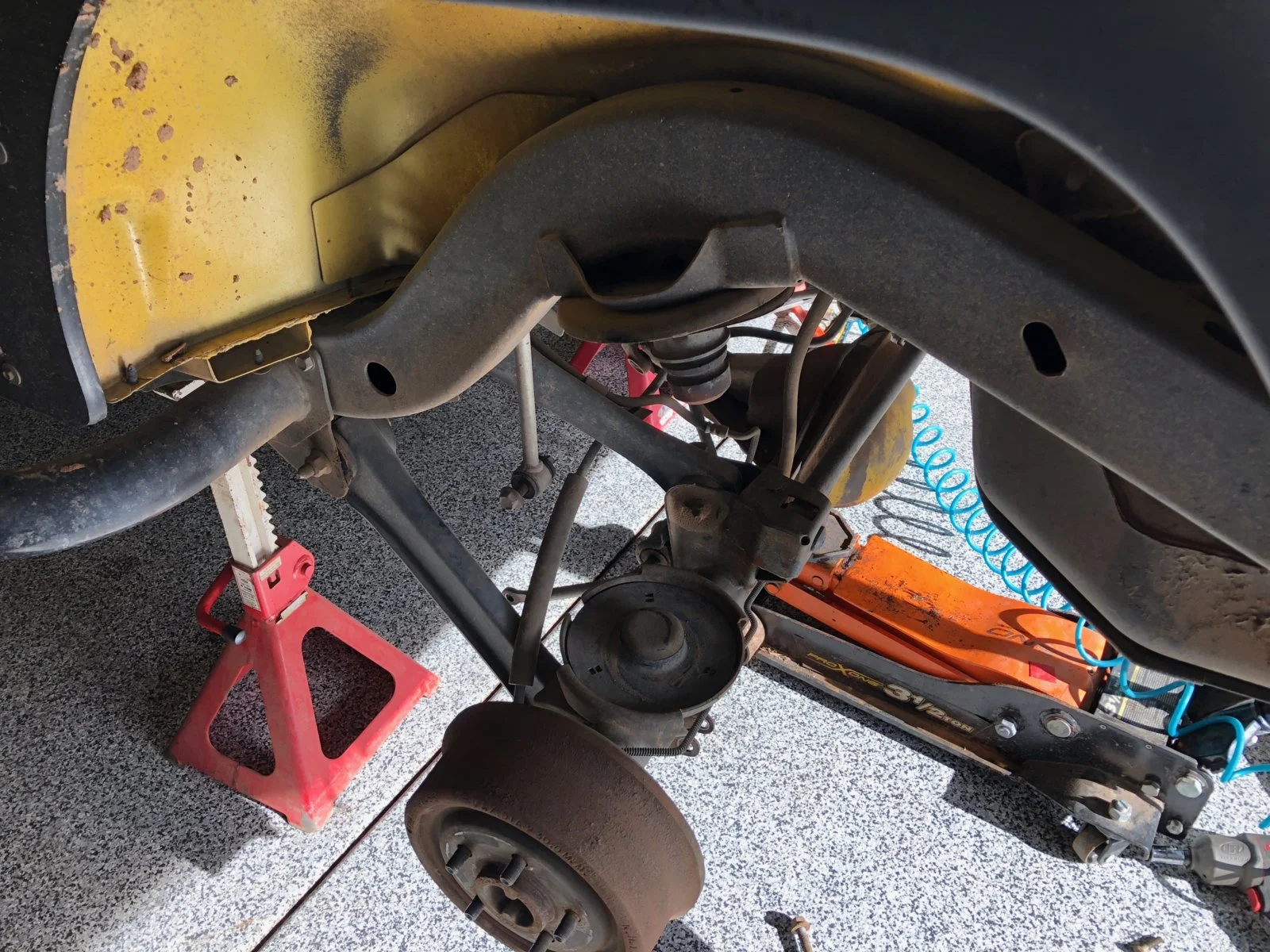

Starting the OME 2 inch lift on Wifees Jeep! I think it had factory JK springs in it. It had almost 3 inches of lift with no rear track bar bracket, and still has stock control arms. It has one hell of a lowering kit on the transmission.
The PO ran a shouldered bolt for the tops of the rear shocks so I got to retap them as I was pulling the bolts out so that was fun. Off to the hardware store tonight. I installed an OME trackbar bracket, and I am waiting for some bumpstop extensions to show up. Had almost 3 inches of lift and no bumpstops. The rear shocks were mangled. She is going to really love the new OME shocks and springs. Luckily with all of the dumb stuff I found the jeep is still relatively clean. It makes it that much easier to work on. Tonight the rear shocks go on and cycle the suspension, while I wait for the bumpstops to show up.
