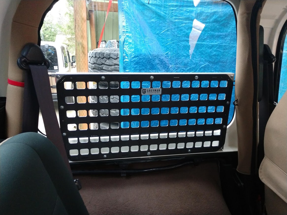

Test fitting a storage option for the back of the jeep. I need to change the mounting to rivnuts, and i need to braise it to make it more solid.

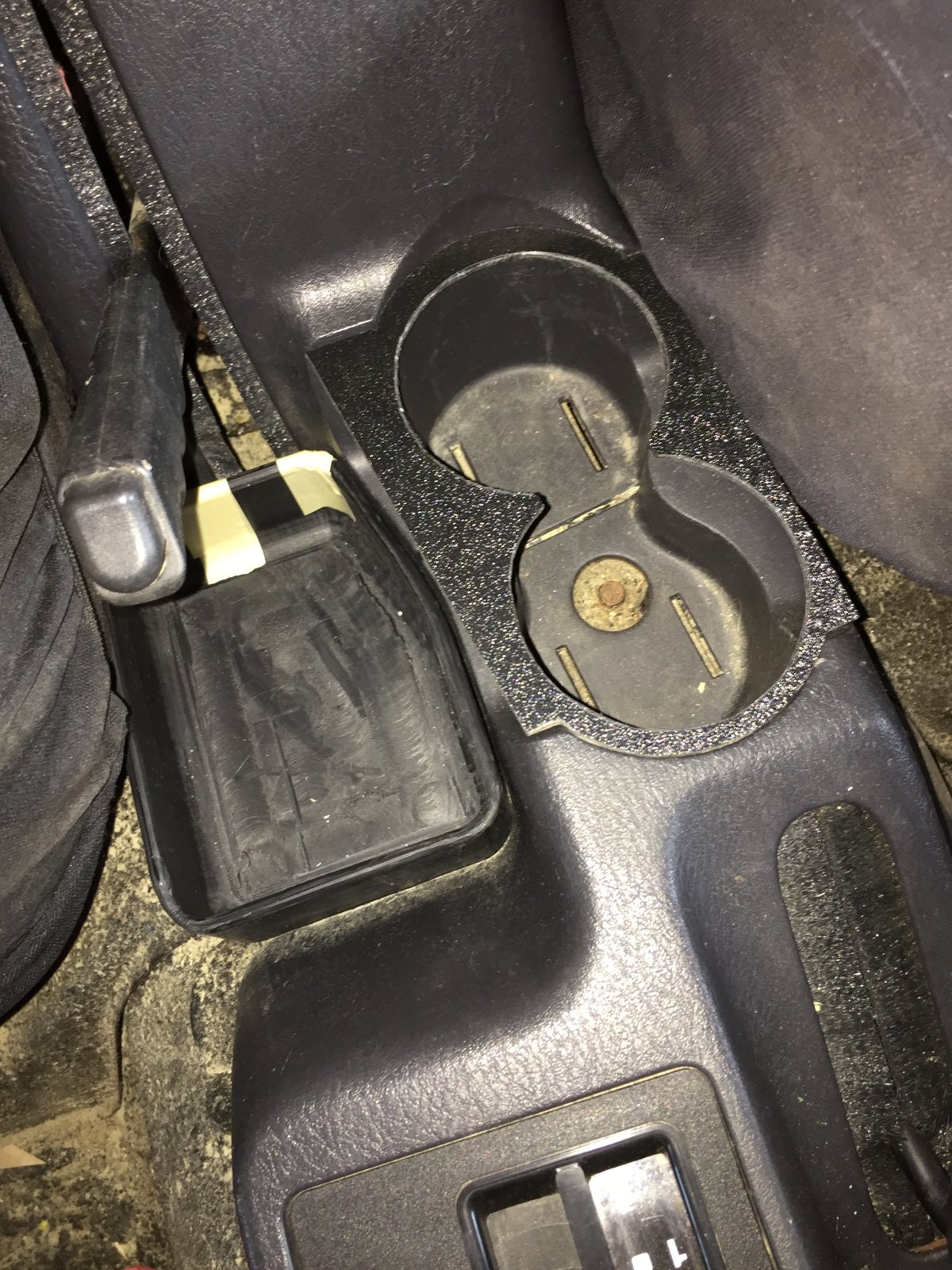

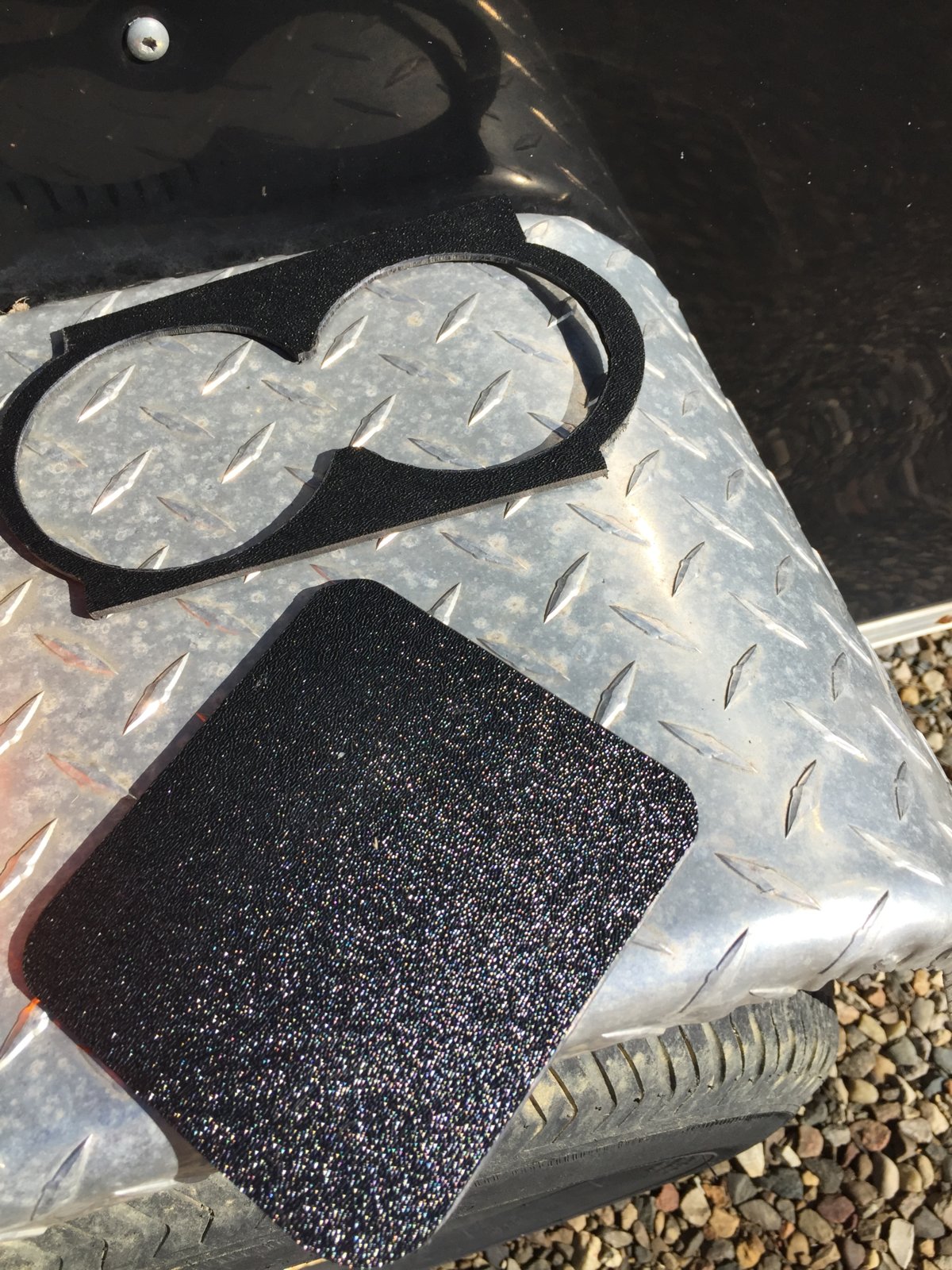

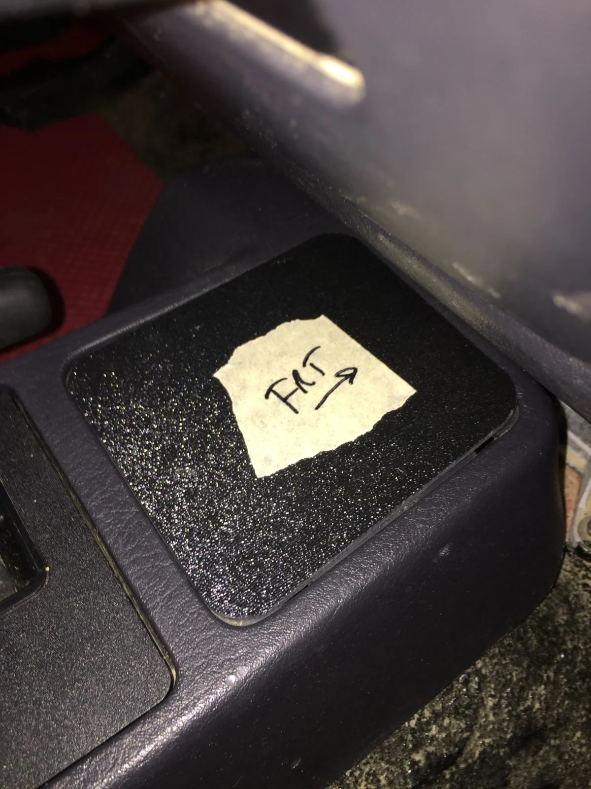

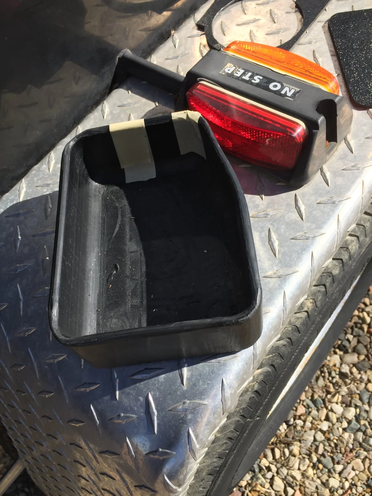

I made these
8393483935
To put here
83941
83940
The cup holder is a prototype, I’m going to make another out of aluminum. The panel in front of the shifter is just to fill the hole for now till I think of a way to use the space

I like the tray for under the E brake. That is a great idea.
I am guessing because you made the cupholder thing, you don't have the rubber insert that goes in it either? I looked on eBay and they want 30 bucks and up for those inserts. Crazy. Anybody know what other Jeeps had the same inserts if any?? If another style Jeep has the same thing, I can probably find one out in Pic N Pull.

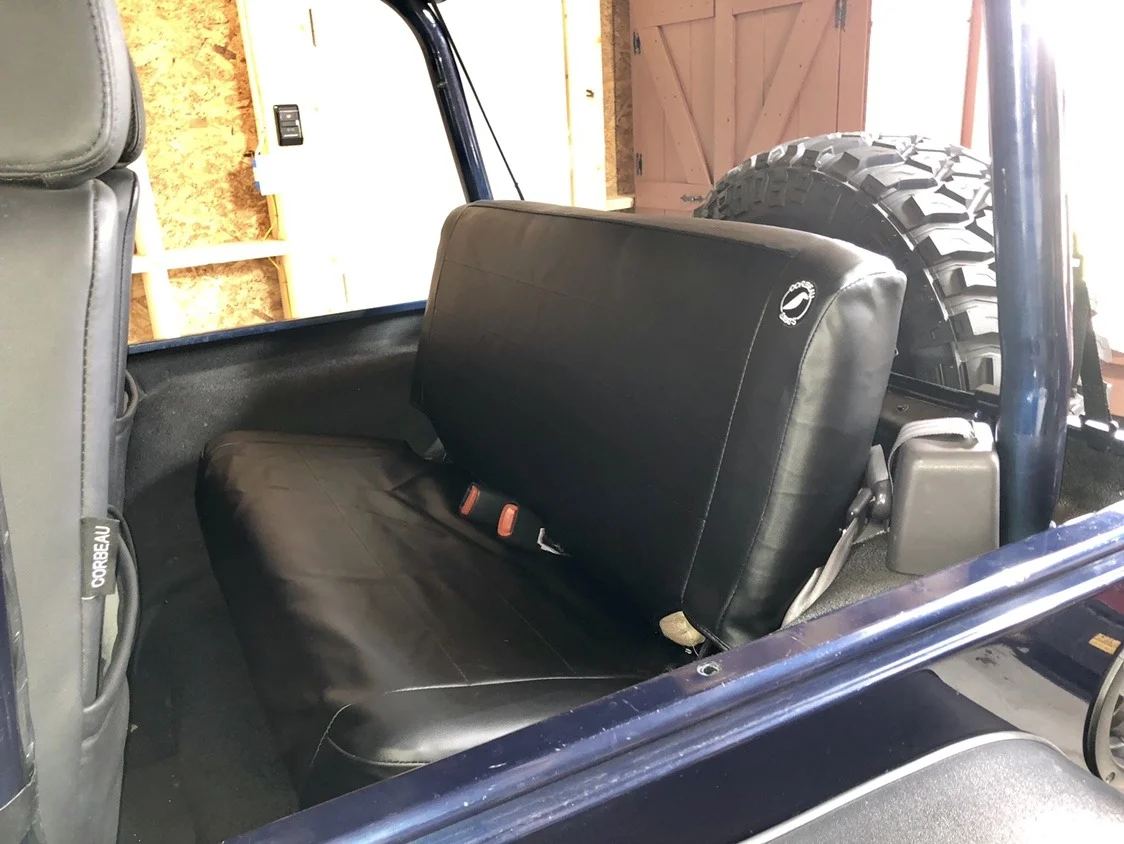

Changed the rear seat from tan to black with a seat cover from Corbeau (to match the front black sport seats) and reinstalled all the hardware and seat belts.
I had taken everything out when I did the Bed Tred install and liked it without a rear seat as a daily driver. Now that it’s not a daily, wanted the seat back for additional passengers.

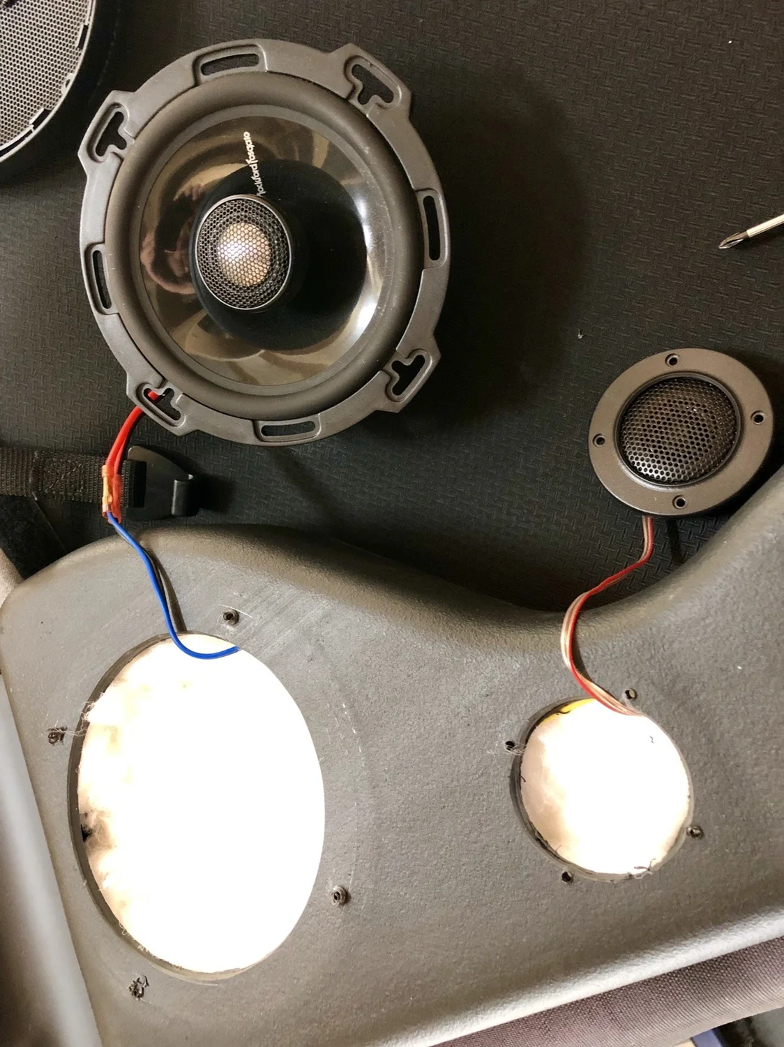

Also added Poly Fil to the sound bar. I bought a VDP sound bar awhile back without doing any research to learn that they are junk. I’ve replaced all of the speakers and determined that it’s a 194 LED bulb that’s needed to replace the barely illuminated bulbs it came with. The Poly Fil made a big difference in sound. Also added Boom Mat to both front 4x6’s (no picture).
Boom mat:
Design Engineering 050350 Boom Mat Speaker Baffles, 4" x 6" Oval (Pack of 2) https://www.amazon.com/dp/B0039Z3SUM/?tag=wranglerorg-20
Poly Fil (1lb bag is enough for 1 Sound Bar):
Acousta-Stuf Polyfill Speaker Cabinet Sound Damping Material 1 lb. Bag https://www.amazon.com/dp/B0002ZPLDY/?tag=wranglerorg-20

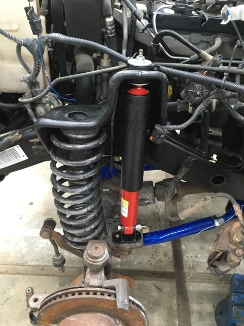

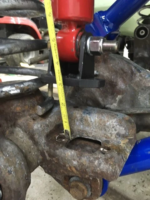

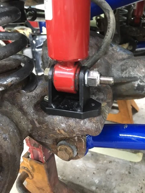

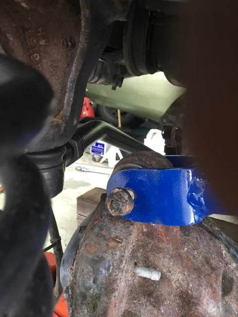

WELL I drove down to the shop where I bought the nut, we found out that the Jeep tie rod is 22x1.5mm, so I jacked up the tie rod end and the $8 nut. Just pisses me off. So I am not going to use the fox shock yet until I get my dana 44's built, so I rednecked a pin bar eliminator that gives me 5" up and 4" down using JK shocks. I also found that the previous owner had put a track bar relocation bracket on subsequently I removed it once I found it. Now the track bar fits but bottoms out...so I may have t redrill the hole and go back to a stock track bar. The stock track bar seems to be bent better.
I also had the lower pads left over from a JL take offs that I picked up, I tried them, they tipped the springs into the bump stop cups, so those are coming off. My YJ was sooo much easier to set up. Just when I think that I am making progress, I fall back with parts that either dont fit or are just not right. Well I will be doing more next week.
