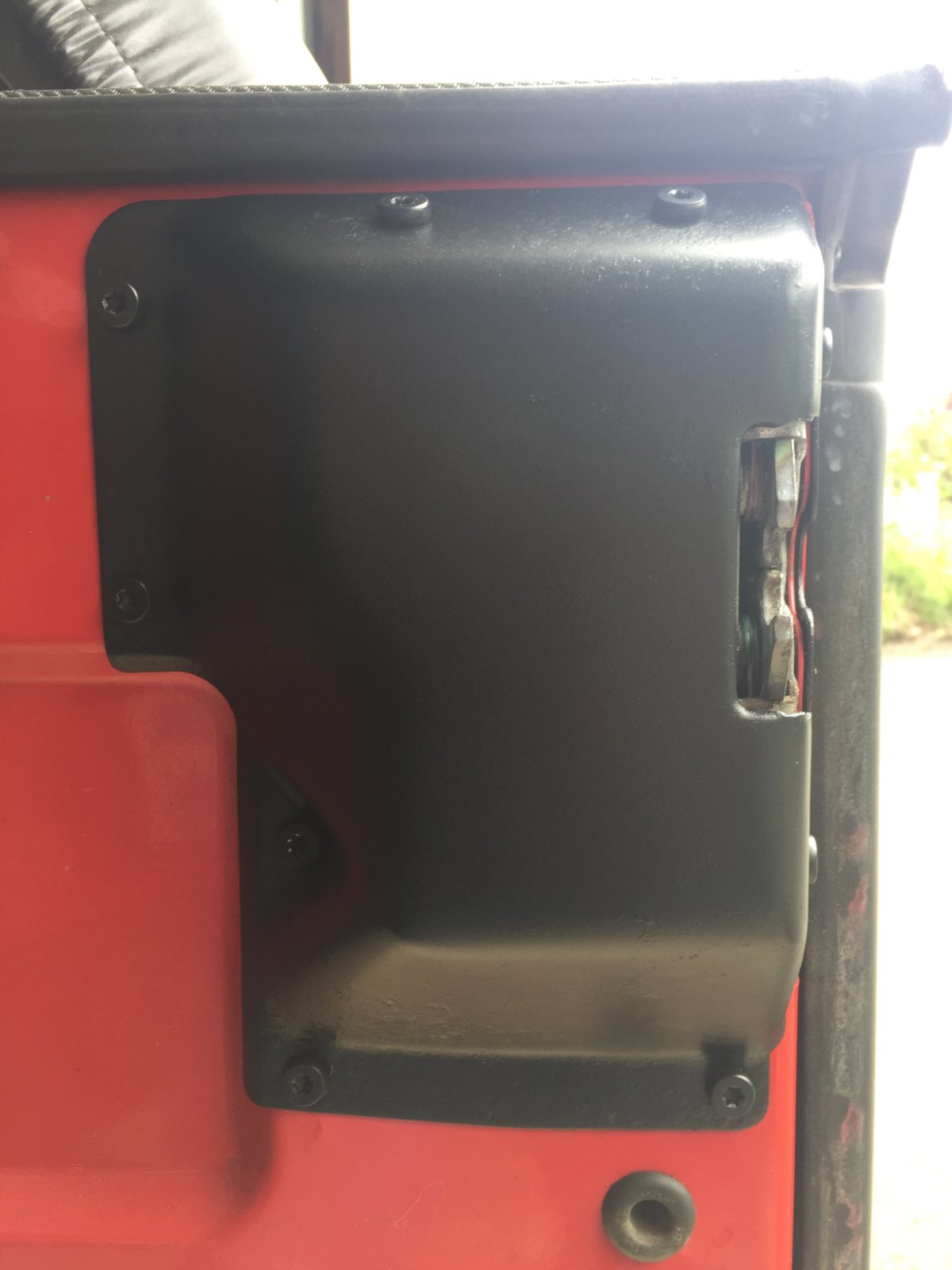

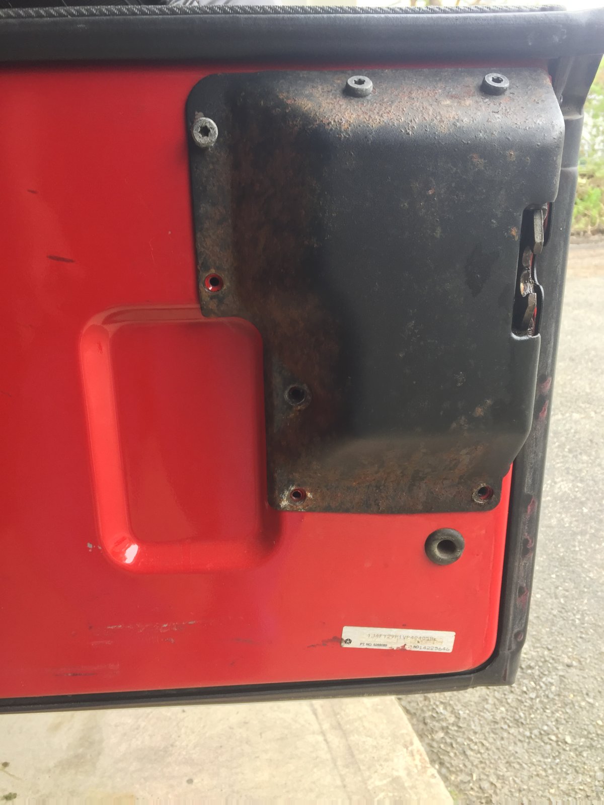

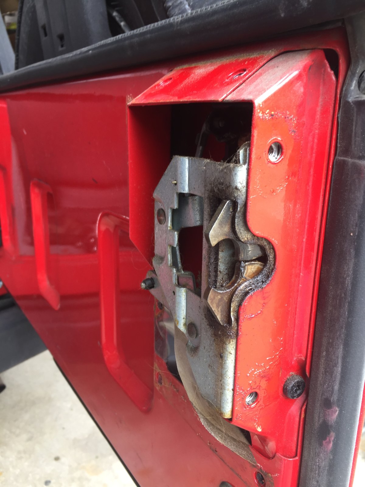

Well my friends, I finally took care of a small project that I've been thinking about. I removed, cleaned, sanded and painted the tailgate door lock cover. I also cleaned the locking mechanism and used some white lithium grease on it.

What a difference......good job!

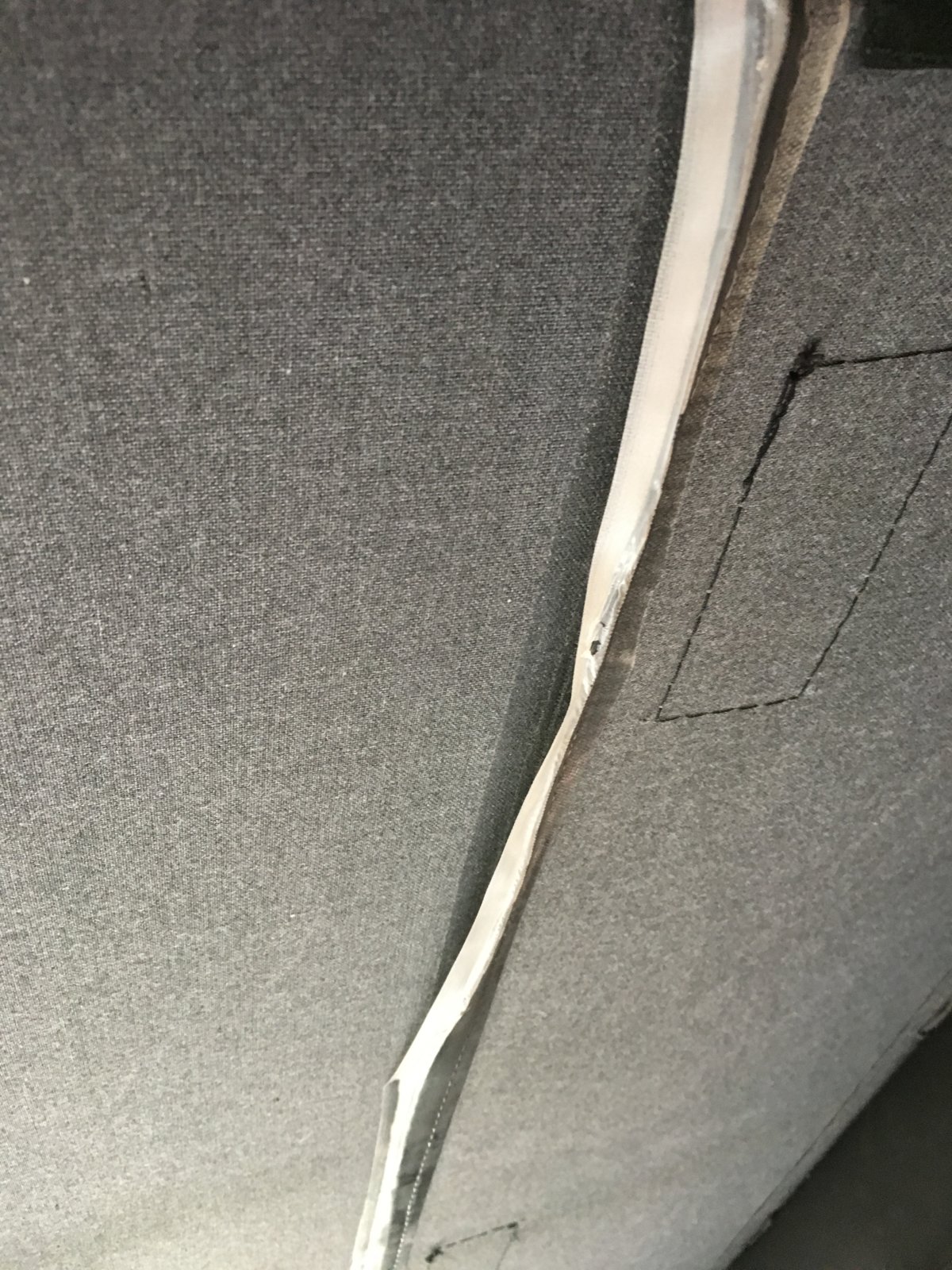

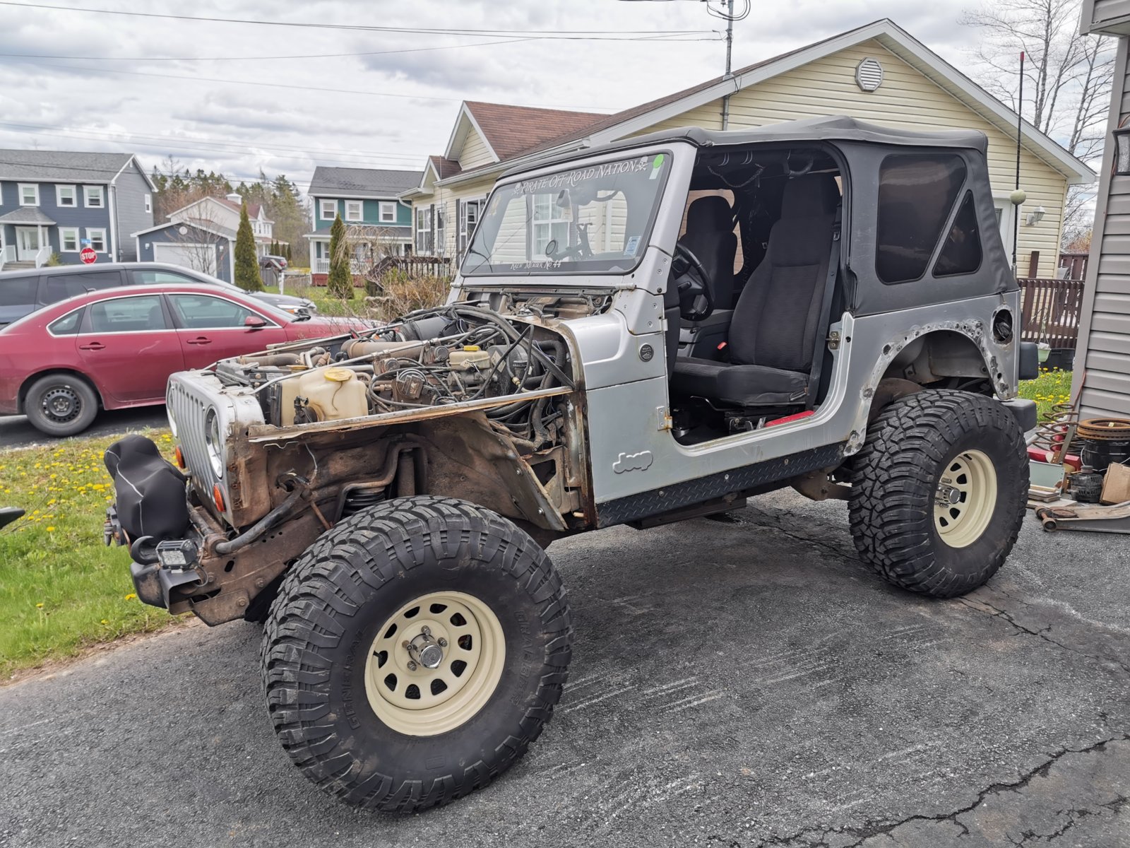

Threw on a new Rampage sailcloth trail top with tinted windows for laughs and giggles. Still waiting on a tailgate bar to be delivered to button it completely up. It’s 92 degrees outside so it stretched out with ease during installation with me sweating all over it. I’ll let it air out for a few days, then wipe it down with some 303 to help it last. The top was missing the two rods that keep water from pooling over the front seats, and the two pieces of foam that go over the door surrounds. I hope to be able to get those from Rampage, so I can run it as it was designed to be, although it may not be a big deal. Quality is already showing as well. It has a seam seal pulling away right over the drivers seat, and after a small test it leaks badly. Dammit Jimbob!

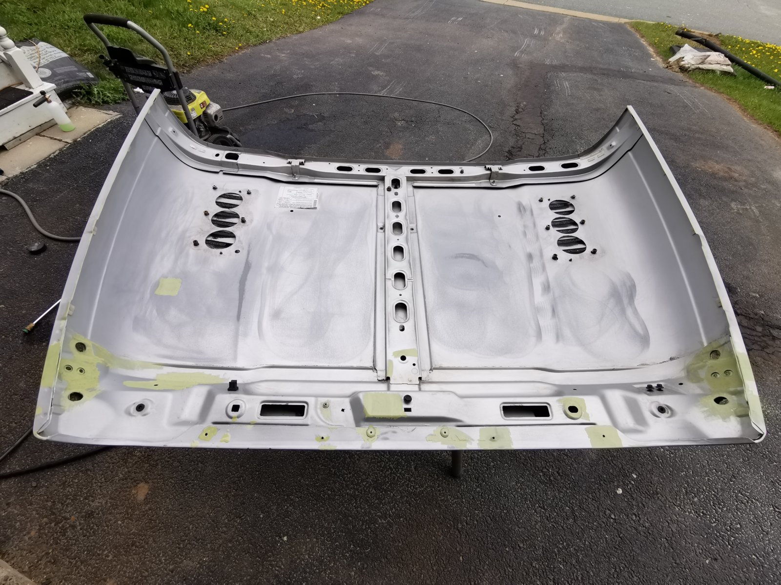

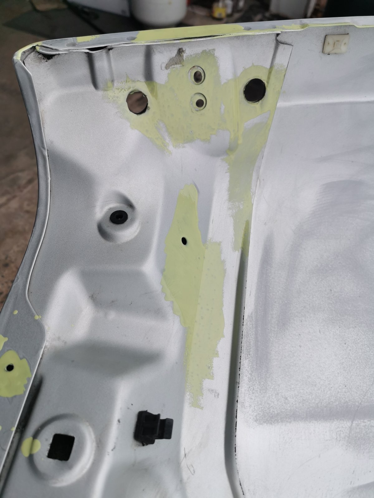

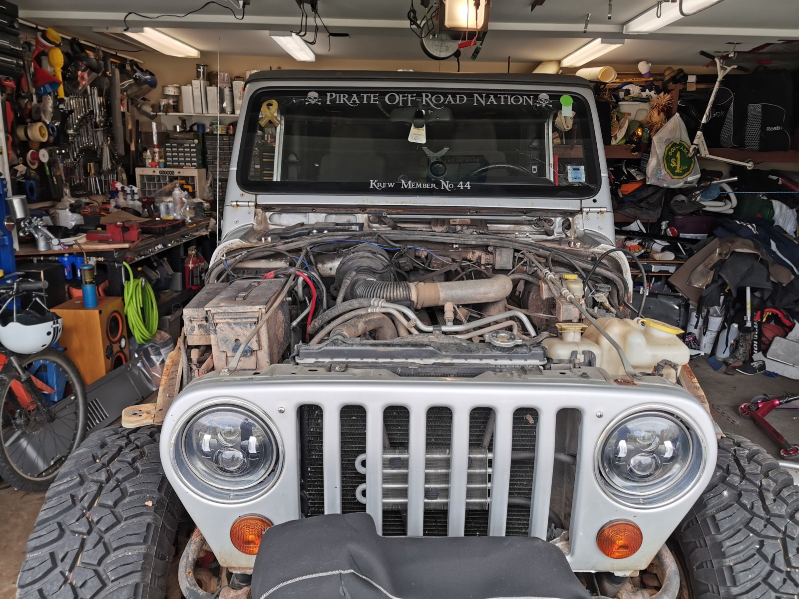

I've been working on my color change project.
Jeep is just about stripped down, doors and hood are ready for paint, and just a few things left to remove from the Jeep, then to fix the minor body rust issues.
The underside of the hood and insides of the doors have been painted.
Epoxy primer where some small surface rust spots were sanded down.
My wife wants to kill me spray booth, lol.
Two coats on the underside of the hood here.

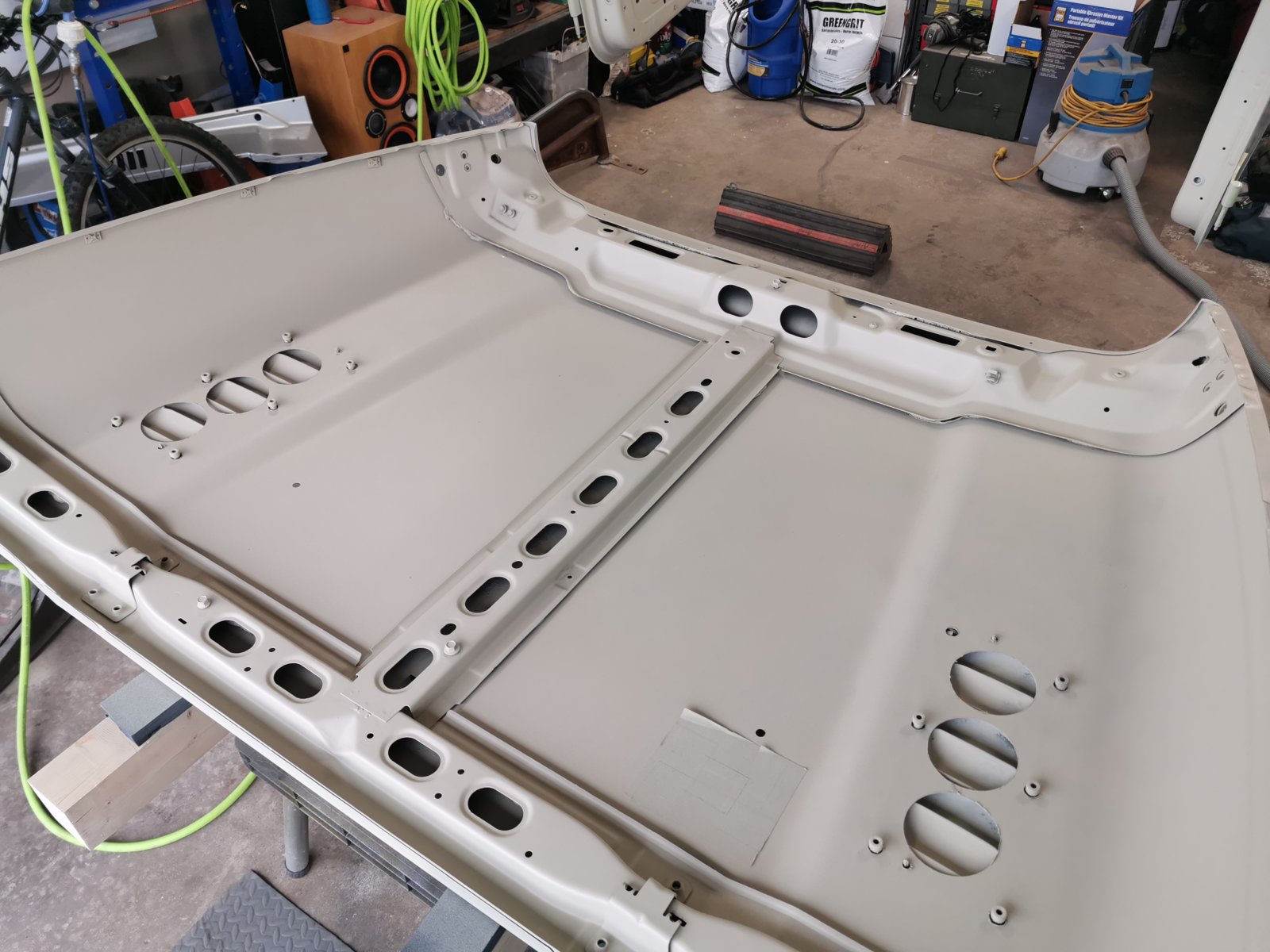

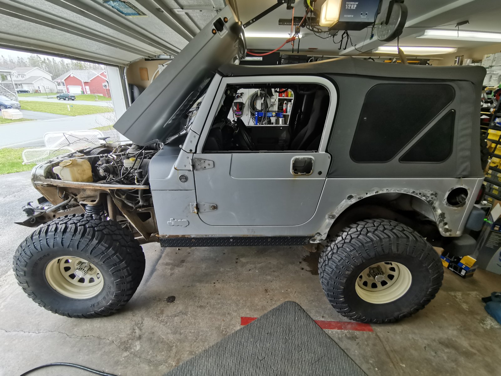

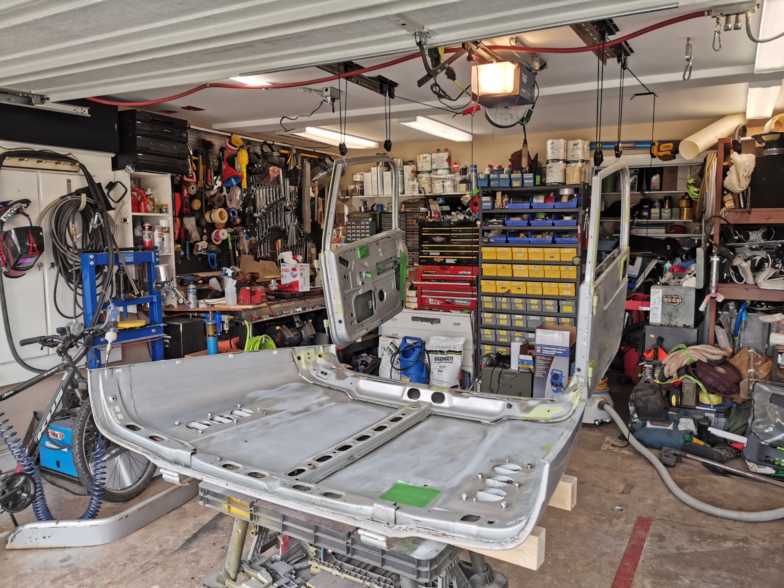

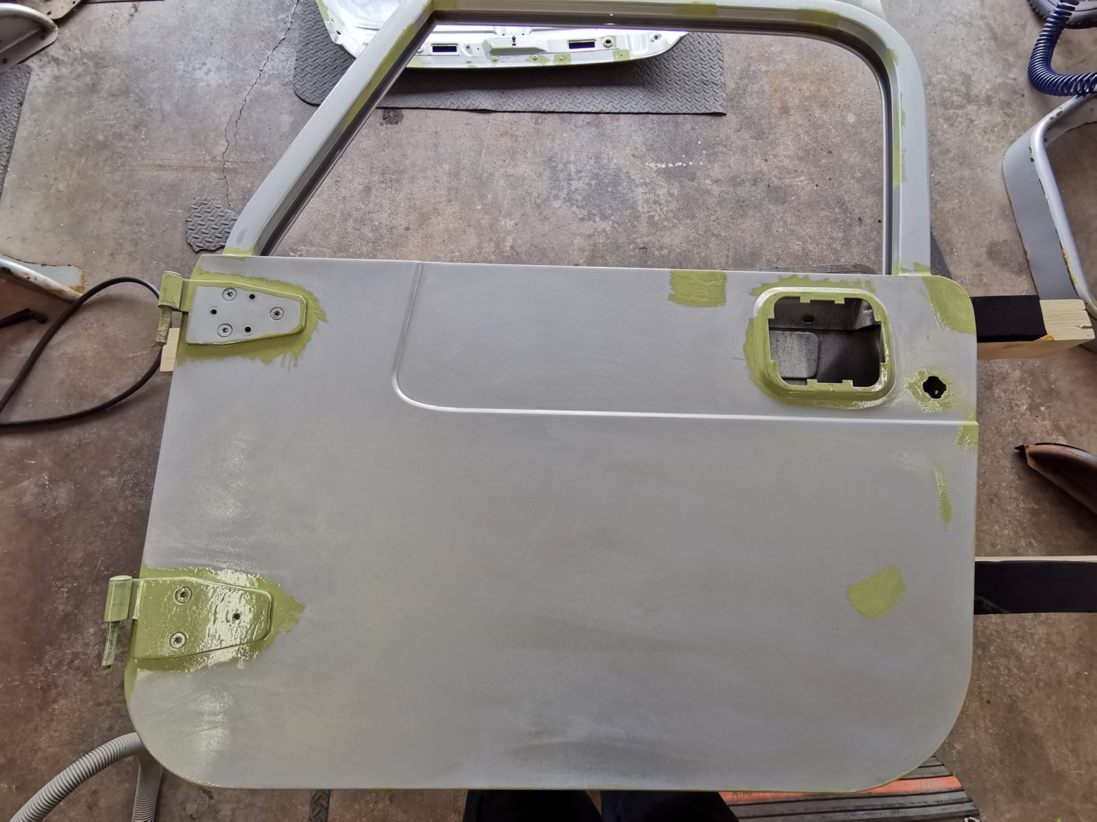

View attachment 94594View attachment 94593View attachment 94589
View attachment 94595View attachment 94588View attachment 94590
Looks great so far...is the underside of your bonnet shown in the pic the outside colour your going for ?
