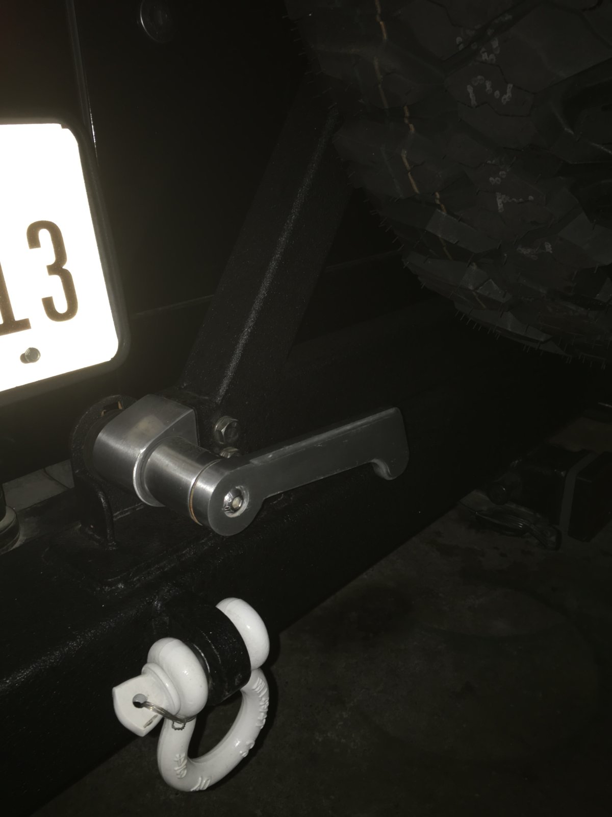

Barricade, or Fishbone, I think. It’s just like most others out there. The locking mechanism on it clears everything fine but I am going to have to figure out a way to lock it. Went to a store the other day and came out to it opened, when I know it wasn’t when I went in. I know it didn’t bounce itself open because it’s solid as hell and doesn’t move or wobble at all. The carrier part doesn’t touch any of the bumpers at all, so I’ll have to fix that too I guess.
put some of that never drying blue dye on the handle, Prussian blue...it makes the perp look like a bank robber and it does not wash off and takes months to wear off! just use gloves when you open it yourself, nitrile ones.

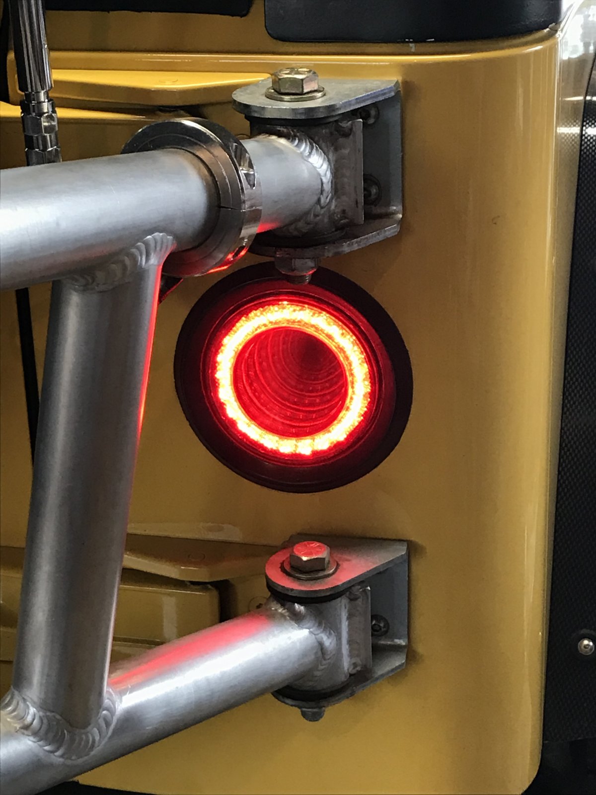

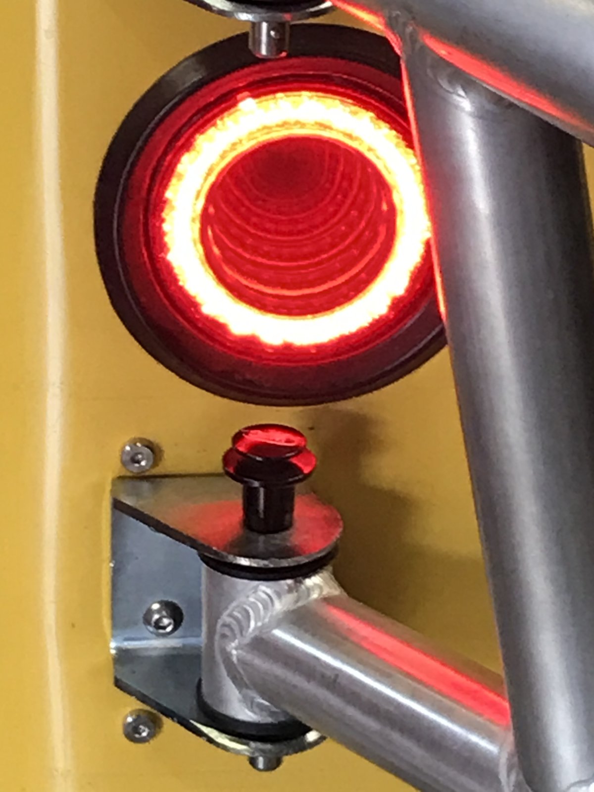

How difficult was it to change out the stock taillights for those round ones...?
Reactions: DrDmoney
Not that difficult at all. You need to measure a few dozen times to make certain you're centered / even on both sides, drill a large hole with a hole saw, add a new ground (I used a self tapping screw into the wheel well, and solder the new connections to the existing harness.
Oh its that's easy?? thought there was more to it than that haha... and the old holes are all covered or cut out as well ?

Do you remember where you got them from?
Reminds me of the older CJ's, love that look.
The old mounting locations will be cut away when you drill out the new holes. I love the look. After following @Daryl on a run I had to do it.
