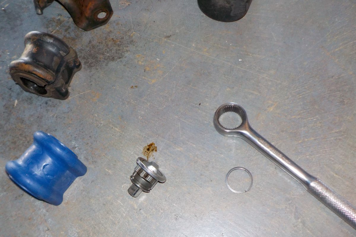

Added some Moog suspension stabilizer bushings and cleaned up under there with some paint (yes I know you wont see it but I know its there haha)
View attachment 98474View attachment 98475
Oh yeah my socket set gave up the good fight and took a one ticket to Tool heaven.
I put those same bushings on the front of mine. I can’t remember if I put any type of lube on them or not, but they squeak like crazy in cold weather when I go over the speed bumps at work. I dont know if I’m going to try to disassemble and put some SuperLube on them or just replace with rubber ones.
