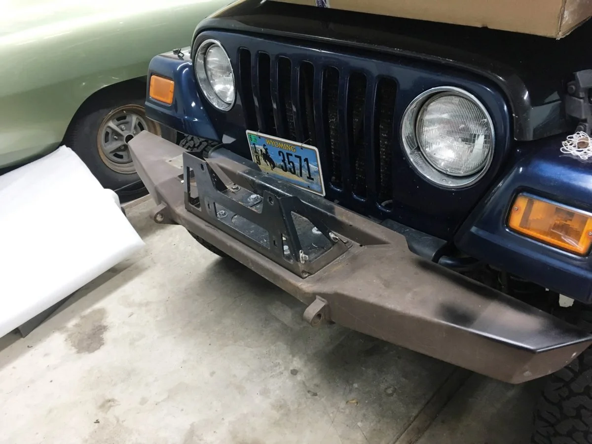

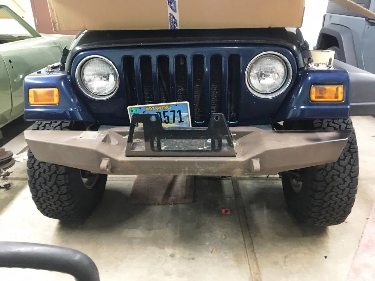

I took the front bumper and winch mount off of the YJ and put it on the LJ, Now I need to throw some black paint on the bumper, remount the winch and I have the front about done. I think I want to weld a receiver hitch into the front and I think I will mount some LED's on it too. That way I can blind the douchebags who dont dim their lights...

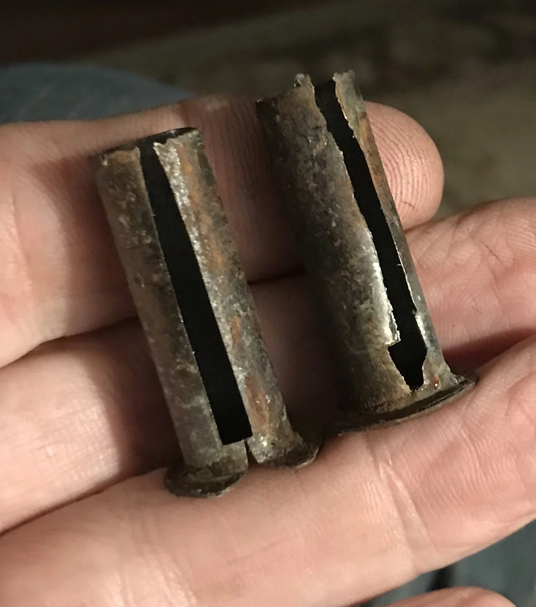

Put delron door bushings on my Tj. Kinda difficult project. The old ones were original and didn’t want to leave. But a big improvement. I might have to trim my passenger door opening on my fiberglass top as raising the door slightly has it scrubbing the half top. The driver side was perfect after install.

Had to use a 2x4 to get the doors off. Guess they hadn’t been off since 2002 when they were put on. I tried driving the old bushings out with the ‘tool’ that was supplied with no luck, in fact I slightly moved my driver side lower hinge by whacking it so I removed the hinge and took it to my shop. I eventually used a small 1/8 in cutter tool in my dremel flexshaft and cut a slot through the thin insert from the bottom of the hinge. Just ran it in and out in the same spot for a few minutes. I used a pointed tool to get between it and the actual hinge and pop it out then. Just needed some place for the rusty steel to go. I didn’t remove the hinges from the truck on the others. Just cut the groove while they were still on the Tj and then popped them out. There is a seam in them, the left one was cut in the seam. Clean up the inside of the steel hinges and door pins good before you insert the delron inserts and don’t forget oil. Hope this helps.

If I can find time I'll be installing mine this weekend...I think I'll drill out the old ones.

Those are SUCH A PAIN to remove! I cocked one of my hinges too, ever so slightly that now my driver door needs a little more ‘oomph’ get it shut. Tried slamming it the other way then realized I’ll probably do more damage than good.
I’ll use my Dremel for the passenger side hinges. Thanks for posting this info!
