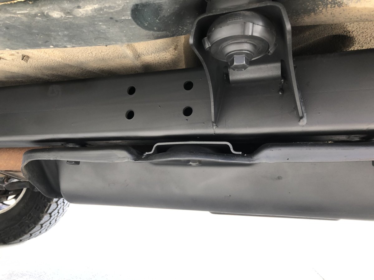

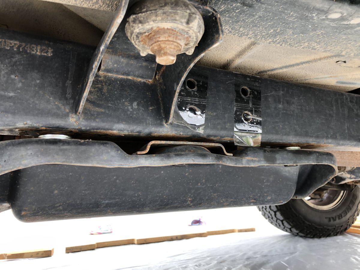

I did the Eastwood Internal & External frame treatments. The frame was pretty clean to start with, so a couple hours of wire brushing and painting really did the trick.
Some before and after:
View attachment 102869View attachment 102870View attachment 102871
View attachment 102872View attachment 102874View attachment 102875View attachment 102876
I like the flat black of the Eastwood external paint vs the glossy look of POR15 how mine turned out but as long as it’s protected
