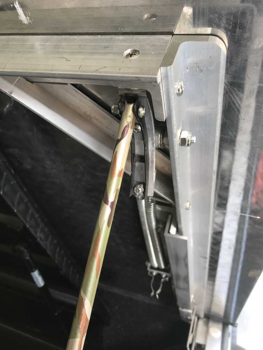

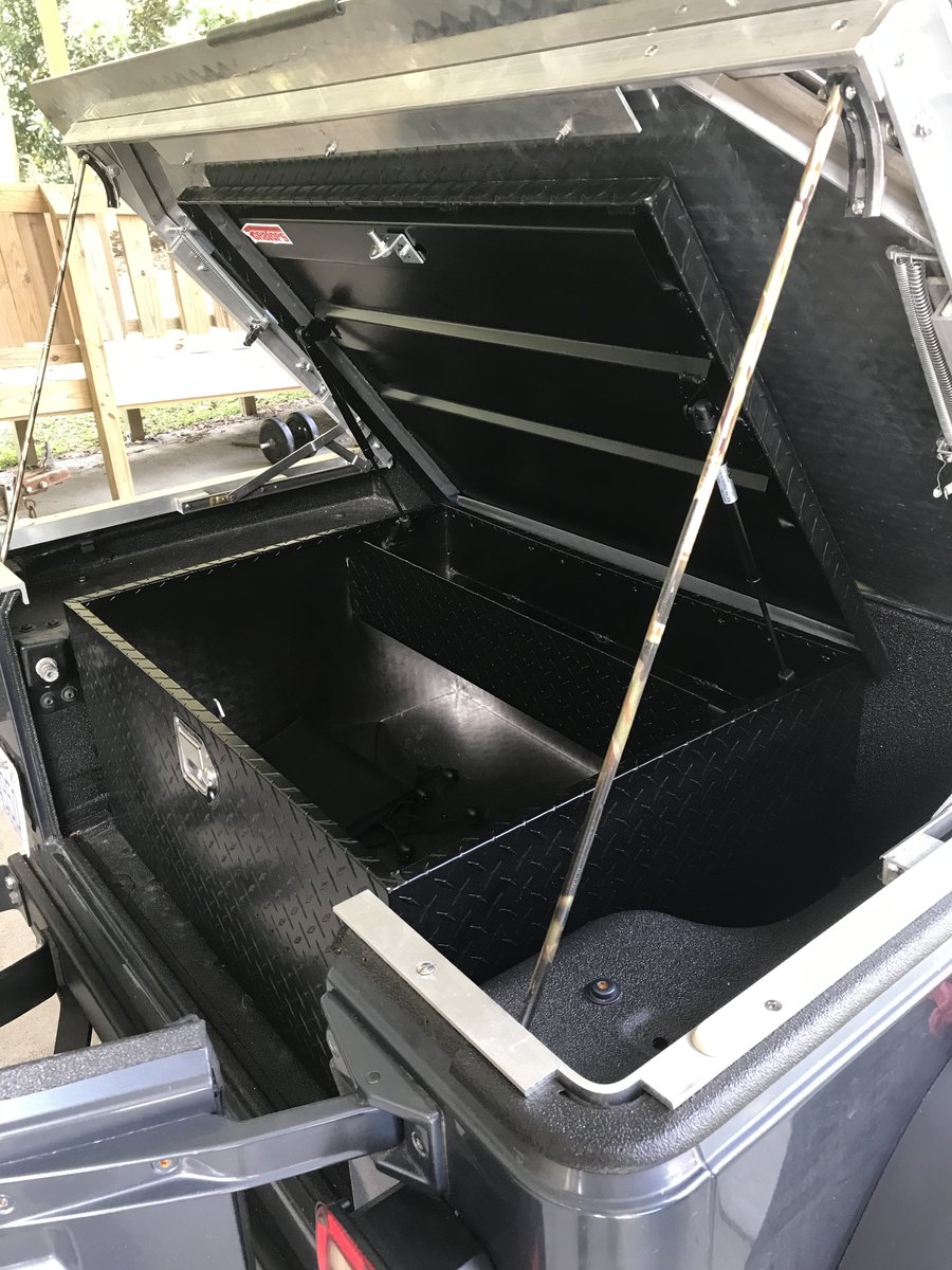

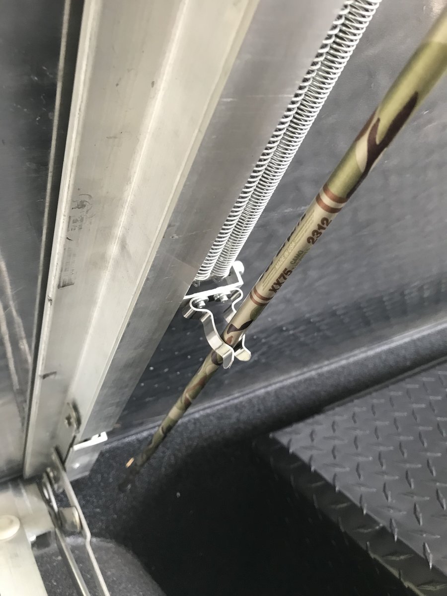

Been finishing up the tonneau, I want some gas struts on it but for now I built a pair of supports out of a couple of scrap aluminum arrows, 3/8 steel rods, pieces of wiper arm and parts of a golf bag cart. Also been fabbing up a lock that will bolt to the tire hanger out of steel angle and a plate. I found some rust on my tire mount that I’ll clean up and paint next week. Then I’ll start on the hood latch mod, Tj to Cj. Pix tomorrow.

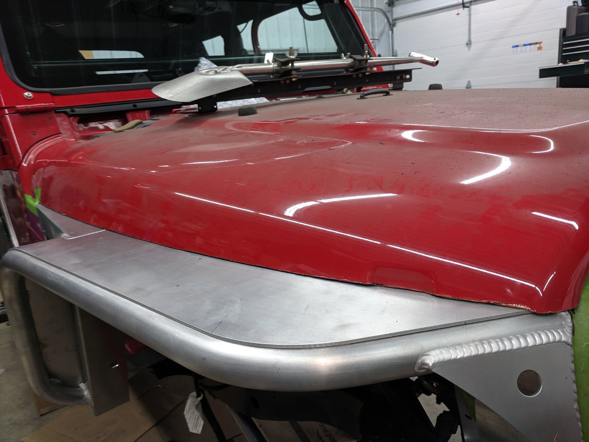

Is that an aluminum shovel?
Stainless steel. I used to carry one in the back but picked that one up 7 or 8 years ago and mounted it to the hood to keep dirt out of the back. It's been useful to have in the woods and around camp. The powder coat on the mount is starting to break down and rust underneath so I'm going to be making something out of aluminum.
