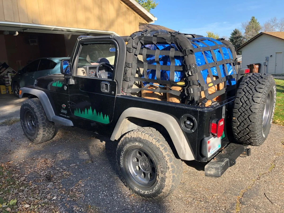

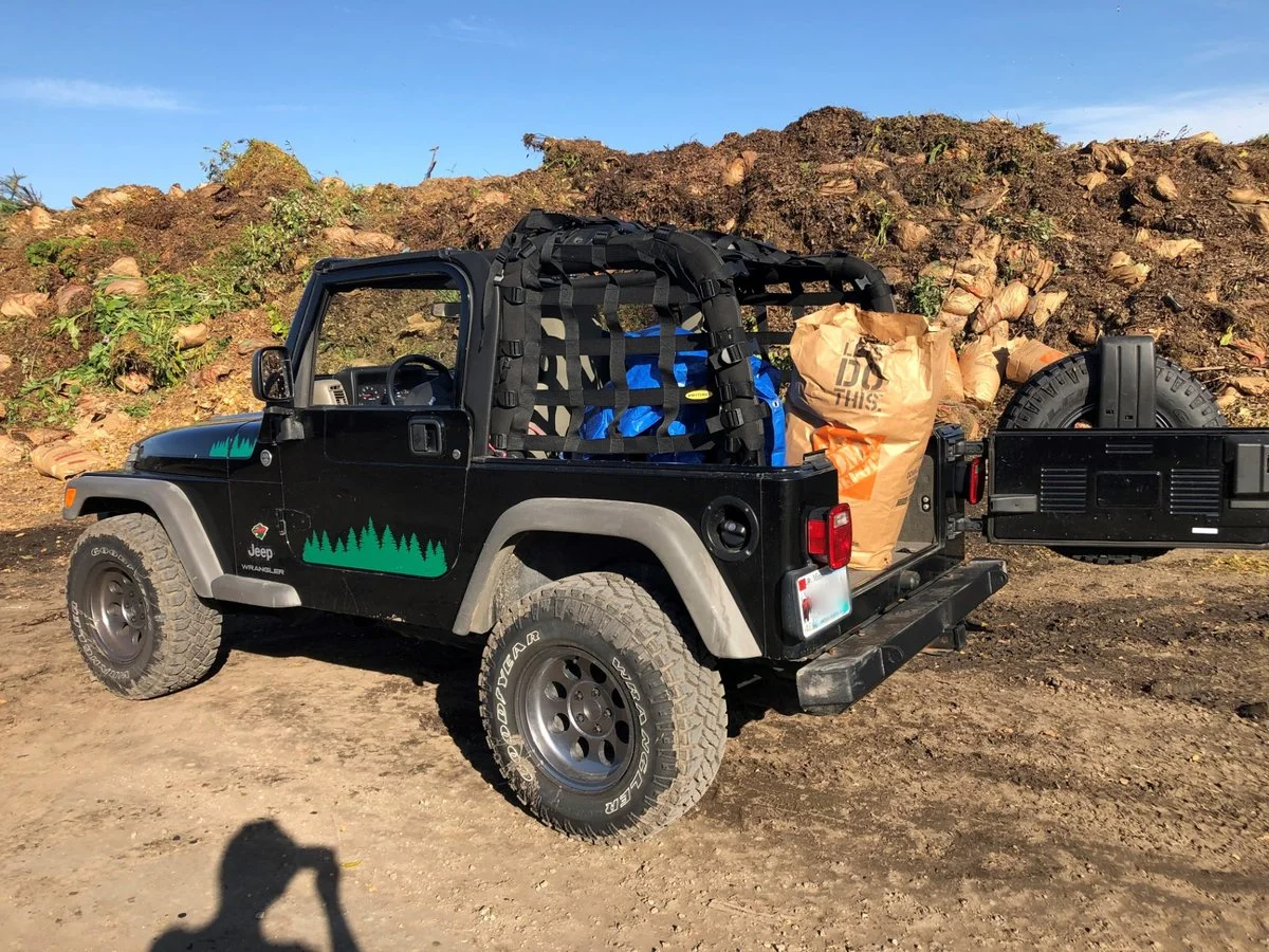

This weekend, I started handling the joys of Fall (a.k.a. dealing with the mountains of leaves that the trees drop on the yard). Fortunately, there’s a mulch drop-off nearby:
I was able to take 7-8 full bags at a time, which isn't bad considering how small the TJ is.

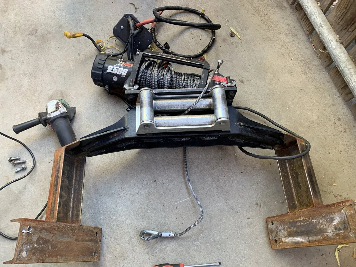

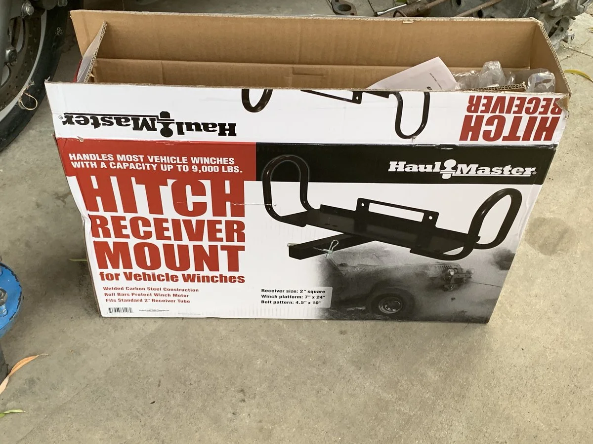

Yesterday I bought this,

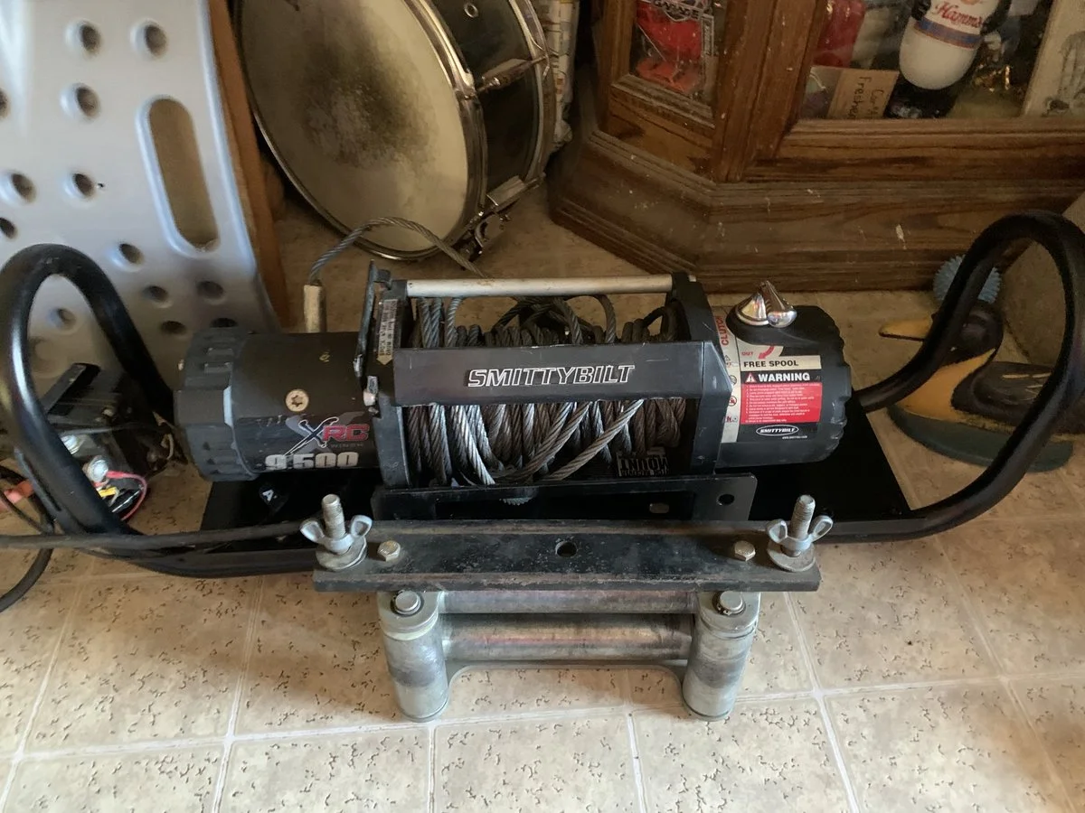

And today I took this off of the funky mount it was on, and got it ready to install on the mount I bought yesterday. :D I was going to reuse the bolts that were in the big mount but the PO used several different bolt sizes and I can't stand that. LOL I will go get some bolts tomorrow and get it mounted. Then we will have to run power wire to the front and back of the Jeep. :D
I know it is not a Warn, but it was free so can't complain.

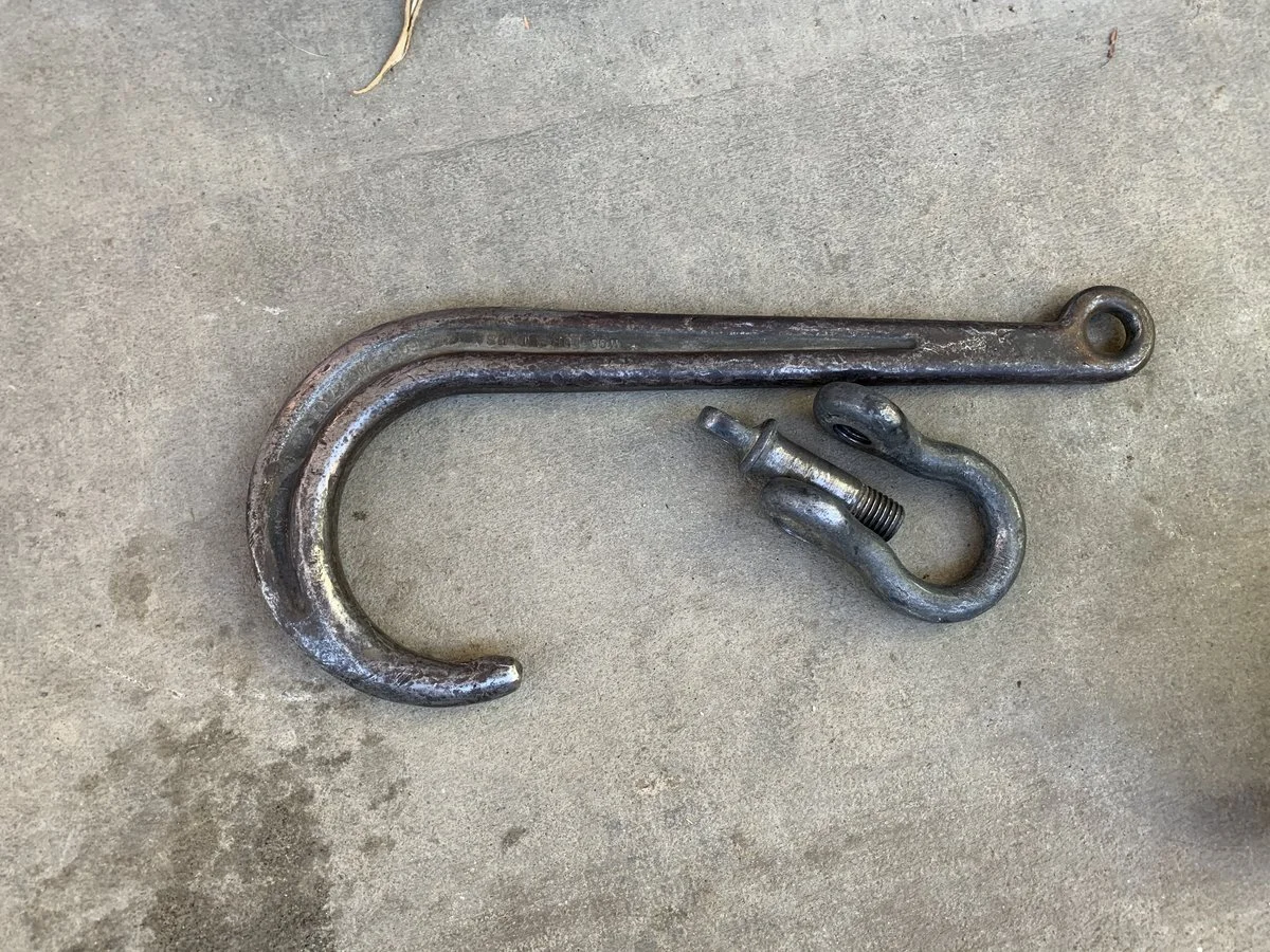

Think this hook is big enough for a recovery hook? LOL It was the one that was on it. As you can see I removed it. Will be getting a much smaller one. :D
Just an observation, but that hook looks like the type of Hook they use on flatbed wreckers for winching disabled cars up onto the flatbed, or a car trailer.
Judging by the looks of the old Mount that you have, that may be what this was used for at one time,
Had to throw my two cents in from someone who knows nothing about everything and something about nothing... 🤪😋
Worked on the winch again today. After finding out not only did the PO use different size's of bolts, he also used different thread patterns. There were 3 Metric and one standard. I thought that the bolts threaded into the actual winch, but when I got home with 8 bolts, 4 metric and 4 standard, I realized that there were square nuts inside, kind of like a MC battery set up. So, I went back and was going to buy 4 new square nuts and return 4 of the 8 bolts, but they didn't have any my size. The guy figured out why they used the one standard bolt. They had cross threaded the nut. So, I came home and found a tap and redid the nut and now all is well. :D Got it mounted!
BUT, I don't think I will be able to use it with my current bull bar. I kind of did some rough measurements and it looks like the bull bar is going to be in the way of it sliding back onto the receiver that hubby welded on. Before I bought the mount I thought all I would have to do is move my light bar up to the top bar, but it looks like the mount is going to be to wide to fit.

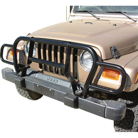

Sooooo, I started planning. LOL I looked at this bar for a stock bumper and like it. But, I'm not sure if it will go over the receiver. Anyone have this bar? If so, can you measure how much gap is between the bumper and the bottom of the bar?
I also found this bar. LOL Yah, I actually think I like it. :D Imagine it purple.......... can you see it? LOL It goes with my Bus's Roo Bar. :D
EDIT!!! I just ordered it. LOL Found it on eBay for 30 bucks cheaper and went for it. Hubby say's he can weld some tabs on it for my light bar if needed. :D All I can say is, Dare To Be Different. :D
Well, you are absolutely right. It was on a flat bed trailer and that is what they used it for. We will save the tow hook for hubby's personal tow truck. :D

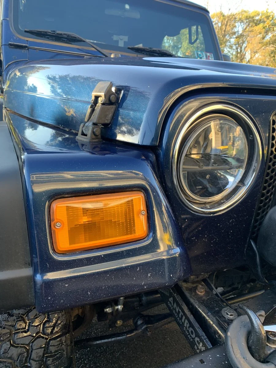

Looks great..!!
What did you use on the front marker lights..??
I used leftover 3M head light restoration kit that I used on my wife’s accord headlight. But you can basically do it by sanding it down with fine grit sandpaper then apply a wax. The 3M kit gives you a bit piece that you use with your power drill to sand and buff.
Reactions: Daubie3
I used leftover 3M head light restoration kit that I used on my wife’s accord headlight. But your can basically do it by sanding it down with fine grit sandpaper then apply a wax. The 3M kit gives you a bit piece that you use with your power drill to sand and buff.
Thanks,
I'll add that to my ever-increasing list of things to do...
